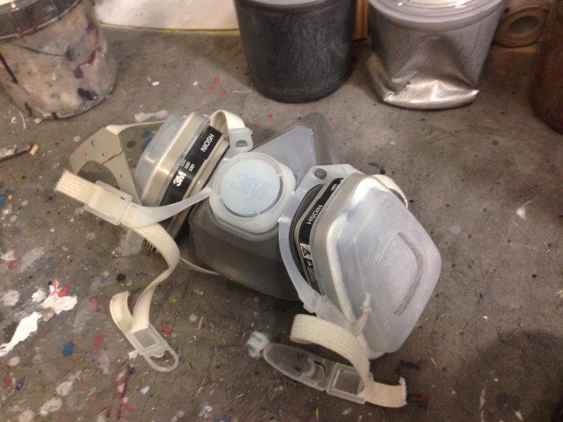

Probably true. However if you are spraying any paint/clear coat/primer you should at least be using a dual-cartridge respirator; one that removes both VOC's and particulate.
