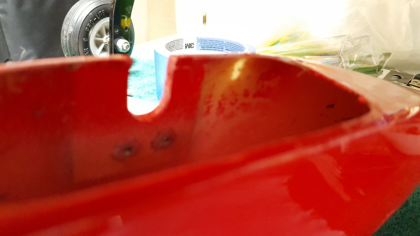

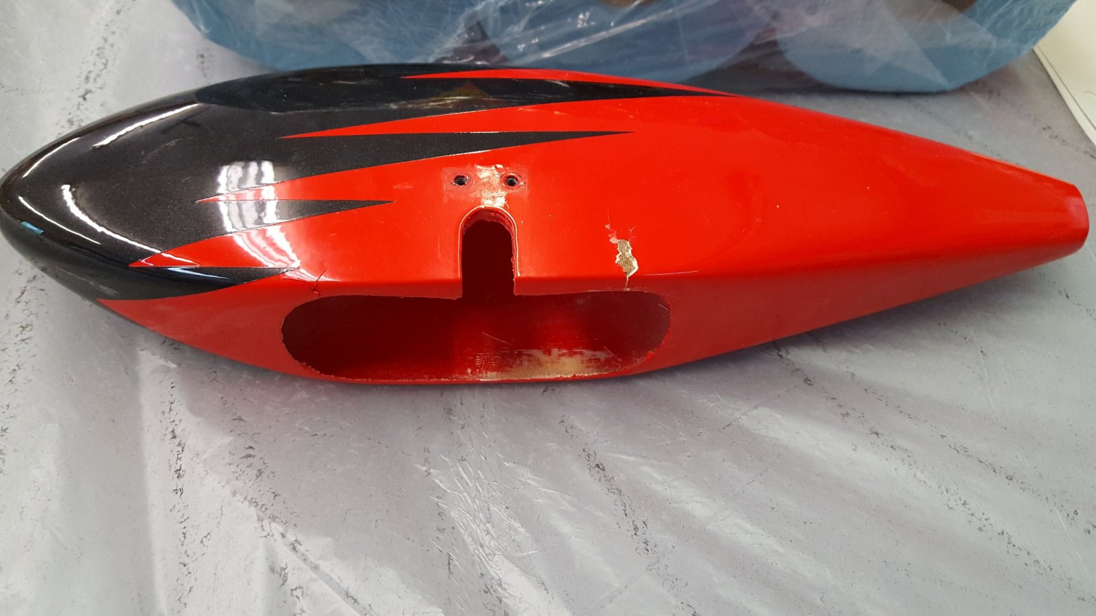

There are a couple of other small cracks that I fixed on the inside but didn't bother with the outside.
When you fly wheel pants on grass they're bound to get a little beat.

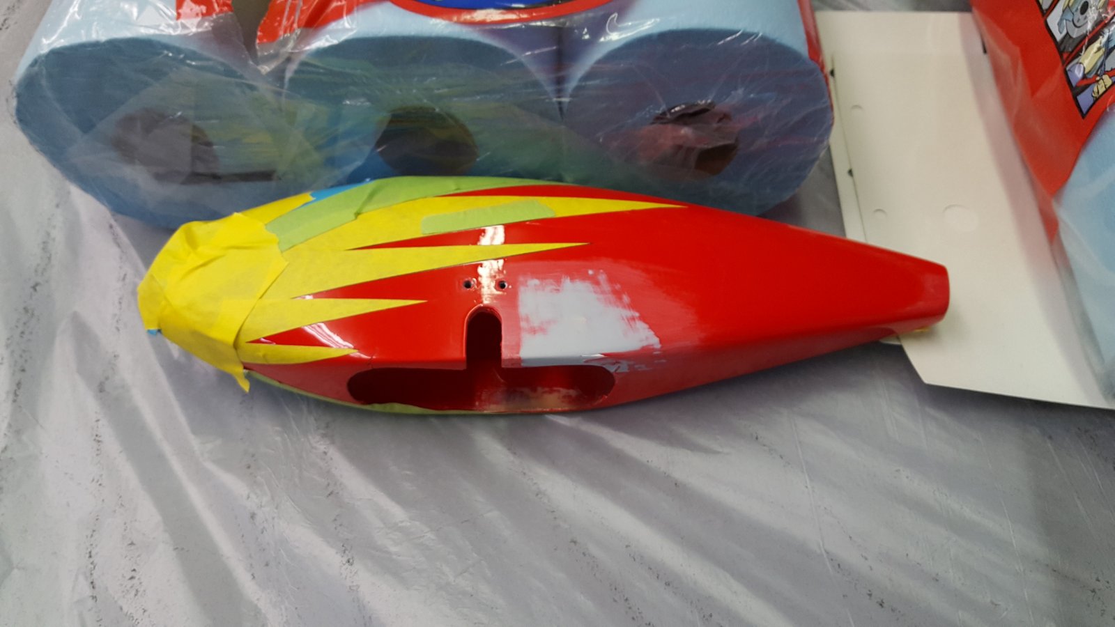

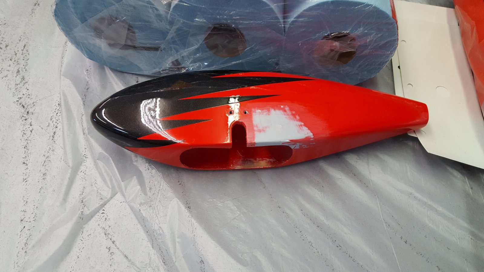

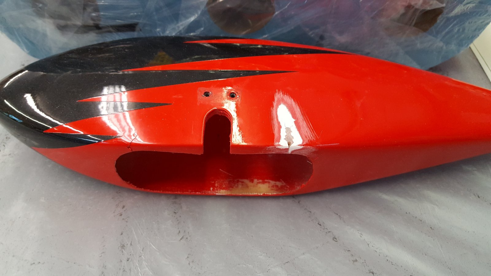

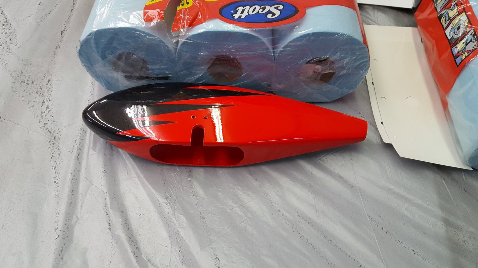

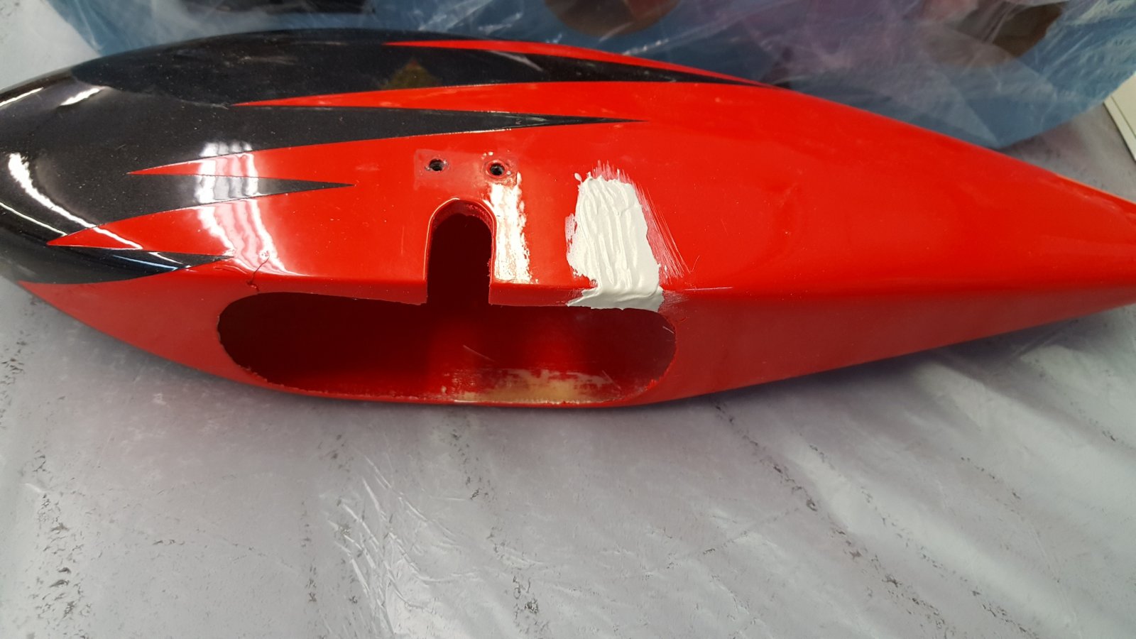

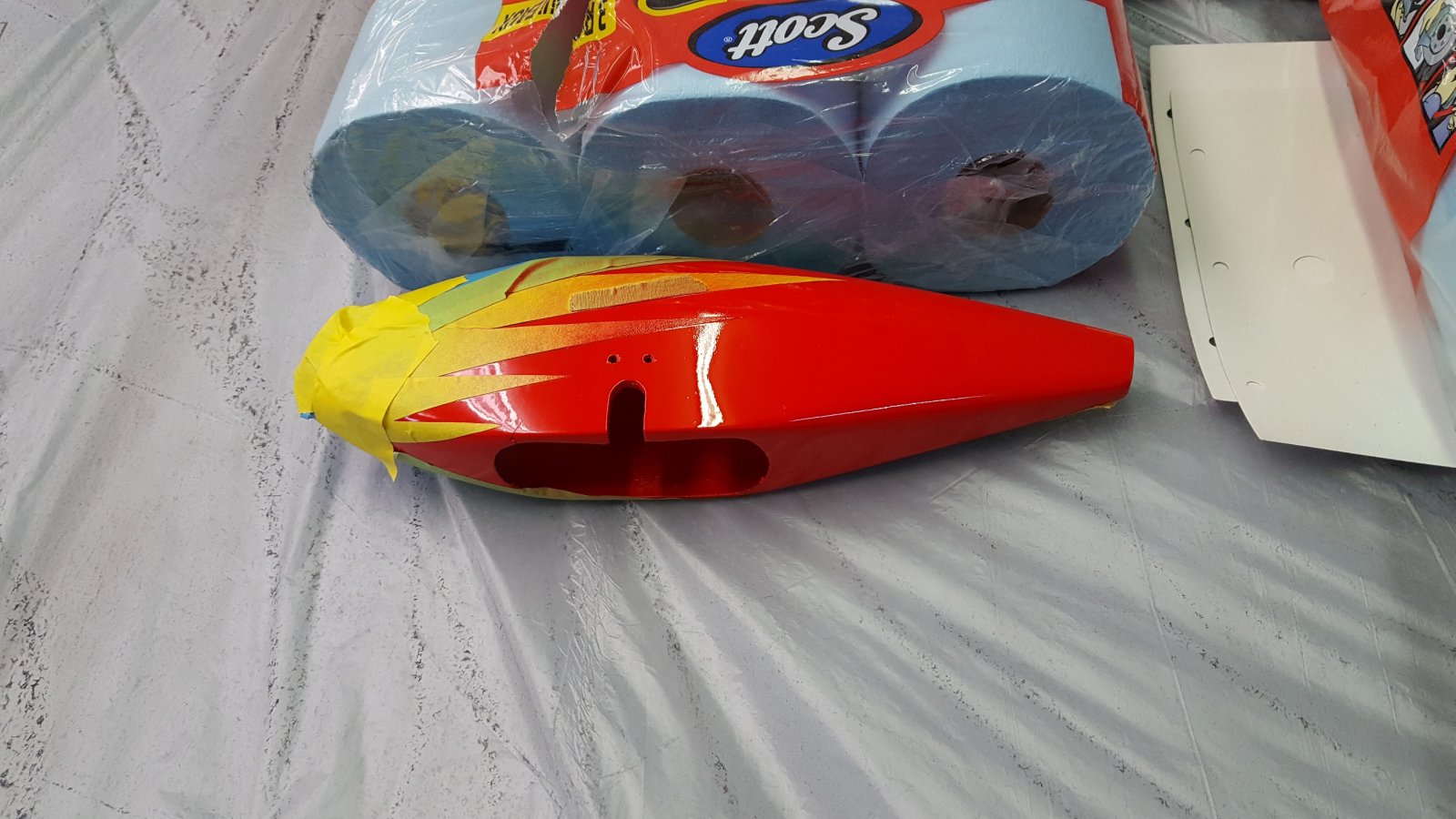

A few nights ago I glassed my wheel pants back together. I wasn't planning on doing much more than touching it up with a brush, but today I took it to work and did a really quick spot repair.
I featheredged it, smeared some Dolphin Glaze on it with my finger, sanded that, primed it with a spray can, sanded and spot painted. I just happened to have some red enamel from painting a sign that matched great!
View attachment 97969 View attachment 97970 View attachment 97971 View attachment 97972 View attachment 97973 View attachment 97974 View attachment 97975 View attachment 97976
Must say looks like new again cannot believe how lucky you are that is a perfect match.
Luchnia
I was pretty shocked at that myself, since it was the first can I grabbed off the shelf. I guess even a blind squirrel finds an acorn now and then.;)
