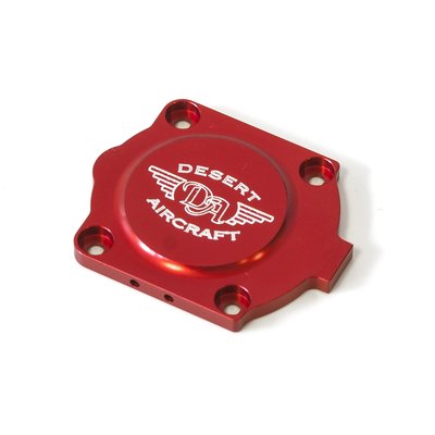

Just an FYI......When I was running my V1 DA120 I did the "breather tube" mod from the diaphragm plate to about 3mm from the choke butterfly. Maybe the pics are still on FG along with others that did this. Anyway... I thought the custom carb diaphragm covers was supposed to remedy the surging issue? I also understood that a pop off pressure of at least 10psi to 20psi worked best.
That is the cover that's on mine.

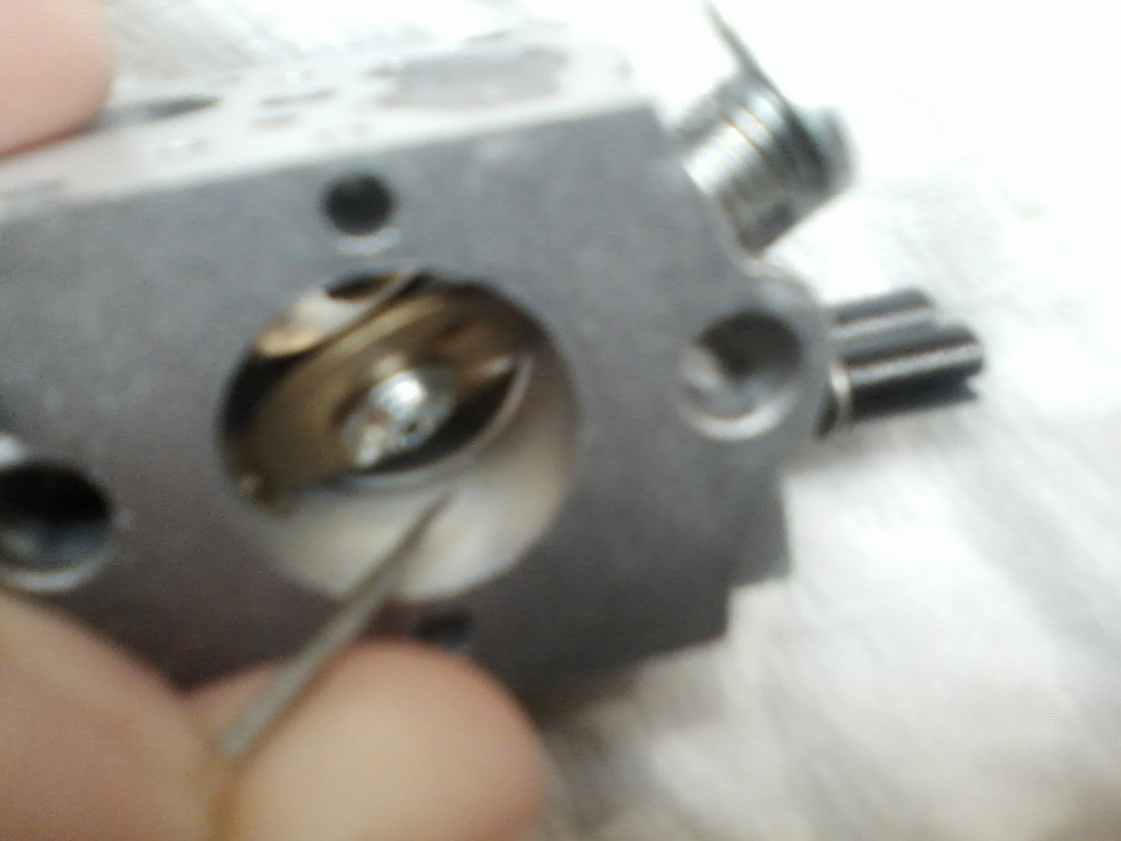

I would think then the L and H needles are fighting each other in their ability to deliver a "steady flow" at the transition point. Maybe moding the differential pressure "sensing" ports inside the carb bore right about where the main butterfly is what their doing? I don't really know just guessing.
This picture sucks but the ports I speak of are located where the tip of the pencil awl is.....
Not trying to fussy but is 14.7 to 15.5 that is ideal for us at sea level. 10 to 20 works don't get me wrong I have had a pope of pressure of over 40 and it kind of worked.
Had the same cover on mine did help on one plane but not the other.
