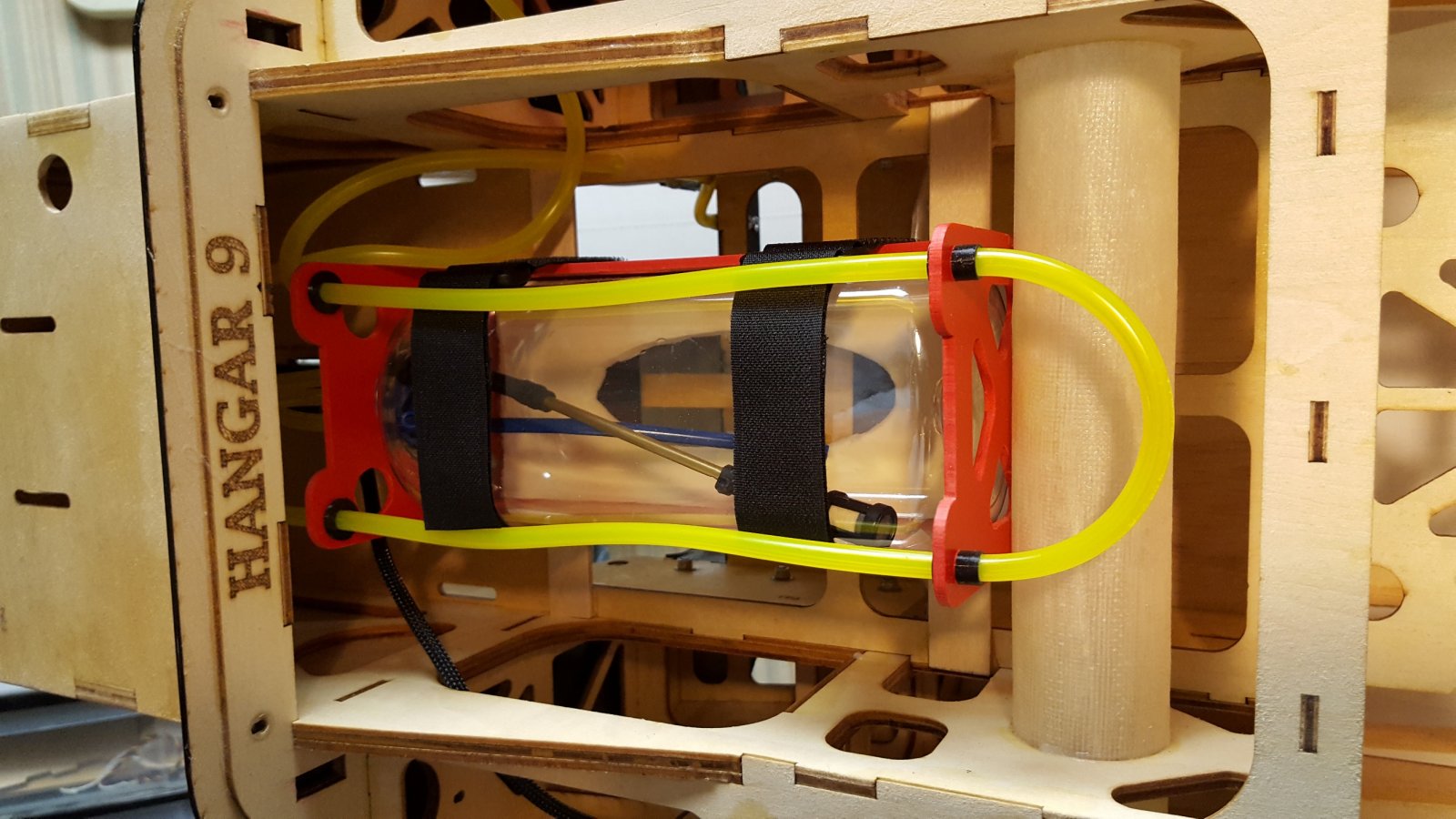

Do you have your vent line looped up around the back of the tank?
Years ago I thought my engines used a bunch of gas till Jason Noll showed me to loop my vent line.....
Yes, I did do the vent line loop on this one. The fuel tank mount has tabs built into it for the vent line. On my Carf Extra I forgot to do it and it would loose a very small amount out the vent.
