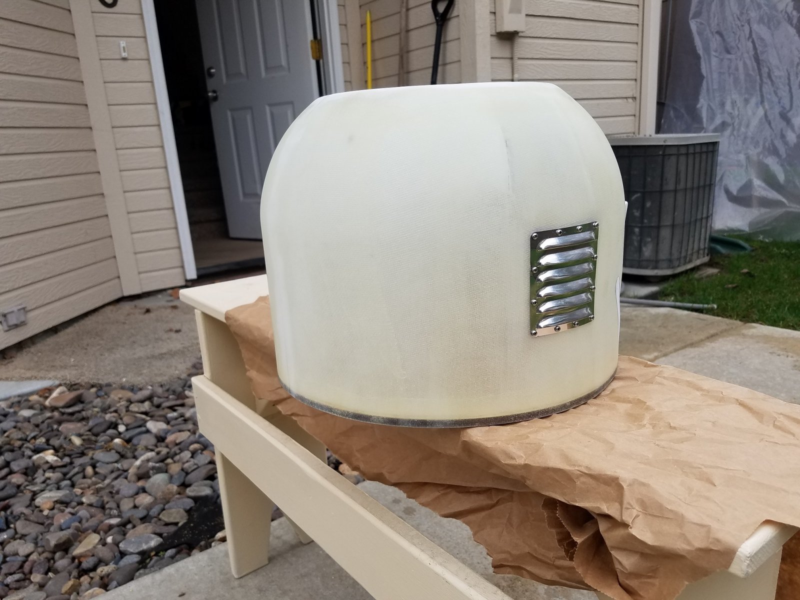

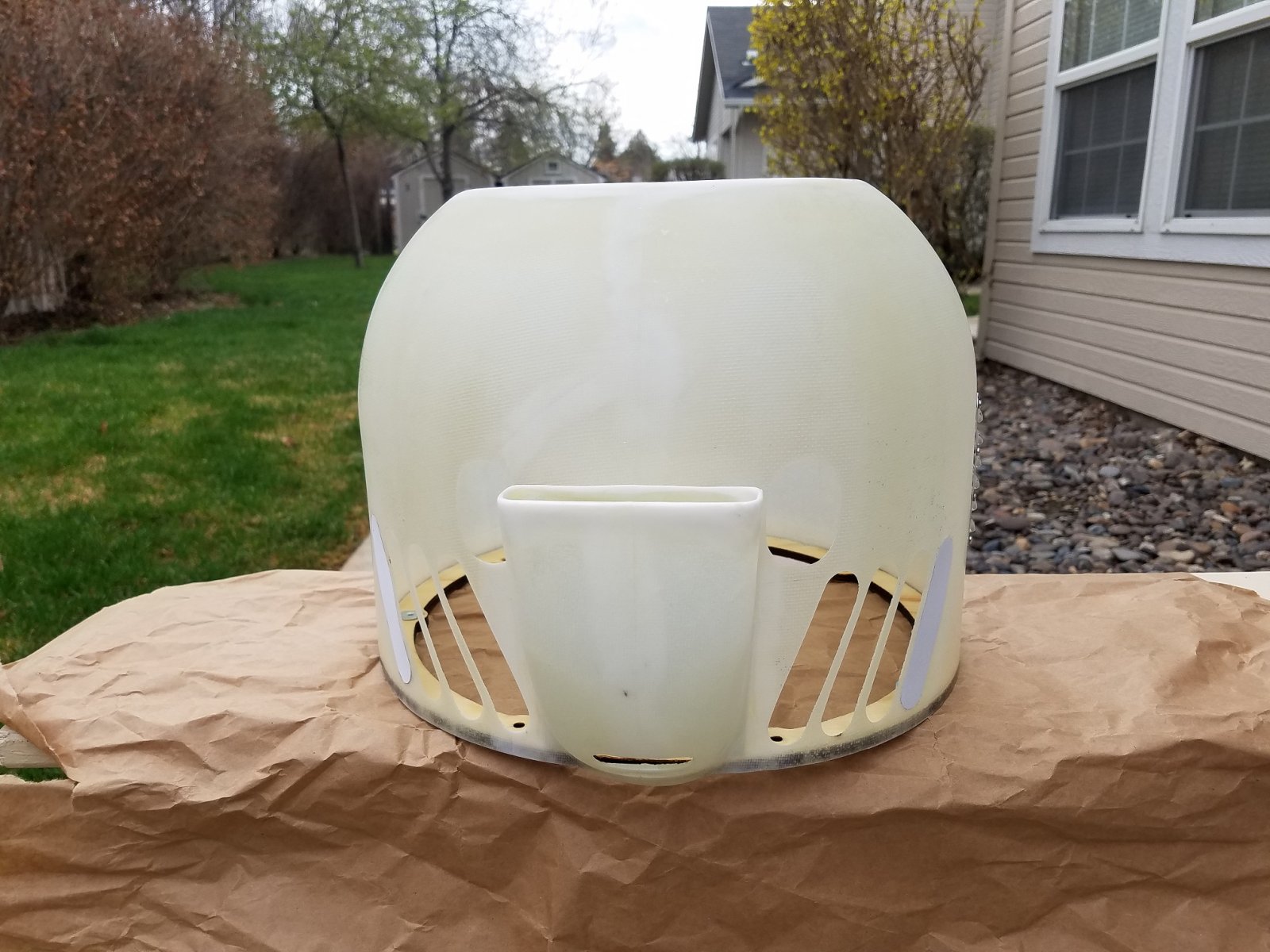

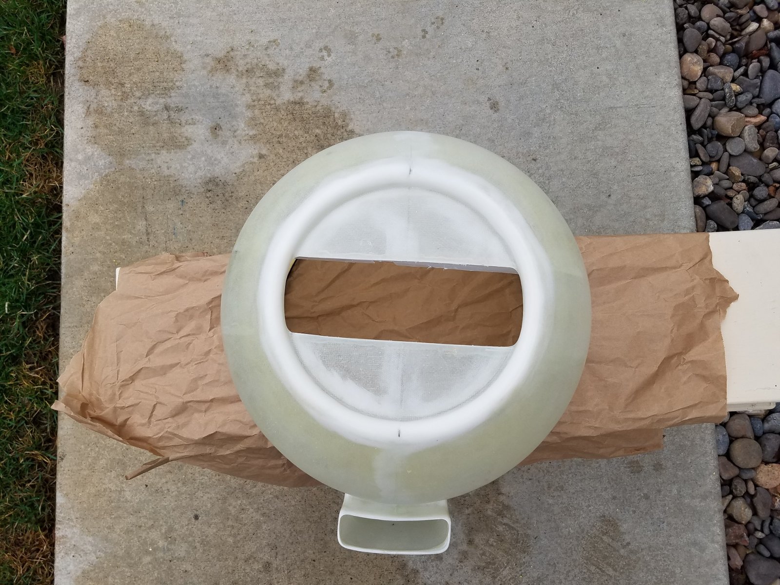

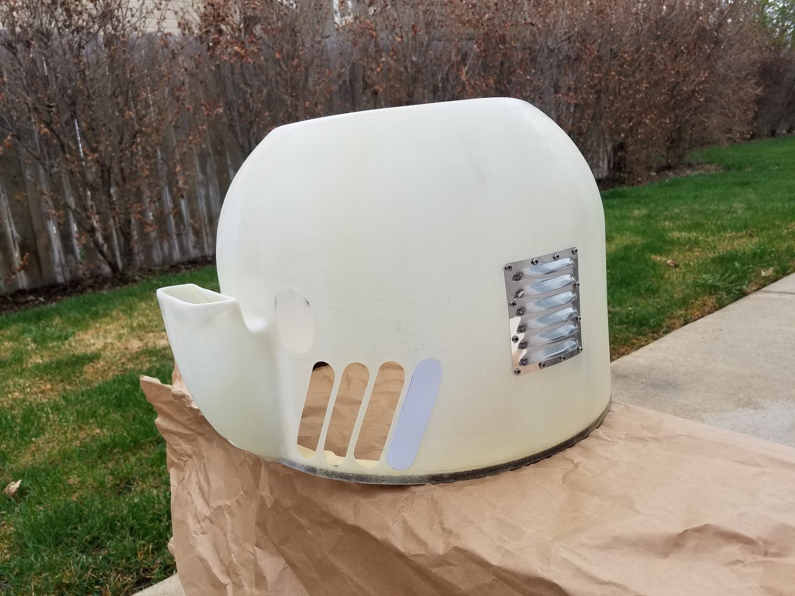

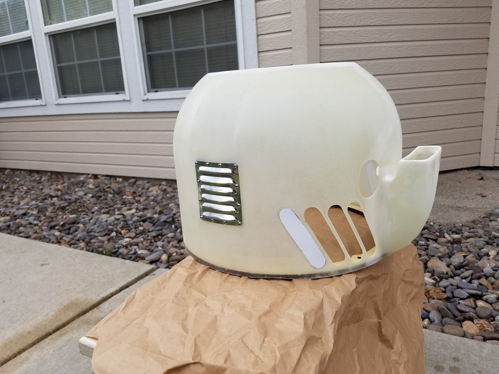

And awaaaaay we go. With the cowl sanded first with 220 to knock off the worst ridges and high spots, I then sanded it with 400 grit. Gave it a nice warm soapy bath with dishsoap. Rinsed really well, then another drying bath with 90% alcohol. Wiped down and ready for primer.

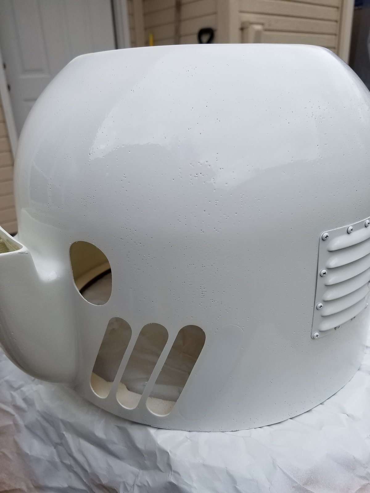

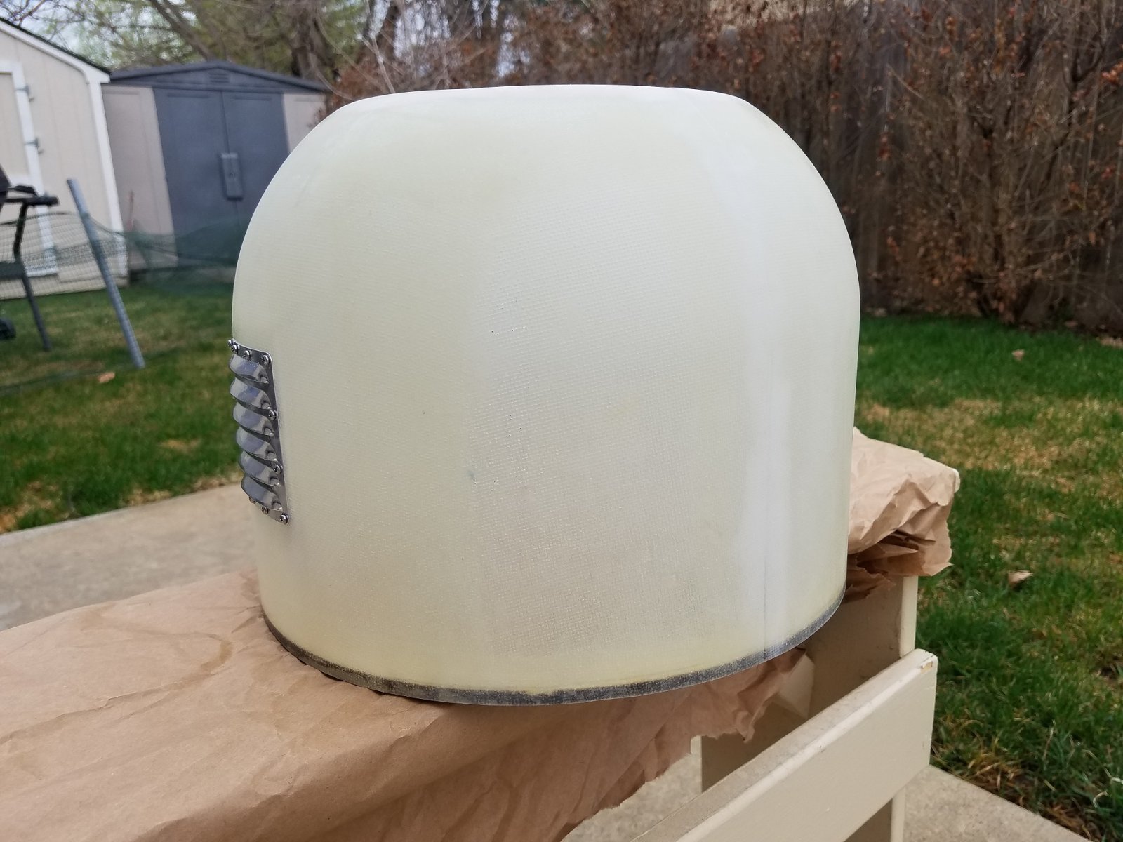

Aaaaaand "THIS" is why I hate to paint. I know enough to stay away from it. But noooooo.....I just gotta try it. I know also enough that the final paint is totally dependent upon the prep work. Apparently I missed something. I SHOLD HAVE GONE FLYING. UGH!!!!

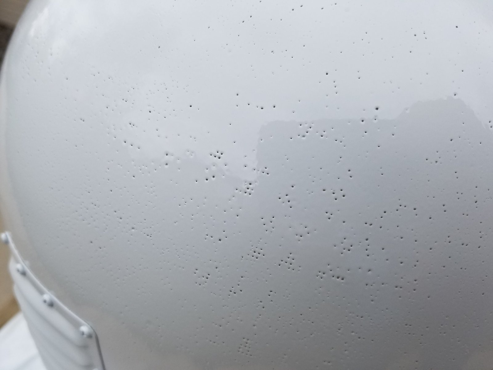

The only damn part of the cowl that took primer without "fish eyeing" was the cooling vent/louvers. What the hell. @Jetpainter can you offer a suggestion on what I did here? Or is it the cowl? Do I need to sand it all off and use a "filler" primer?
This is probably what David @HRRC Flyer was talking about.
Stupid....stupid....stupid!!!
They're not fisheyes they're pinholes in the fiberglass. You will need to fill them in with something. My preference is a product called Dolphin Glaze. It's a thin two part polyester glaze. You could use a lacquer based spot putty which is a tad easier to use, but the two part holds up better.
Any good bodyshop supplier will have some type of pourable two part glaze. Scuff up your primer with 400 or so, not enough to remove much primer, just enough to give the filler some bite. Then go over all the pinholes with your filler trying to press it into the holes, but not build up much on the rest. Sand it with 220 until you've sanded off all the excess filler and all you see is the dots where it filled the holes. When you start seeing glass stop. You don't want to sand the glass much because you can open up more pinholes. Reprime and see where you are. Use a strong beam flashlight to shine across the surface at a shallow angle. That will make the pinhole stand out so you can find them.

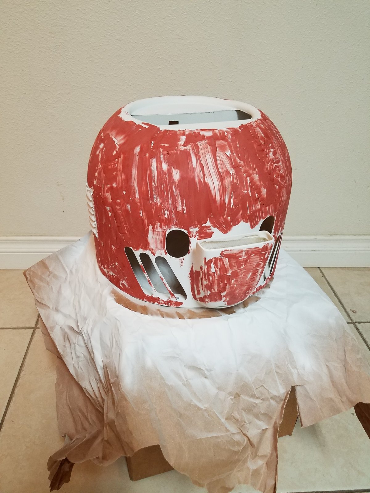

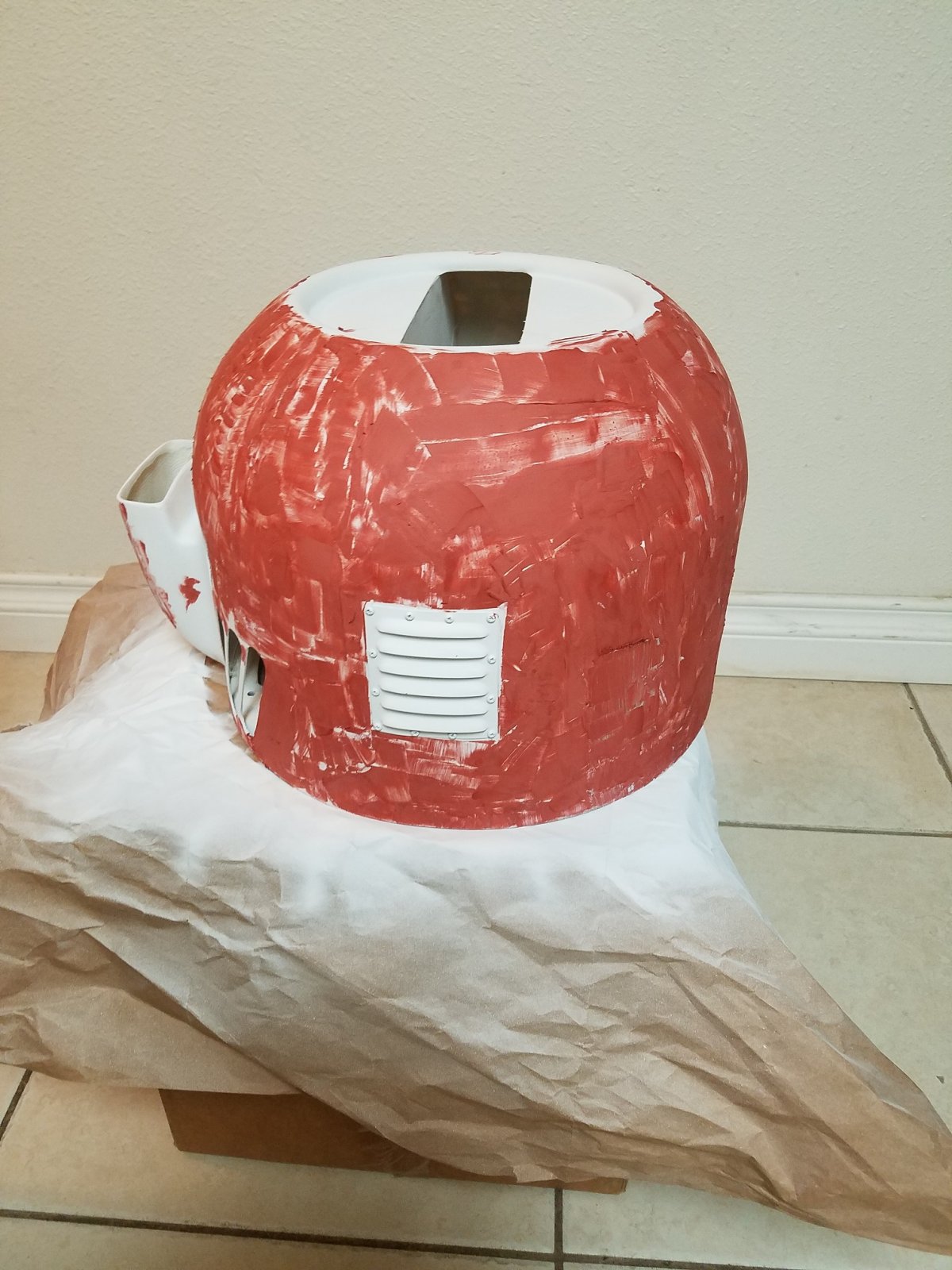

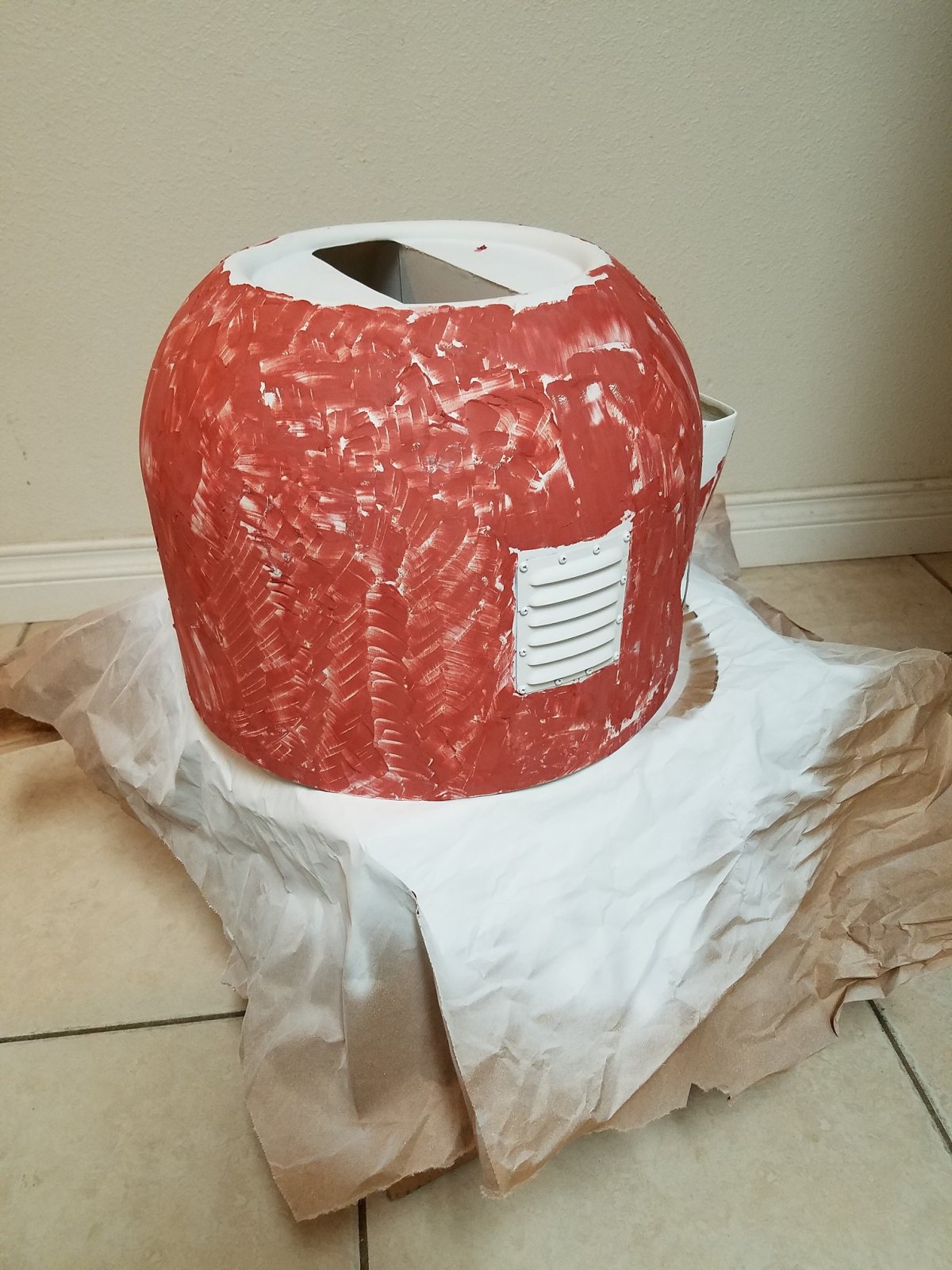

Well isn't this funny/odd. Just came up to update my progress. I was so exasperated I decided to go out and put a couple of laps on the Sukhoi. On the way home I stopped by to pick up some spot/glazing putty. Pin holes? Ha! Ok, yeah.....I don't think so. Maybe a little over kill and maybe a little more sanding to be done. But I am so over this cowl.
