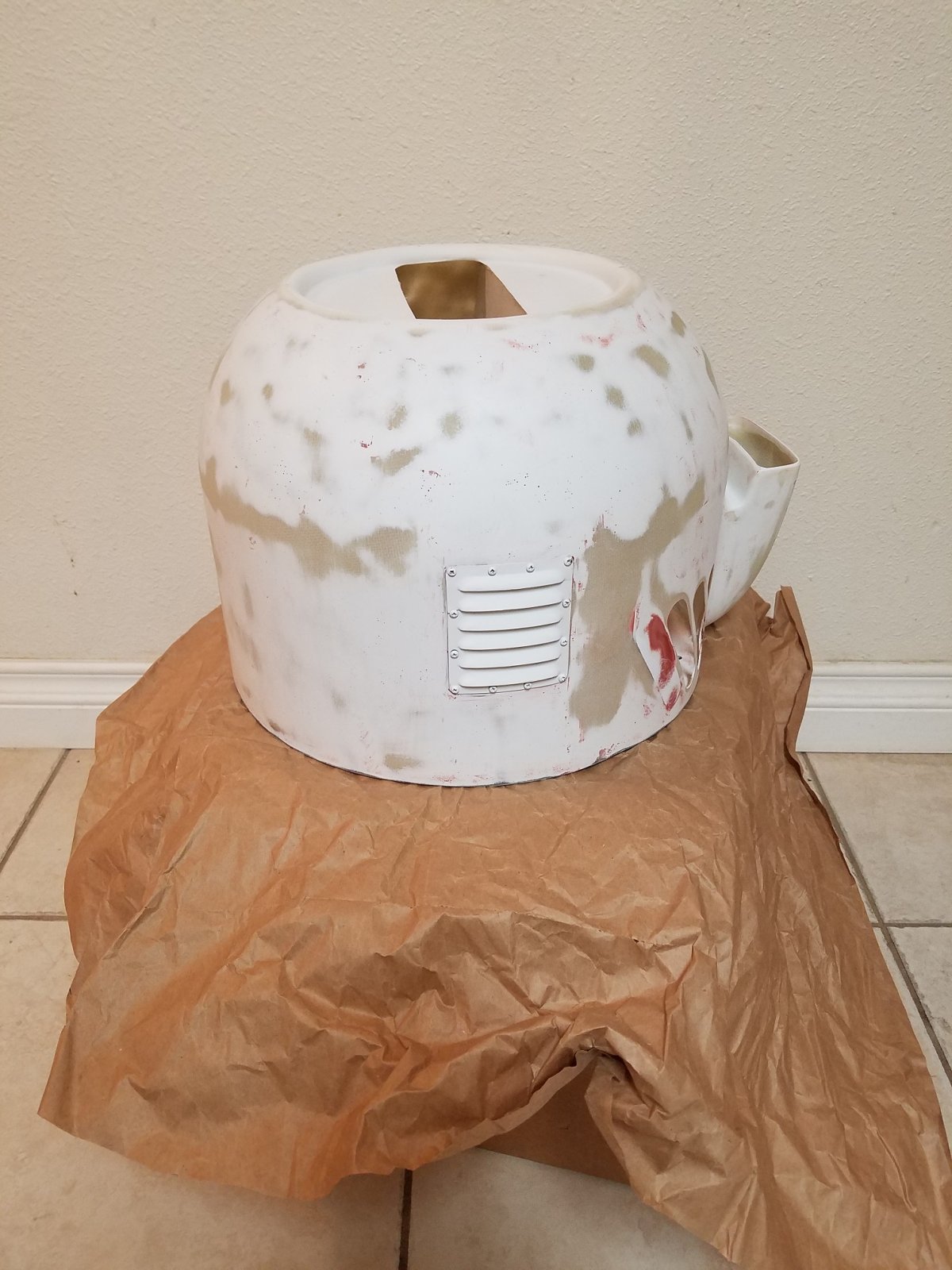

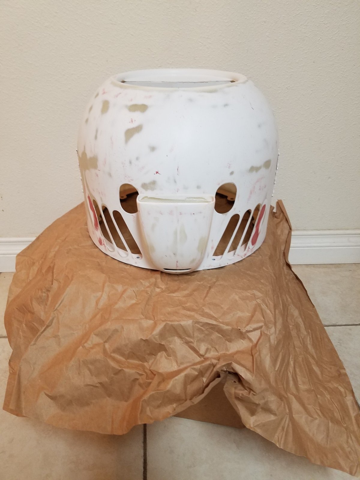

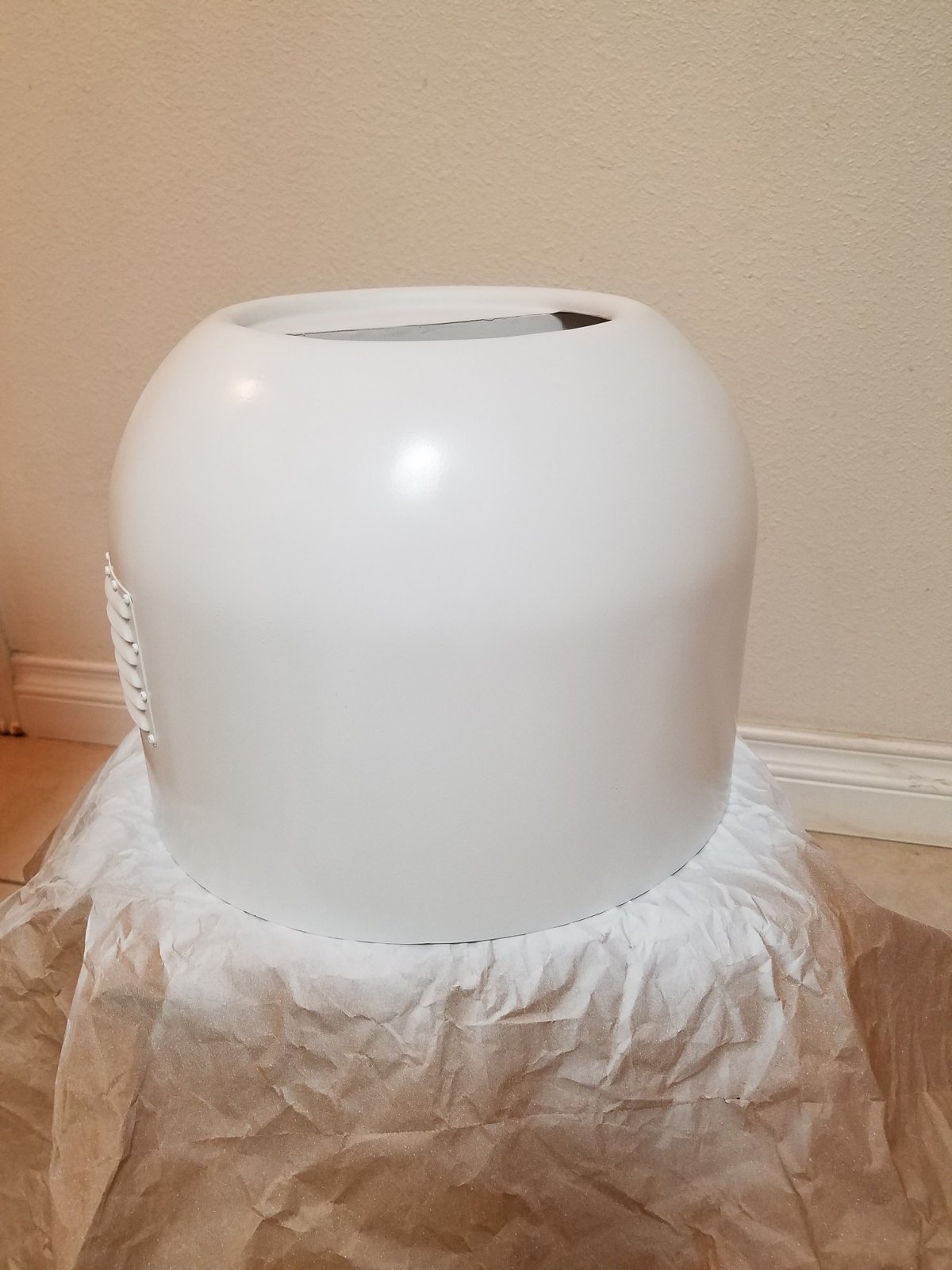

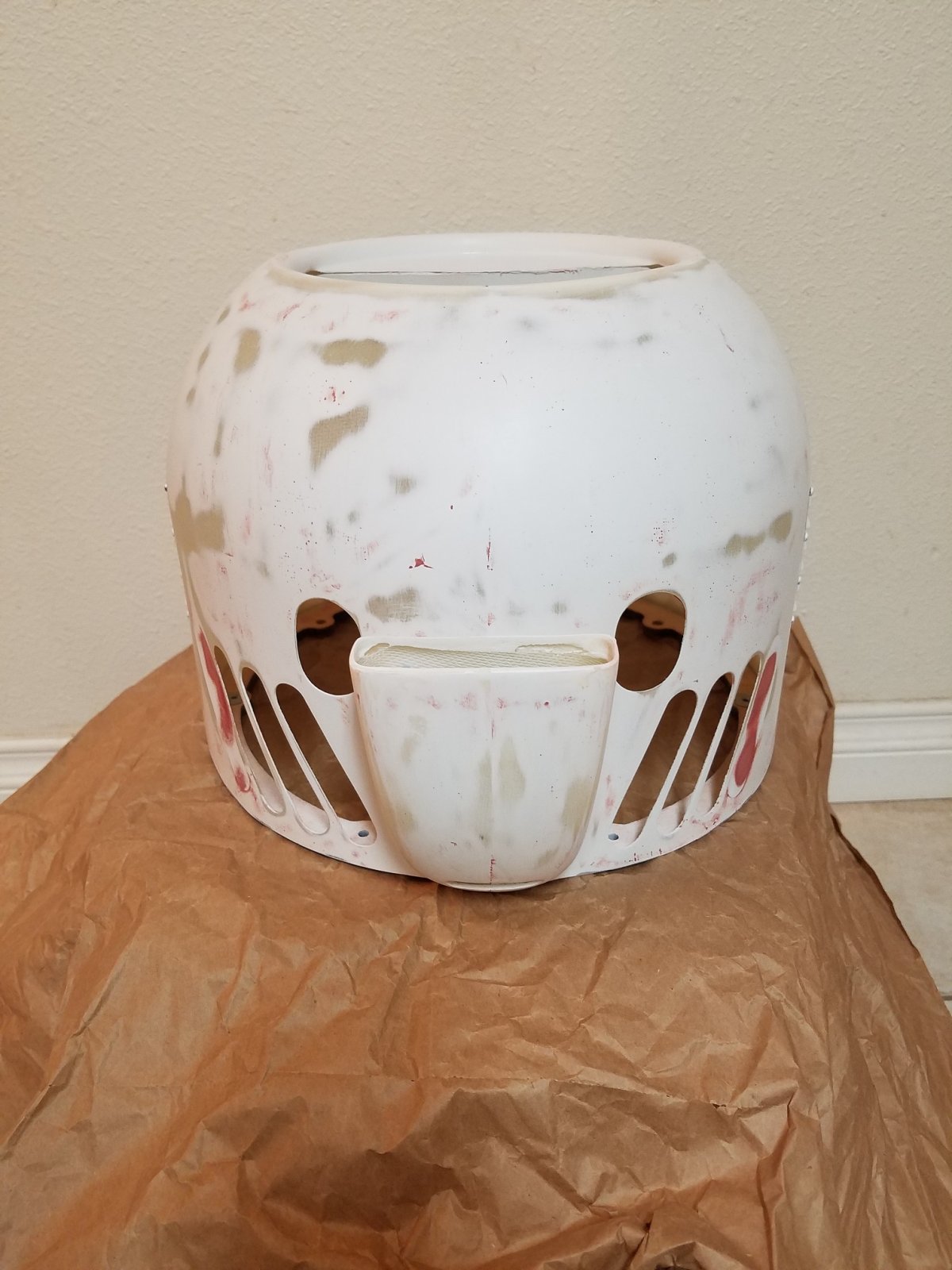

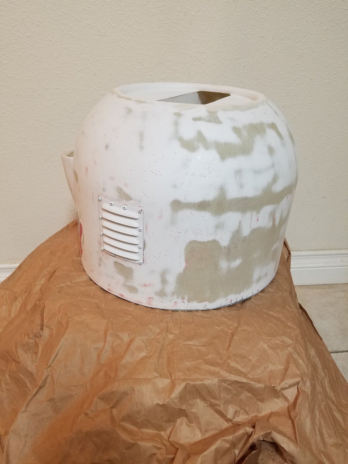

Ok, so where were we before I had melt down number 2? Oh yeah, working on the Pitts cowl paint. Took some time this evening to knock off all the spot putty and get her whipped into shape. I started with 220 "Wetordry". I sanded dry. Then went to 400 grit "Wetordry" and did this one under warm running water. Near as I can tell, it is "MUCH" better than it was.
20170319_231956.jpg 20170319_232005.jpg 20170319_232013.jpg 20170319_232023.jpg
Next up, I will shoot the primer again to see how much I accomplished.

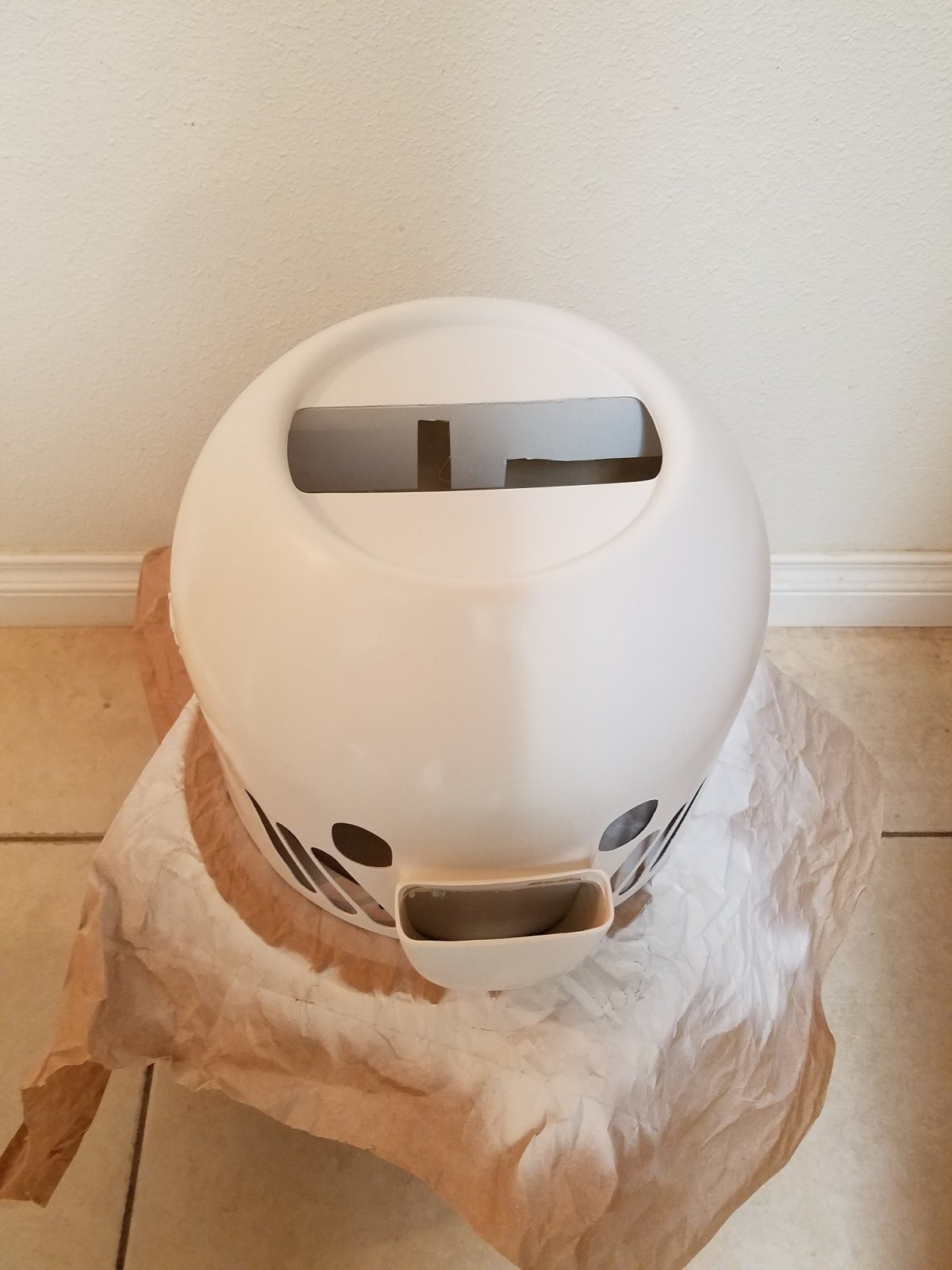

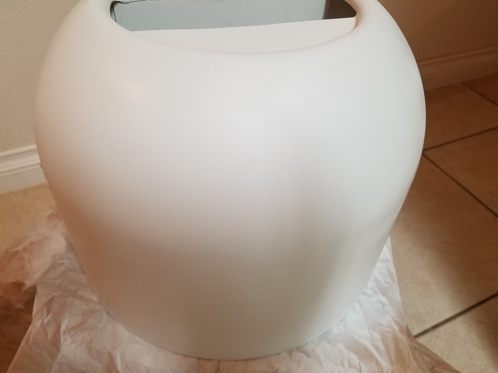

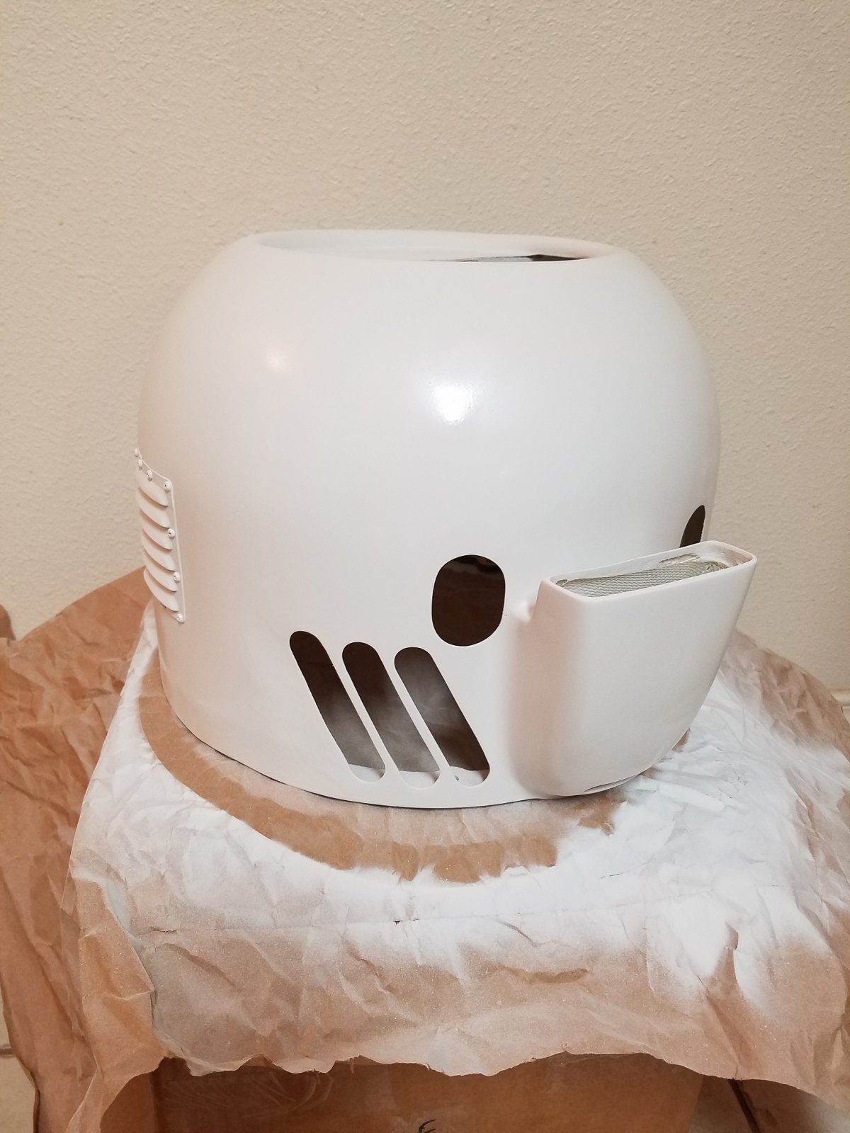

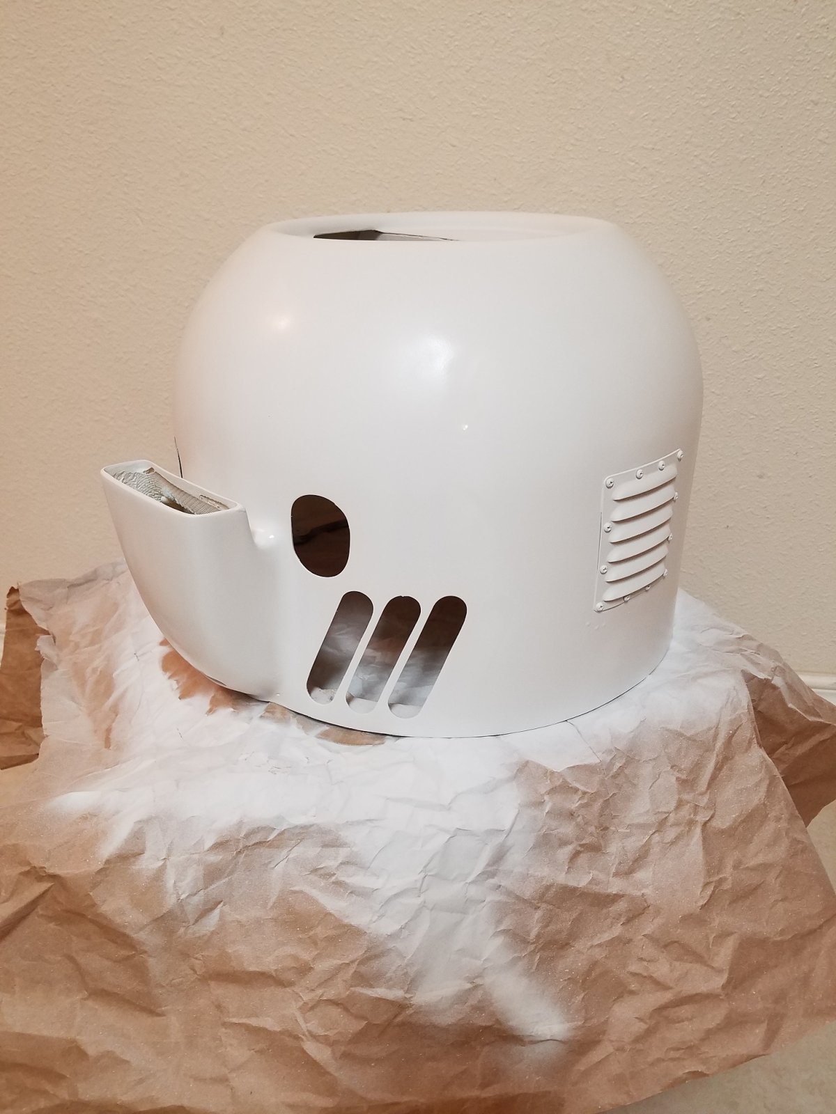

Another warm bath and Alcohol rub down, the cowl is ready for some primer. Before doing so, I brought my thermostat up to 70 degrees. I usually keep it around 60 but figured if I let the cowl and the primer sit in a warmer environment, perhaps it might aid in any attempts to get a better finished product. Don't really know if it had much affect, but the results are only about 1000% better than my first attempt.
20170319_233820.jpg 20170319_233831.jpg 20170319_233840.jpg 20170319_233853.jpg 20170319_233921.jpg
I am actually a tad bit much happier with the outcome this evening than I was earlier today.
This I can handle. I still see "really" up close one spot on the bottom of the cowl that I missed. Not a pin hole pot mark. More like a void in the fiberglass layup. And one tiny spot right on the folded lip of the front face right near the top. But all in all, "I'll take it"! I am probably going to do another real light wet sand with 400. One more shot of primer, then one more "really" light 600 grit wet sand before the paint application.

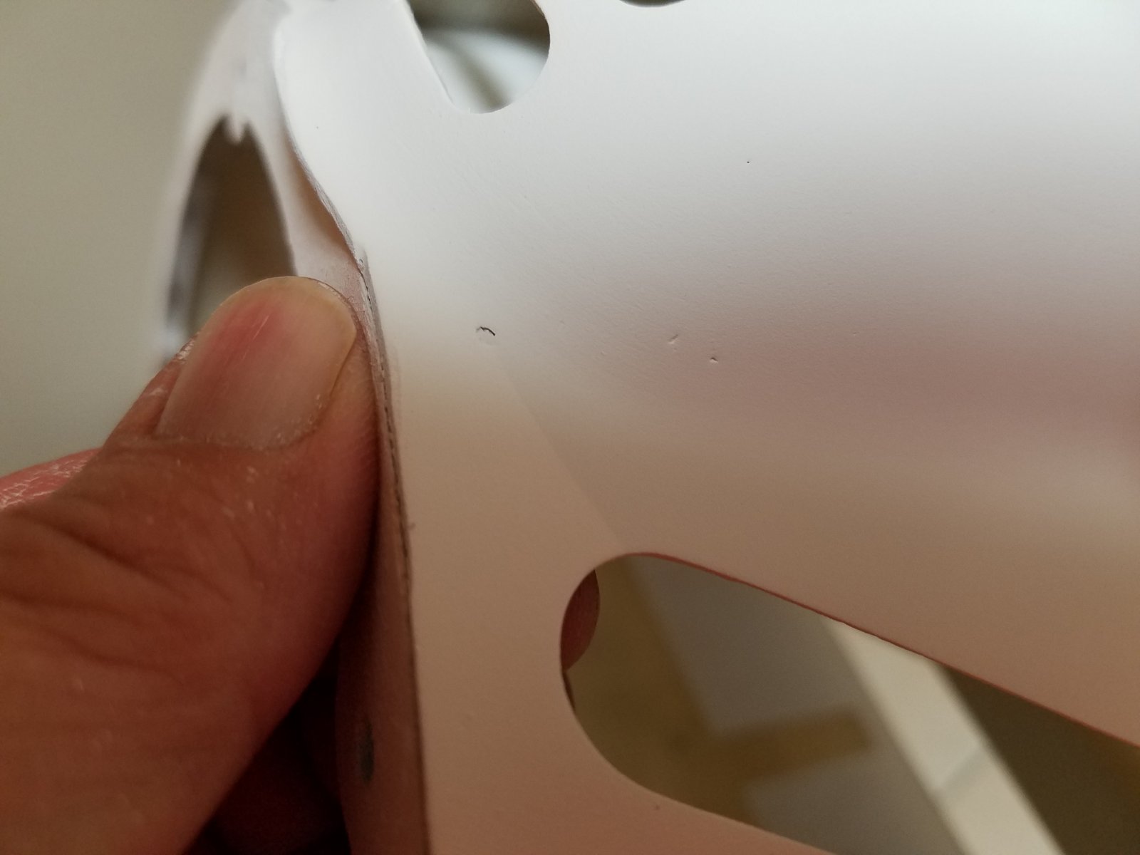

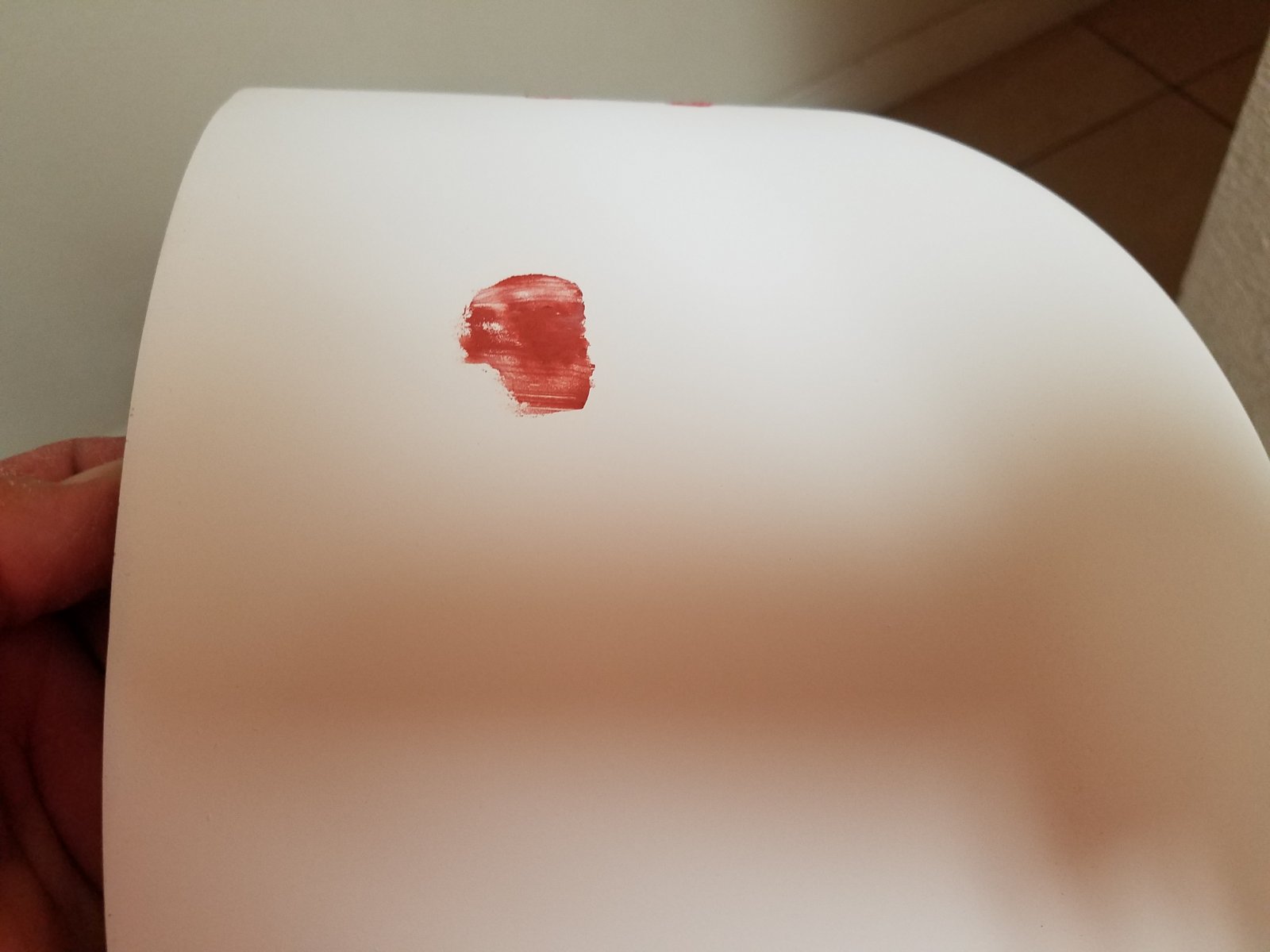

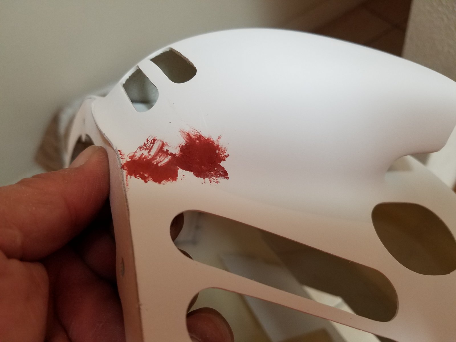

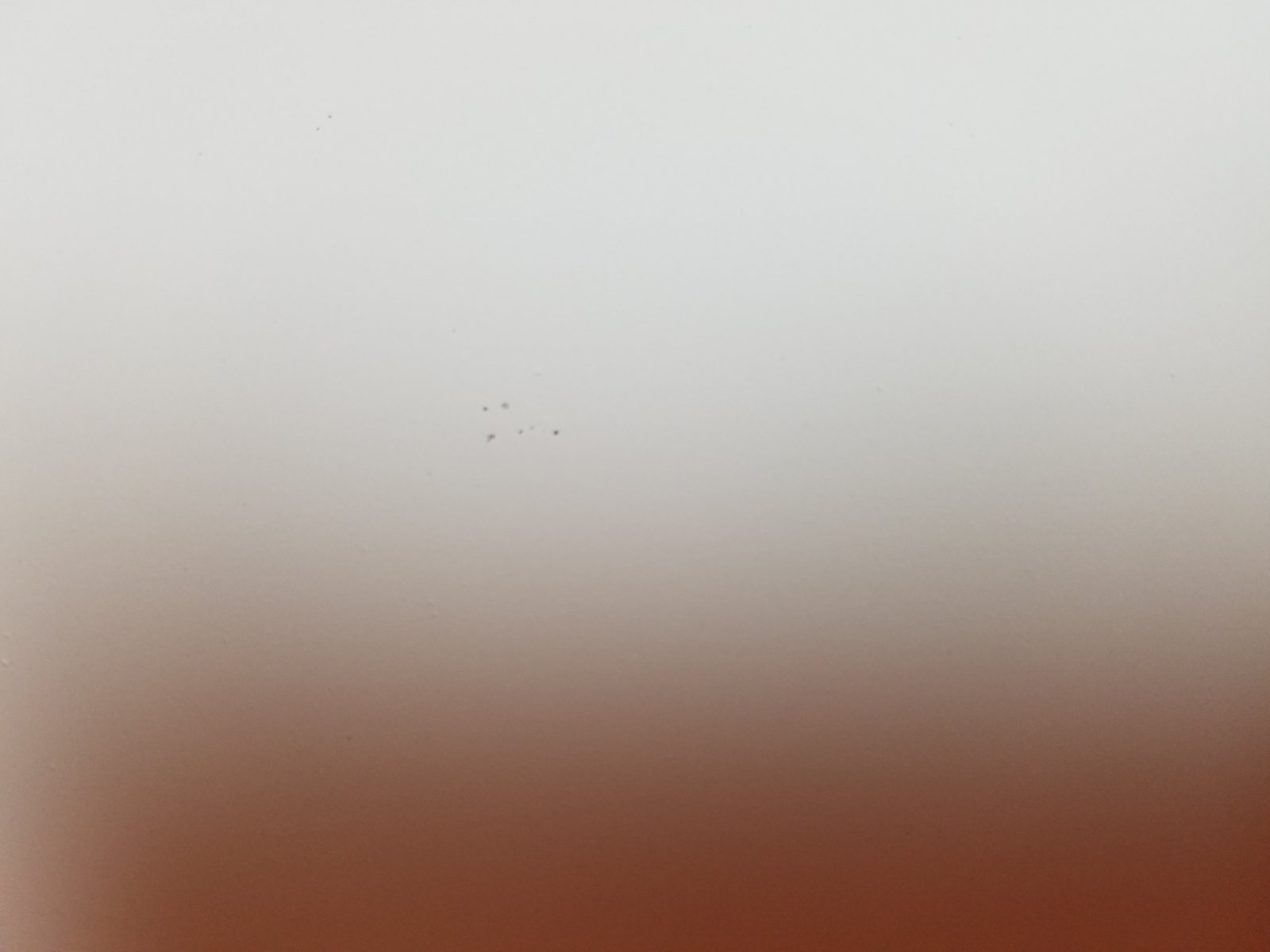

Before heading out to work this morning, I paused momentarily to peek at the Pitts cowl. Lookin' pretty good. The one spot I mentioned last night must have been a reflection. As it is now not there. The other on the bottom is definitely a flaw in the cowl. Somehow I missed it. But easily taken care of. I also noticed on top of the cowl, there is a cluster of tiny little pin holes. Missed those last night. And one vent hole that I plugged has a slight crevis. So a dab of putty on the 3 spots and out the door to work I go. Hopefully my paint shows up today. But after the remaining minor imperfections that need to be addressed are taken care of, I will probably finish those up and let the cowl sit so the primer has plenty of time to cure before I start shooting the paint. Maybe try for later this week. We'll see how it goes.
