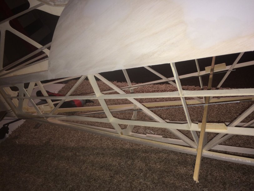

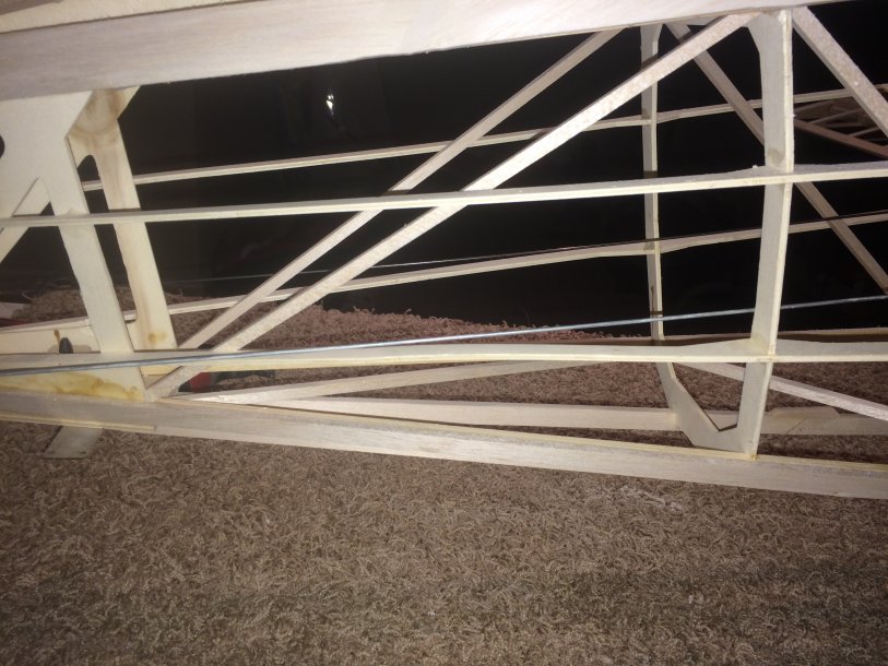

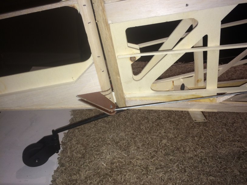

Today, i was working on the rudder horn and how i am going to actuate the rudder. I'm not a fan of pull pull at all, and was trying to put the rudder servos in the tail without them showing. Unfortunately, that isn't going to be a simple method, nor a really practical one. So, pull pull it is.
I'll be using the JR MPH83T servos on the rudder. I'll be running two in an SWB tray. So, to figure out where to mount the rudder horn and where the wires would exit the fuse, and where they tray would sit. I'll need the tail weight, especially if the Kolm 310 4 cylinder 4 stroke is ready in time.
Here's a few pics of the rudder horn and the steel rods i used to setup where the wires and tray would sit.
MattyMatt
So, the last picture shows the stick running across the width of the fuse, this is where the SWB 5" rudder arm will sit.
