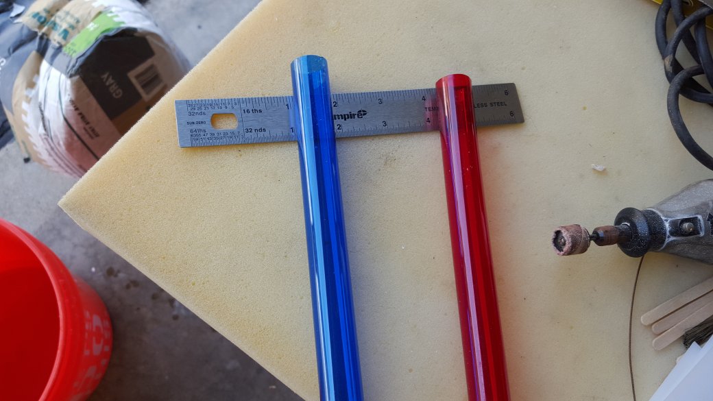

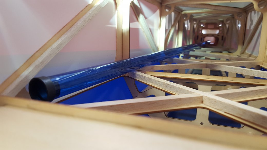

These Pilot RC planes are all tightly X braced up. Really tough to work in (great once you're flying)... so I took @Spats lead and am putting in a tube for my wires to the tail. I wasn't finding anything I wanted until @Tavis said he was trying fluorescent light tube covers, so I got these:

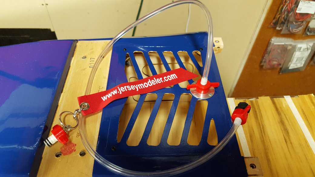

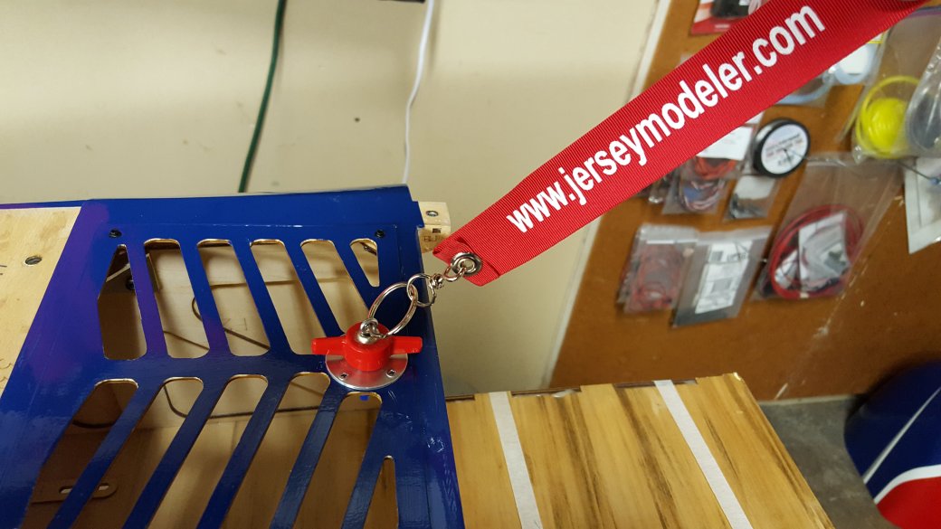

I've known Deano since day one of his jerseymodeler.com business. He's always had these twist connector fuel dots and vent dots, and sets up his fuel cans to work with them. But, I was always into standard fuel dots. Anyway, at my home field spilling gas is against the rules. So, I'm going with the JM system this time:
