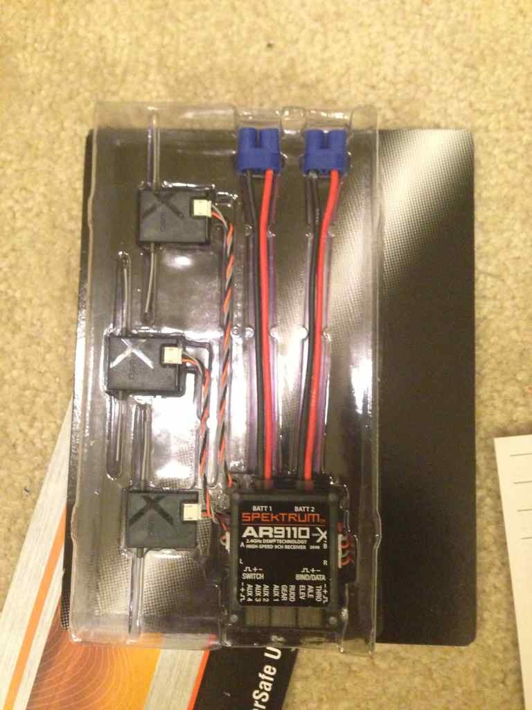

Going to install this tonight, and should have some new, bigger 2s2650mah sky LiPo batts in my mailbox tomorrow :)
