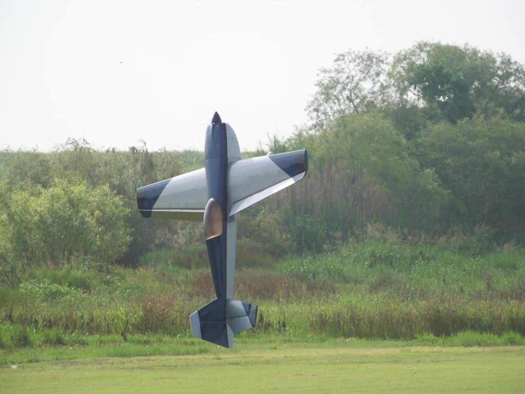

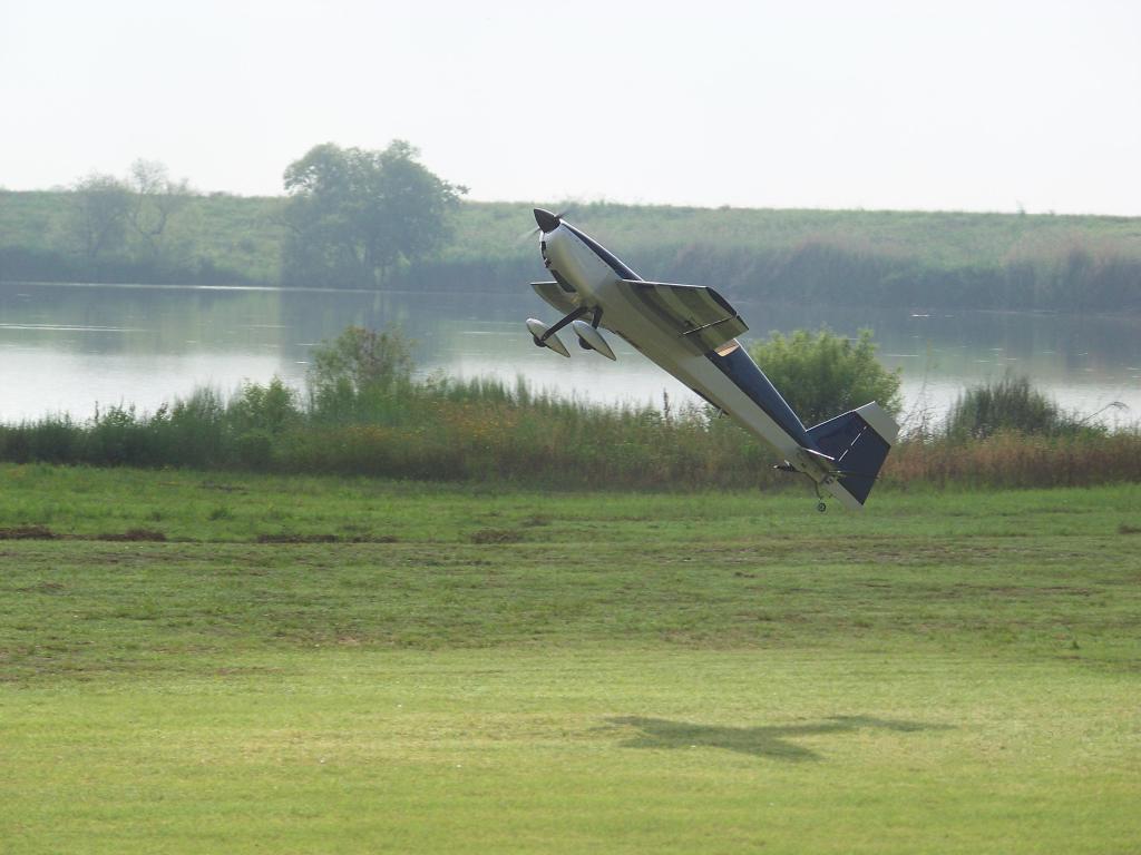

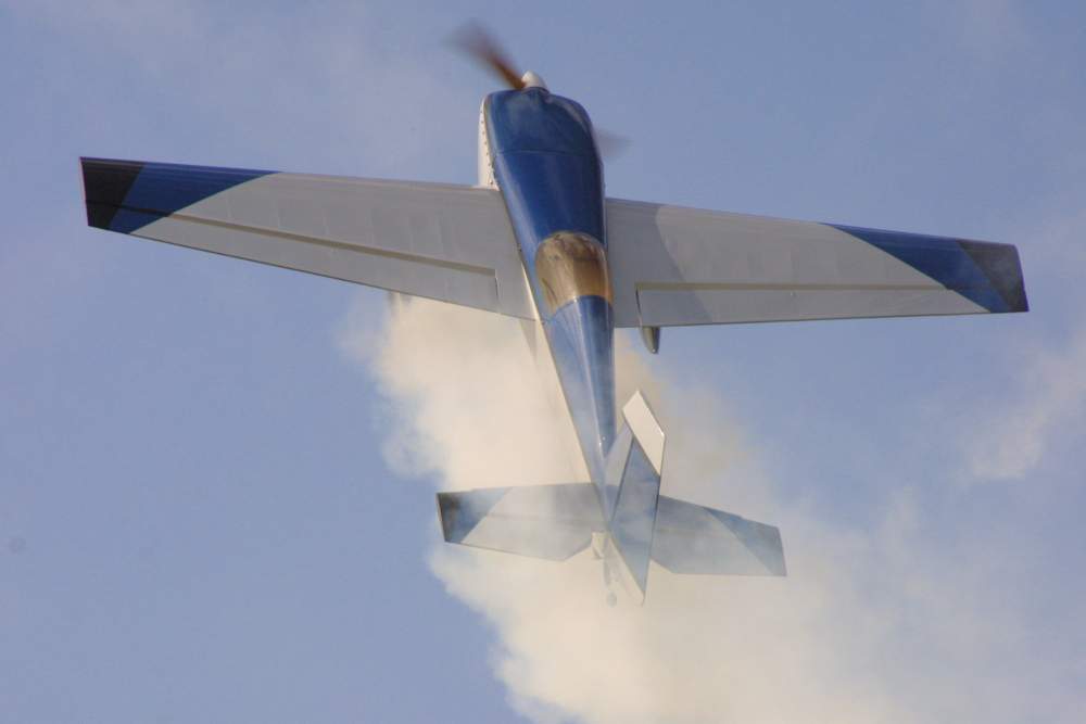

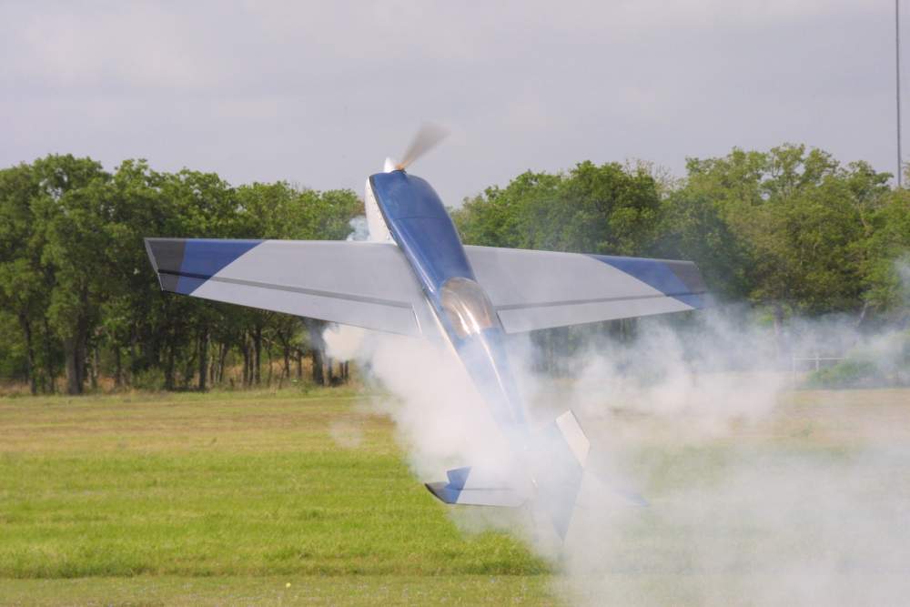

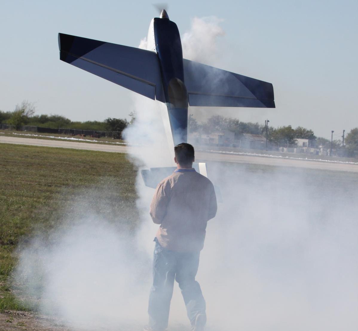

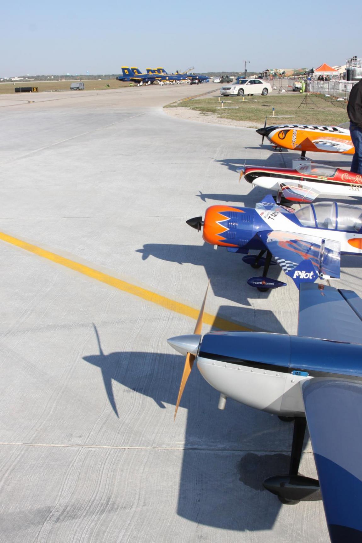

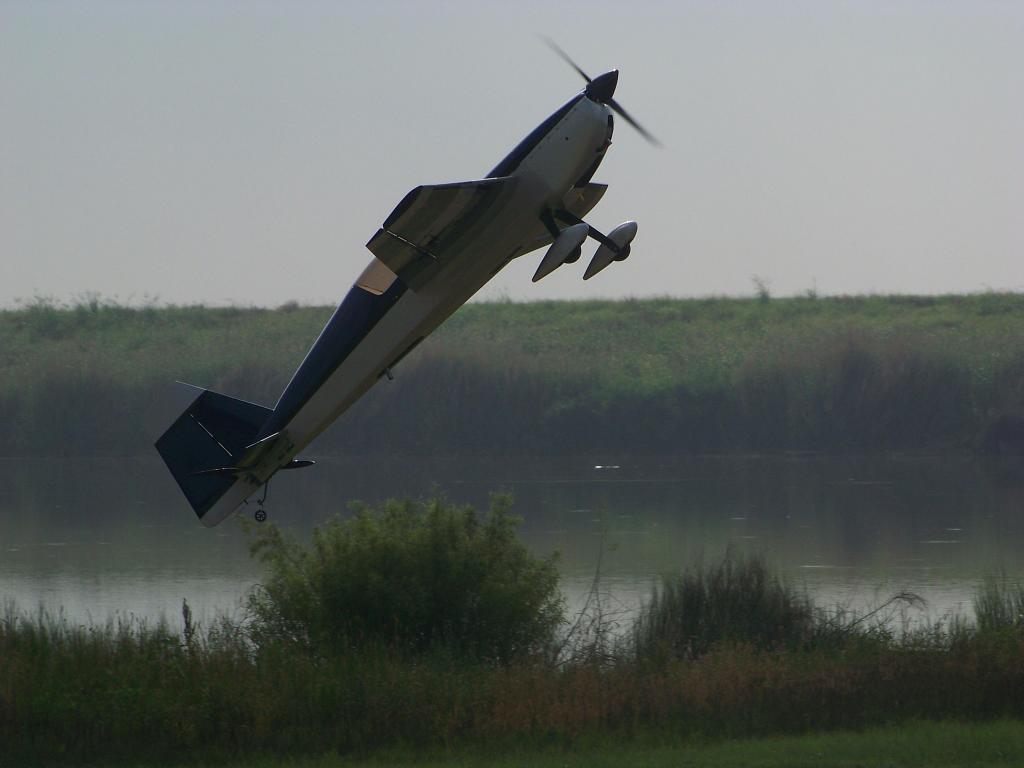

Dont worry about it Gary, I'm sure it will be fine. I flew that plane for a season on regulated LiPo's to 6.5 volts and still had no issues with it. With the 8711 servos I was running at 6.5V in the wings, I was around 400 OZ torque per aileron and it was still awesome. Once I went to HV on them, I noticed a better roll rate at high speed, nothing else. So, that being said, if your servos are putting out close to 400 even know there rated to put out 480, you will be fine with it. You can always change them later or we can add a second servo fairly easy. Here are a few good photos I have of it to cheer you up !!!!

Such a good looking plane :)
