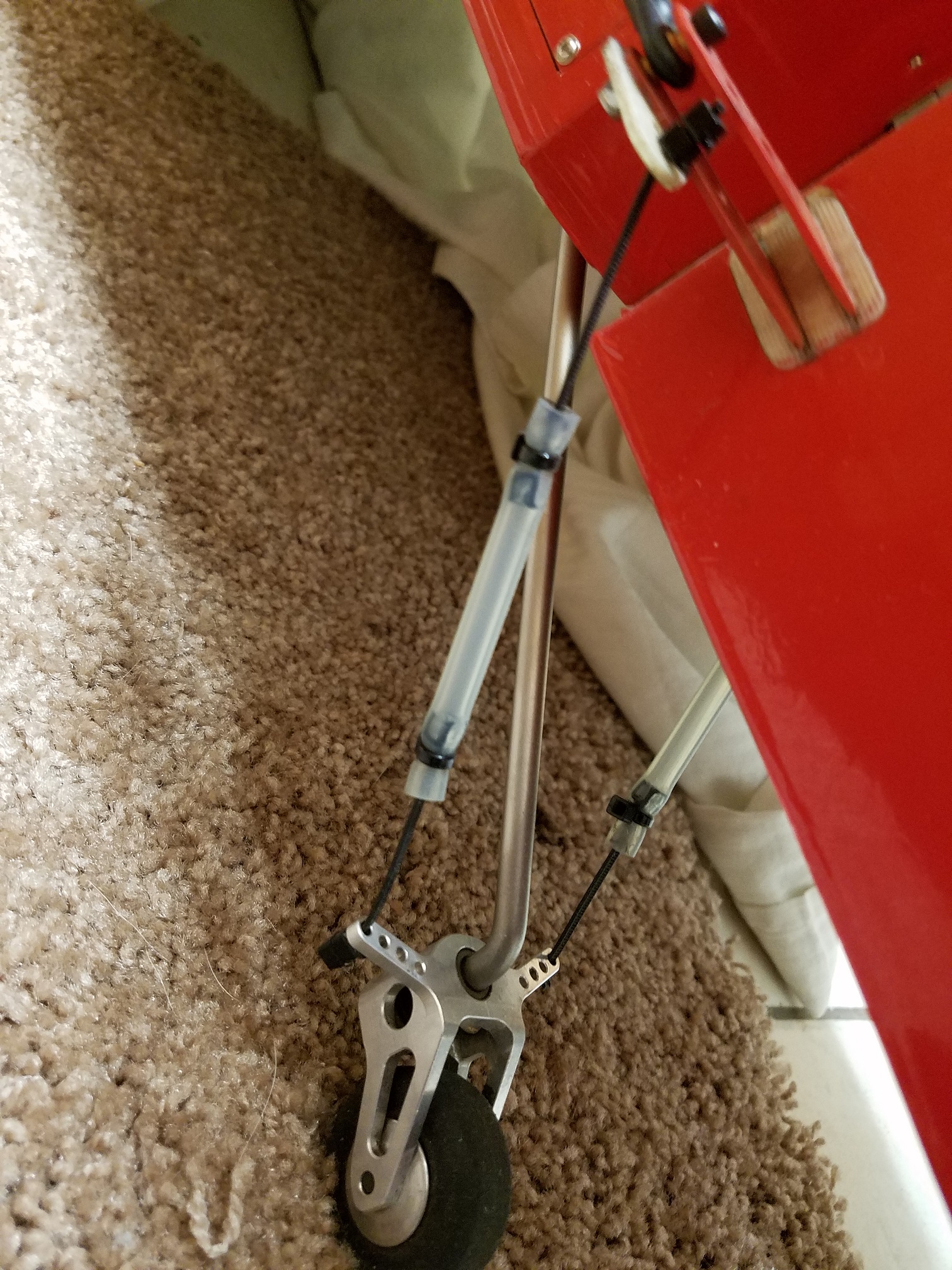

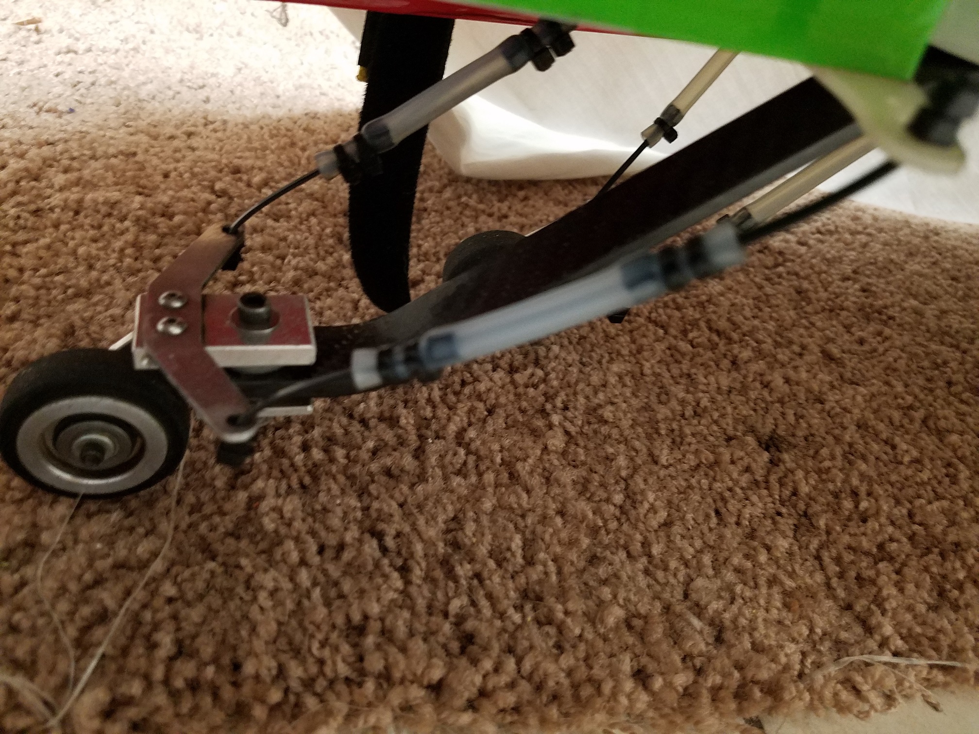

I saw somewhere the other day where someone mentioned the fuel line tailwheel spring thing but now I can't find it. I did one years ago but don't remember how and thought I would shortcut how to do it again. Does anyone have such and if so could you post it for me?

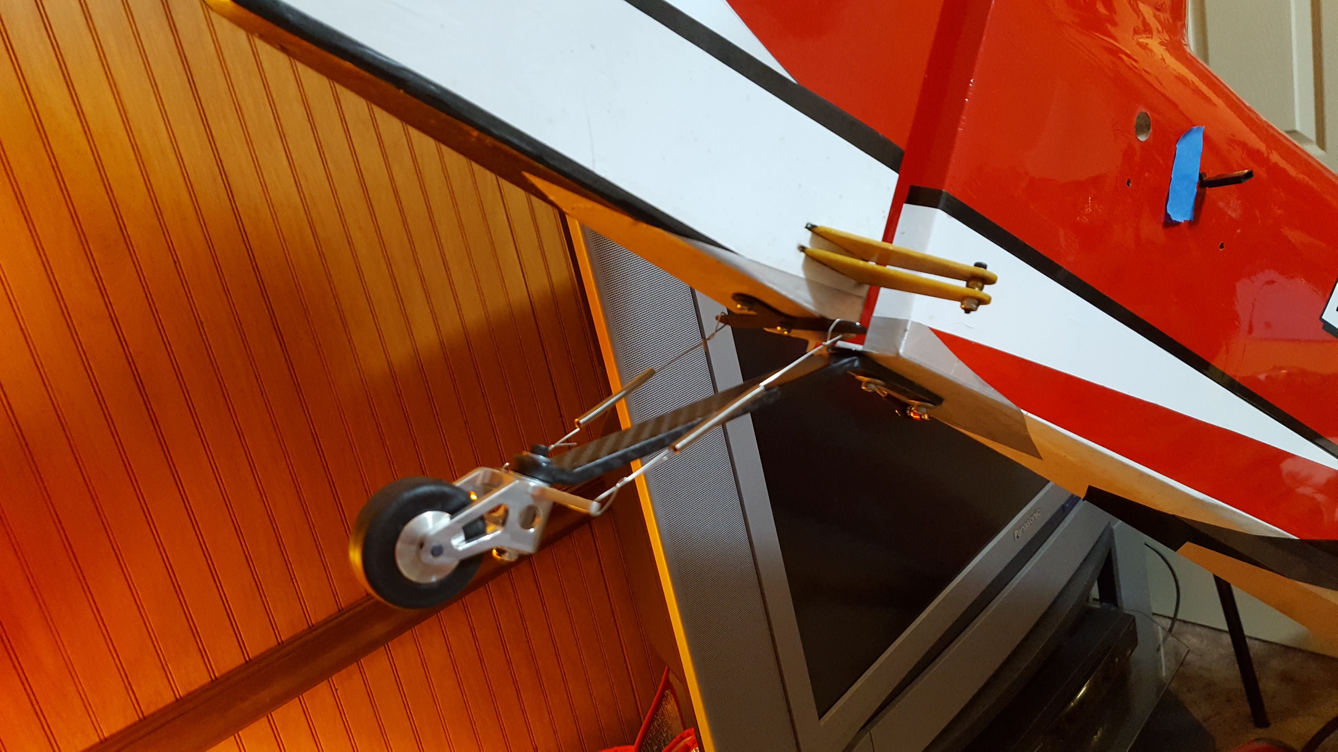

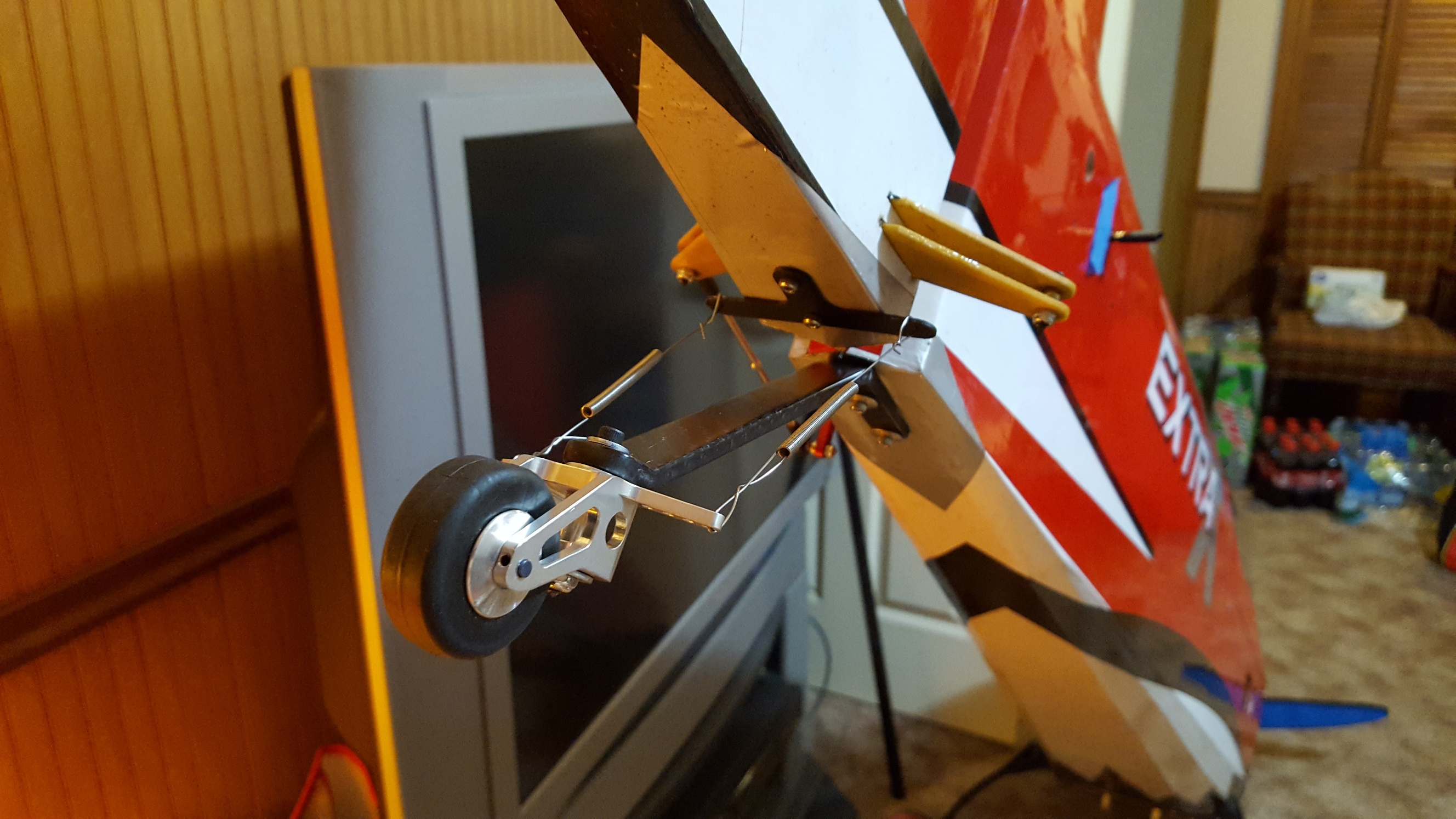

I installed my J&J tailwheel on my Hangar 9 Extra 300X yesterday. I'll probably change the springs sooner or later. The ones that were on it were too short, and these were all I had laying around.
One of the reasons I wanted to change the tailwheel is the tail seemed really bouncy when taxiing lately. It turns out the Hangar 9 carbon fiber spring was broken and delaminating.

Woah...dude. Beautiful. Really! So regarding the springs... I tried and I tried and I tired until I was so freaking furious to keep springs just right on my planes. Baby ate springs like they were going out of style. The Sukhoi simply would not turn correctly. And the Behemoth Yak? Yeah, not happening. I changed over to the nitro fuel tubing and zip tie method. Have not had one single issue. No matter if it is my Pilot Edge at 29 pounds or the Behemoth Yak at 53ish (fuel tank full), they all perform and steer beautifully. Don't think I will ever go back to springs, (if I can help it) again.

This is how I do mine.
