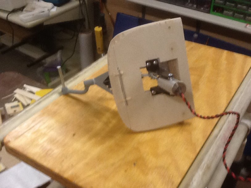

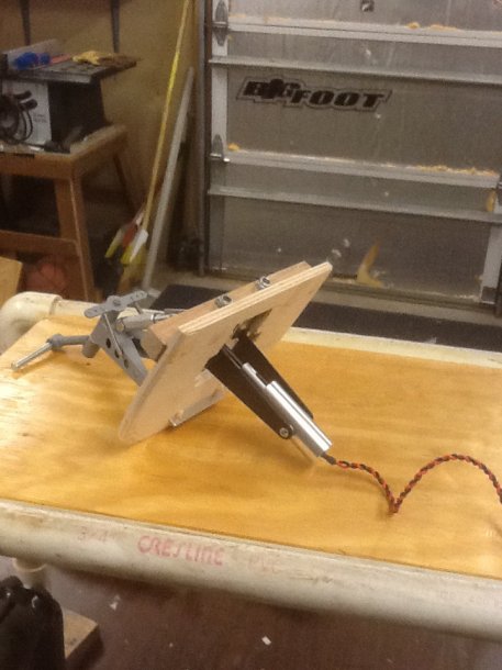

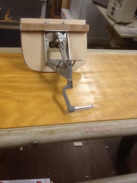

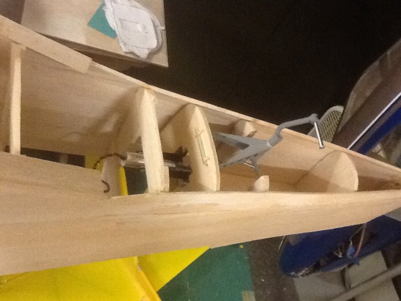

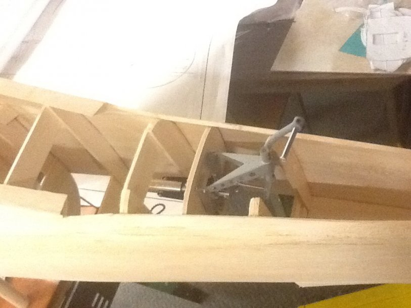

Here's a pic of the retract in the tail. The engineering on the mechanism is understandable but a little strange because one flange faces forward and the other to the rear. I had to come up with a unique way to install it since I used 1/4 inch plywood instead of 1/8th. I'll post some pics of that later.

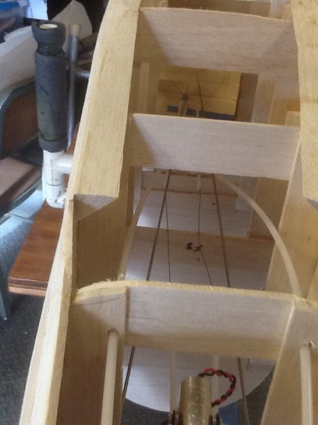

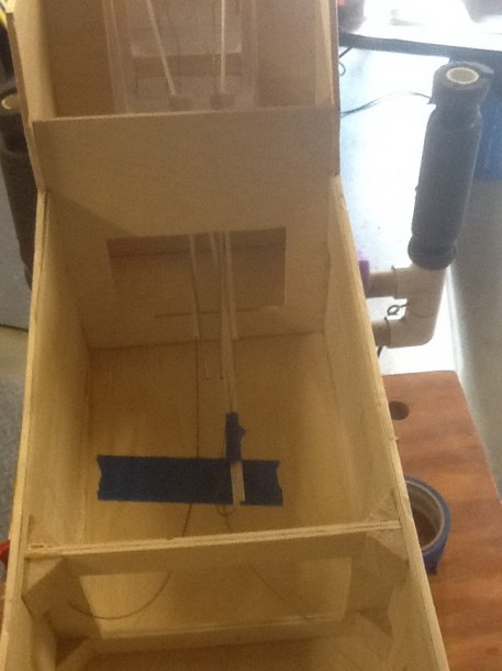

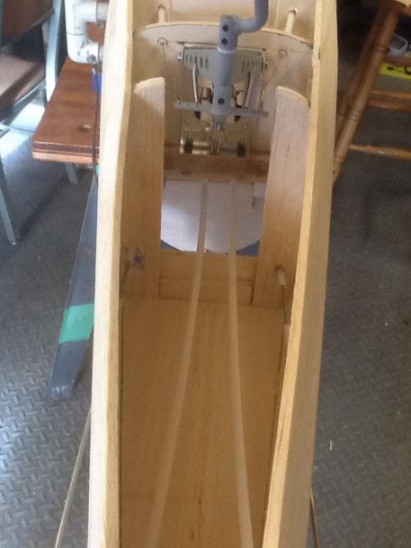

I've installed the control rods into the fuselage. I'm using pull-pull on the rudder and tail wheel. That took 4 rods. Then I used 2, 48 inch, 4-40 rods for the dual elevator control. Getting those long rods to move smoothly and come out even 4 feet away in the servo bay took me all afternoon. But you Can see in one of the photos that my efforts paid off. They came out within a reasonable 1/16th.

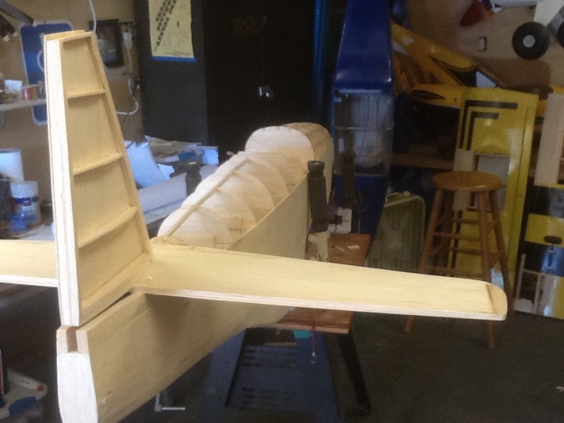

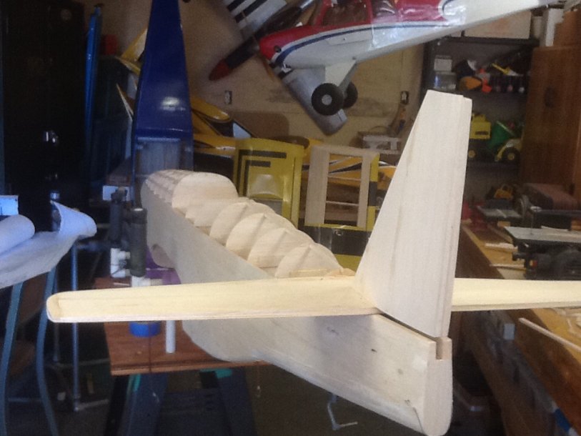

Little more work on the tail. This has to be finished before I can move forward with the sheeting of the top of the fuselage.
