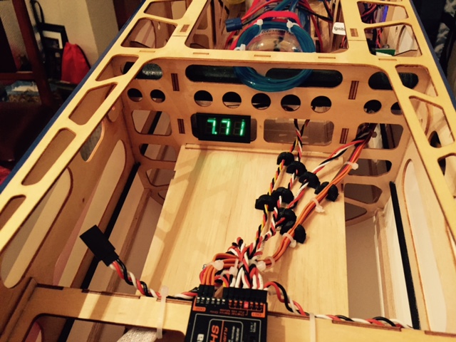

Thanks Terry I am hoping to maiden it this weekend. Right now the 25.7 oz Propel (round) tank is in it (see below). I have the Fiji 32 oz standing buy as well and I did buy the SWB tank fitting for a 24 oz Dubro that I may or may not use for reasons like you mention.
I need to maiden it quick as I am going crazy. Between work, family travel (grandkids birthdays) and winds I have not yet got it up. In a week I am leaving for 2 weeks in Asia for work to boot.

Don't worry, he's got that voltage display onboard i was waiting to give him crap about;). Seriously though, good luck on the maiden. The 70 takes a few flights to really come to life, you will love that combo.
And it will suck a lot of gas those first few flights.
