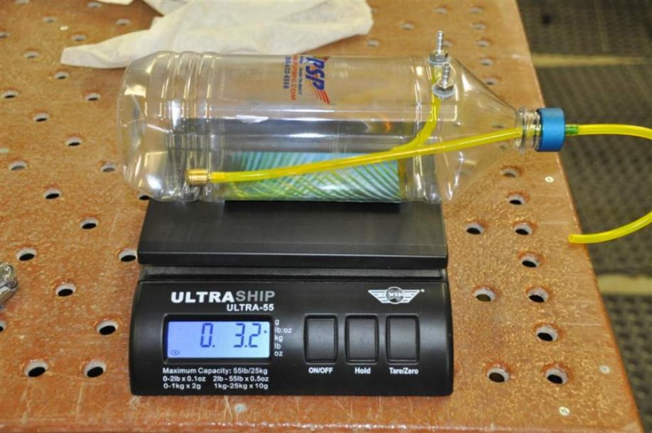

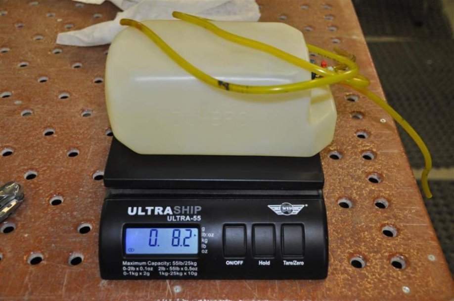

Terryscustom
Now I am not debating the merit or weakness of each of these just as you should not say "Big weight Savings" for the use of a water bottle tank over a Dubro tank.
Gasoline weighs .77oz. per fl. oz. If you have too much left you don't have the right size tank. It is a necessary part of the flight so weight on take-off is irrelevant in a proper sized tank. On my 70cc planes I land with roughly 4-5oz. after my timer goes off. A water bottle tank in the 32oz to 50oz size vs. a dubro tank is about a 60% weight savings so absolutely yes the savings is huge.
Sorry but the rest of your list is purely user preference, some of them I completely shake my head at as well.

Terry are those both 32 oz tanks? You should pull the extra two Tygon lines off the Dubro to be fair though. But I have never implied they would be equal and am not making that argument. I fly 24 oz tanks as I do not merit the extra flight time of the 32 oz. That's 8 oz of savings for me.
Ounces are ounces. You care about enough ounces you get a pound or two. Of course I shelled out the bucks for a magnesium da200, so my perspective may be a little warped....That cost me $650 bucks for 8 ounces over the lightened 200. So for me saving 5 ounces for the price of PSP cap is a no brainer.
Ohio just put 8 ounces less gas in the water bottle, nobody says you have to fill them up.
