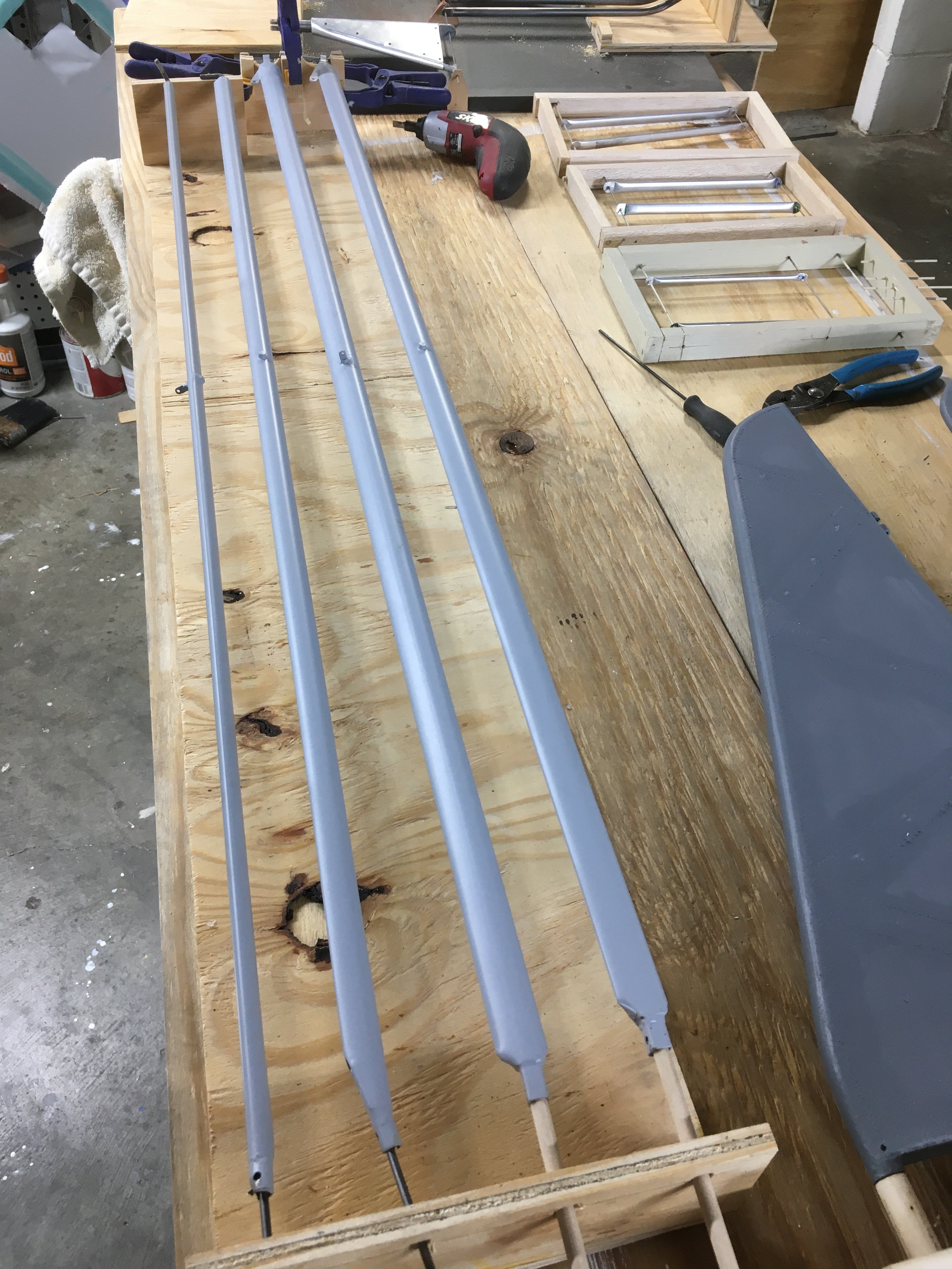

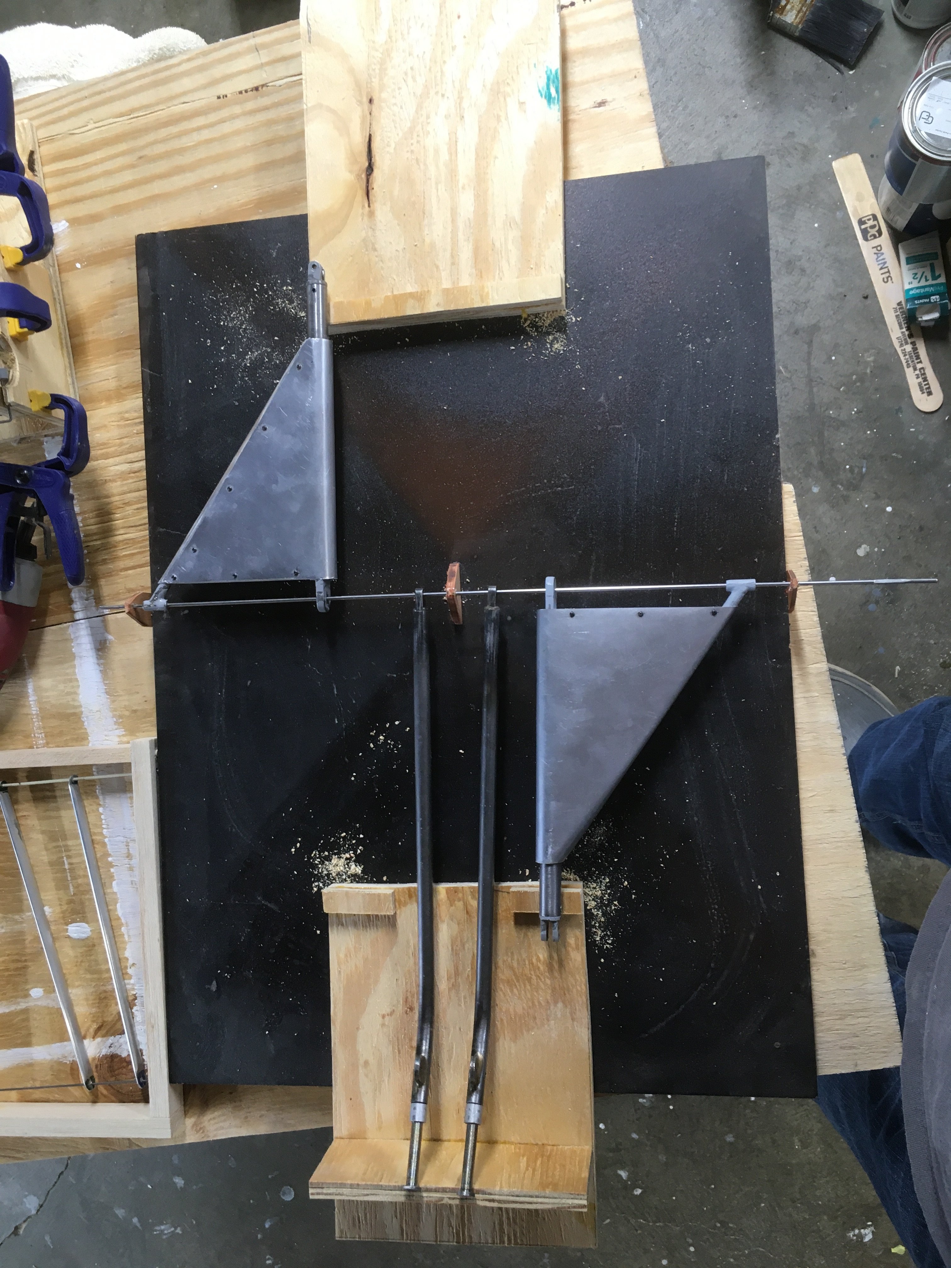

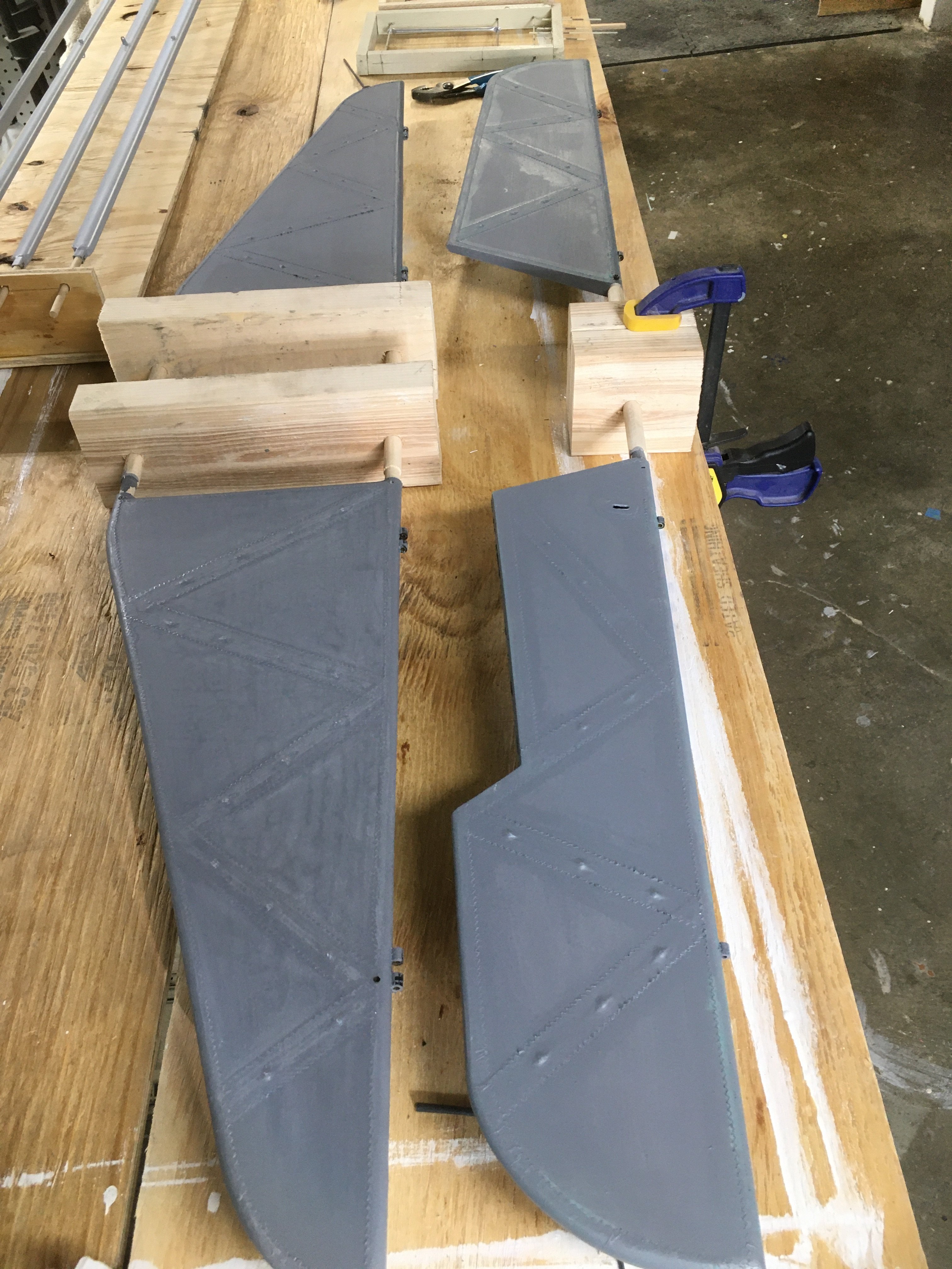

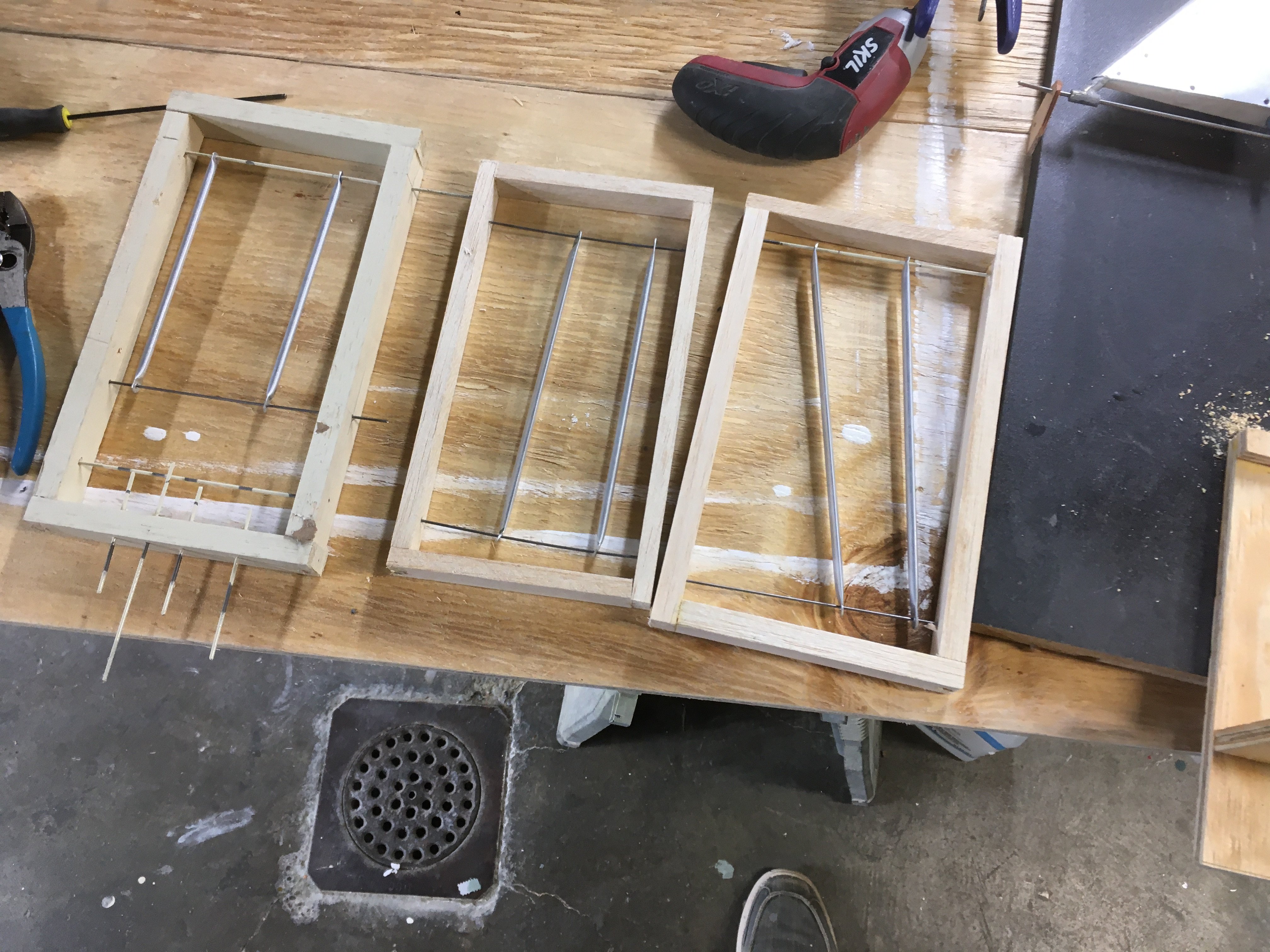

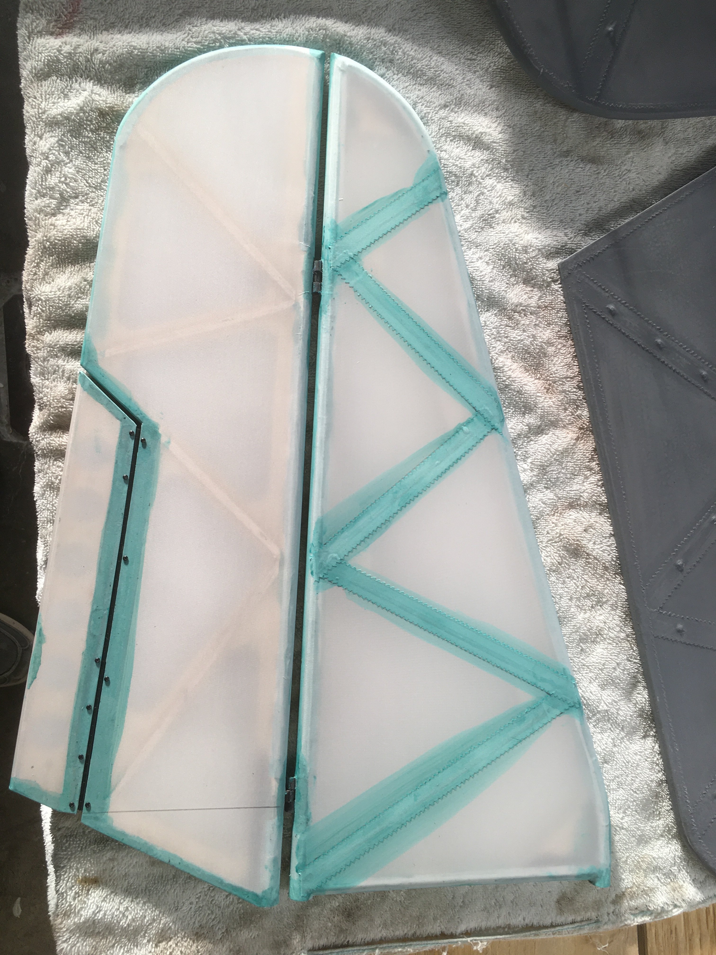

  2. Spent the better part of the day making fixtures to hold the small parts for painting. Getting warmer north of the Mason Dixon line, 60's next week! Just might get some painting done. Still need to make fixtures for the rudder and cowl. IMG_1202.JPG

  5. My phone said 18 f this morning, was too cold to go out and check if it was right. Weather improving this week. Might dust some primer on the cowl and start that process, there's quite a bit of massaging done to it so I expect two or three rounds of primer and sanding. This will be done with Rustoleum automotive primer surfacer. Once happy with the finish will use 1 coat of Stewards Ekopoxy primer on all the fiberglass and aluminum parts before the color coat.
