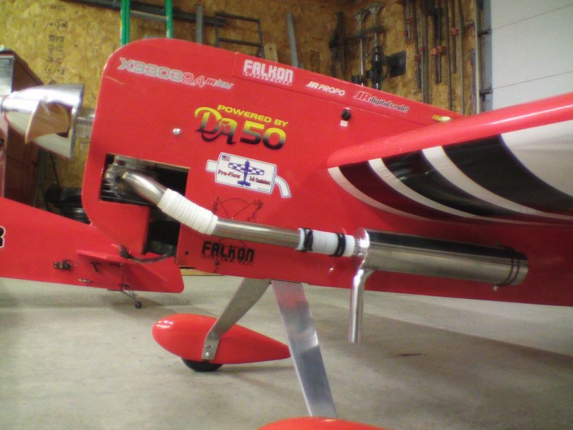

Eventually tried one of sullivan's canisters and that toned down the noise a bunch. i really enjoyed this airplane. sometimes i wish i still had it.
