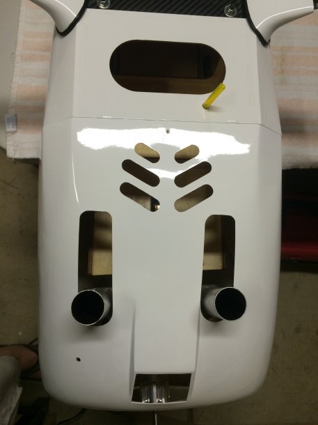

Here's the exits on my 104 EF. I also added a little air spoiler just ahead of the big hole that isn't pictured

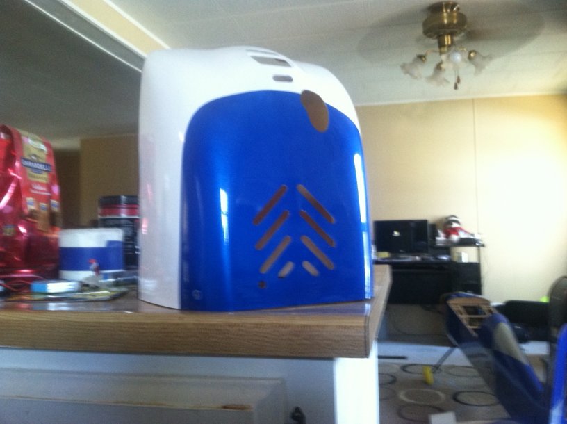

this is what i did to the bottom of the cowl. instead of cutting out a hole, i scored it and turned the "lip" downward, to create a negative pressure air dam. this will help extract the hot air out of the cowl, at the same time, it is not a big "ugly" hole on the bottom.
Does that make your plane climb at higher speeds, or is there no effect?
