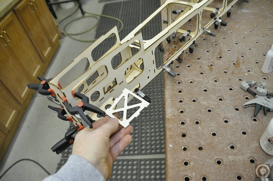

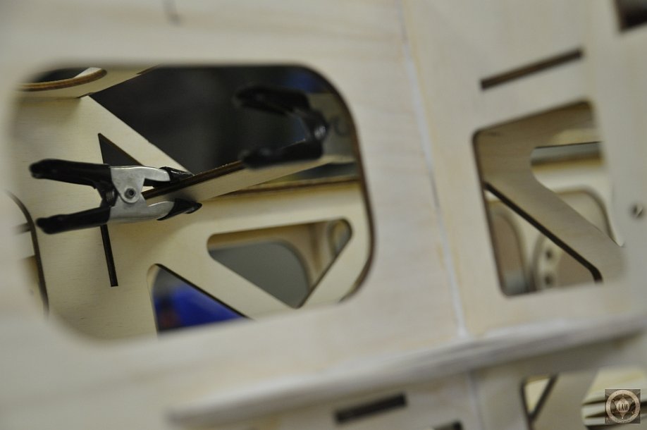

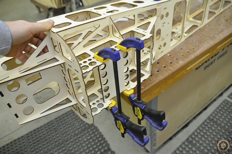

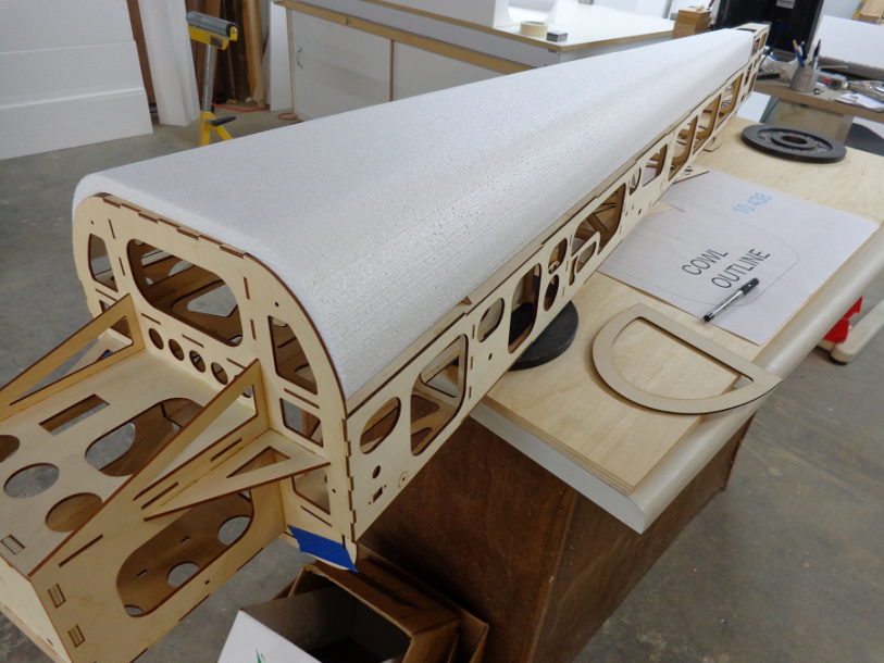

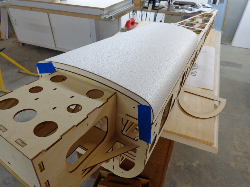

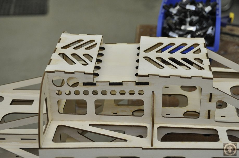

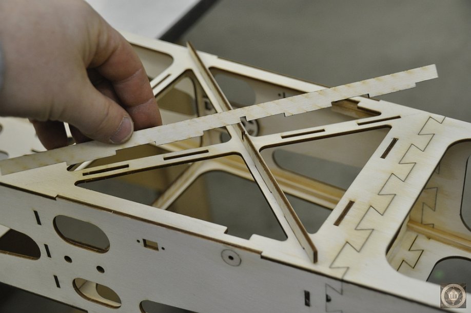

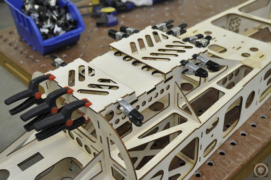

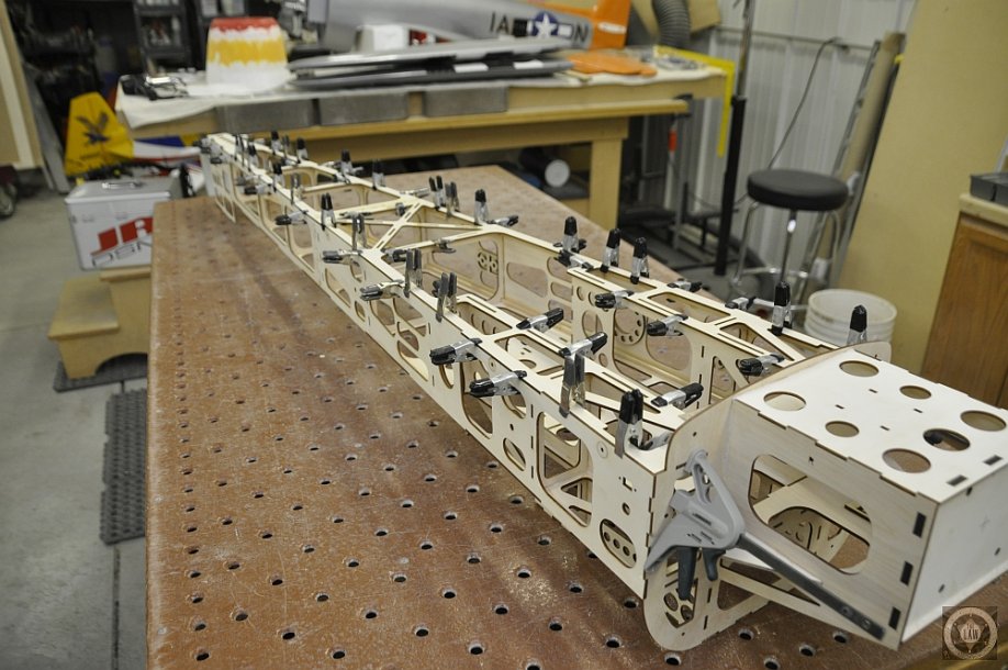

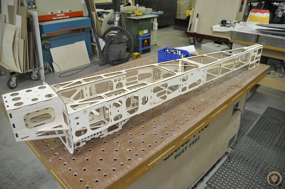

I got a little more done this morning but now I need to pay the bills for a few hours before I can get back to it. Fuse sides are installed and fuse top is test fit. I don't think I can say it enough, TEST FITTING is very important before gluing every part! Also want to point out (maybe brad a bit) that I have not used a flat table. When assembled as I show the fuse is perfectly square and straight, or if you are the super engineering type that measures down to the thousandths.......it is more straight than pretty much any ARF.

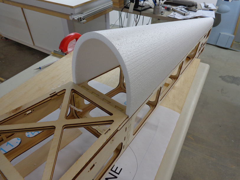

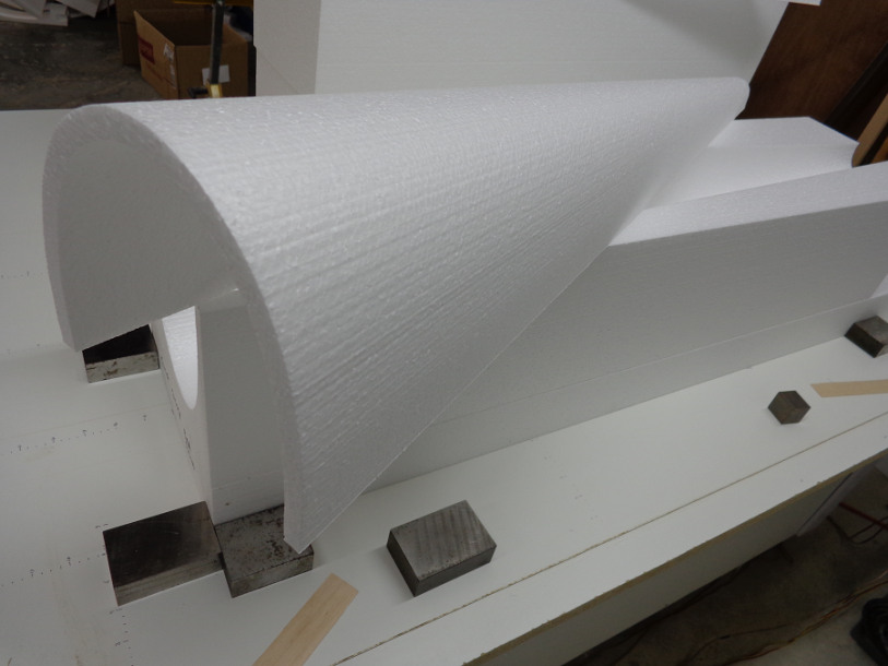

Rick at @Fibertech is working on fine tuning the foam for the MXS-ST. He does simply amazing work with top notch quality:yesss:

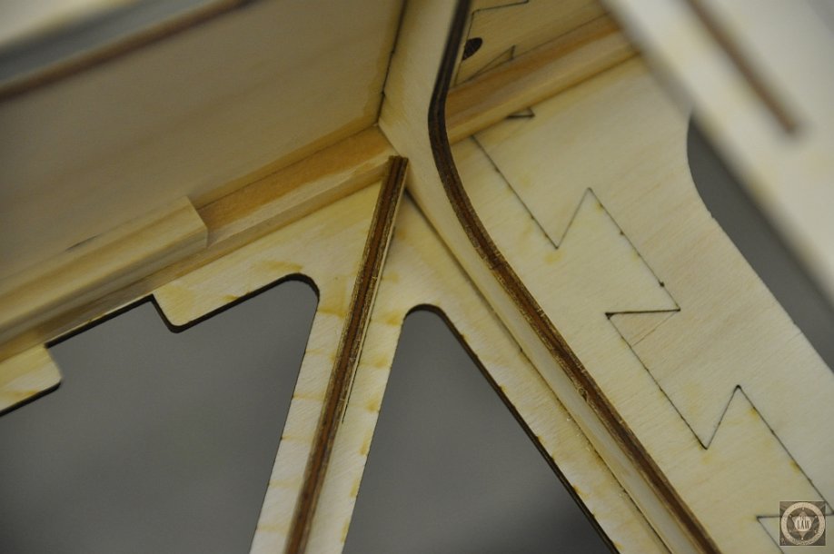

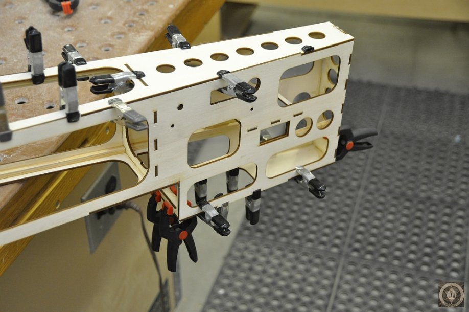

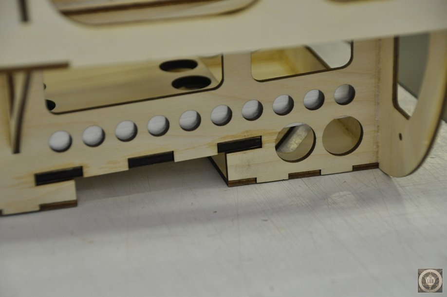

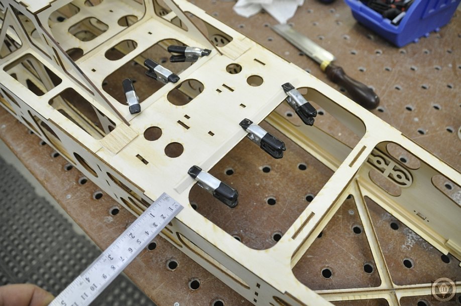

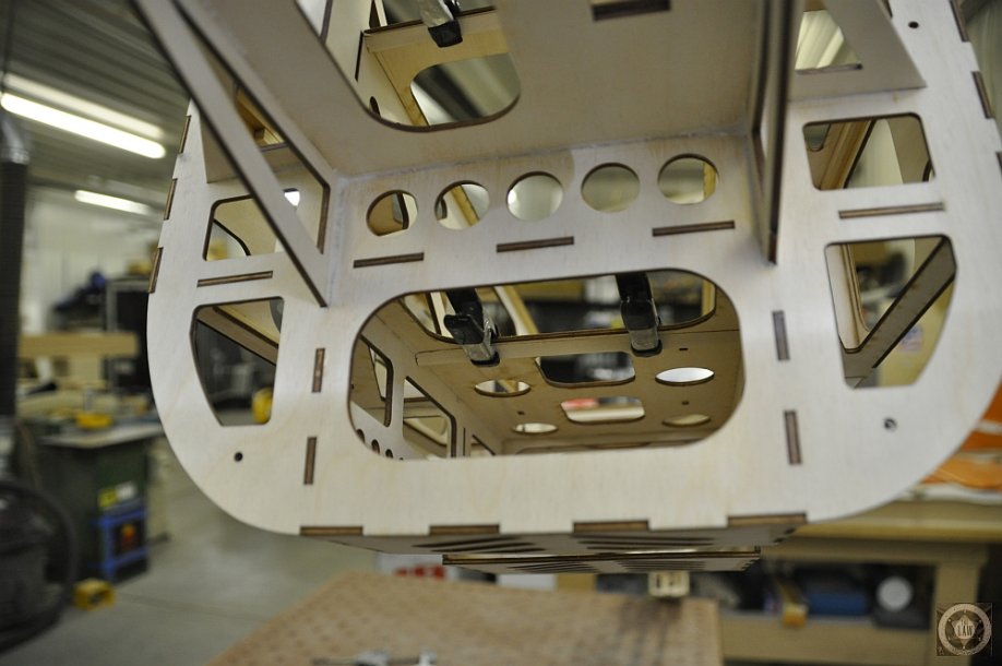

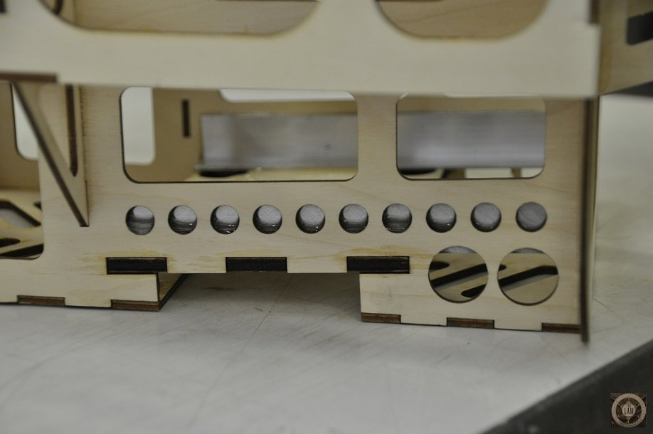

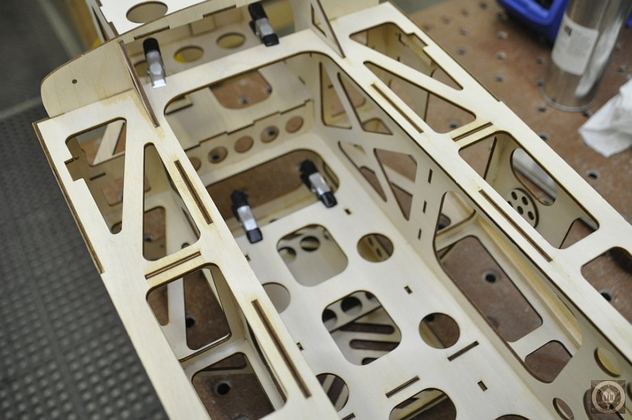

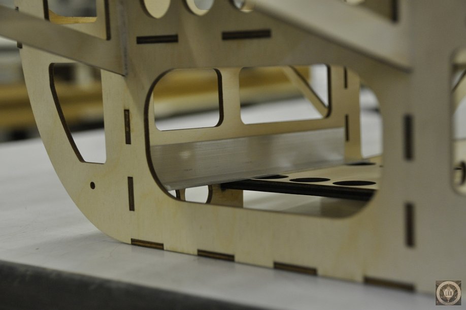

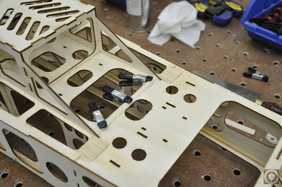

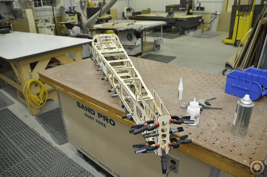

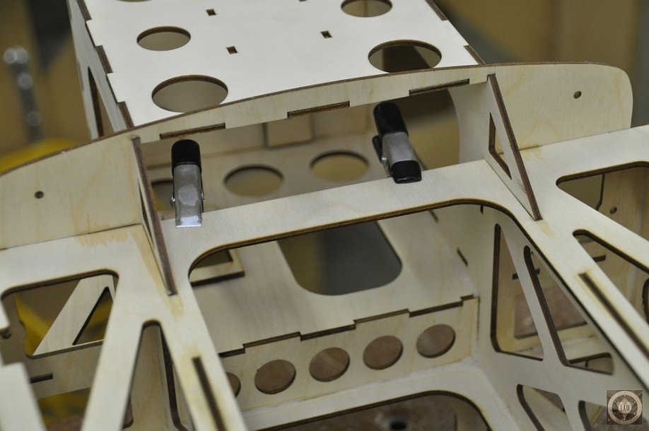

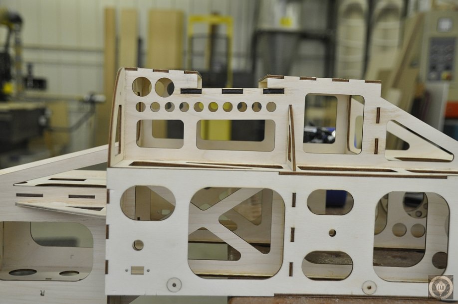

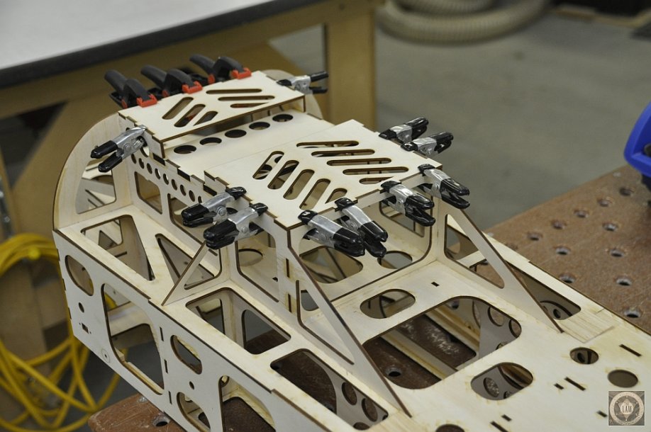

Alrighty, work is done and gone......back to the fun stuff!!!

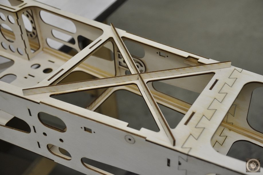

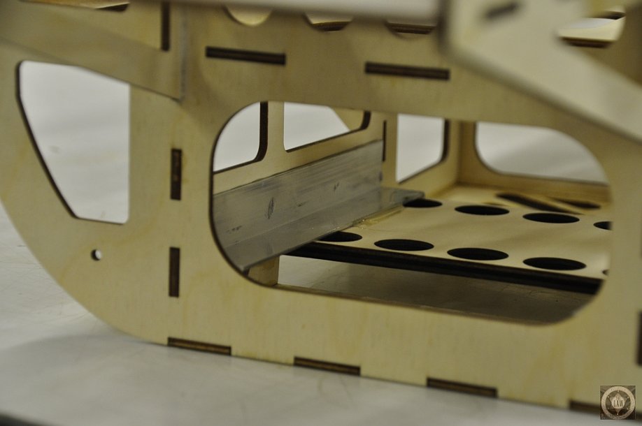

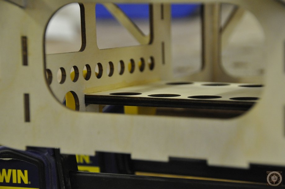

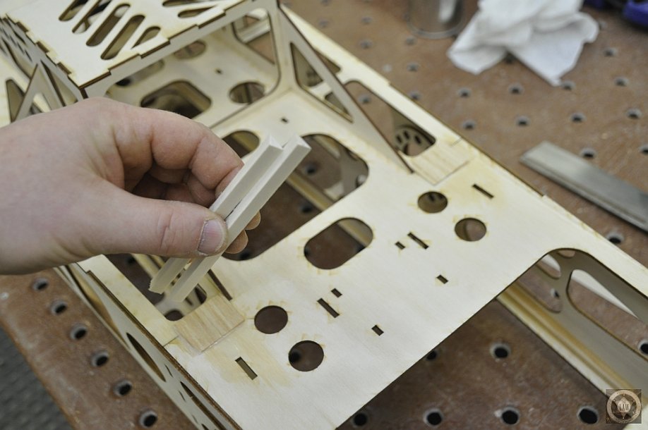

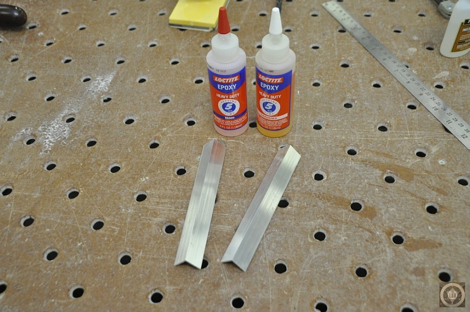

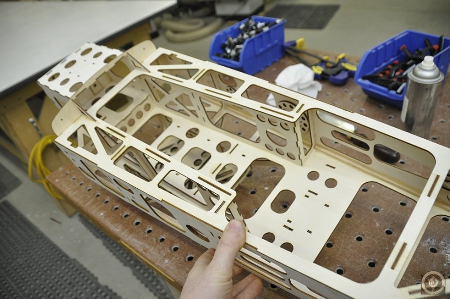

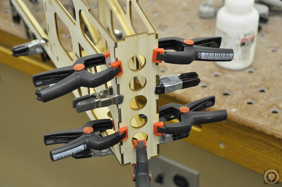

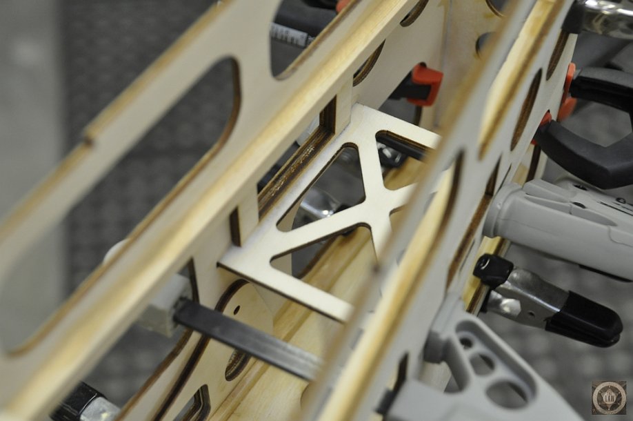

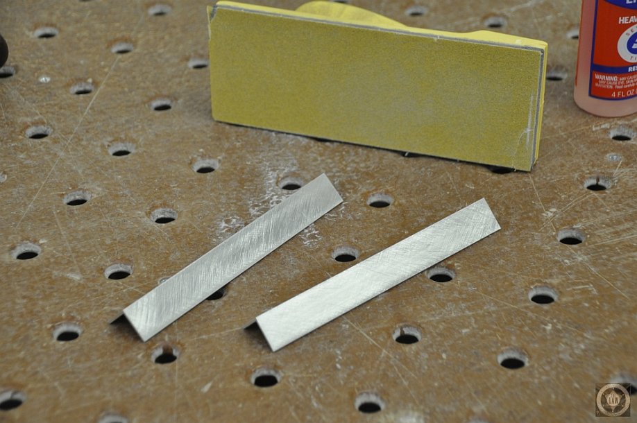

Wrapping up the rest of the fuse parts, a little tri-stock to support the fuse bottom by the tank, RX and battery tray and front. Install landing gear and bottom vents. Epoxy in landing gear aluminum brackets. Install X-brace in top of fuse.
