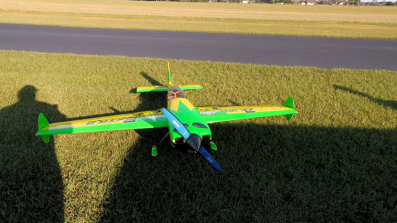

    Yea...….After about 50 flips, and defeated, it was time to go home and soak my shoulder in a hot shower and sulk. I did fly my jet though:). I know what's wrong. Needles are rich from "running new" during the summer and the canister is way to small for this engine but it is the only size you can fit in to the airframe with out compromising structural integrity. Poorly designed "pipe tunnel" for an airframe of this size. A pitts muffler may be in order if I can't gut the baffles inside the canister.

    Before you try to get to the baffles you may try just replacing the stinger or exit pipe to a size bigger. Don’t know how many chambers it has but will be difficult to get to all of them. Let’s us know how you make out. Instead butchering the canister it may be easier to just to install a Pitts type muffler.
