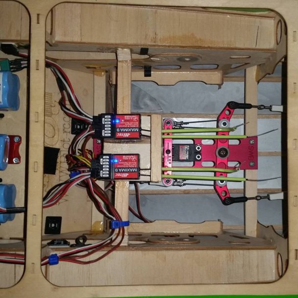

I have went away from the SWB tray due to centering issues. Once I linked the servos, game over, dead on centering every time. I may have needed to tighten the linking cables more but, hind site is always 20-20 :) It was nice to get rid of the extra weight also.

I have a dual SWB tray in my Yak and it's dead solid as far as centering goes. I think some of it comes from the servos needing to be sync'd to each other, as well as how tight the pulley setup is.

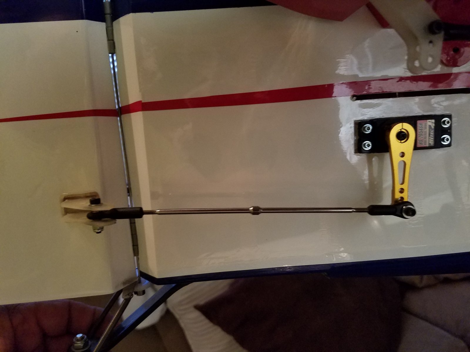

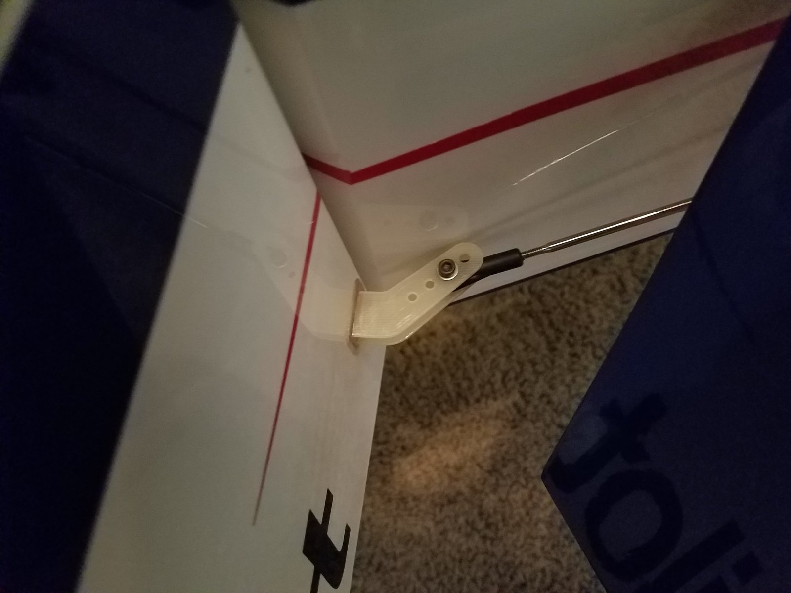

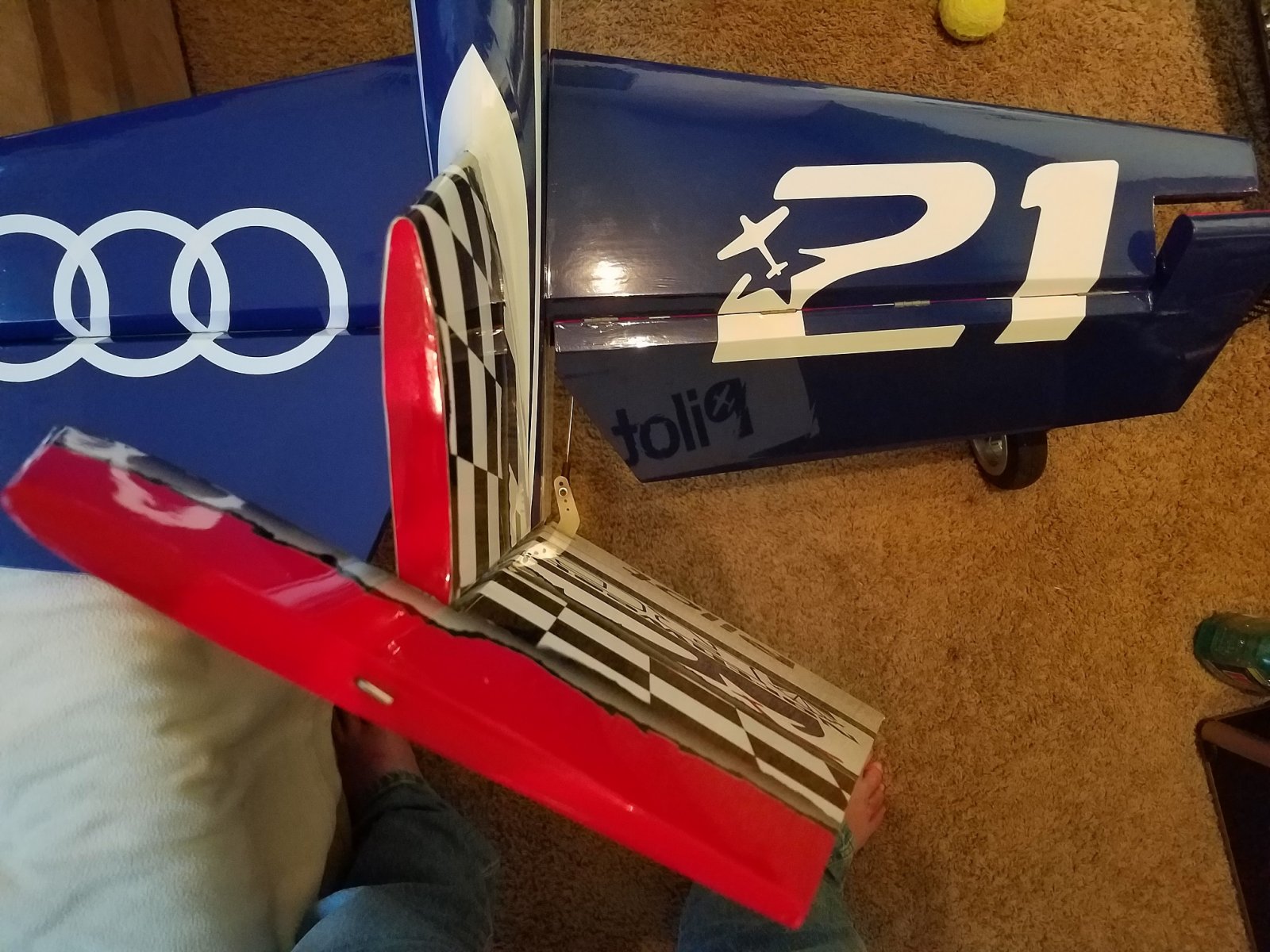

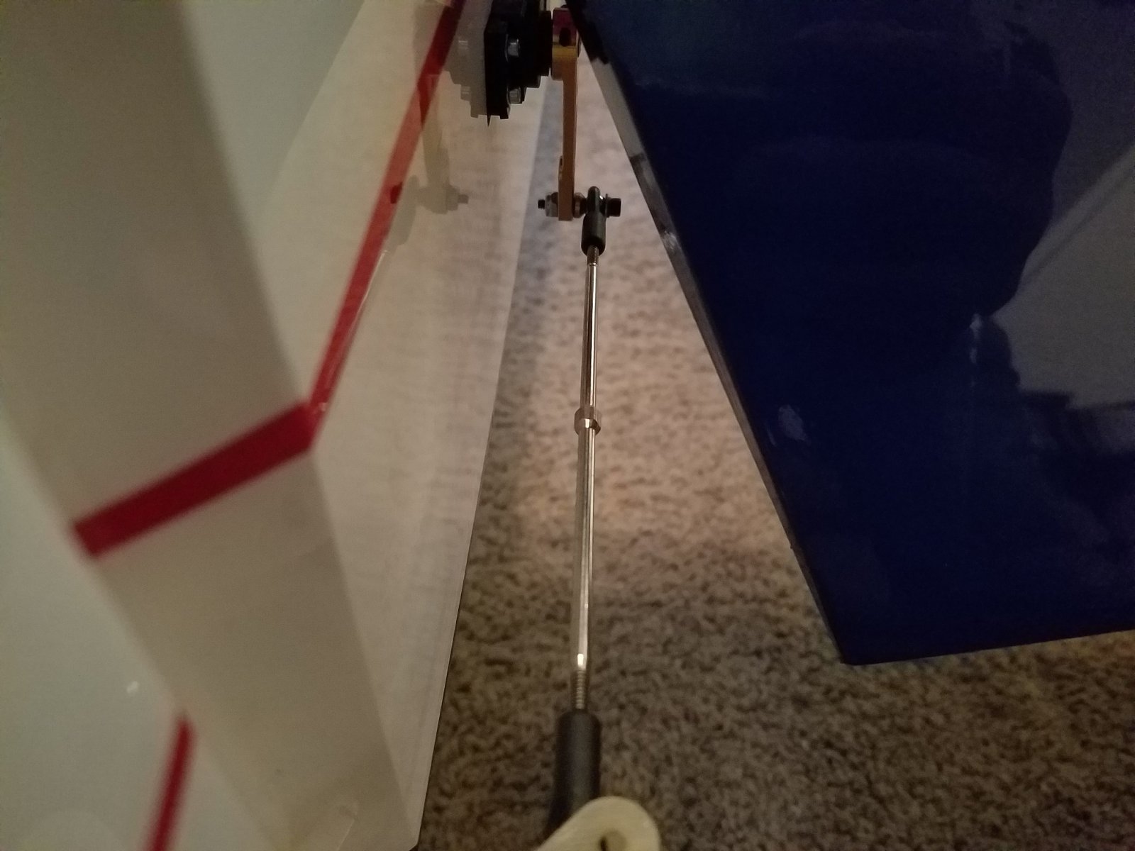

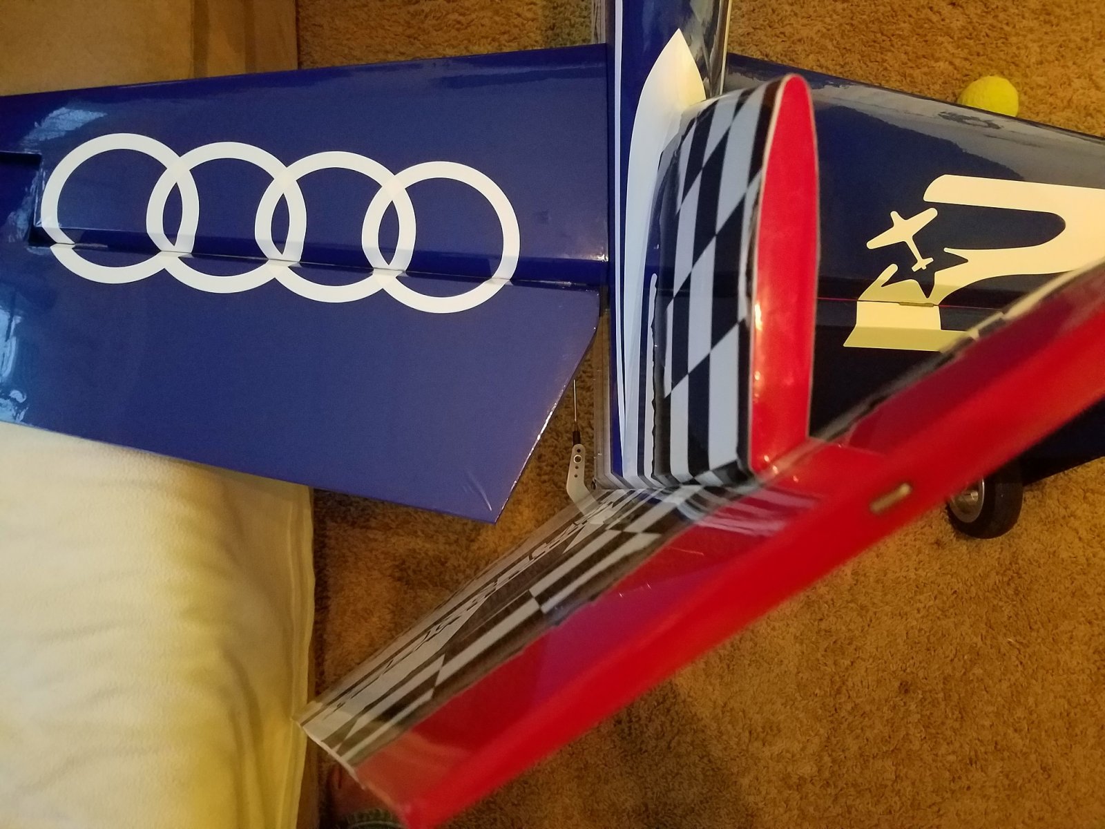

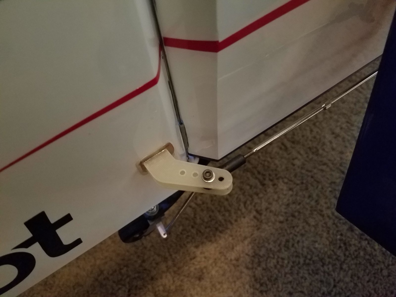

Here you go Tanner. I am not entirely certain of what it is that is different or just what you can tell from the photos of my Edge rudder. But as you can see, I get plenty...way lots of plenty of rudder throw. In fact, I have my rudder throw "e.p.a'd" out to stop it from going full stop either direction. And the rudder will travel exactly the same amount whether left or right. Full down elevator does not interfere with the rudder travel. I have found that the 107" V2 Pilot Edge does not "need" all the rudder throw you can get out of it. In fact, too much rudder actually counteracts any superior maneuvering capabilities. For example: Both my 107"'ers only needs about 30 degrees max throw to get wicked fast and tight knife edge spins. "Pop-Tops" are just as insane. When doing full throttle knife edge snaps, max throw of the rudder will give you some extremely violent snaps. From perfect Left wing up snapped to perfect Right wing up and vice versa.
Did I misunderstand or did I over look something? Let me know if this is what you needed or if there is something more I can do to help ya out.

Nice set up if I see it correctly you have two servos doing the job one on either side of the fuselage. Do you prefer this to the pull pull cable system and if so why. Or did you do this to achieve balance.
