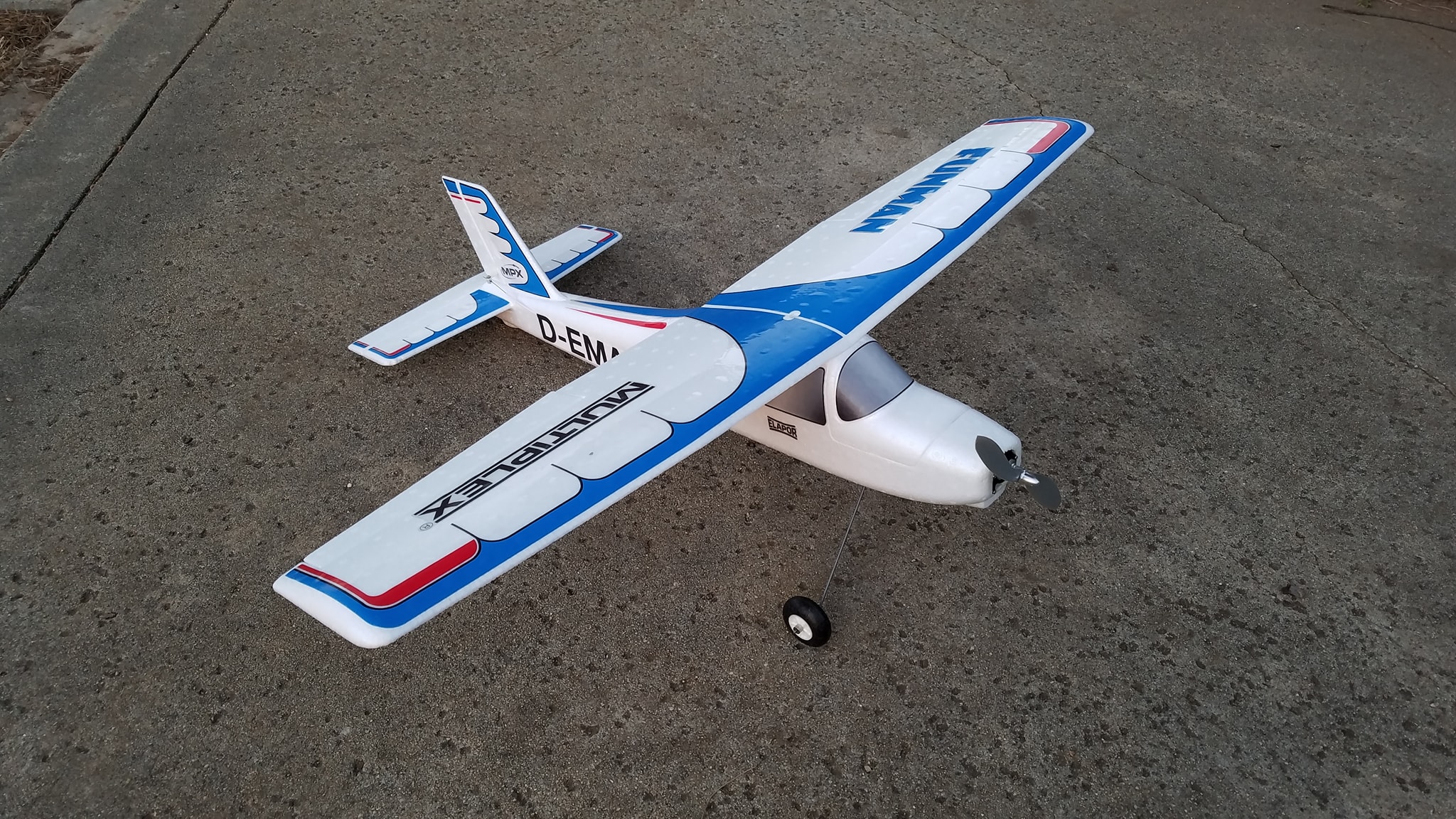

    Put this little guy together last night. There was a box of parts (ok, several dozen huge boxes..) that was set to be tossed out at work so I grabbed it and some spare parts for it. Believe it or not it had a brushed speed 400 motor, a 16 amp brushed ESC, and a 7 cell 850mah NiMH installed in it! 2 HS-55's were in the fuselage as well, so I dug out 2 more HS-55's to put in the wing and put it all together with a Castle Creations Thunderbird 18 ESC and a Himax HB2815-2000 inrunner that bolted right in place- it would've flown on the brushed combo, but not with aileron servos and it would be hand launch only, so those parts were pulled and set aside in favor of a brushless system. On a 2s 5000 pack (same weight as the stock 7 cell NiMH) and 7x4 propeller it should make about 150w of power, and I think I should get 20+ minutes of stick time out of a pack. Not bad for a little 4 channel airplane that's about 10 years old :)

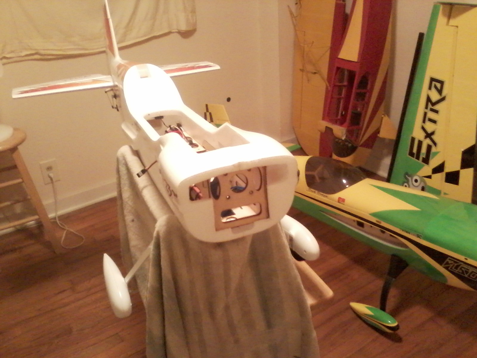

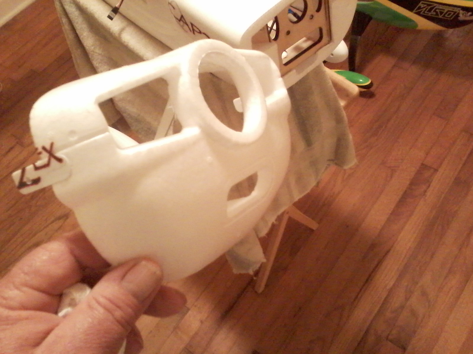

    Had to pull the motor on my CAP and send it in :(. I think one or both bearings loosened up causing power loss and vibration. Only 4 flights. I hope they don't take long because this plane is a pleasure to fly. I really need to get busy:dancing-chicken: and swap engines on the Alien since I'm now in the "Removed motors " mode :dancing-poop:. Not only can things change in an instant at the field but also in the shop! :cautious:.
    Since the Cap is down for a bit I might paint the front cowl portion and wheel pants to make it a bit more custom. I got a bunch of yellow paint from a previous project (Yea, cub still not finished lol) :rolleyes:.
