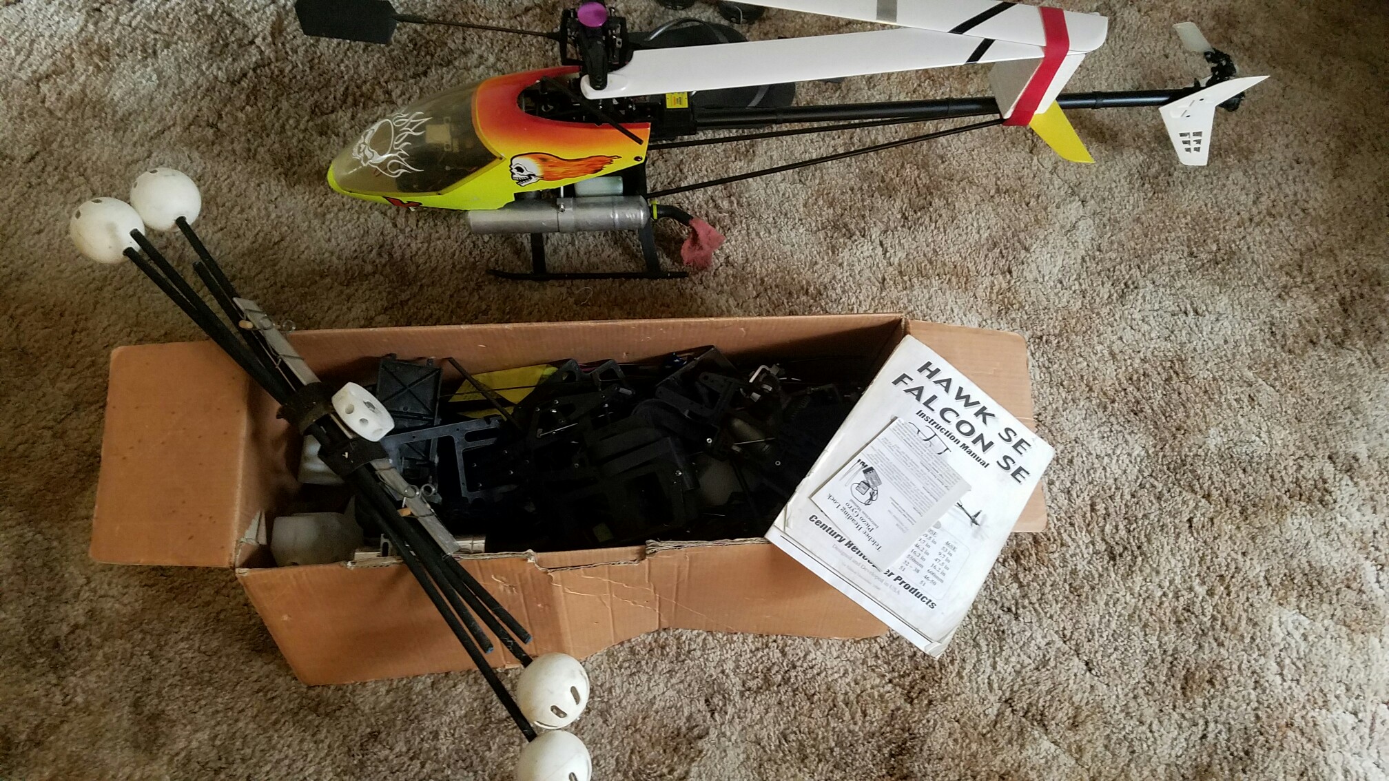

    Picked these up. Will be my first venture into helis so I have lots to learn especially trying to get it setup on my taranis but hope for it to be a successful venture.
  7. Jetpainter
    Jetpainter 640cc Uber Pimp
    Teach yourself on the sim first and you'll do great. It worked great for me and I was flying in no time.
    There was a great training program on Helifreak or RunRyder one or the other. The part of it that helped me the most was where you went to the helicopter training circle in Realflight and set it as big as it will go then give the heli a little rudder trim until it's rotating 1 revolution per minute and try to hover in the circle as it rotates. Once you can handle that for 10 minutes without crashing or leaving the circle you'll be able to handle the real one just fine. You can also do it inverted, that's fun.
    Bluepilot2003 likes this.
  8. BalsaDust
    BalsaDust Moderator
    I just want to fly circles with it. No 3D.

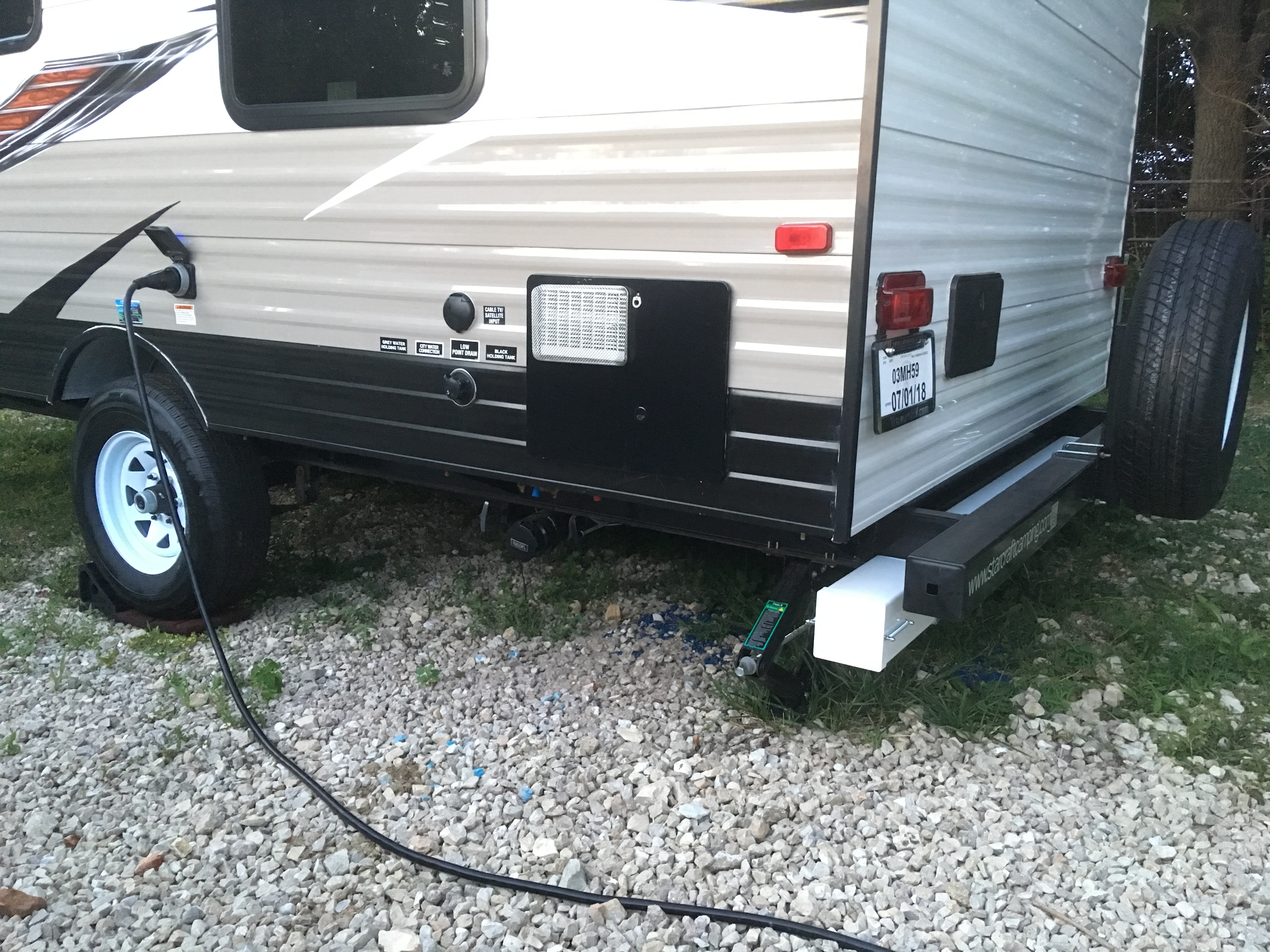

  10. Picked up a new camper last Saturday. 19’ Starcraft Bunk House. Been working on it all week.
    First thing I did was re-wire the battery. I didn’t like the way they had the wires routed and they zip tied them directly to some angle iron. So I re-routed them are used some snakeskin to protect them. I don’t think I have any pics of that though.

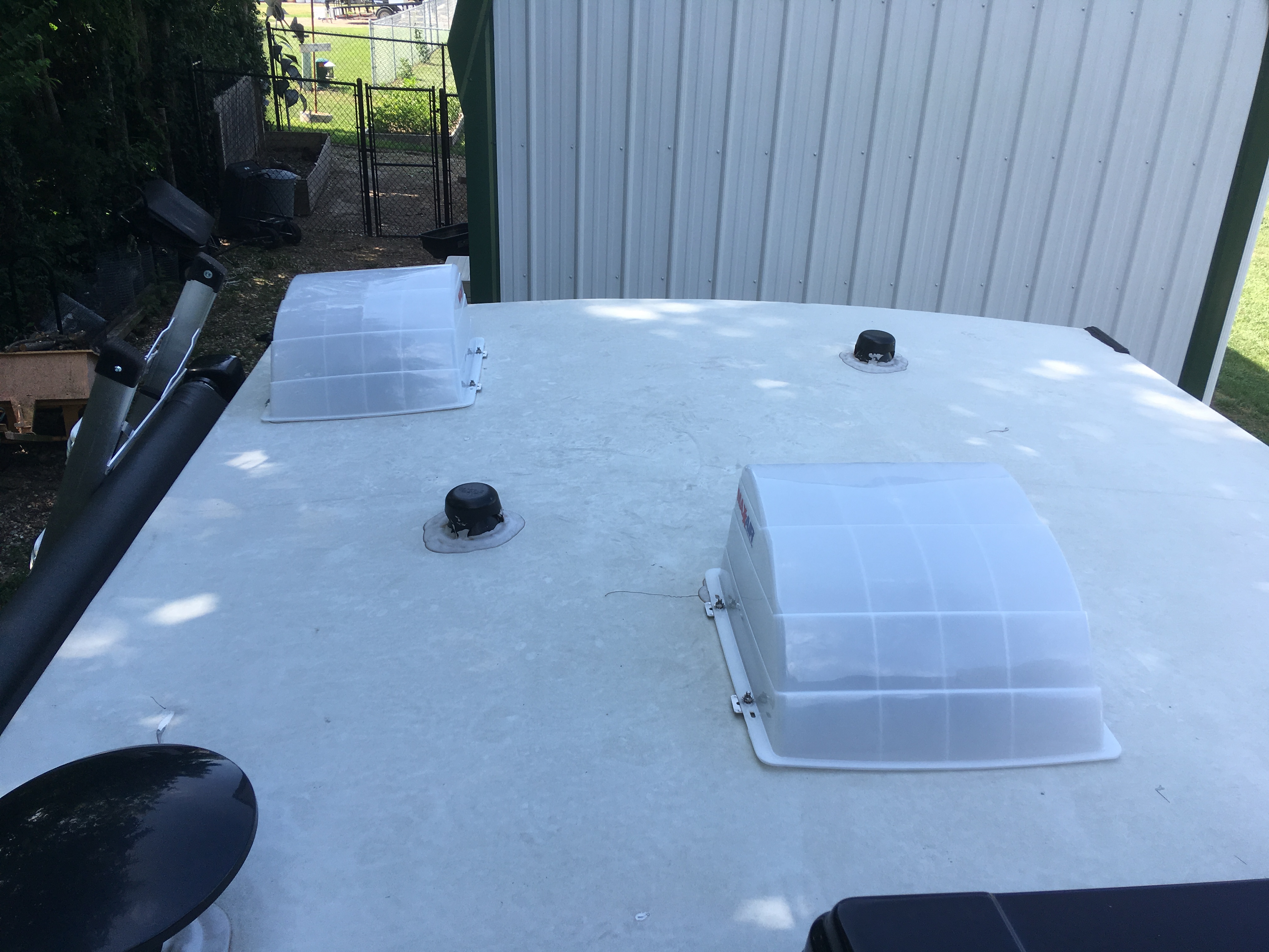

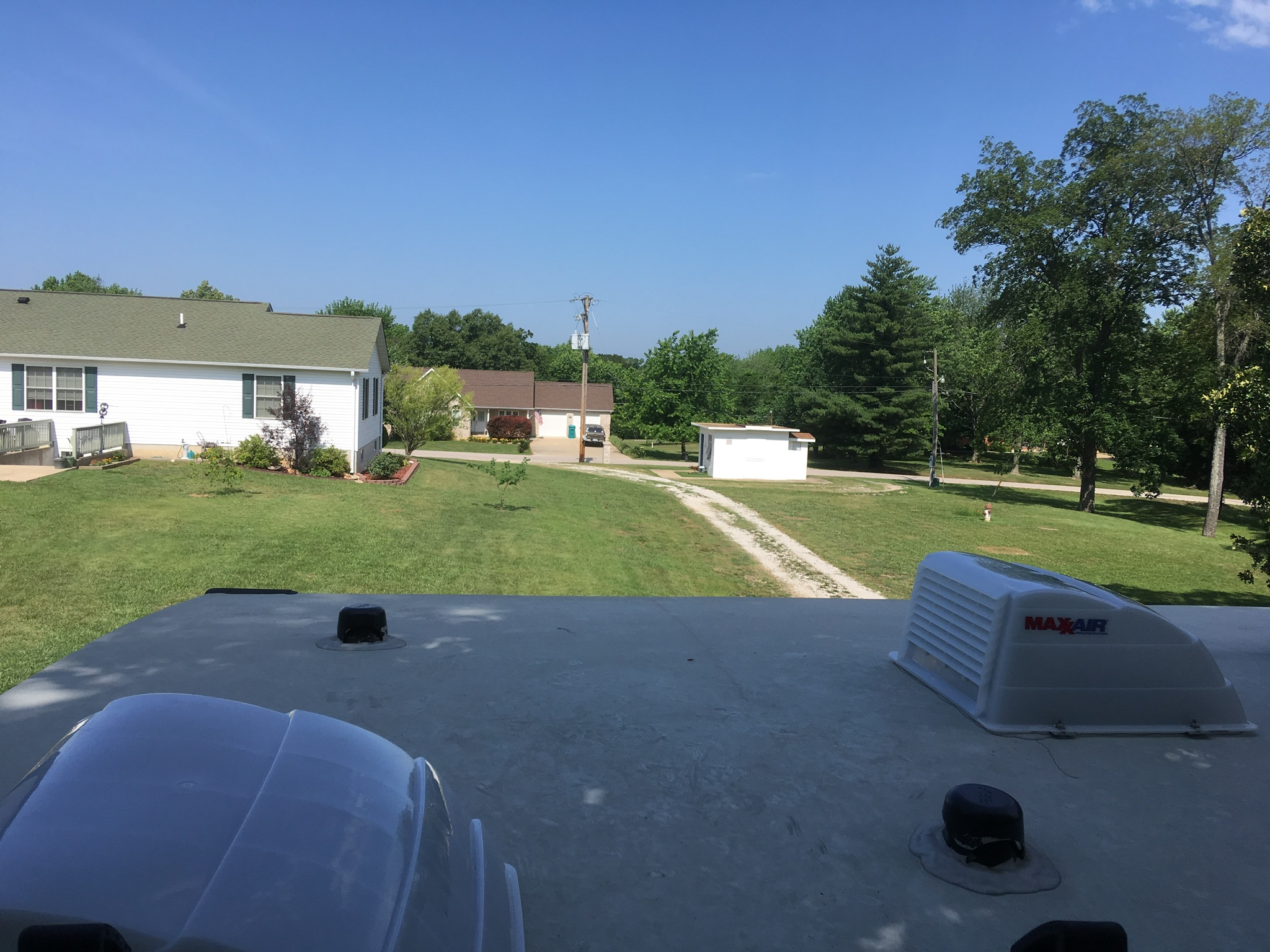

    Next I installed a couple Maxxair vent covers so that we could leave the vents open without having to worry about rain getting in.

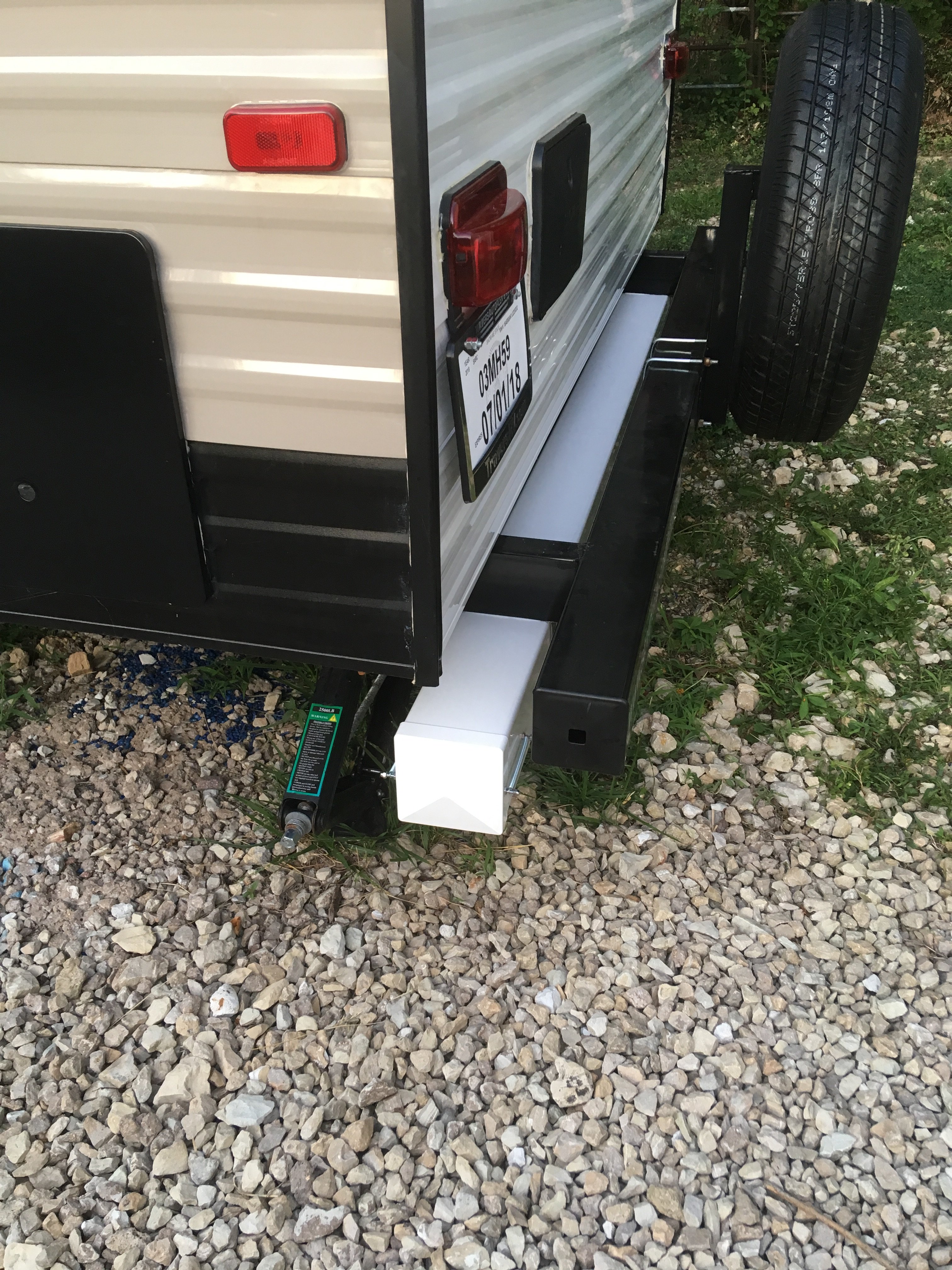

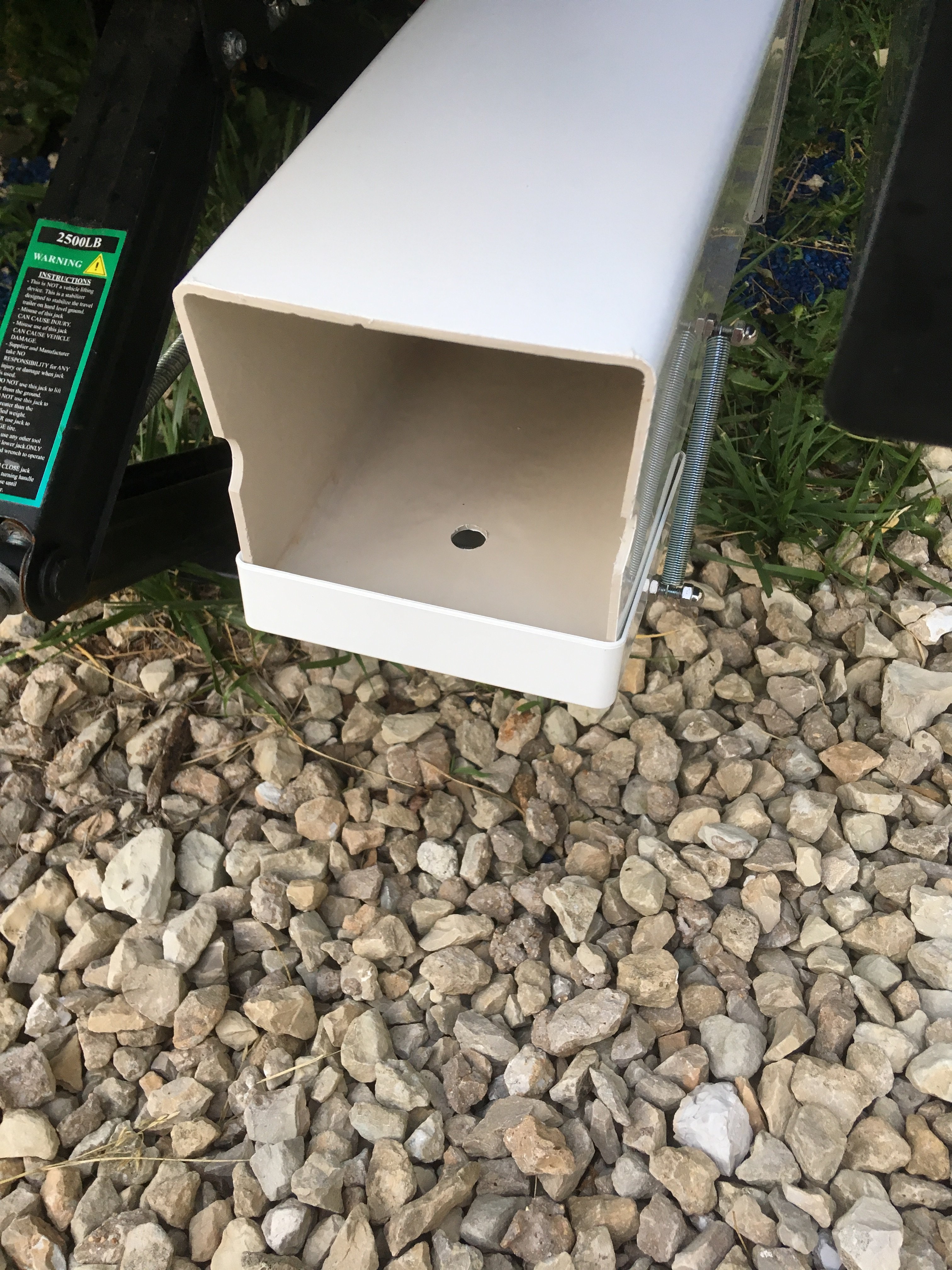

    Then I built a sewer hose storage compartment using a 5”x 5” vinyl fence post. I know a lot of people use the rear bumper to store the sewer hose. But I was afraid it would cause the bumper to rust out. Plus the bumper is only 4” x 4” so the brackets and the elbow don’t fit in there.
