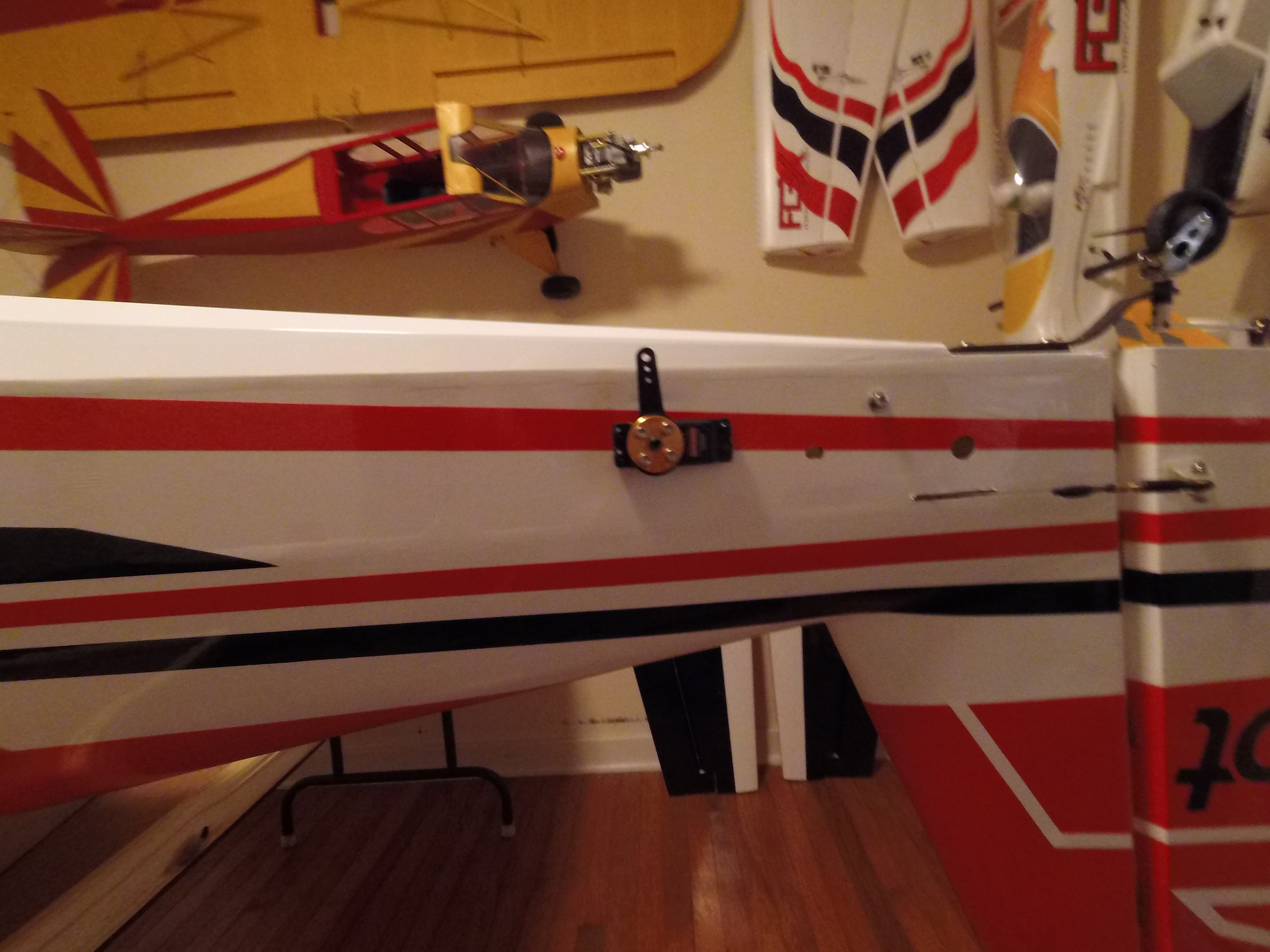

Was quite a chore but I did get the belly access panel done. Being I did it all by hand and sanded the edges of the openings I am going to prime and paint instead of covering it. I also made some servo arms from old mild steel arms, that came from a cheap ARF, by adapting aluminum servo wheels to them. The hangar 9 arms I had are 25T spline and Spektrum servos are 23T spline. My old arthritic fingers are not laser sharp ya know :errrr:.

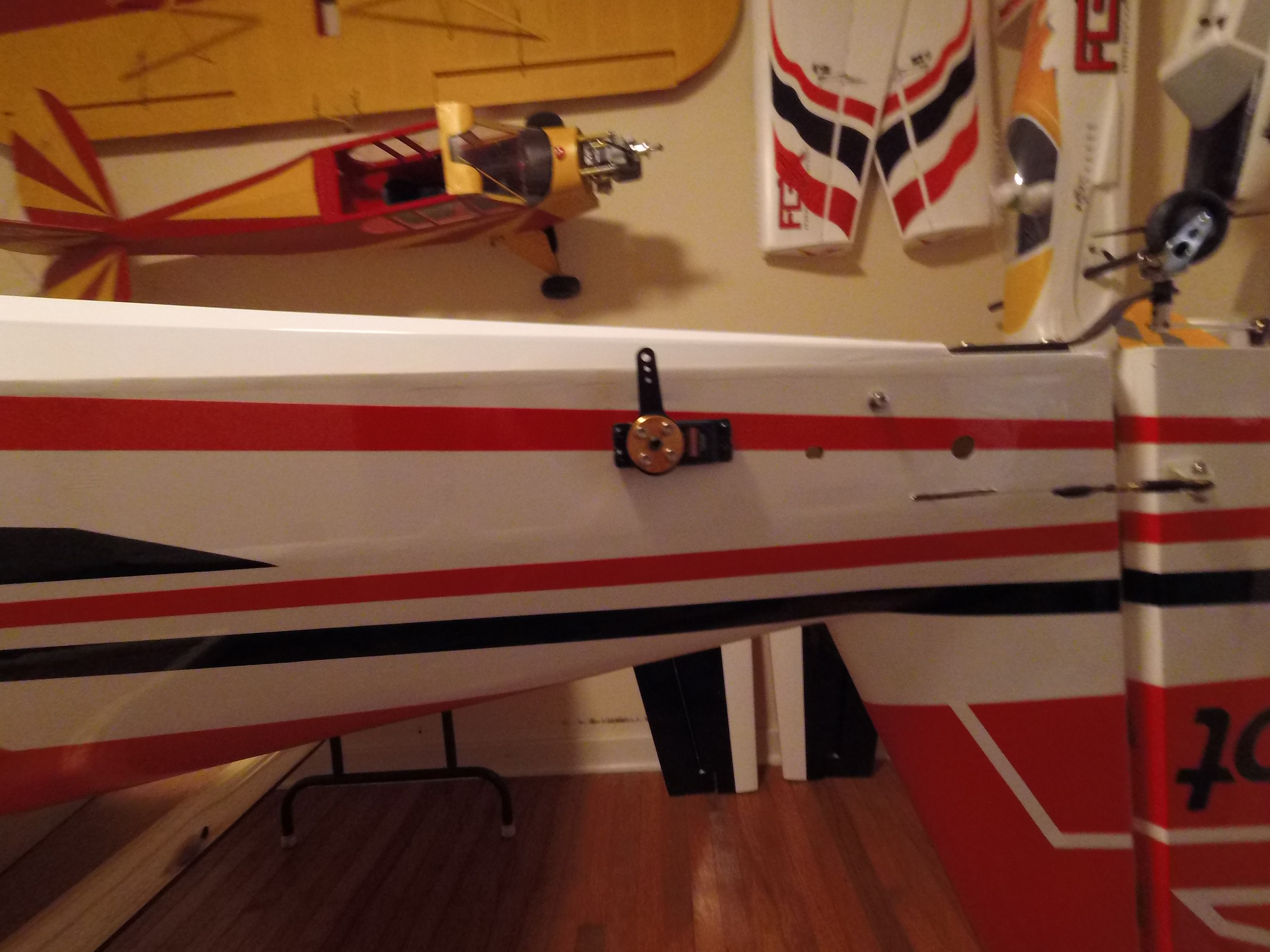

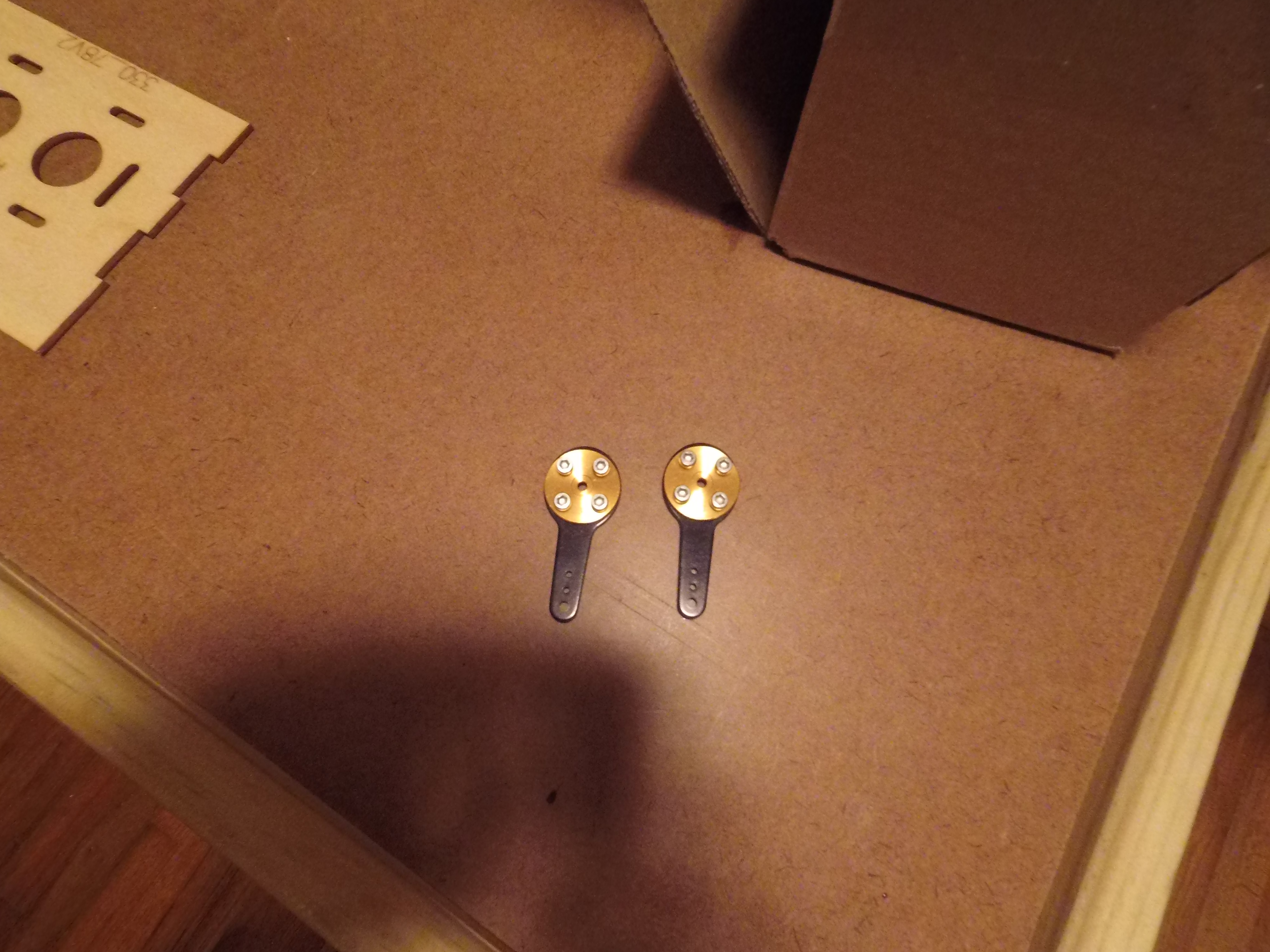

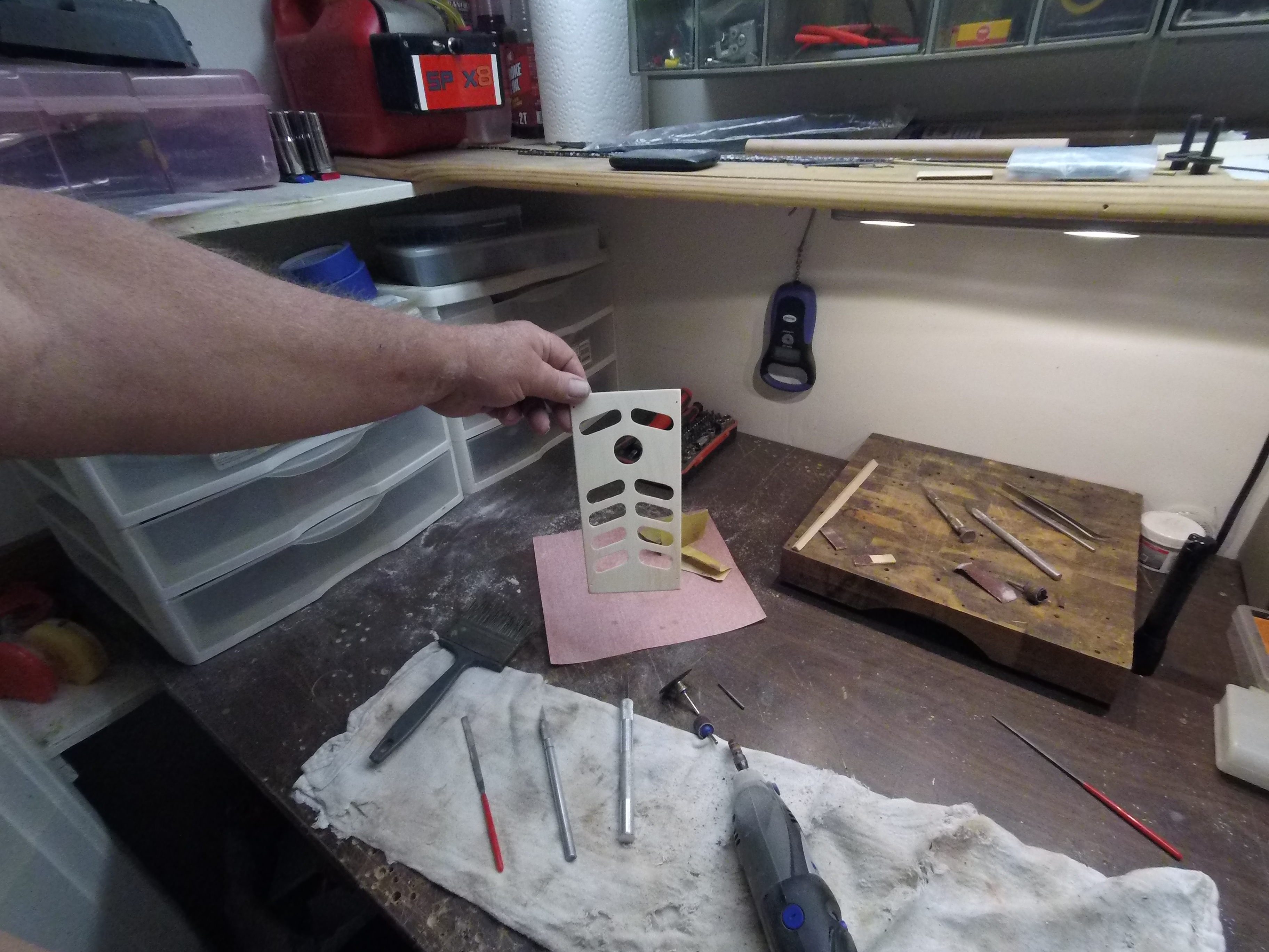

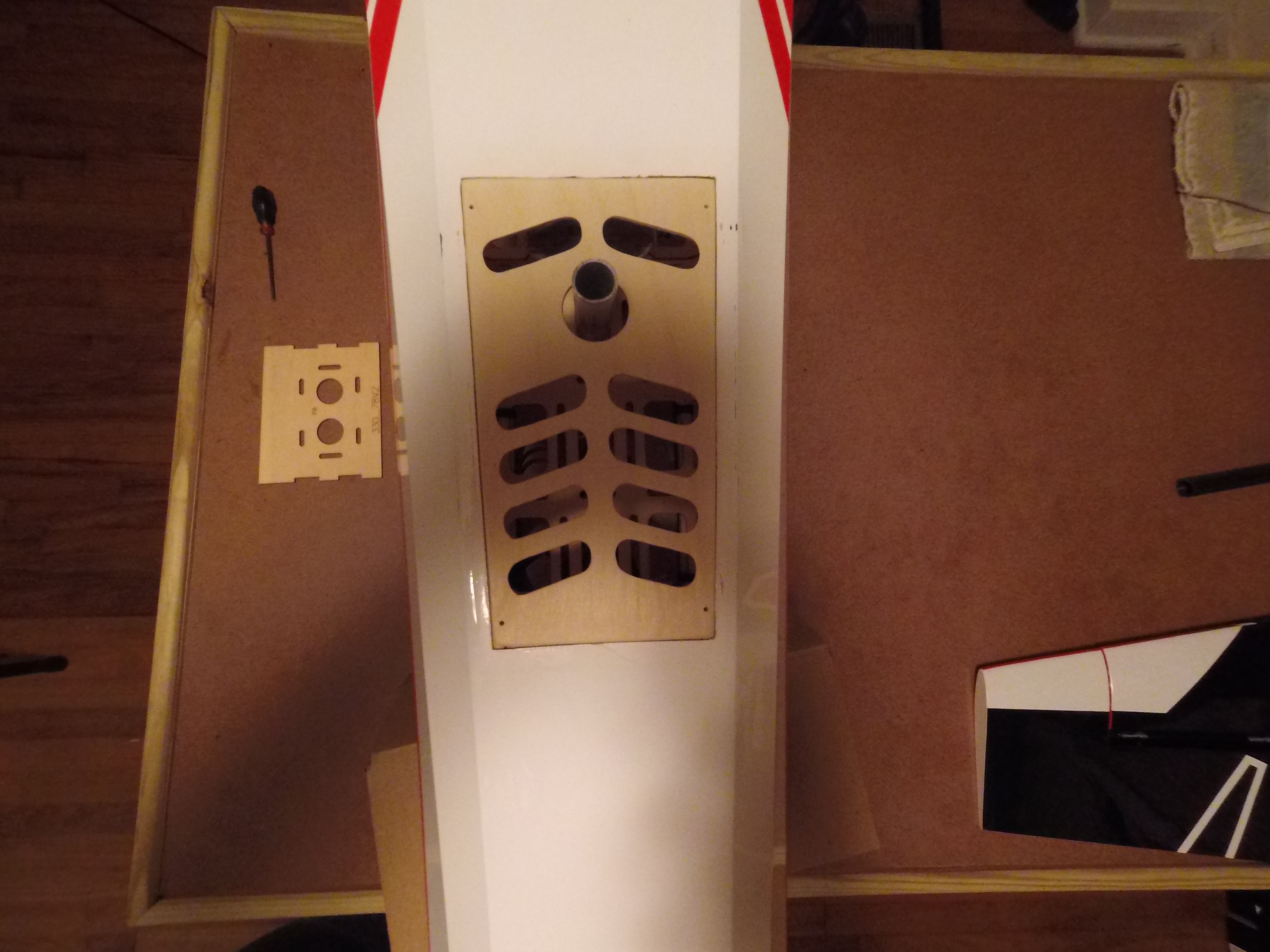

View attachment 108421 View attachment 108422 View attachment 108423 View attachment 108424
Great job brother! Those servo arms look factory. Belly pan looks awesome too.

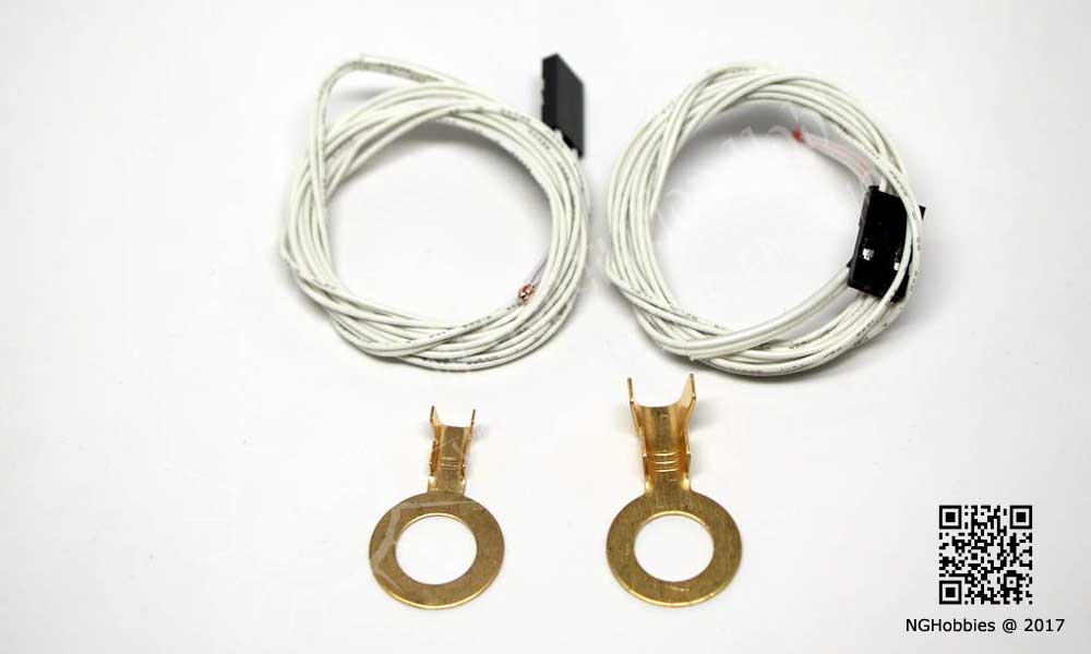

I have been working on a better way to secure temp sensors and came across these (1st pic) but I am only using the brass part
(2nd pic), they go on the spark plug. They are working rather well and would like to find a source just for the brass part. Does anyone know where the brass part could be bought.
You can get those from an electrical department in auto store. It is a wire crimp for wiring. The one you are showing are normally used under a fog light mounting bolt for grounding.
