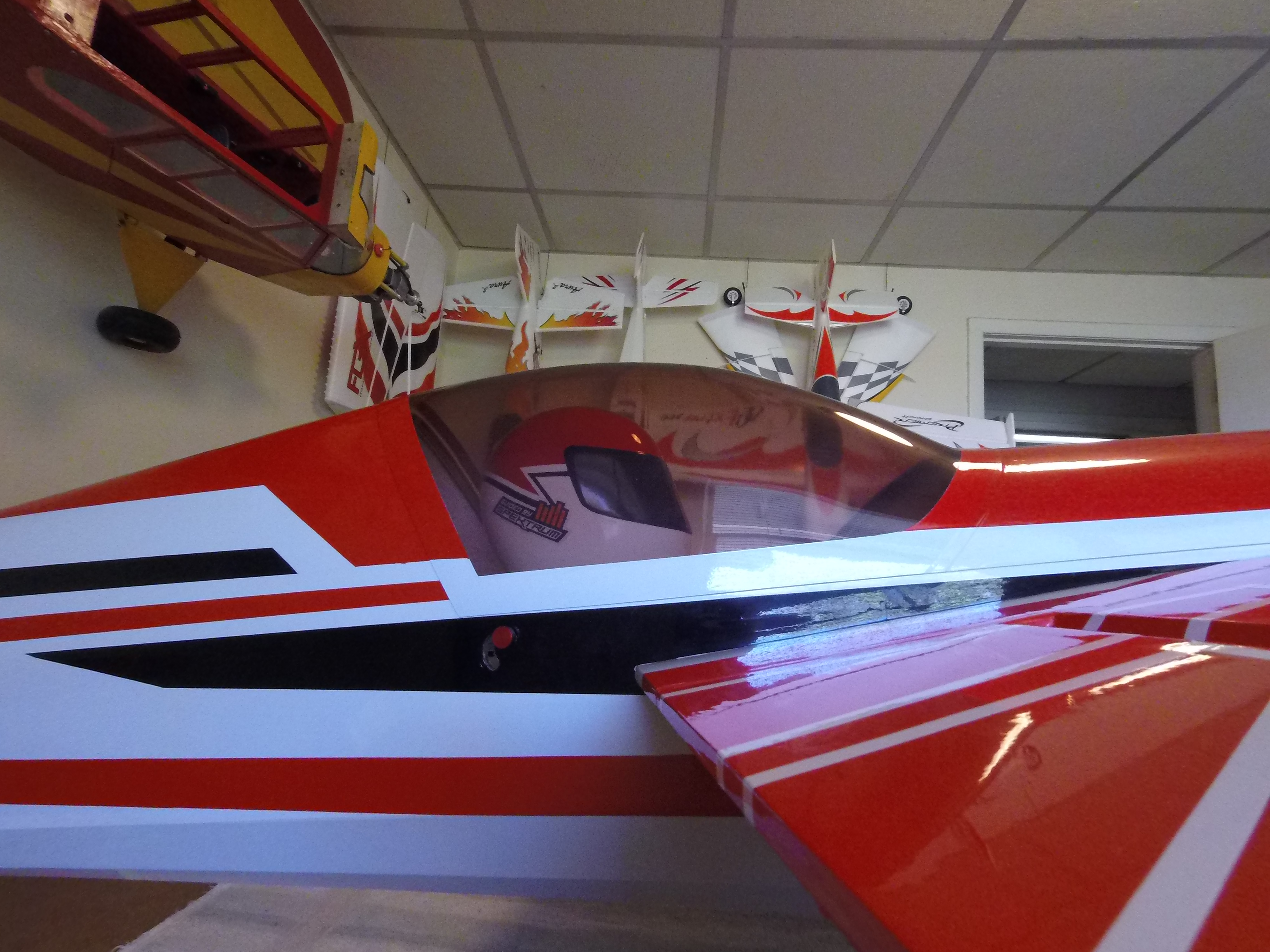

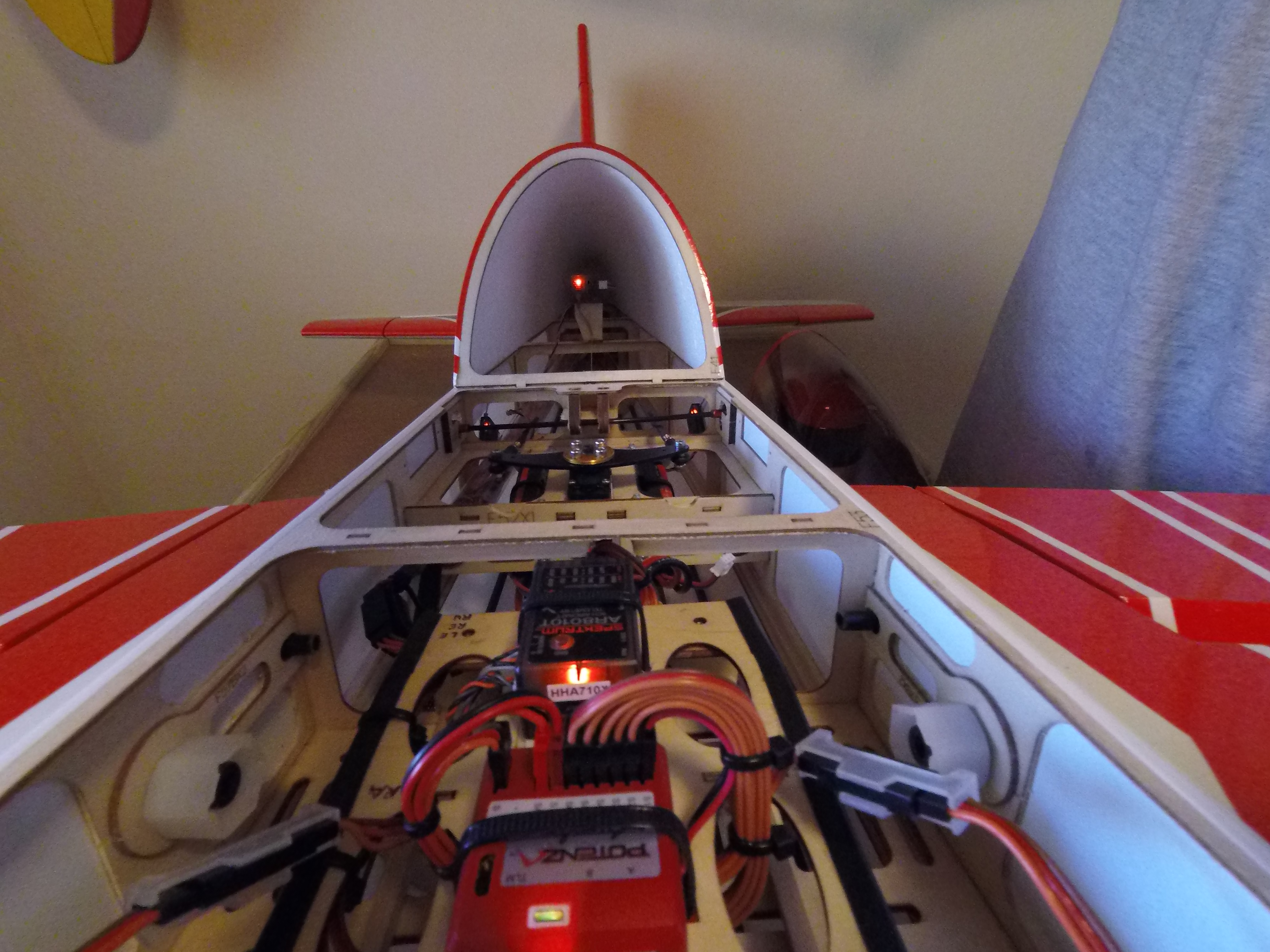

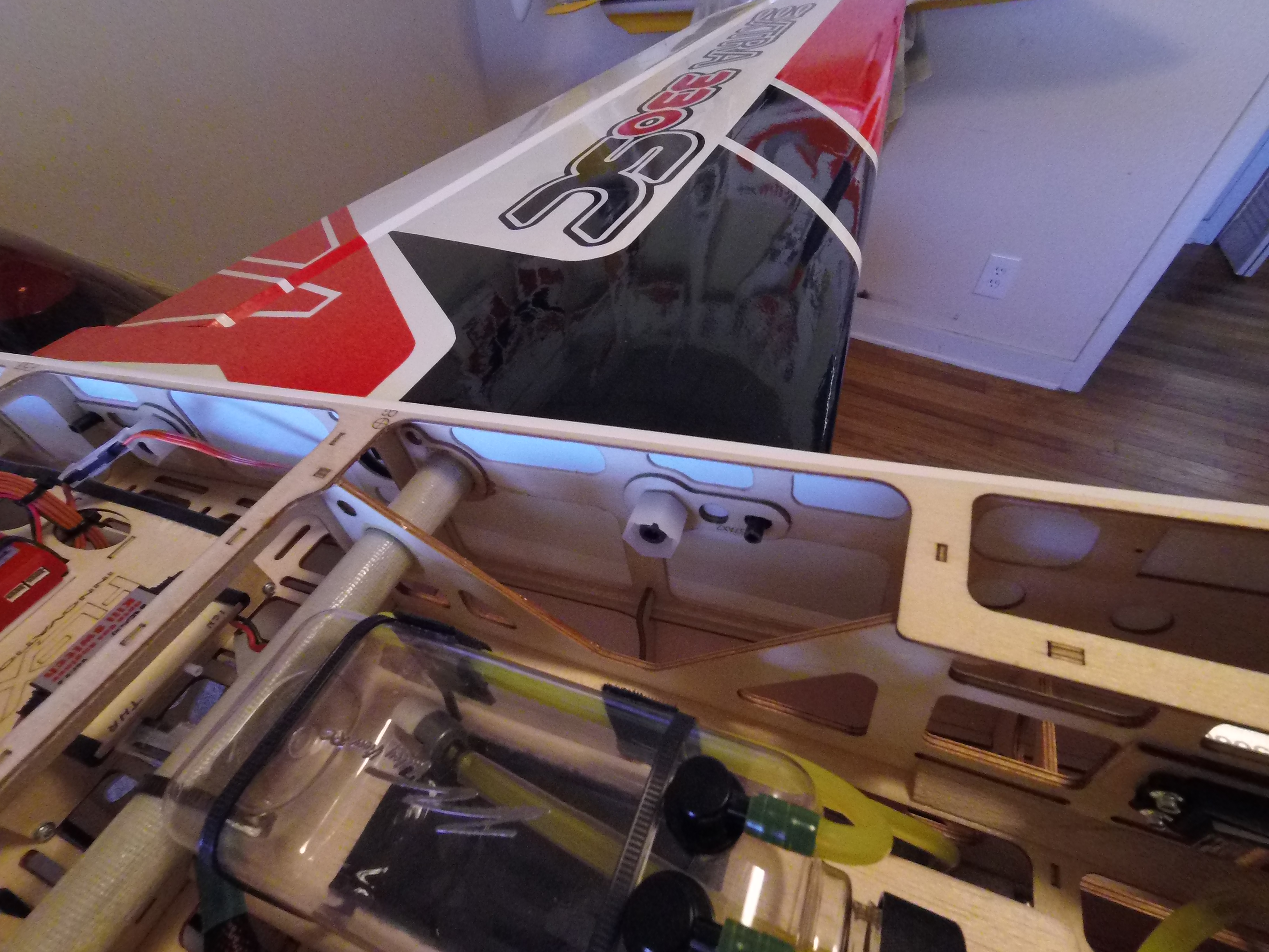

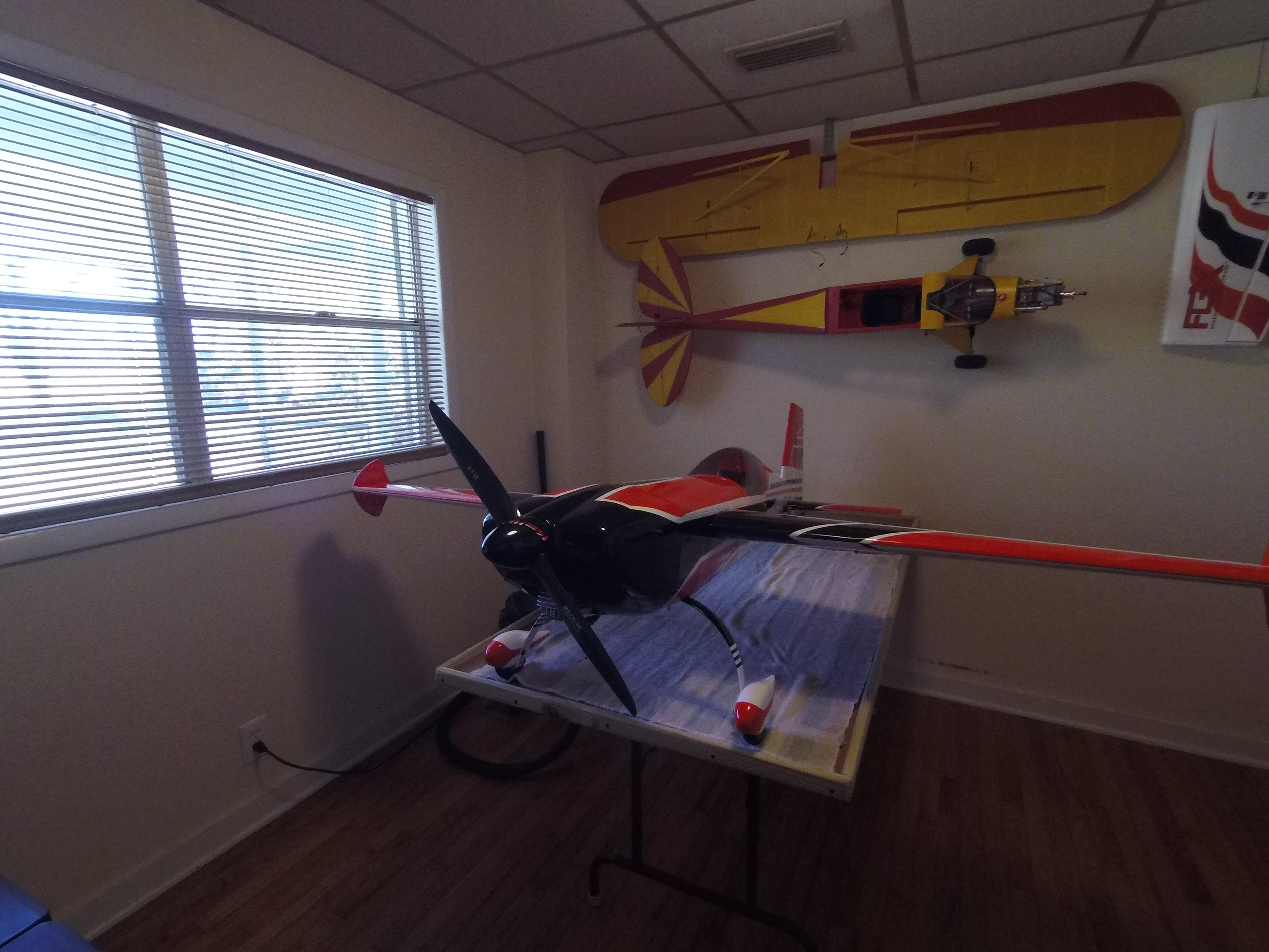

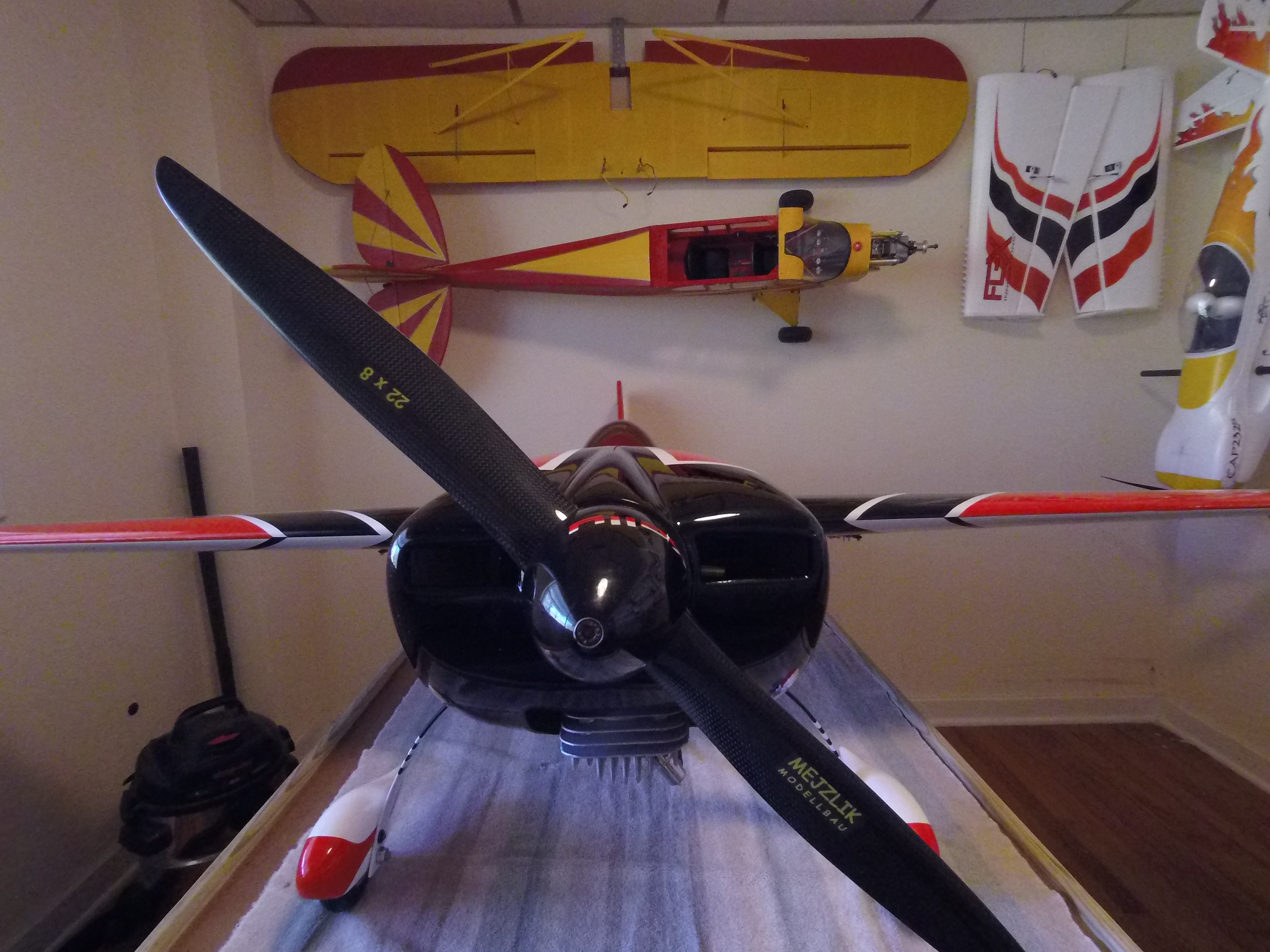

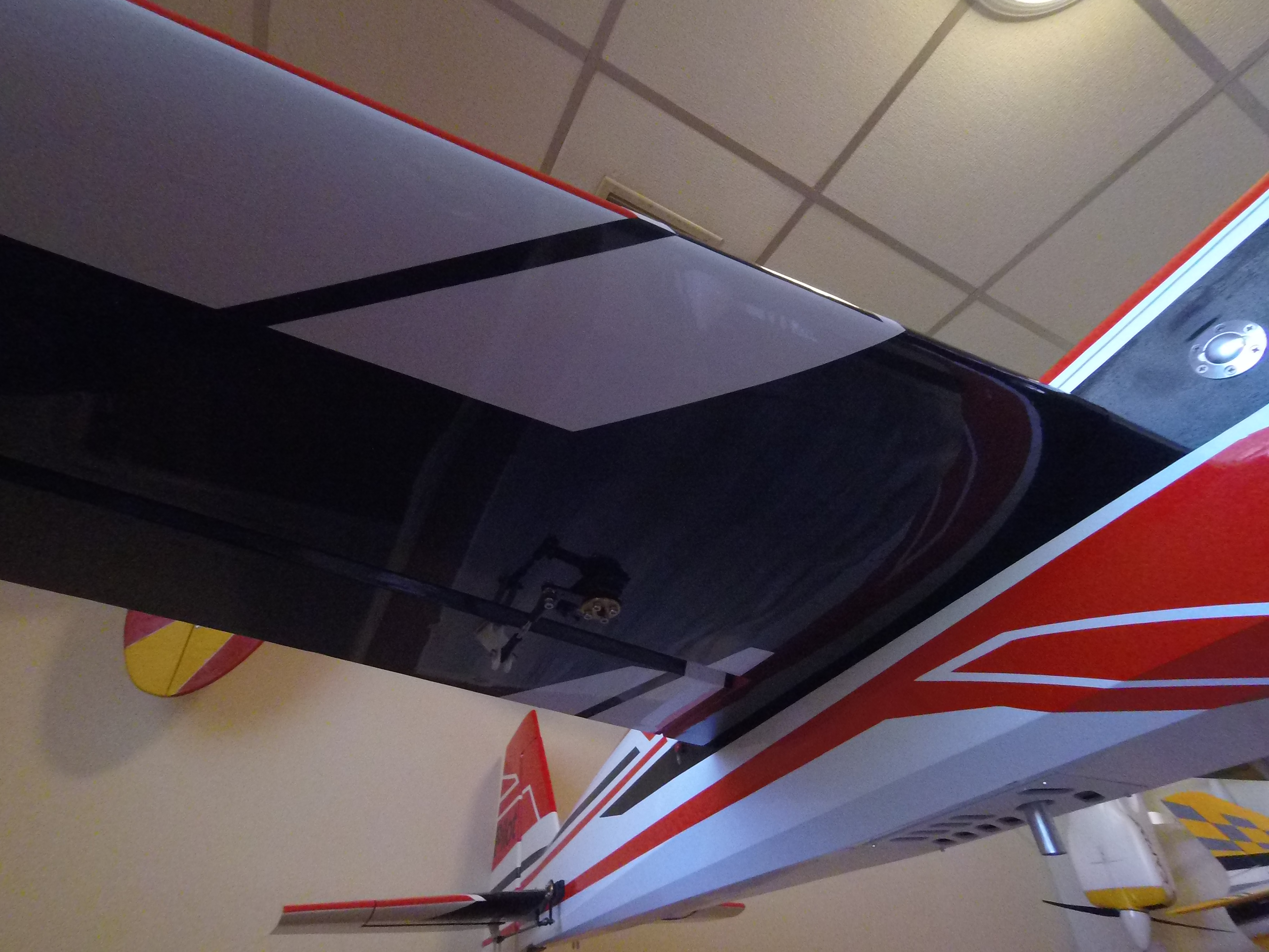

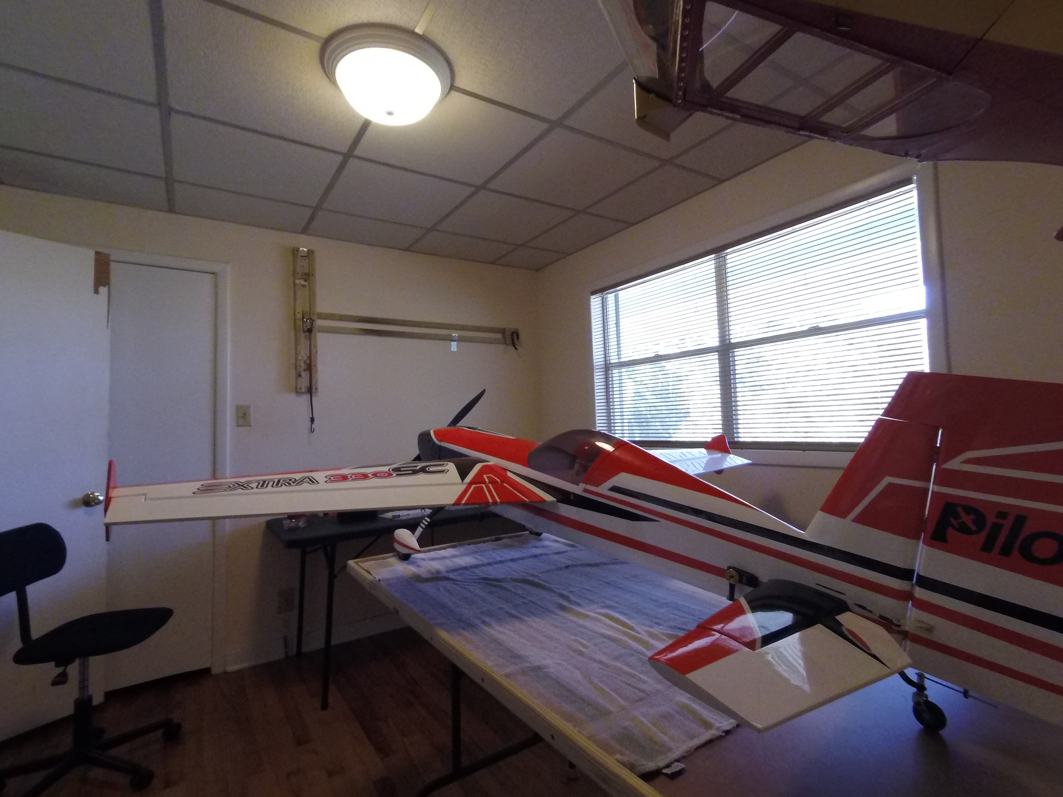

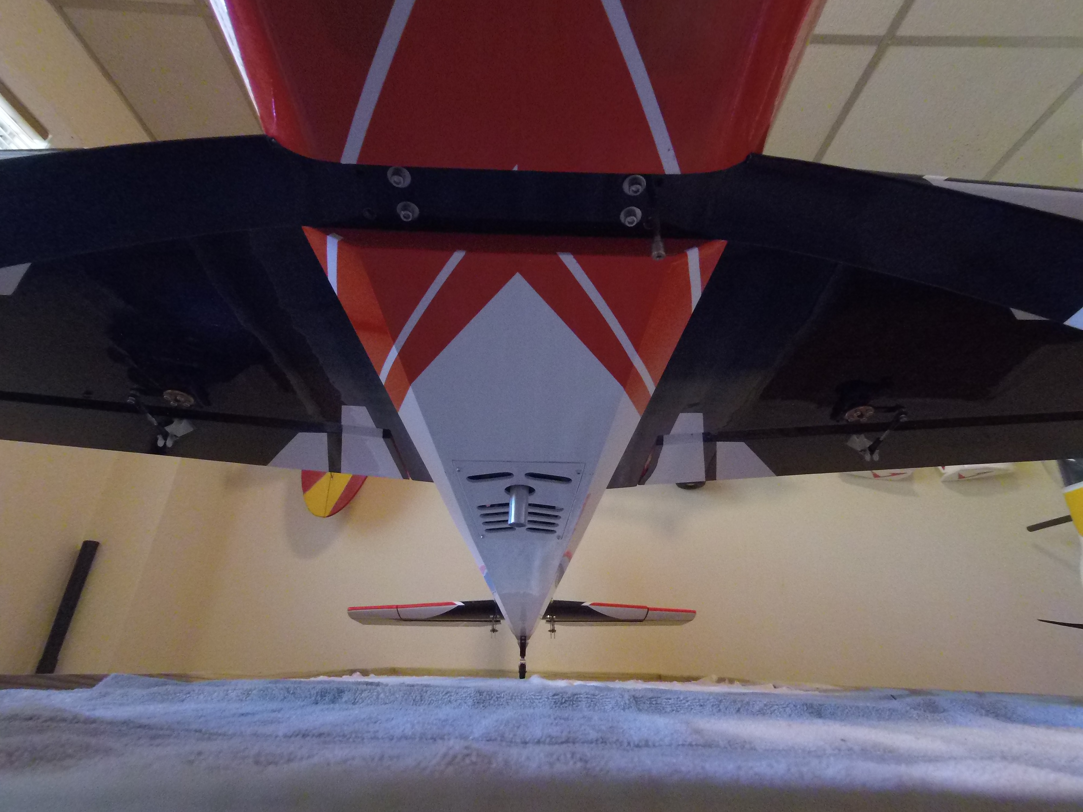

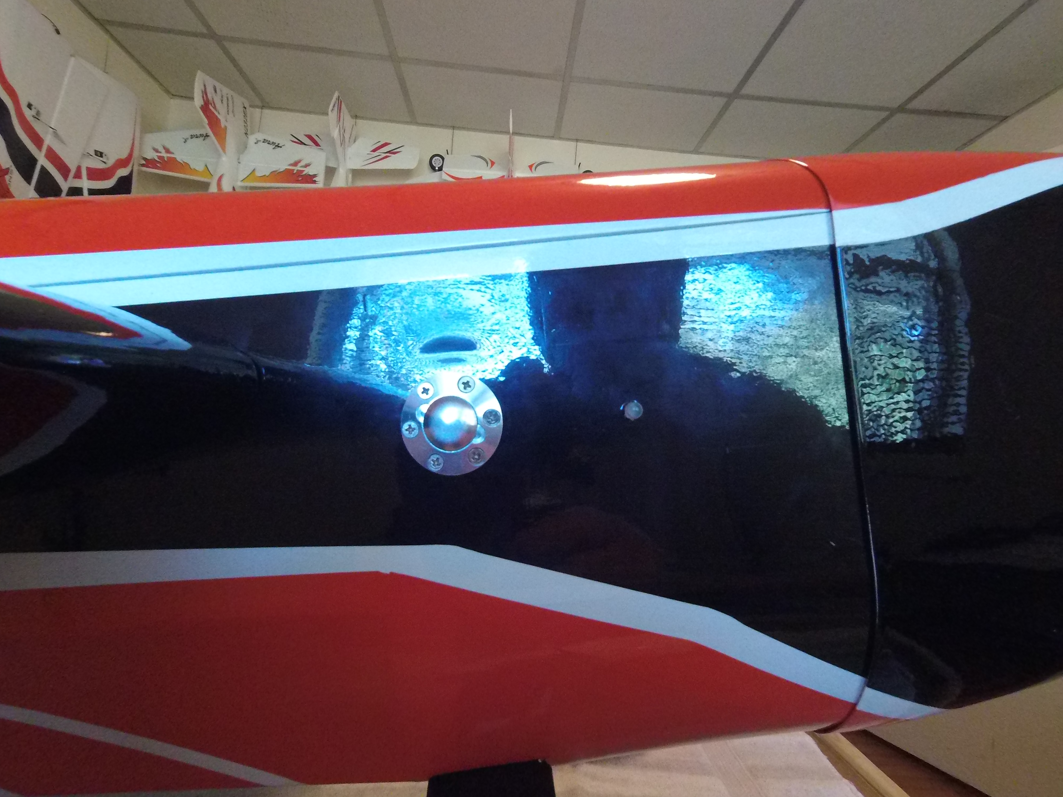

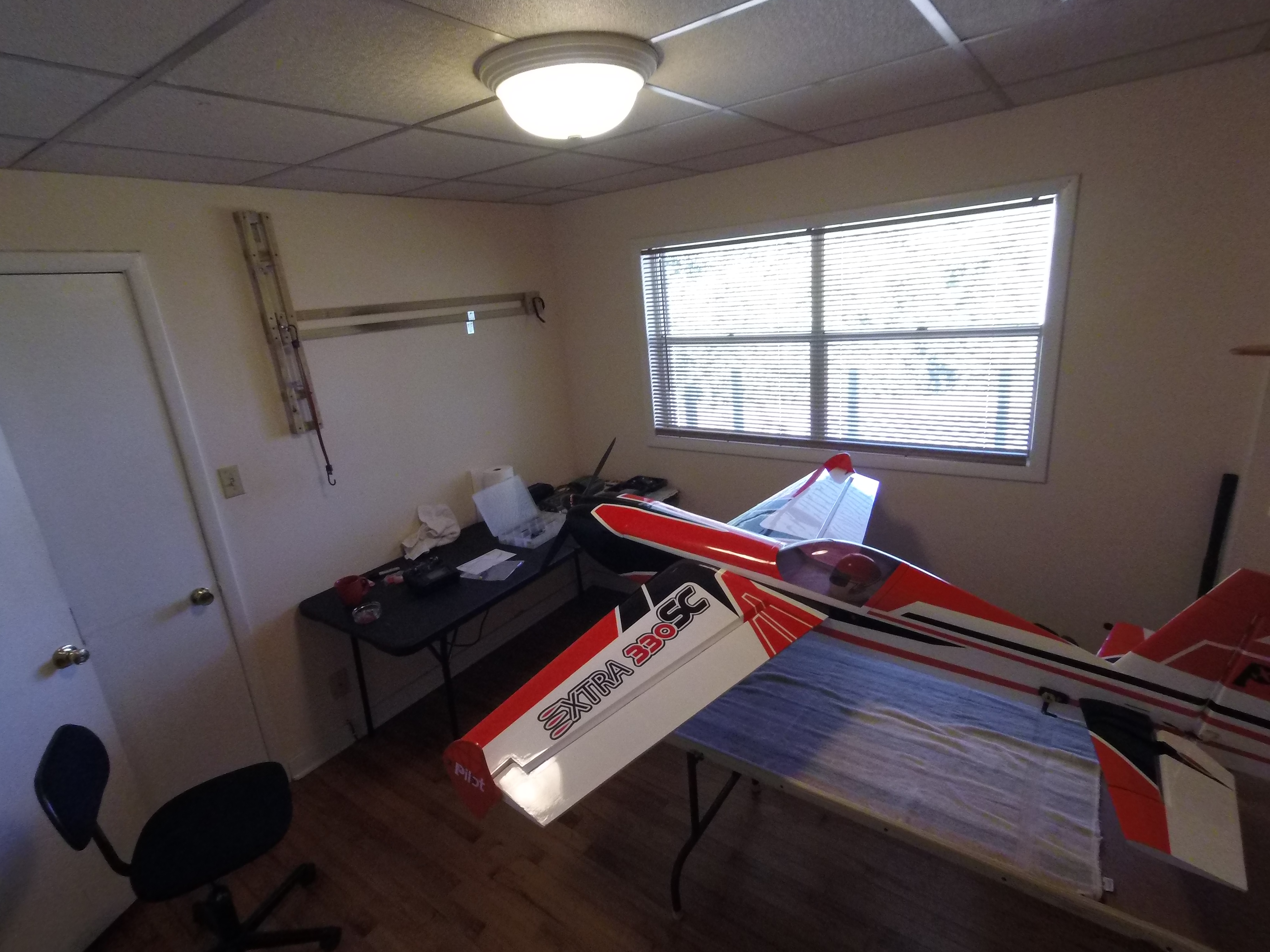

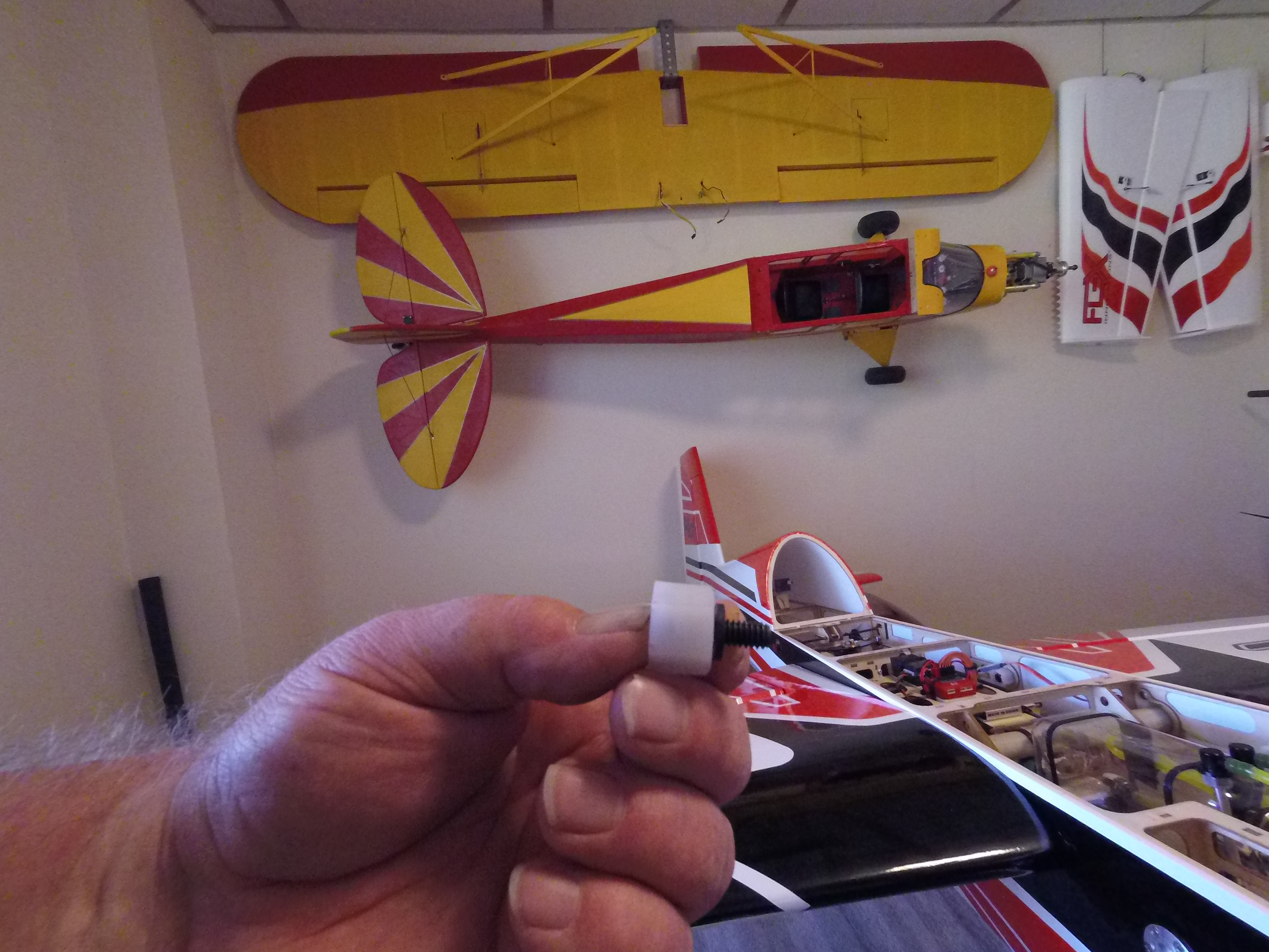

Just took some shots of the finished plane powered up and assembled for flight. The custom wing bolts I made work great and go on / off quickly and easily. Everything working and ready to run. Hope to Maiden soon :)
View attachment 108482 View attachment 108483 View attachment 108484 View attachment 108485 View attachment 108486 View attachment 108487 View attachment 108488 View attachment 108489 View attachment 108490 View attachment 108491 View attachment 108492
Need more details on the wing bolts see the picture but not enough to figure out exactly what you did.
First off.....I had installed 1/4-20 blind nuts over the 5mm nuts in the wings 3 years ago when I first assembled this ARF. The 5mm threads were poor and difficult to start the bolt. I remember when using 1/4-20 hex caps it was difficult getting the four bolts snug with a hex wrench (A bit easier with the new fuse design though). I had some really nice wing bolts in the Alien Extra (Sea-Craft's) and it gave me the idea to make my own.
I just happen to have some "replacement" ZAP ca glue bottle caps I had gotten about a hundred years ago from HTUSA. Never had the chance to use them for I switched to BSI ca four score and seven years ago lol. Any way I cut the tips off the bottle caps and tapped out the center for the 1/4-20 x 1" hex bolt. The center portion of these particular bottle caps is very thick nylon and was perfect for my application. The bolts snug in nice and tight in the nylon bottle caps and don't back off when installing it as a unit in the plane ;).

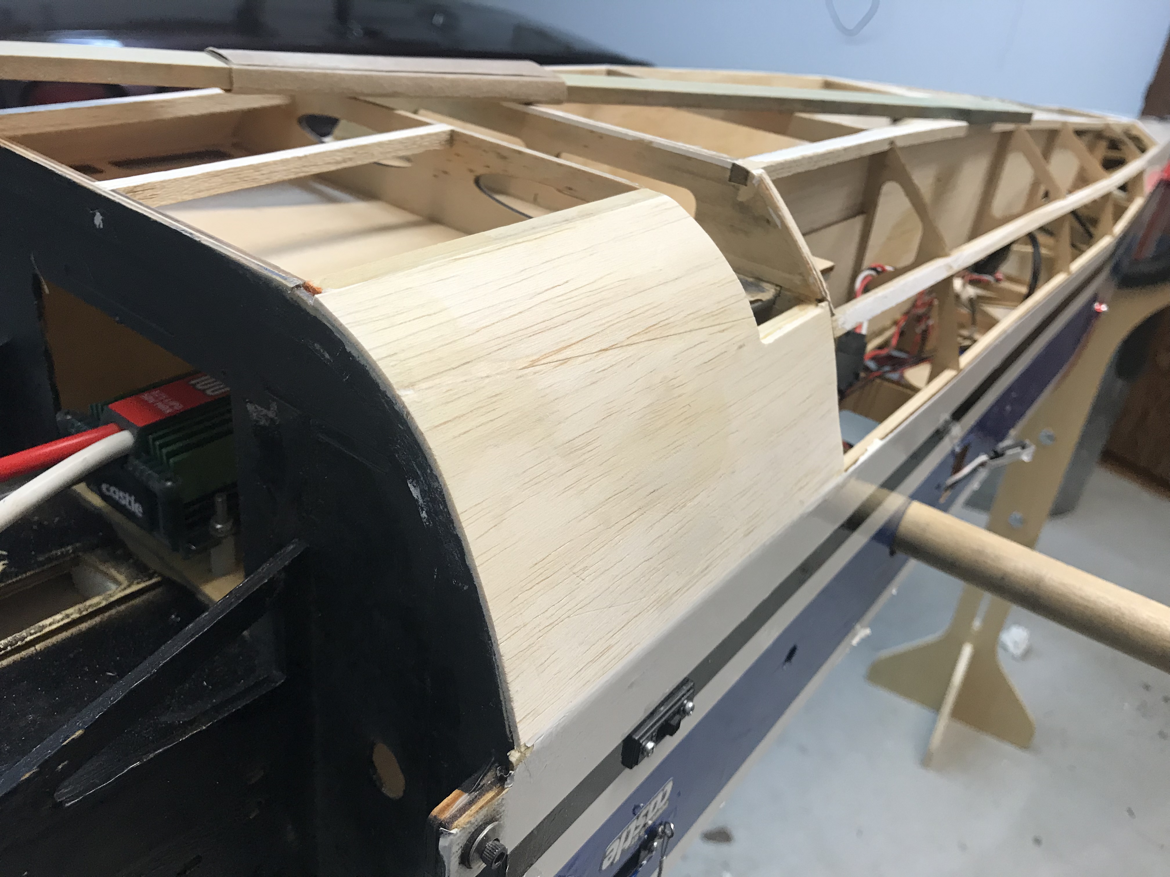

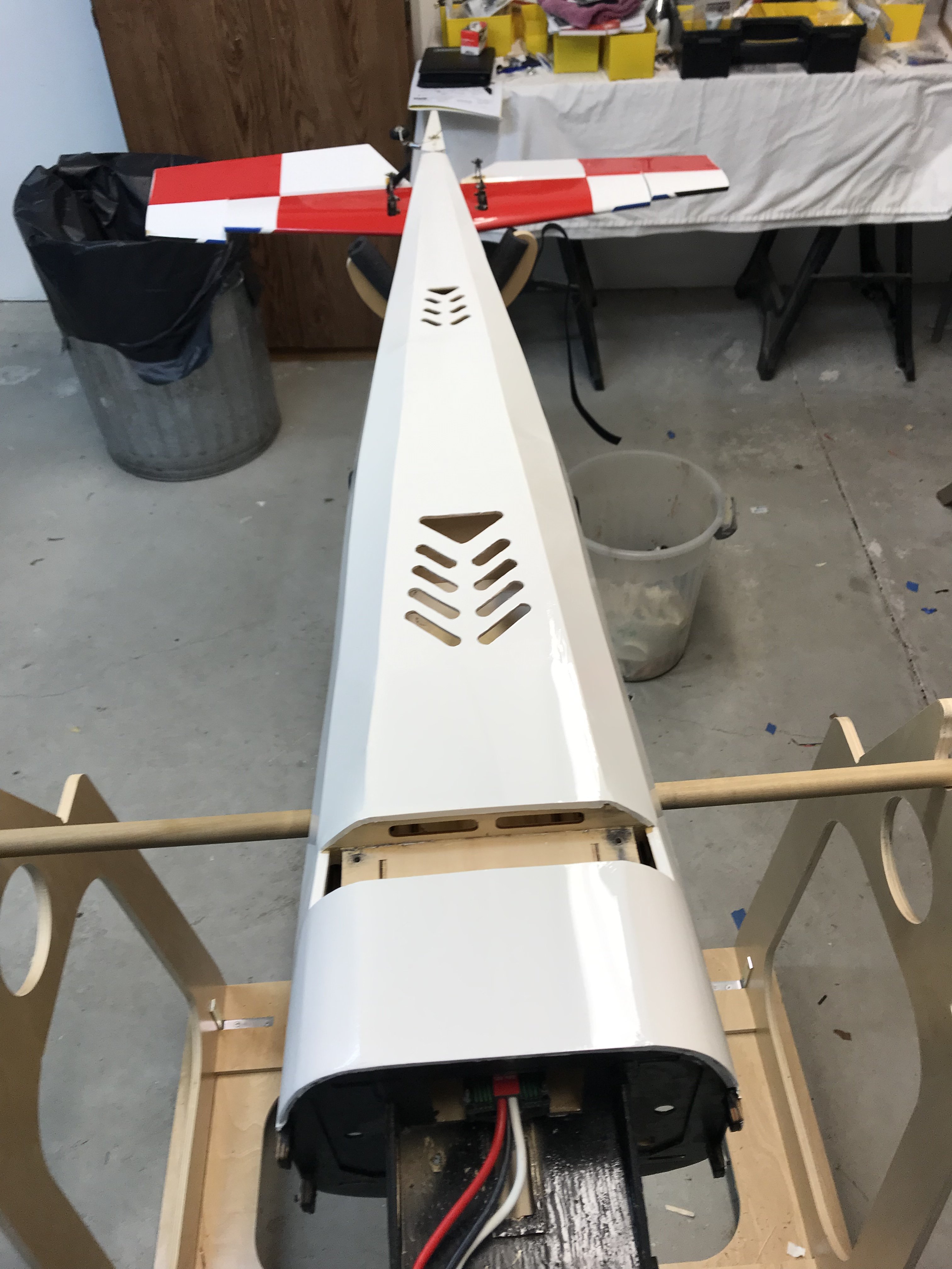

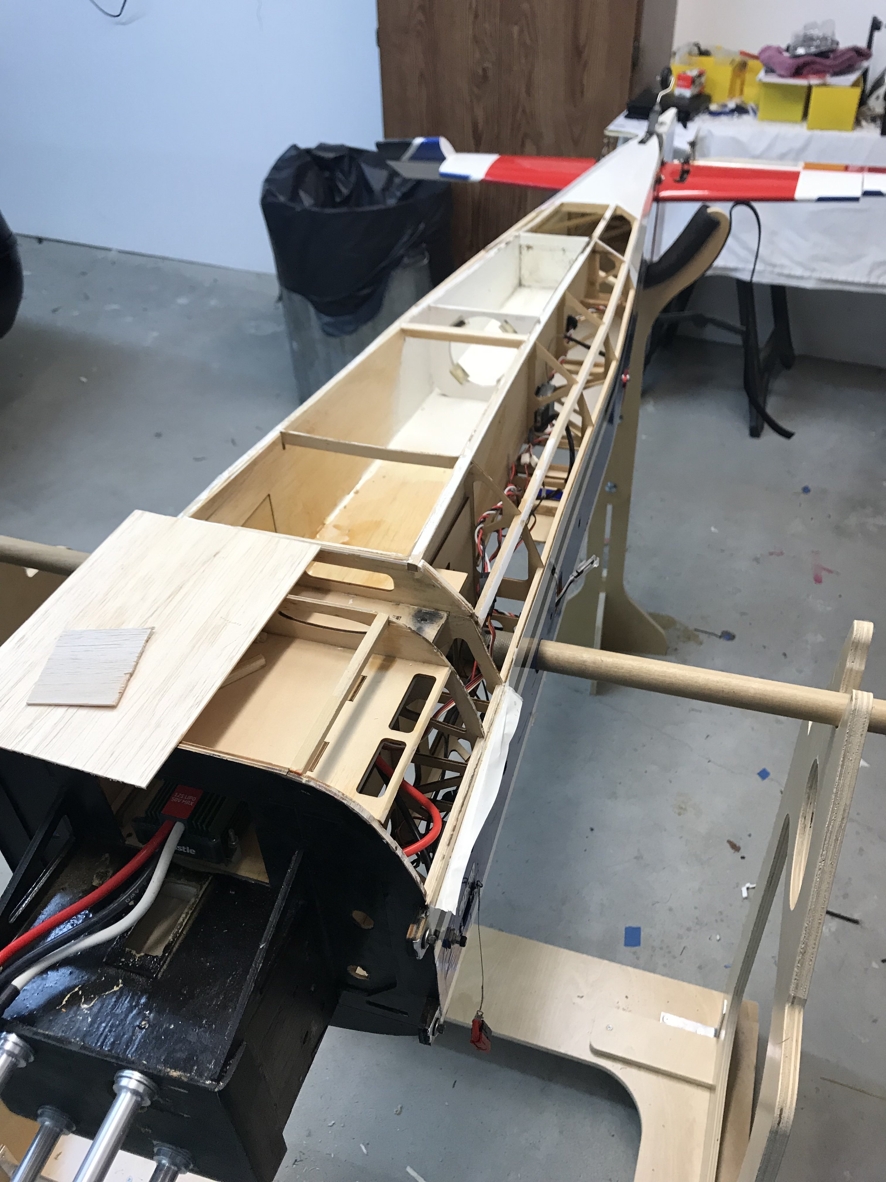

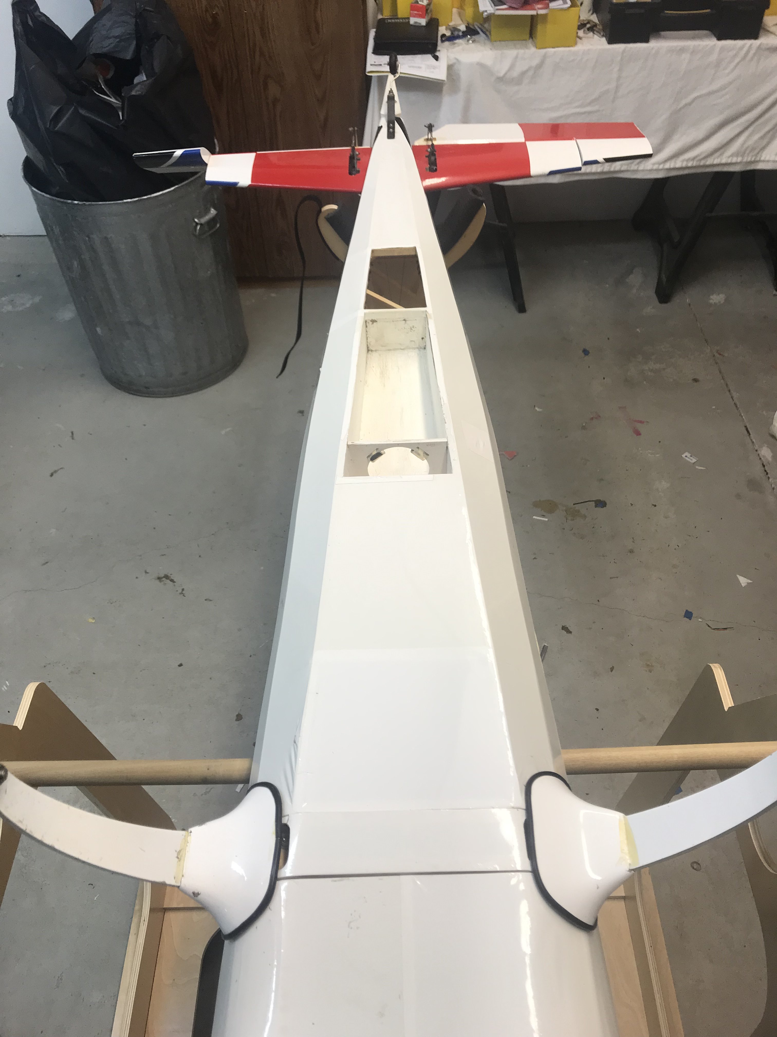

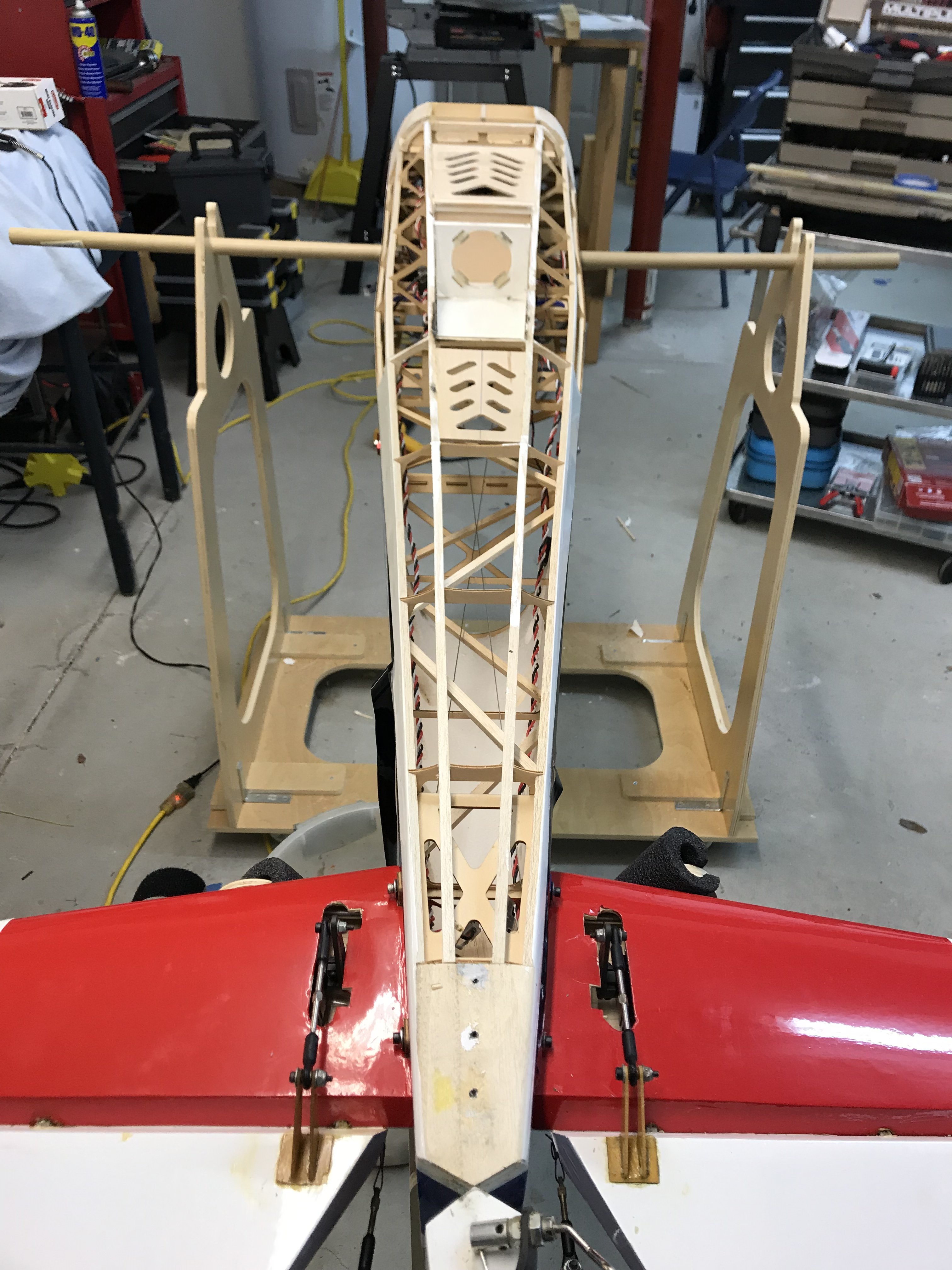

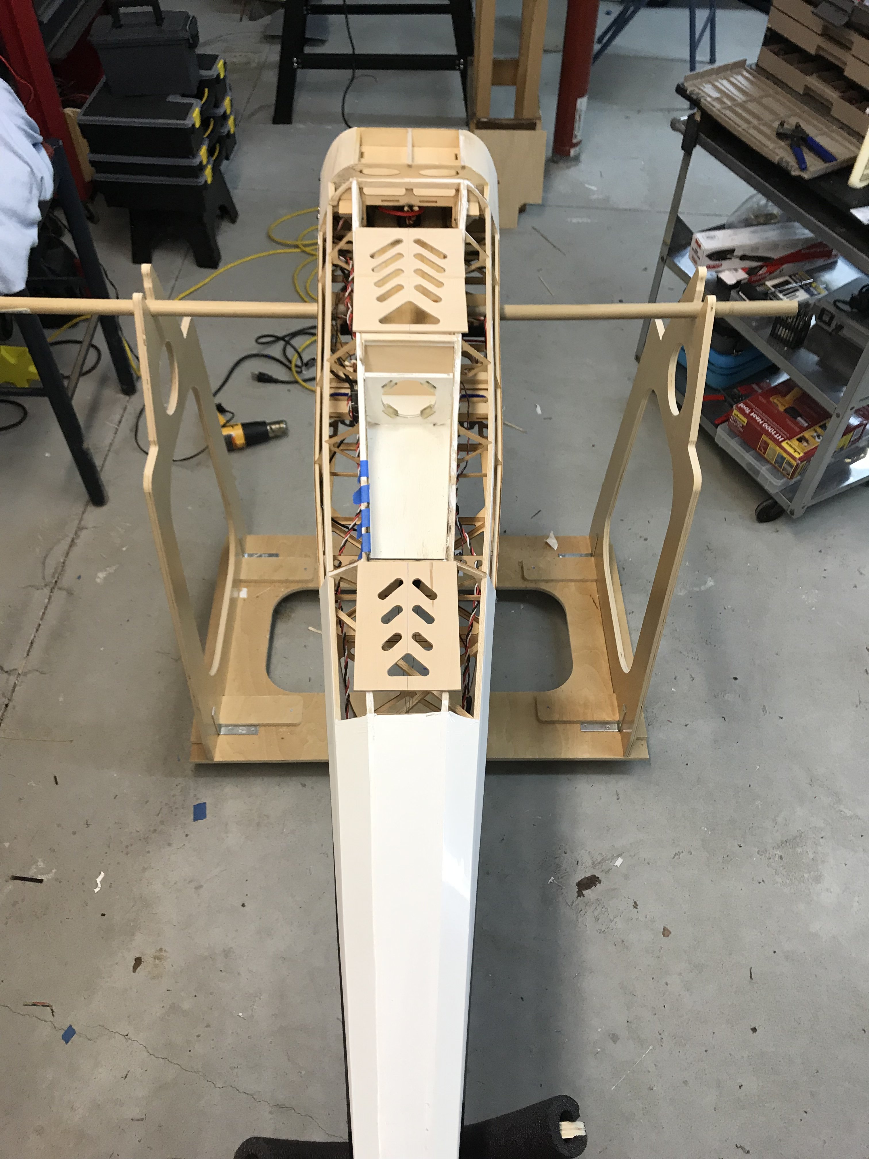

It’s always bothered me that my 88” EF Extra 300 had a big exhaust opening for cans from it’s previous life as a gasser. I bought it used and set it up for electric. The bottom of the plane was a little rough and it had slight balsa damage from the gear bending up at the ends of the flat part.
Did a little repairing and updated the vents. New CF gear is on the way.
