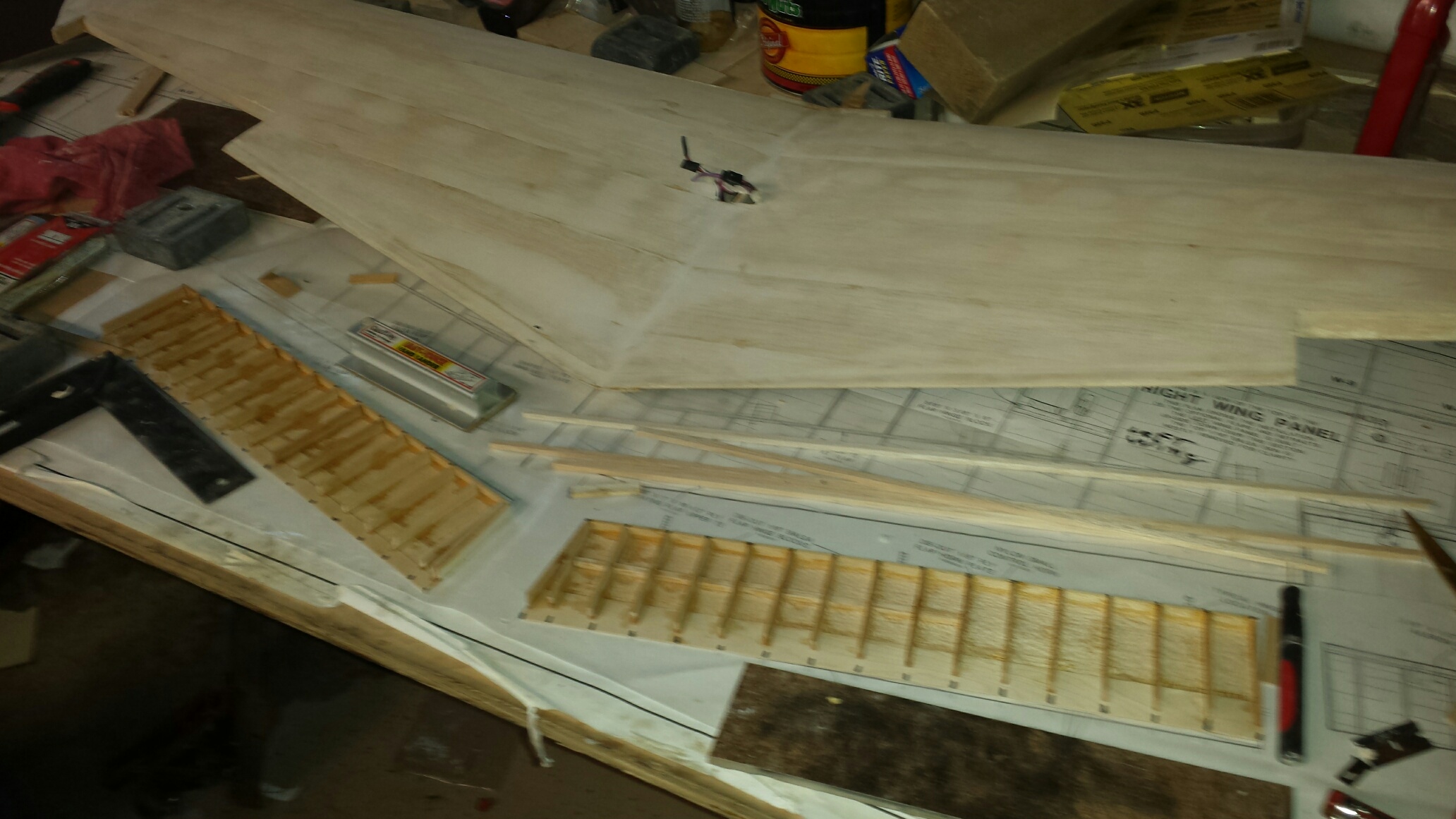

Helped it a little so rewet the flap and put it back on the flat furface and reclamped it and will let it set for a couple of days this time and see if that works
 Success Wetting then clamping on a streight edge for 24 hours worked so finished the flaps today and then started work on the alerons. Im Going to use Robart super Hinge  Point hinges to hinge the flaps does anyone have any experience in installing these and could give me some pointers.
