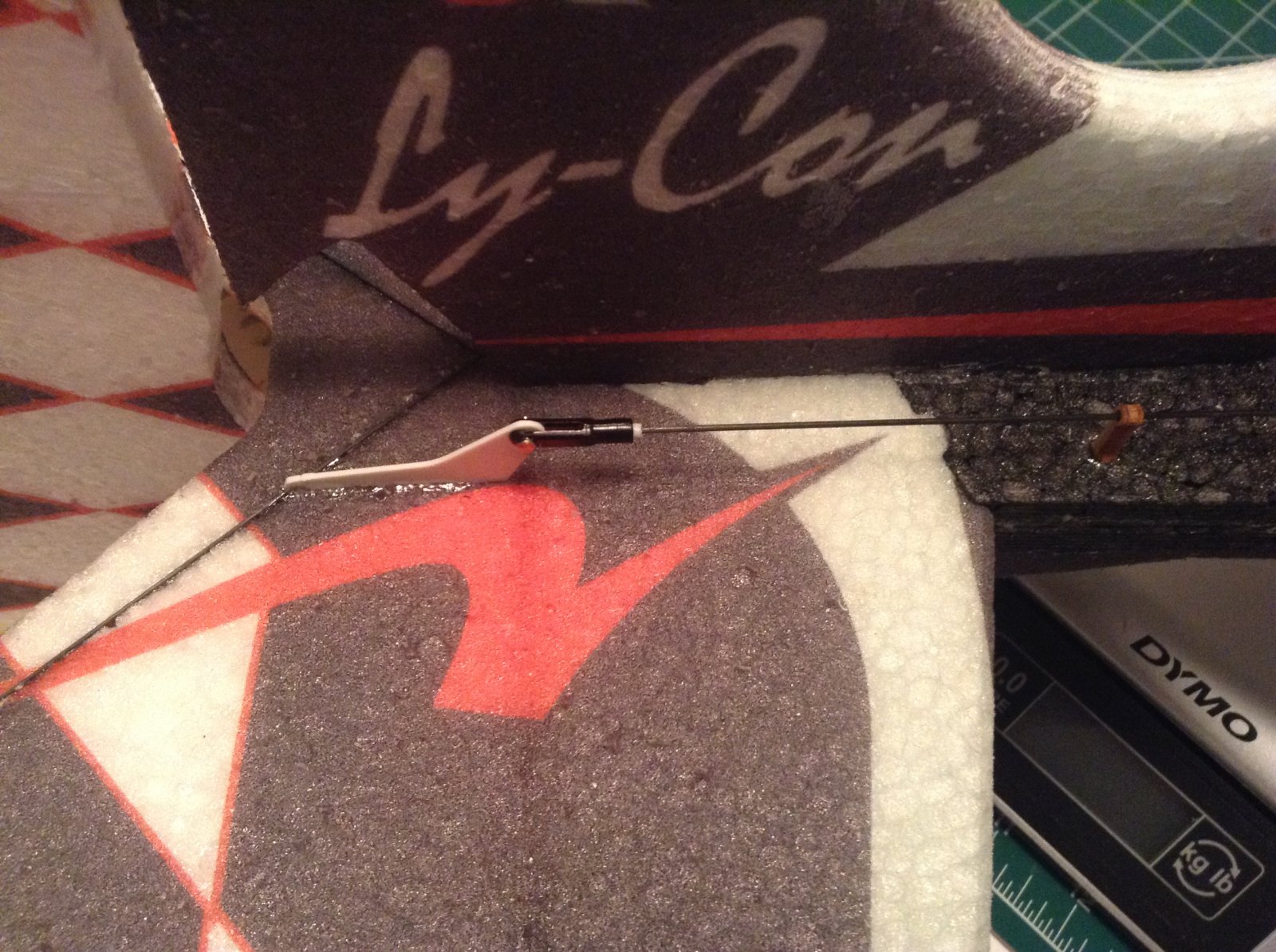

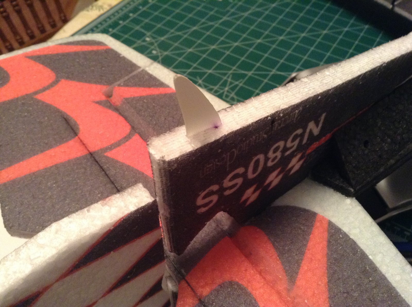

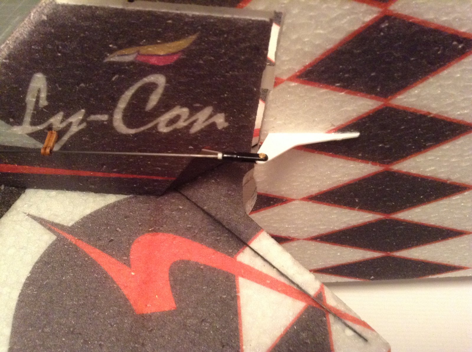

Cut a slot and install the tail skid

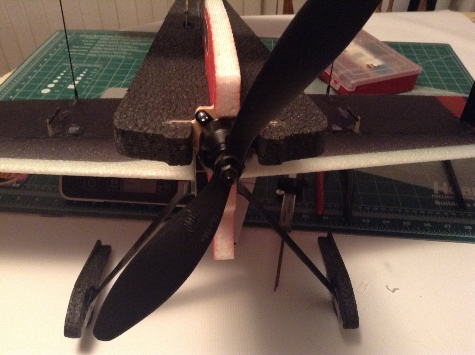

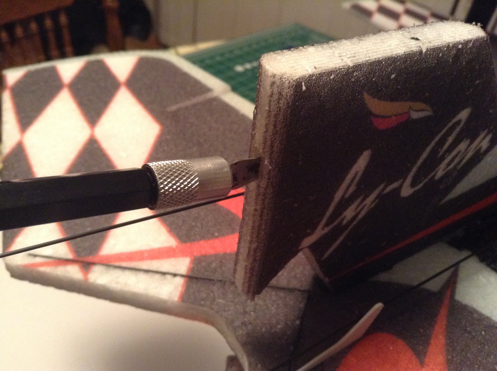

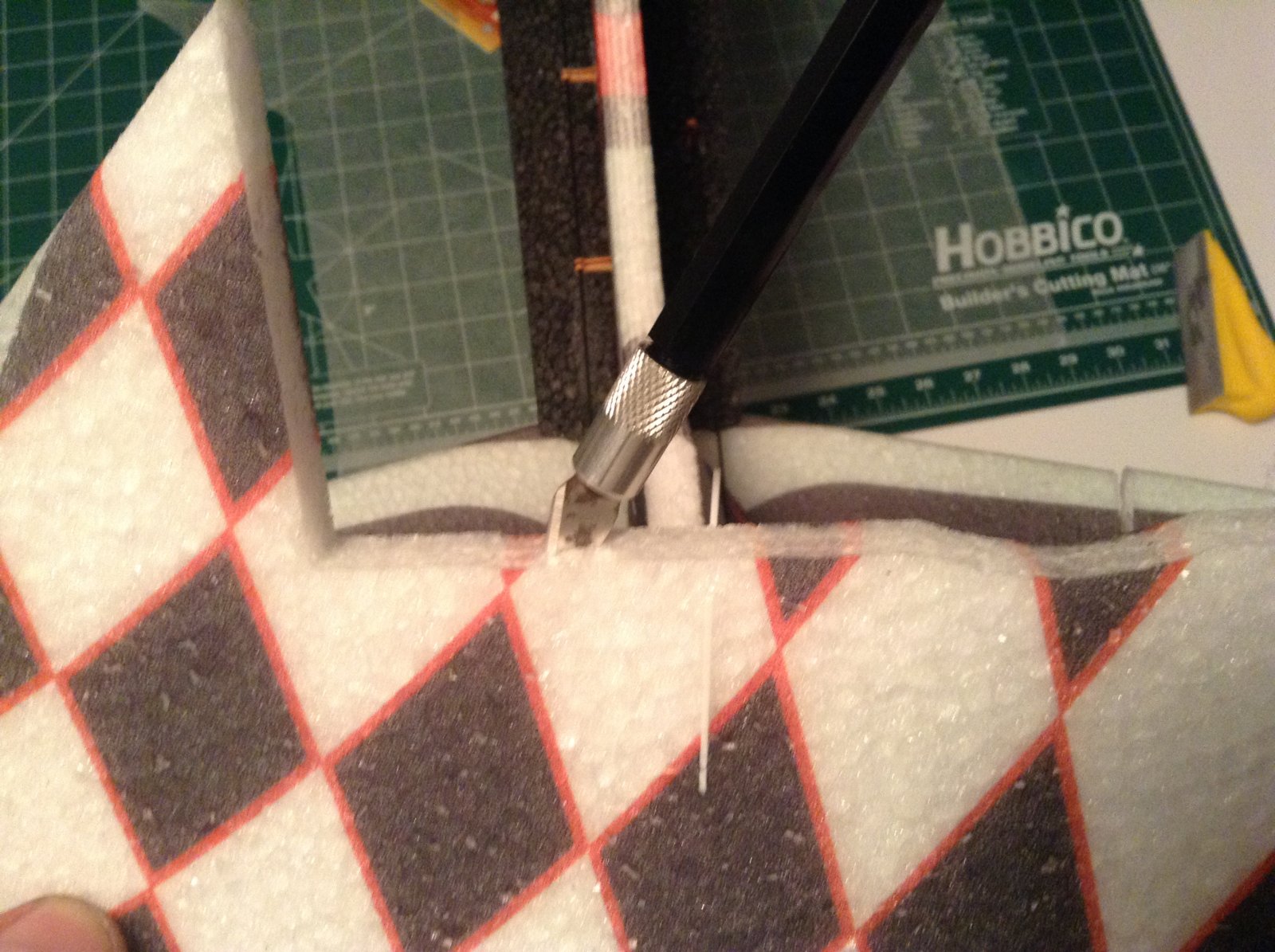

Cut slots for the rudder hinges, thay are marked on the fuse and rudder. It's a slight divot in the foam.

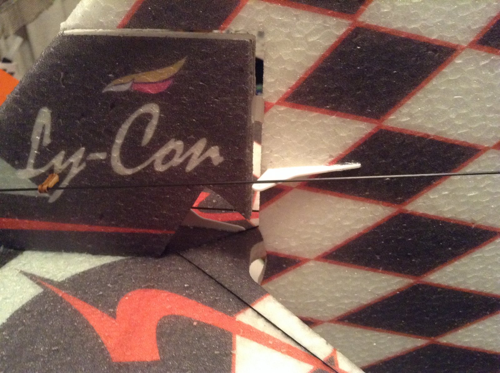

Glue hinges in and install rudder, leave a 3mm gap in between the rudder and the fuse

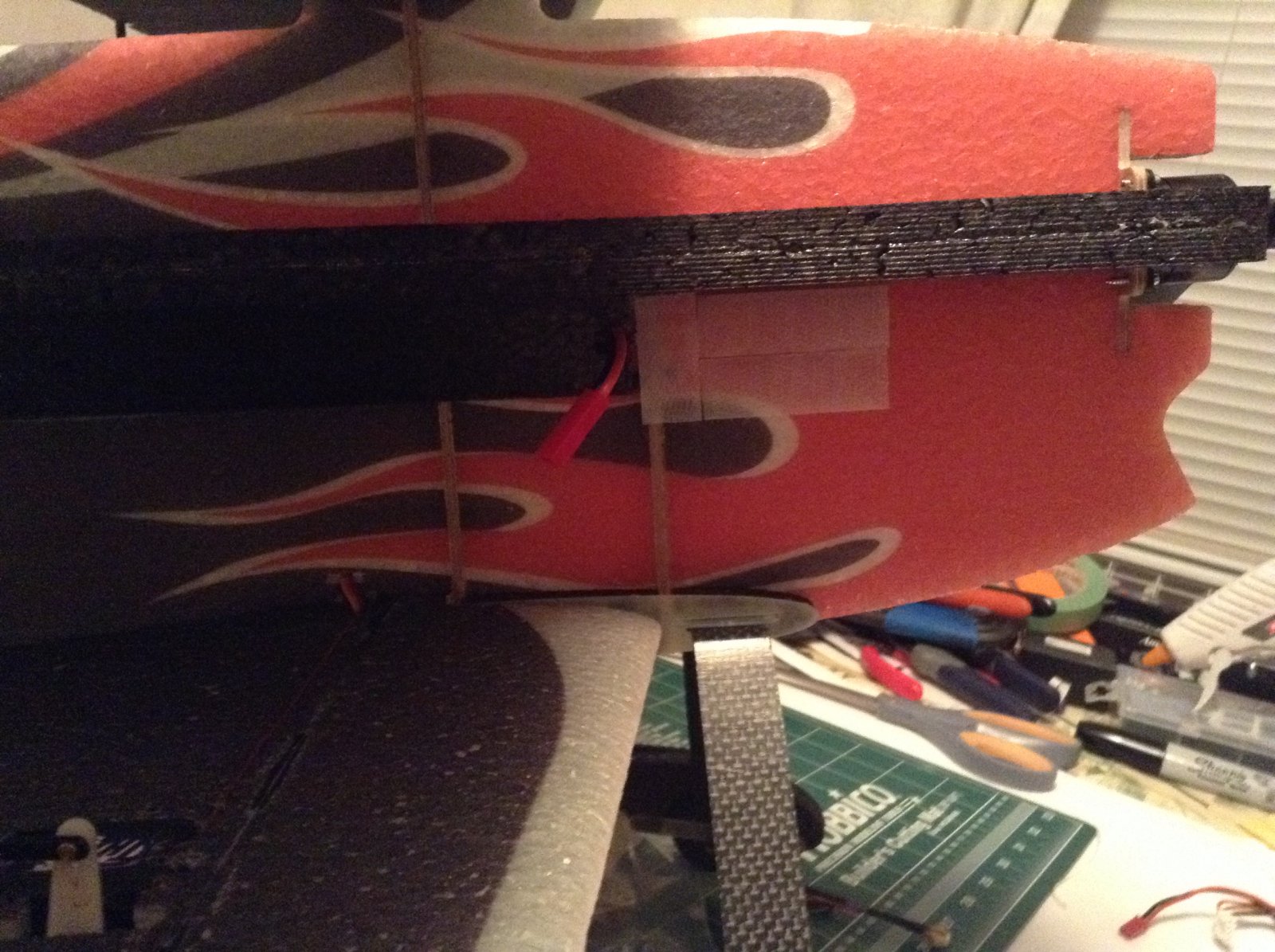

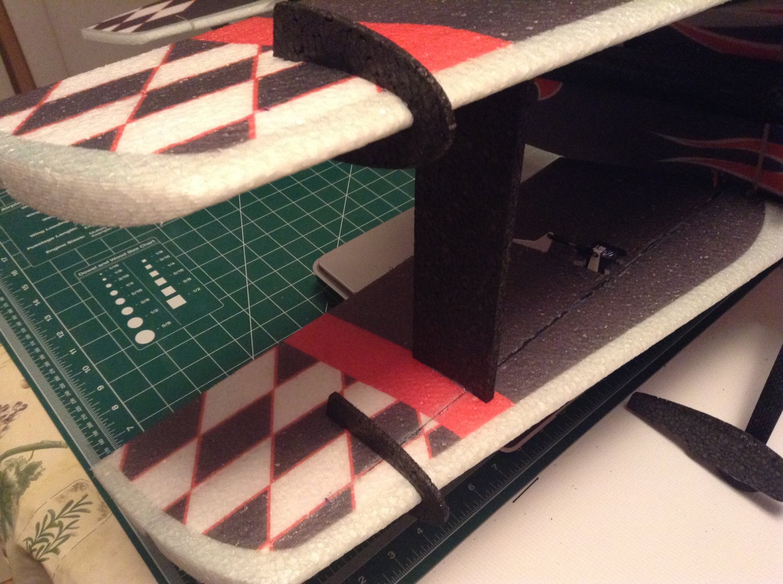

My battery location to meet the 90mm CG point. I thought it was a bit nose heavy, so I added a little more velcro to the rear of the original spot. I did not notice and excessive roll coupling with the battery here, so I wont be cutting a battery slot.

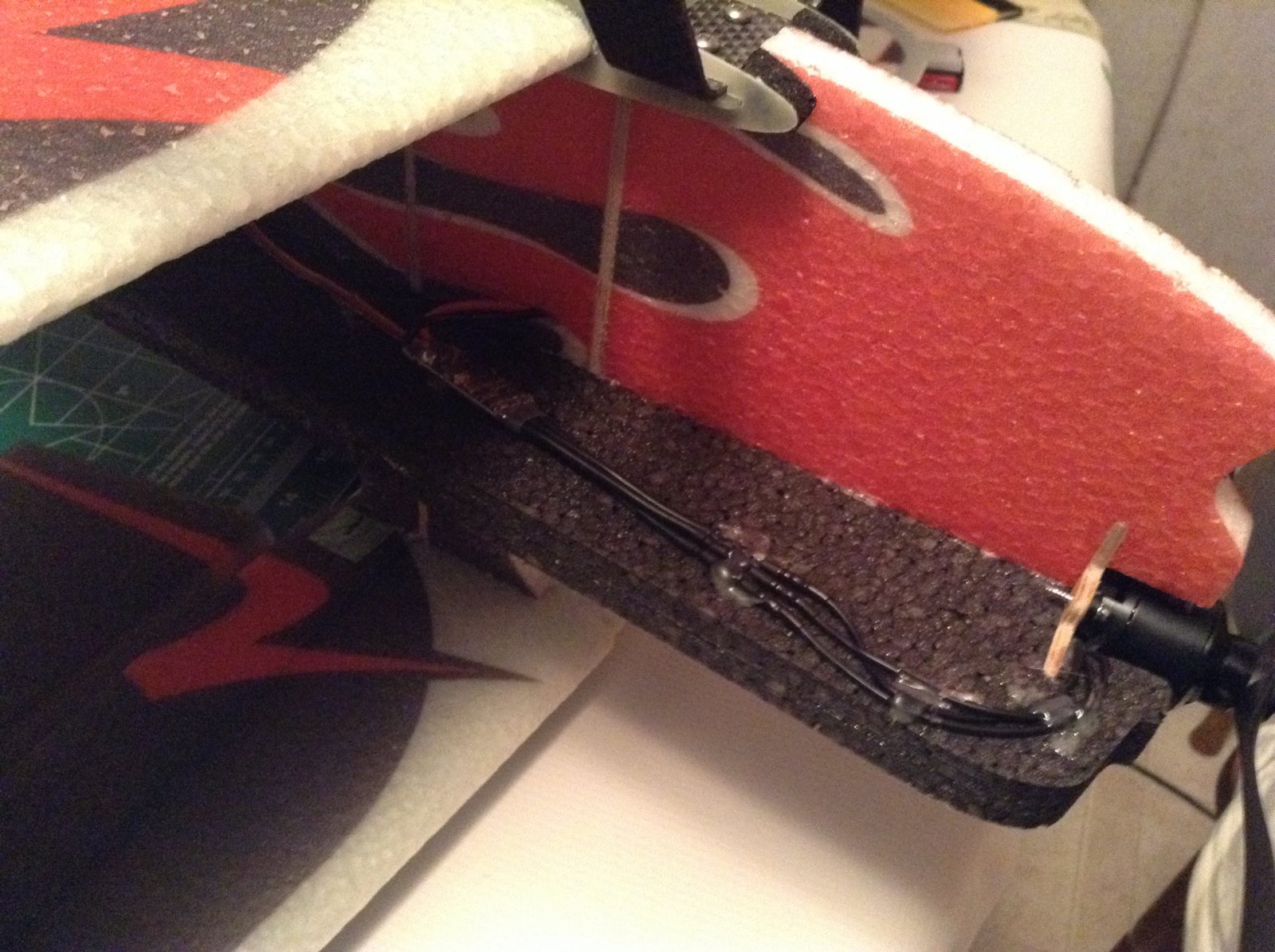

ESC location. You can also see my CG marks on the green tape.
