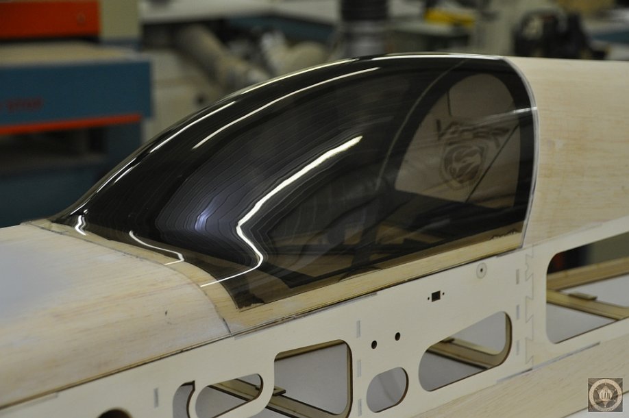

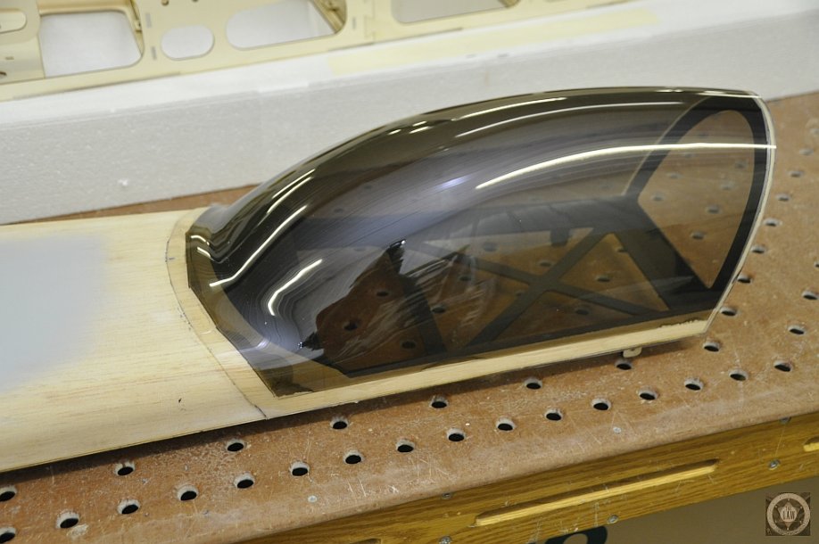

Terry, I know you have answered me before on this... but, In the picture of the canopy where you show both your work, and the Yellow finished one, do you then apply covering over the top of the canopy and hatch to make the seam a nice even transition?
Terryscustom
Nope, no covering on my canopy at all. I will show how to blend in the leading edge of the PETG shell soon with minimal use of filler at that joint. If you want the front lip to completely disappear it should be done and blended in before glassing the hatch. Real planes have a hatch that opens and has an outline so I actually prefer not to have the hatch fully smooth. I'll post a pic with the tape and junk removed soon.....
Terryscustom

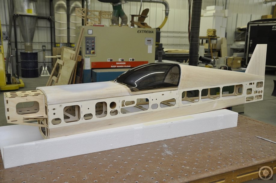

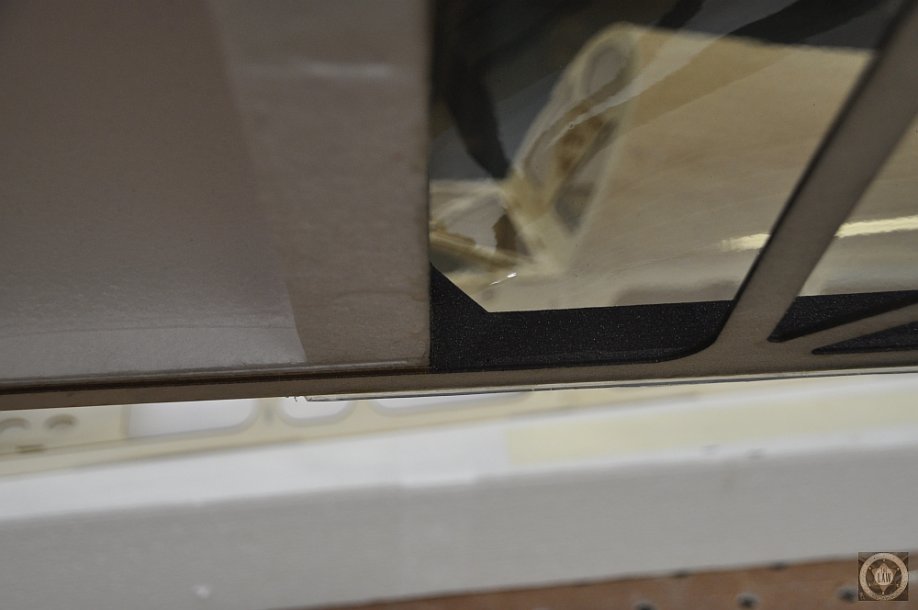

All tape and everything removed and it looks pretty good. Nice thing about Goop is you can run your finger along any excess that squeezes out and it pills up and rubs off. Notice I have a weak 1/16" hanging over at the bottom This will be carefully trimmed with a razor blade and then sanded flush with a block.
One other step that I will do now is put some goop in a syringe and lay a bead of that around the inside of the canopy where the PETG meets the wood. I will let the clearcoat cure for another day first though because the goop is solvent based and it will eat at the fresh clearcoat.
