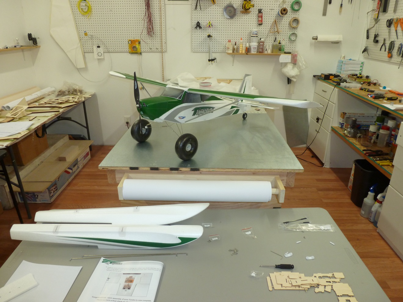

The Tundra is ready to go, charging a battery now and will give it a shot when ready. I did not use the added tail bracing as one side had the wrong plastic end on it. Had to switch two wires on the motor to run forward. And there is a wire out of the speed control that I have no clue what it is for. It has been a very long time since I worked with such confining spaces.
The extra wire from the ESC is for a reversing function. Plug it up to a switched spars channel. When sitting still flip the switch and then start giving it throttle and the plane will drive backwards.
