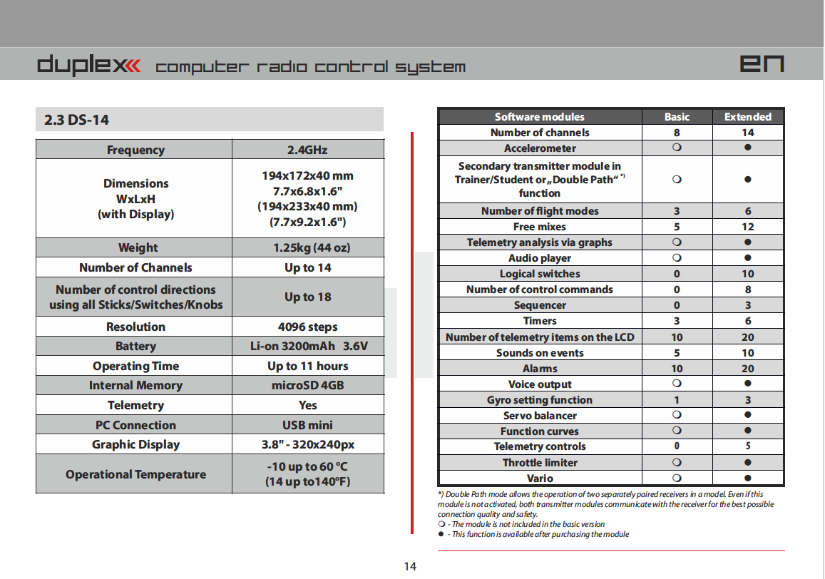

So the JETI DS-16 is 4096 resolution

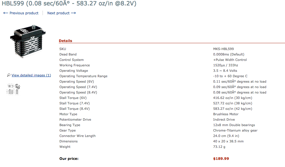

After rereading the servo article and flying coreless servos for the better of a decade i have gotten use to the slower start they have compared to the hyper Brushless servo that are instantaneous speed which makes my flying less smooth .
The issue isn't my Jeti radio rather it's the pilot learning to adapte too this knife edge response my 599 give me.
Here a couple of pages of info .

Thanks guys i too have too press refresh when remembering about servos , good articles.
Look at the response time 0.08 sec for 60 degrees that is dam fast for a servo, that would make any one of us feel that we are over correcting, if we are use to flying standard speed servos. Can you not change in the radio slow the speed down ever so little until it meets your needs.
Rusty 73
I would love tot but Jeti doesn't post much info in adjusting these things, nothing in the manual or on Espirt Jeti vidios about adjust servo speed .
May I offer a little assistance? In my trusty old Hitec Aurora 9x and the new Graupner MZ32, there is a menu from a sub menu that will open a parameter for "SERVO SPEED". On the Hitec, a value of 0.0 to 7.0 can be selected. With 7.0 being the slowest. It increases in .1 increments. Example; 5.4 is slower than 4.3. Or 3.2 is faster than 6.8. Make sense? The Graupner is slightly different. But still same idea. I bought 2 new JR XG11's a couple of years ago. They also had that feature as well. Look in your menu's. I would be greatly surprised if the Jeti does not have servo speed selection as an option.
