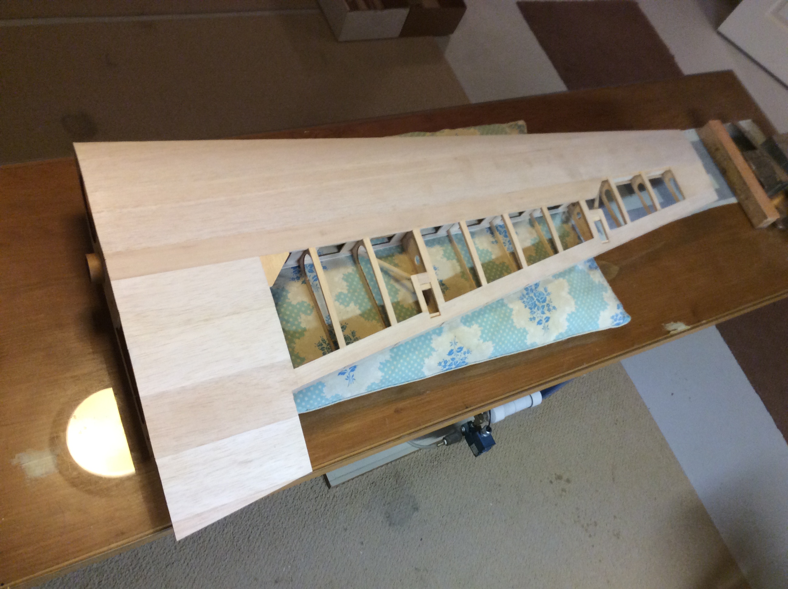

Try to explain my self not any easier but do know what to do when and how to avoid the difficulties I got my self into. Worked on the interlinked shear webs and got them right and fitted properly and did a lot of sanding on the leading and trailing shearweds that also slid into the ribs once I did that it was easy sailing and it is all fitting together properly.
Working on the wing started to sheet the bottom side, should have the bottom done by late tonight. On and of working on the ailerons got the sheeting done and prepared. Decided to go with 1/16 sheeting as suggested by @TonyHallo. Just have to decide how I am going to glue the sheeting to the foam cores.

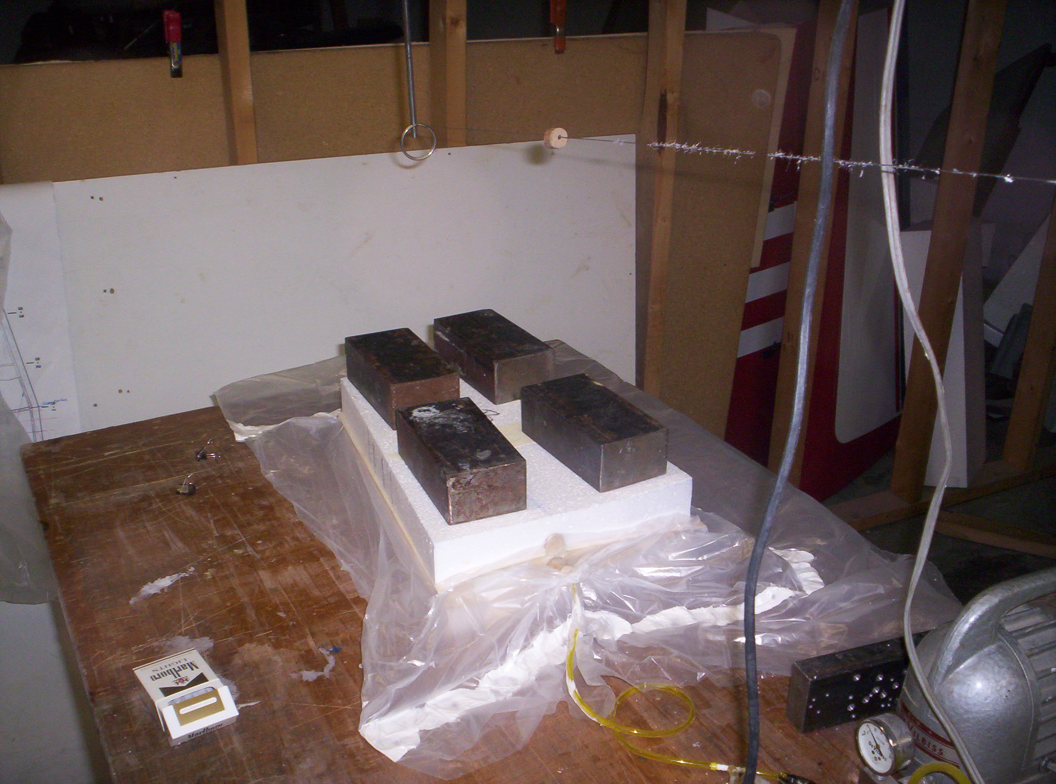

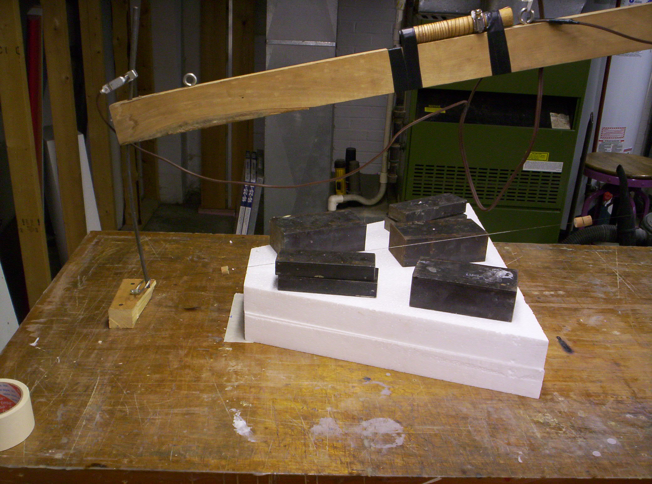

Gorilla poly glue. Not sure what you have in mind, I would cut the blocks weighted down from top cutting both the top and bottom with the top up weighted straight on the bench. Here's an example of a rudder I cut 15 years ago. . Glue to skins with on with the core in the shucks weighted in the same direction. I might glue a 1" wide 1/64 piece of plywood along the trail edge at the same time to add stiffen it up.
Wow you do not fool around that is some serious building and impressive equipment.
I like the hose clamp that you can move on your homemade rheostat to control voltage!
