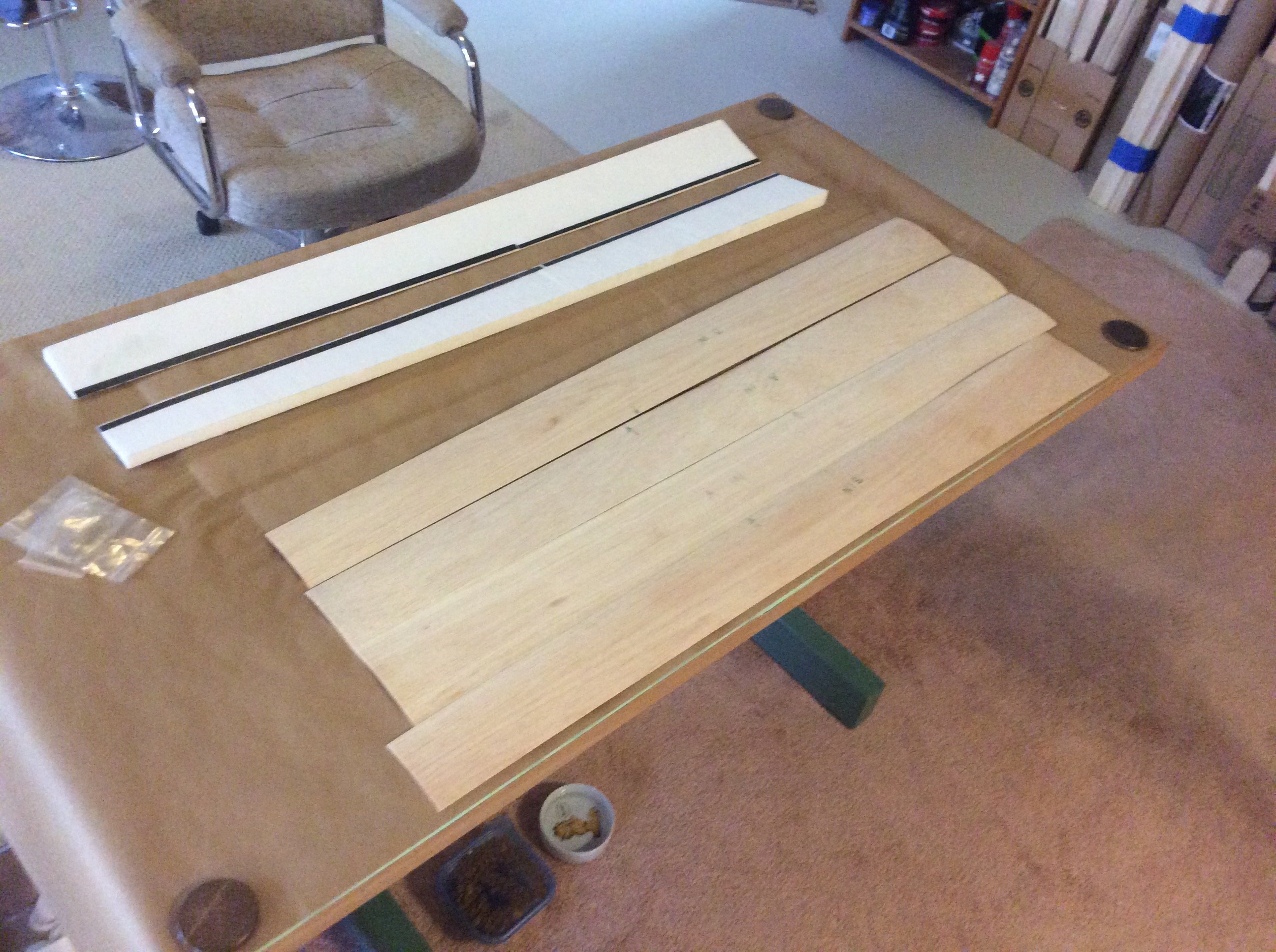

Getting ready to make the ailerons on the table is sheeting and the styrofoam with carbon strips glued in place and preparing everything for the vacuum bag. Will hair spray the balsa to help reduce the epoxy soaking into the wood.

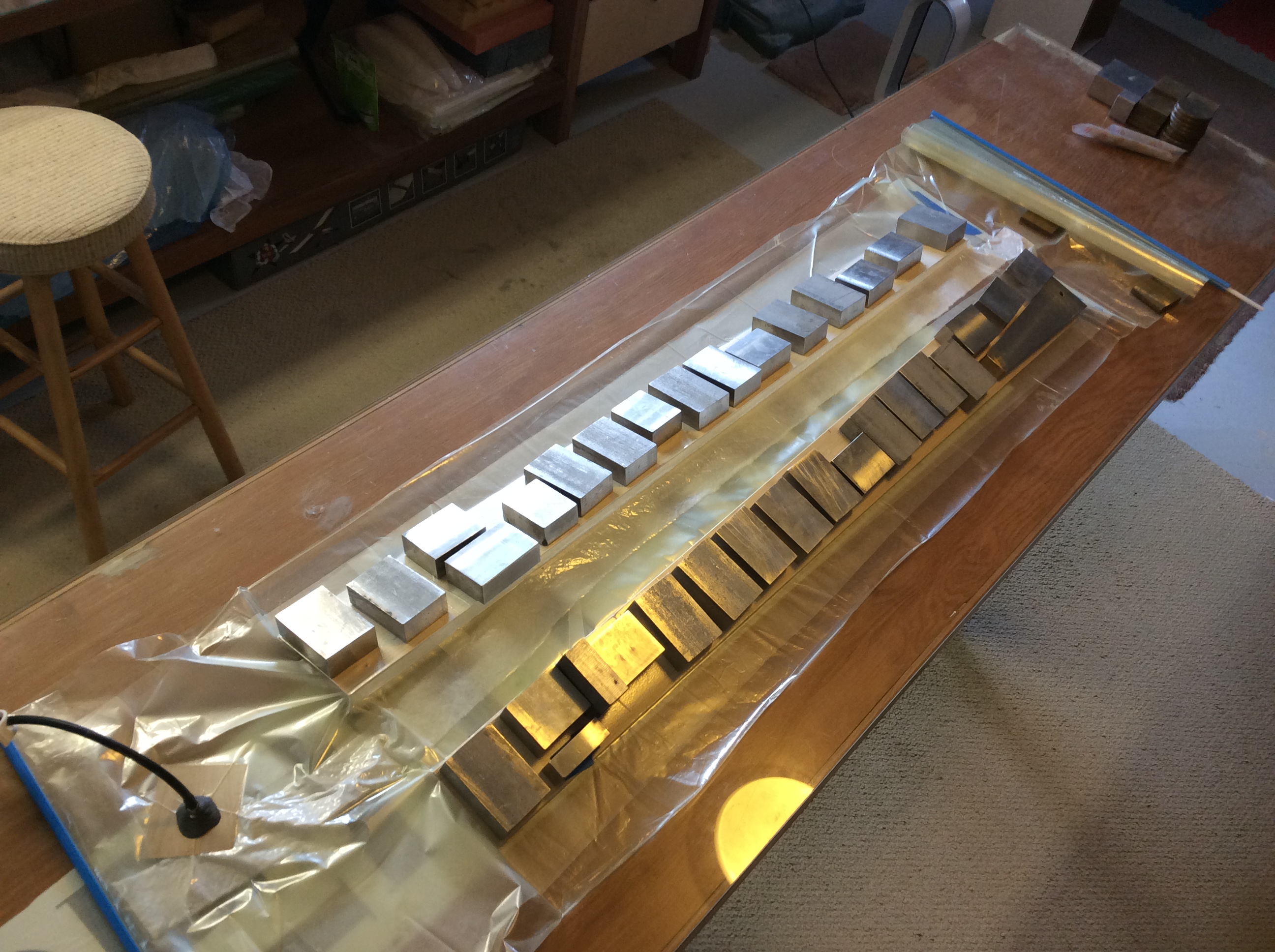

This is a picture of the two ailerons in the vacuum bag. It is all done and now just have give it time hopefully it all works out. It is under 8 inches of vacuum.

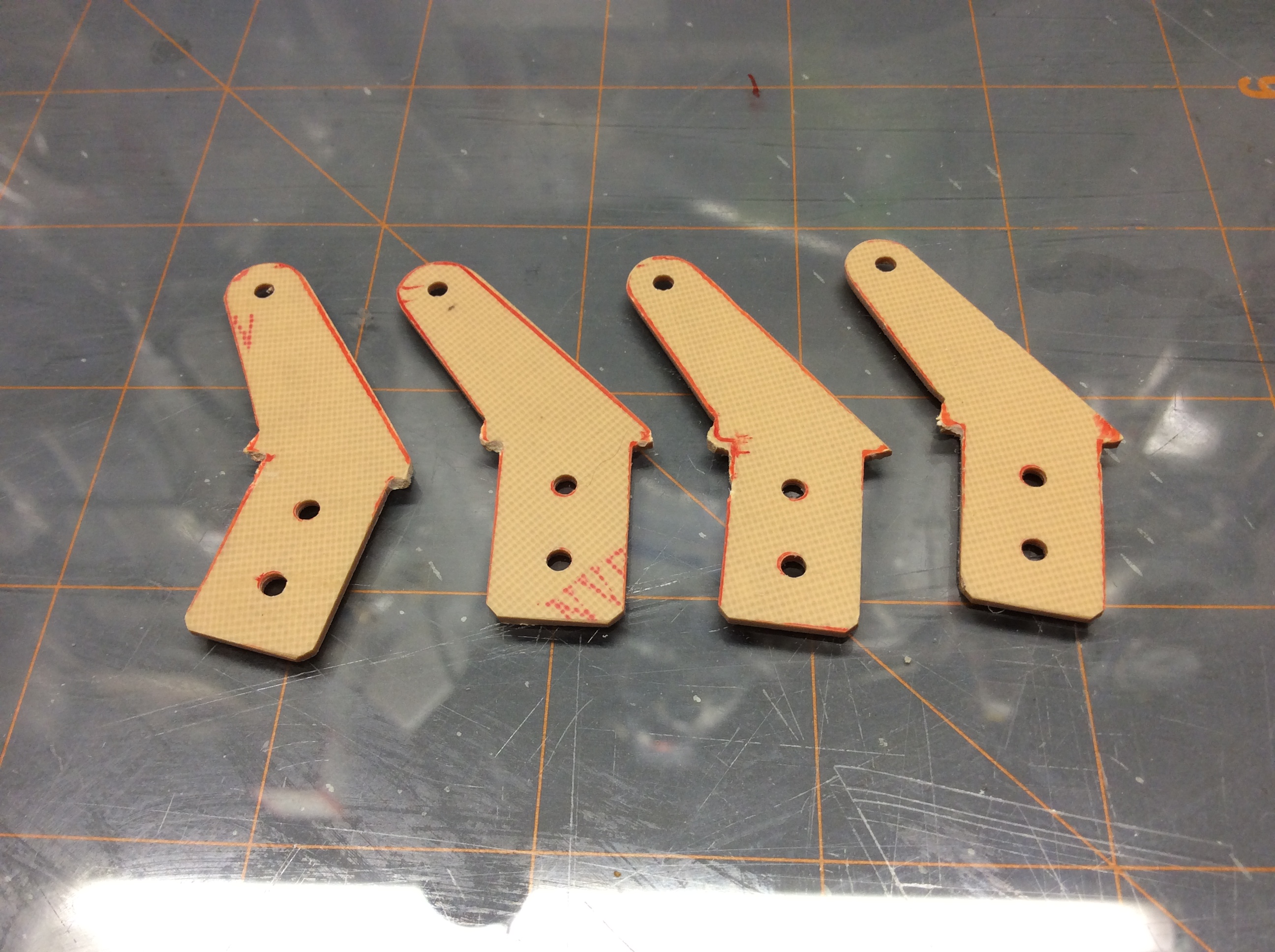

Well can’t sit around all day looking at a plastic bag with some ailerons in it I needed some horns for the ailerons and did not have any and would take 3 to 4 weeks to get them ordered to get to me so I thought why not try to make a few. Found some material that I believe will do the job.
