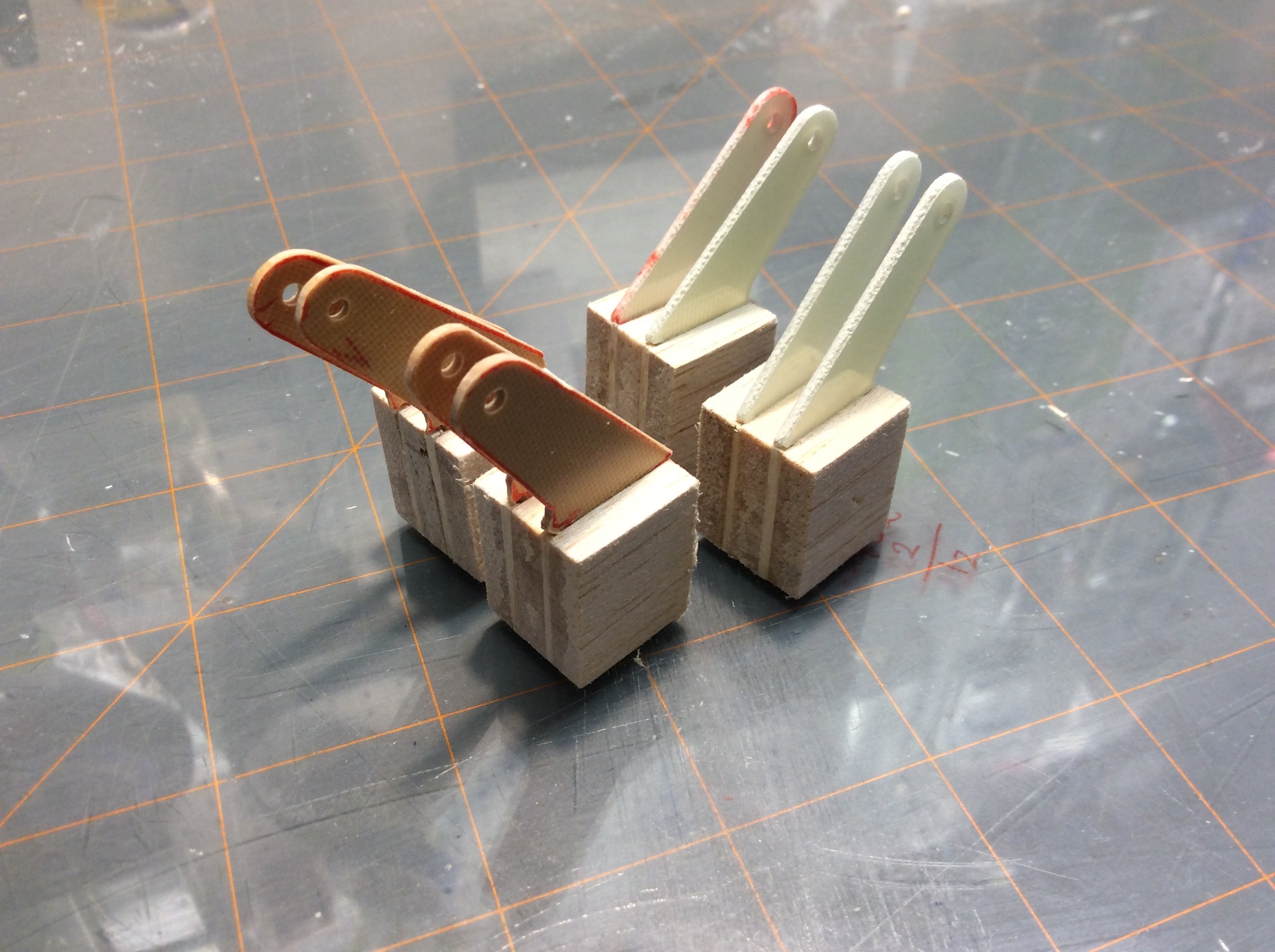

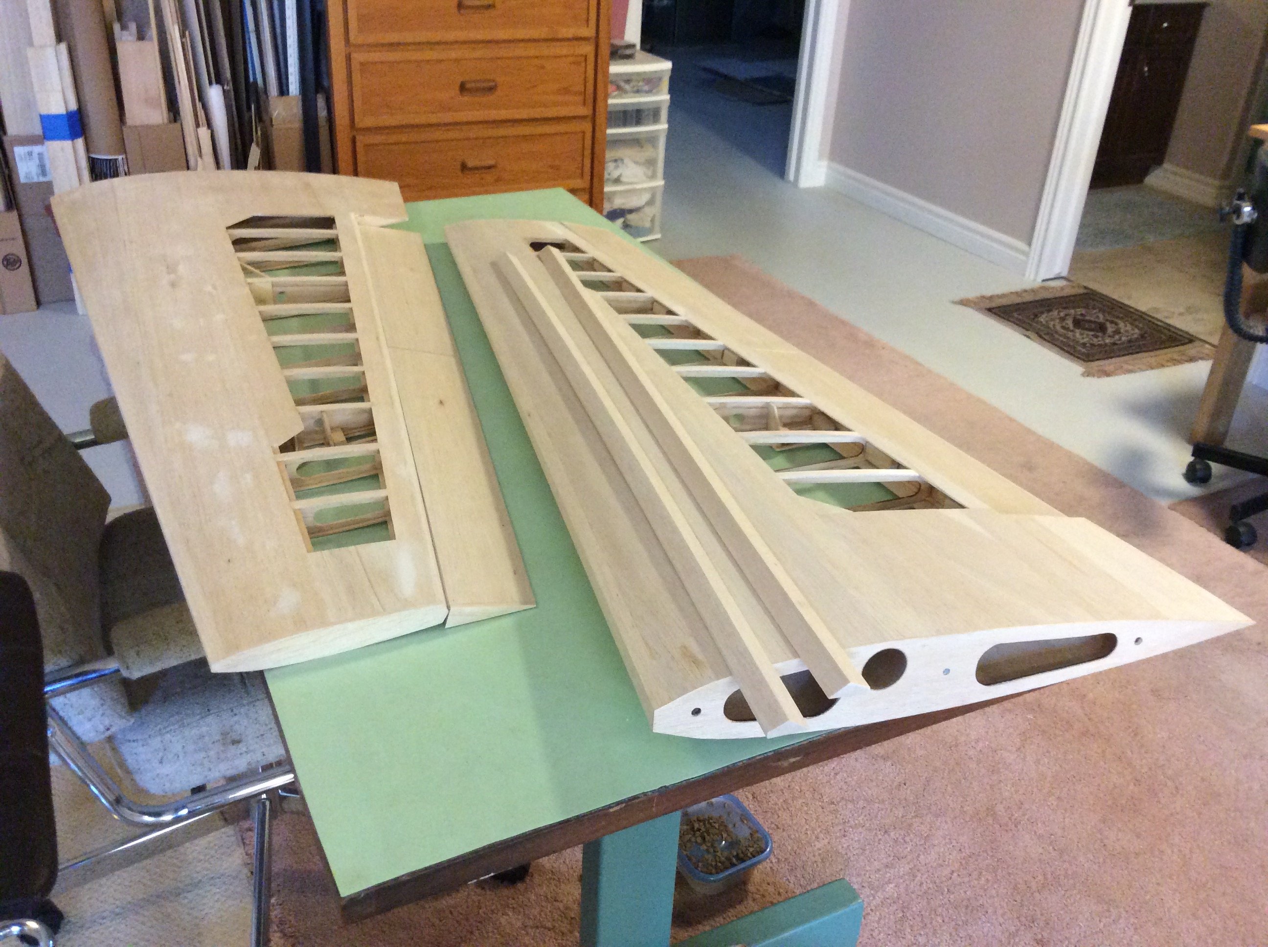

Well the ailerons are almost done just have to install the control horns and the bevels for the ailerons the bevels are cut and sanded and ready to be installed. The control horns are made just have to make the control horn blocks that will be installed into the styrofoam. When that is bone then the bevels will be installed and fitted.
Still have a little work to be done on the ailerons but the weather is really starting to warm up really getting the itch to get a plane out and ready to go flying. Will finish the wings and ailerons but if the weather holds like this and improves the fuselage will be built this coming winter. I just do not have much patience to build during the summer or the will. Much to busy doing plane maintenance and flying, try to fly a minimum of three times a week if the weather will let me.

No I was not but as know when you order stuff from the USA it can take as long as 5 weeks if it ends up in customs and I was not prepared to wait that long because summer will be here and then I will not finish the ailerons. So I made them . Stuff like that I usually do not make it is much easier just to buy it. Thanks for your help anyway.
