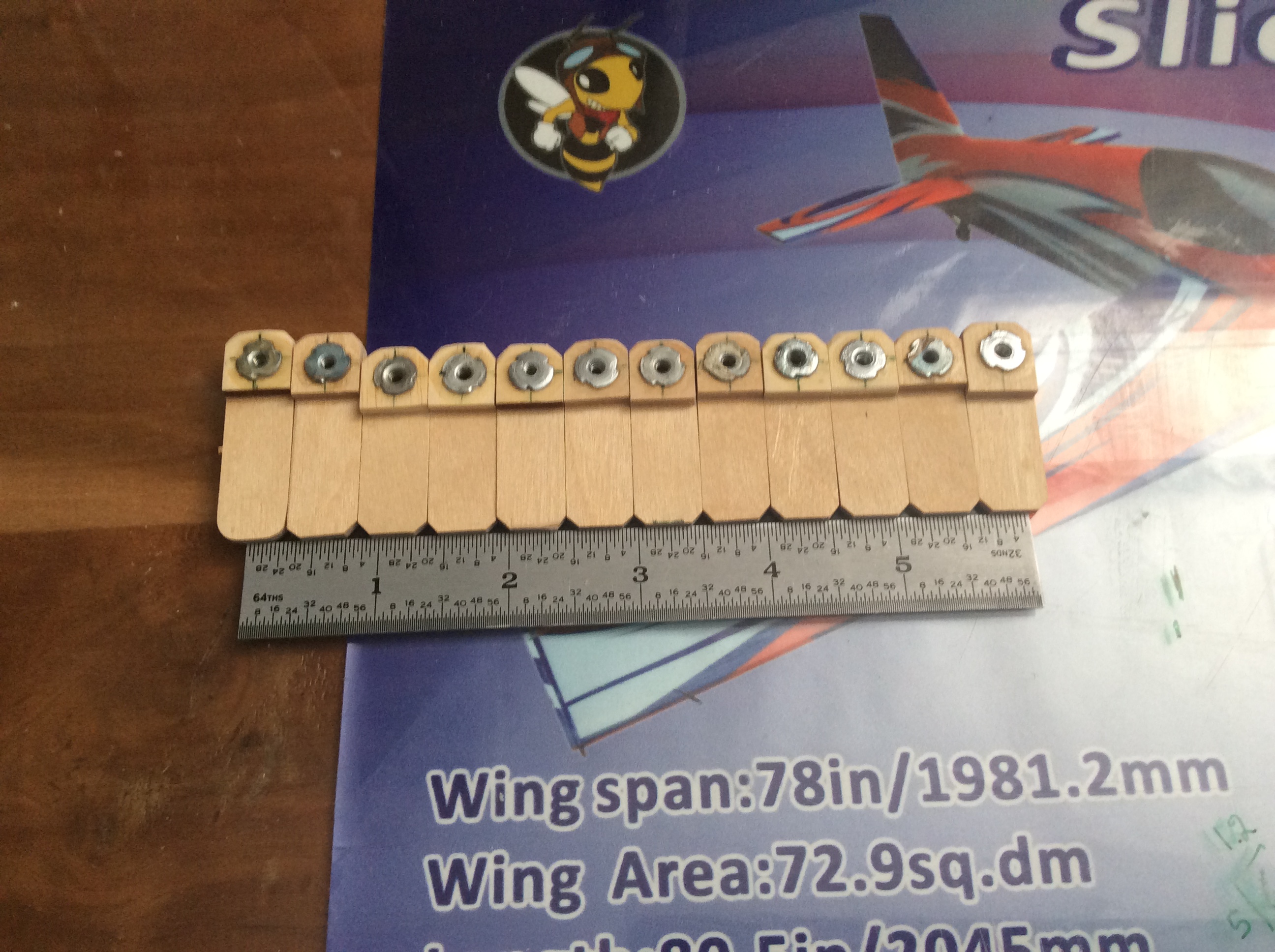

Well got most of it cleaned up and will start the fuselage in the fall, may do small parts or sections of the fuselage when the weather sucks that can be put together in the fall. Thinking of splitting the cowl done it twice so far. Will have to make the bolt connections and the tabs for the cowl.

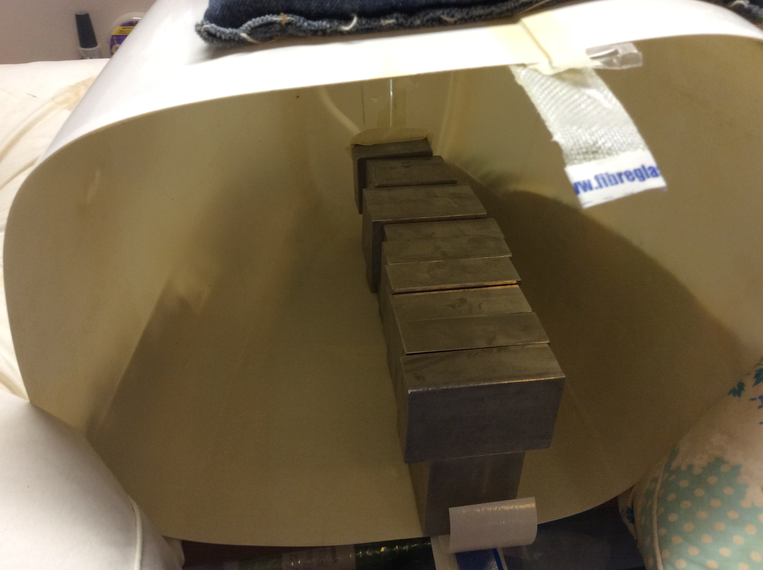

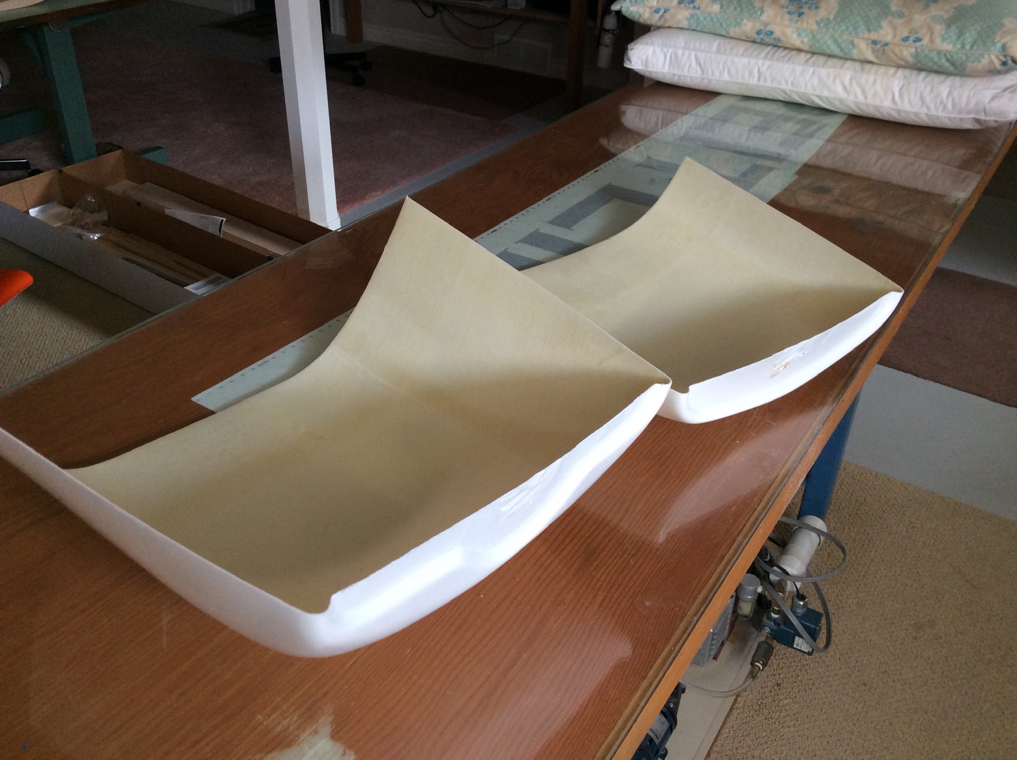

Well it is cut no turning back now have to finish it and get all taped up and glassed on the inside. Cutting wasn’t to bad just a standard Zona saw and 5 minutes later I had two halves.

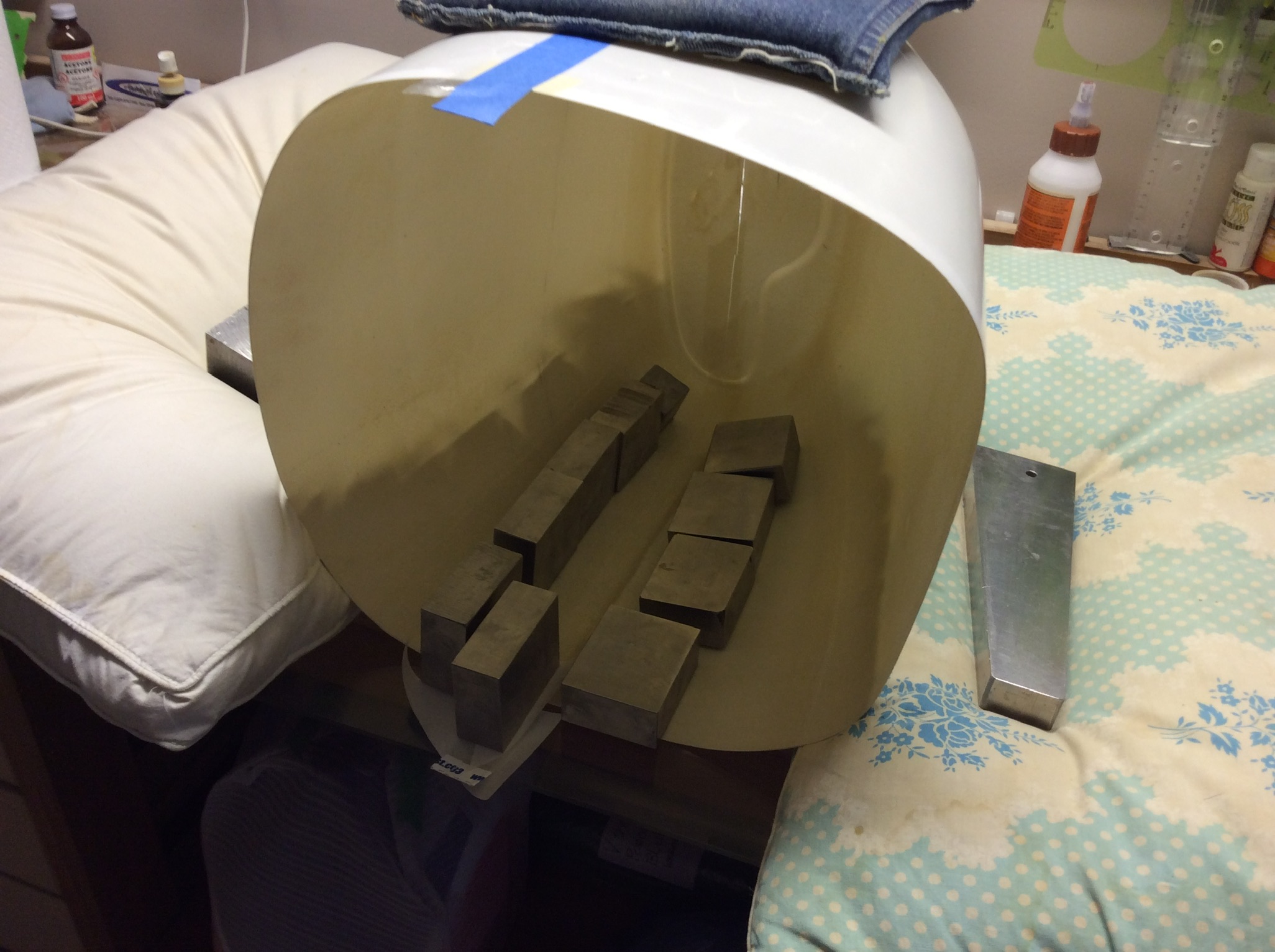

Ok one side is epoxied I hope, the cowl is not good when cut it, it sprung open a lot. So it has been a struggle to get it back into place and shape so that the lip can epoxied in. It took a lot of weight and quit a bit of work it get into place hopefully. Just have let it sit overnight and see what turns out tomorrow morning.
The second side seemed to be more difficult. I was going to take it apart and see how it looks but trying to get the other side to lay flat , it was not happening. So just flipped it over prepared the other side and laid in the Fiberglas. Then added a hole lot of weight to get it sit down flat to the workbench. Well just have weight 5 to 6 hours and see what I have and how well it will come apart. Don’t know with all that weight where all the epoxy is going seep to?.
