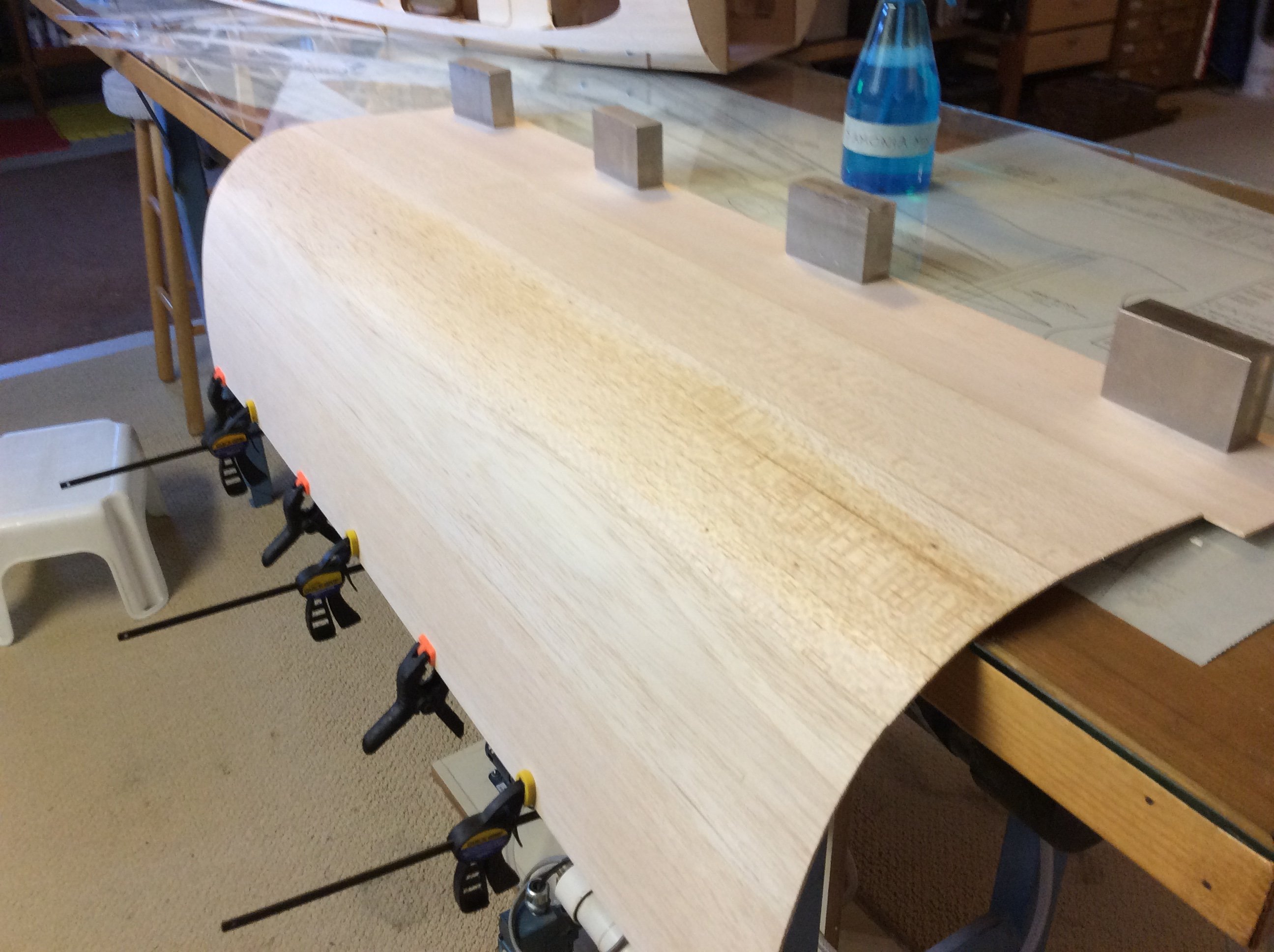

What you need to do is make a pressure tank for forcing some water into the wood. I use, for most sizes, a piece of 4" pvc 4' long with a glue on cap on one end and a threaded cap on the other. The threaded cap has a fitting for the air hose and I will, depending on sheet thickness and how quick I want to get it wet, pressurize it from 60lb to 100lb. No matter the pressure it is sure better than just wiping the sheets down. This also helps a lot when trying to bend a curve into balsa and even more so with hardwood.
You know, when your wetting that to get it to bend down you can run your covering iron on high over it wet and it will make it bow.
Ammonia also helps to get the wood to bend, the higher the concentration the better.
It does the same in either, expands the outer surface of the wood. Another cool trick with water and the heat is a method of gluing I use when I sheet an airframe, especially wings. I apply an ultra thin layer of wood glue on both surfaces such as ribs and the sheeting where the ribs touch it, let dry to the touch, place the sheeting in position, spray the outer surface with water and using the highest heat iron the sheeting in place. The heat will reactivate the wood glue causing it to glue together and the steam the heat generates helps soften the wood for shaping. This works extremely well but I would advise trying it once on a test piece to get familiar with it.
Beautiful Snoopy! Keep up the awesome work. FWIW, On the sheeting tight bends, I found if I place masking tape on the outside radius of the balsa, it tends not to crack when bending into place. Run tape perpendicular to grain. Almost like it holds the grains together to mitigate cracks.
To all you gentlemen I really would like to thank you for your input and help. Some of the methods to bend balsa wood around difficult bends is very interesting, and hopefully I can try one of them on the next job. Like they say you learn something every day. One thing it proves that making balsa conform to difficult shades is a common problem among us in the hobby.
