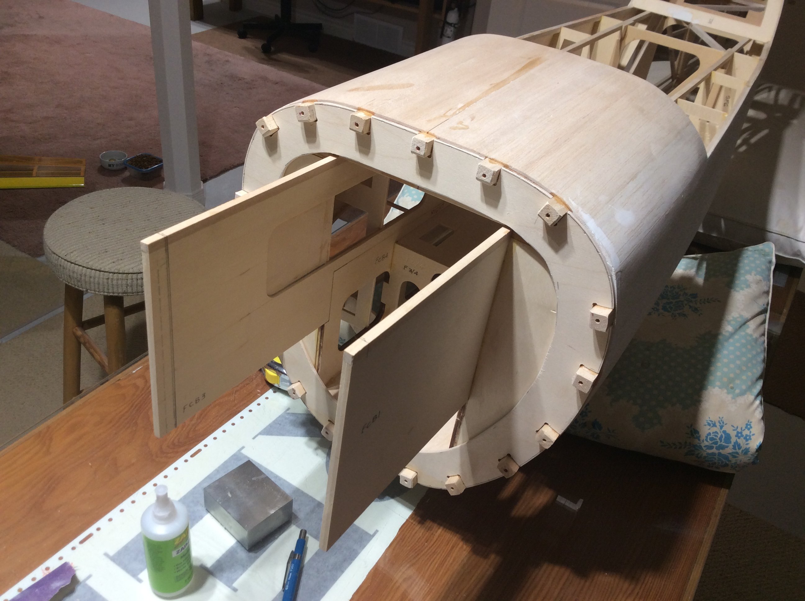

It’s one year and six months later and I am back into the 330L Extra. Got a DA 100L for it and planning the installation.
The first thing I noticed is that the cowl is not cut square and straight so I will have to tackle that first. Also just did a quick cowl fit to the fuselage does not look good the cowl is to big. When cowl is fitted to the top of the fuselage the bottom sticks out the bottom by a good 1/2 inch ?? Not sure how to fix that right now, will have to think about it for a while.
Presently trying to come up with a cowl ring to fit the over sized cowl, and blend into the fuselage.
Well decided to extend the bottom of the fuselage just enough to take up the extra cowl. The landing gear was just bolted to the bottom so I will blend the cowl extension to the gear. So that will now hide the gear to some degree.
The cowl ring is made, so now just glue it into the cowl and finish pinning the cowl attachment blocks.

Are you going to glue the ring to the cowl? Glad to see you're back on this build, have a kit on the shelf and want to know how it ends!
Yes the ring will be glued into the cowl. The holdup was what engine was I going to buy for the plane, ended up with a DA100L.
