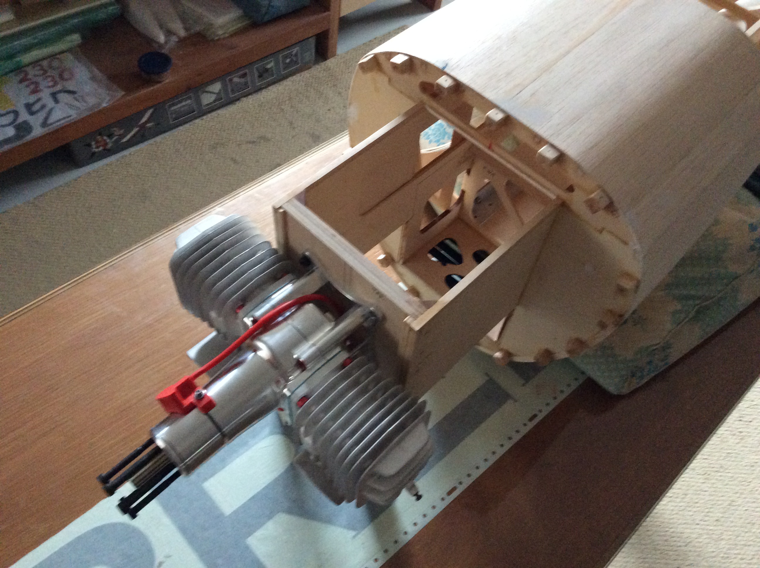

Ok big moment the motor is on the front, and it looks good if I may say my self.
Glad I did not take the 120 because it is just over three eights of an inch wider it would not have fit with in the cowl with out having to make some blisters. It just fits.

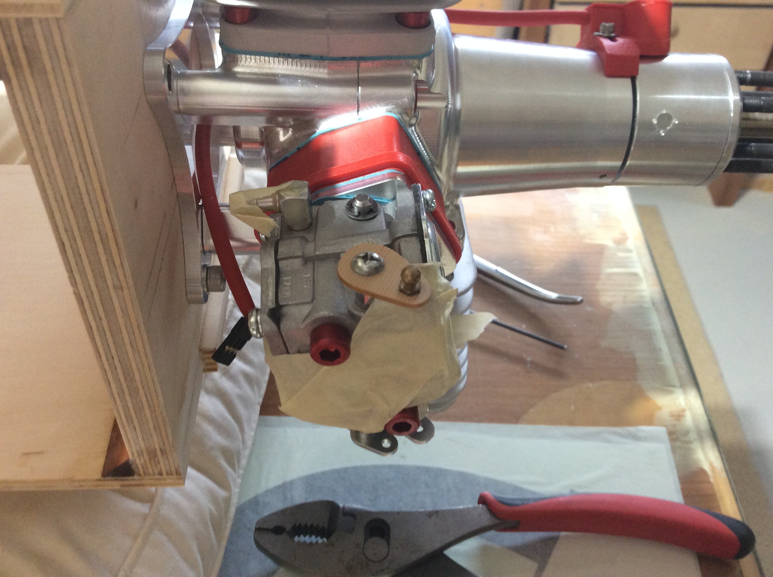

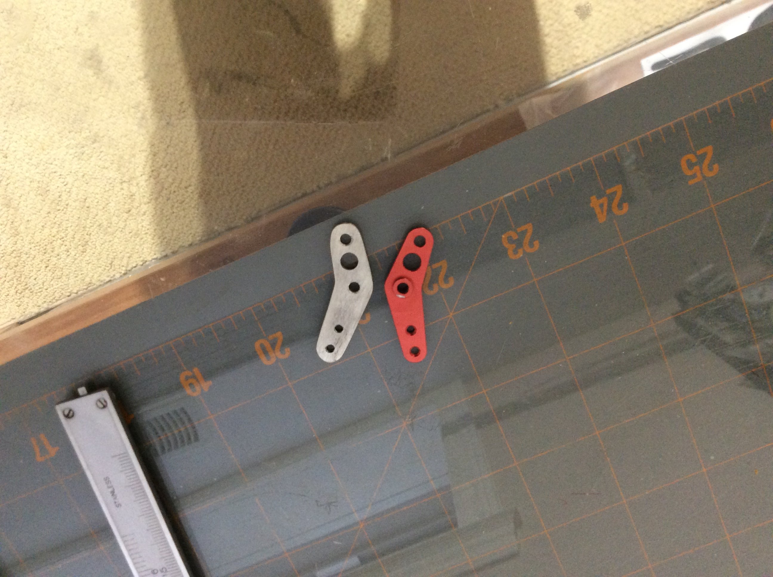

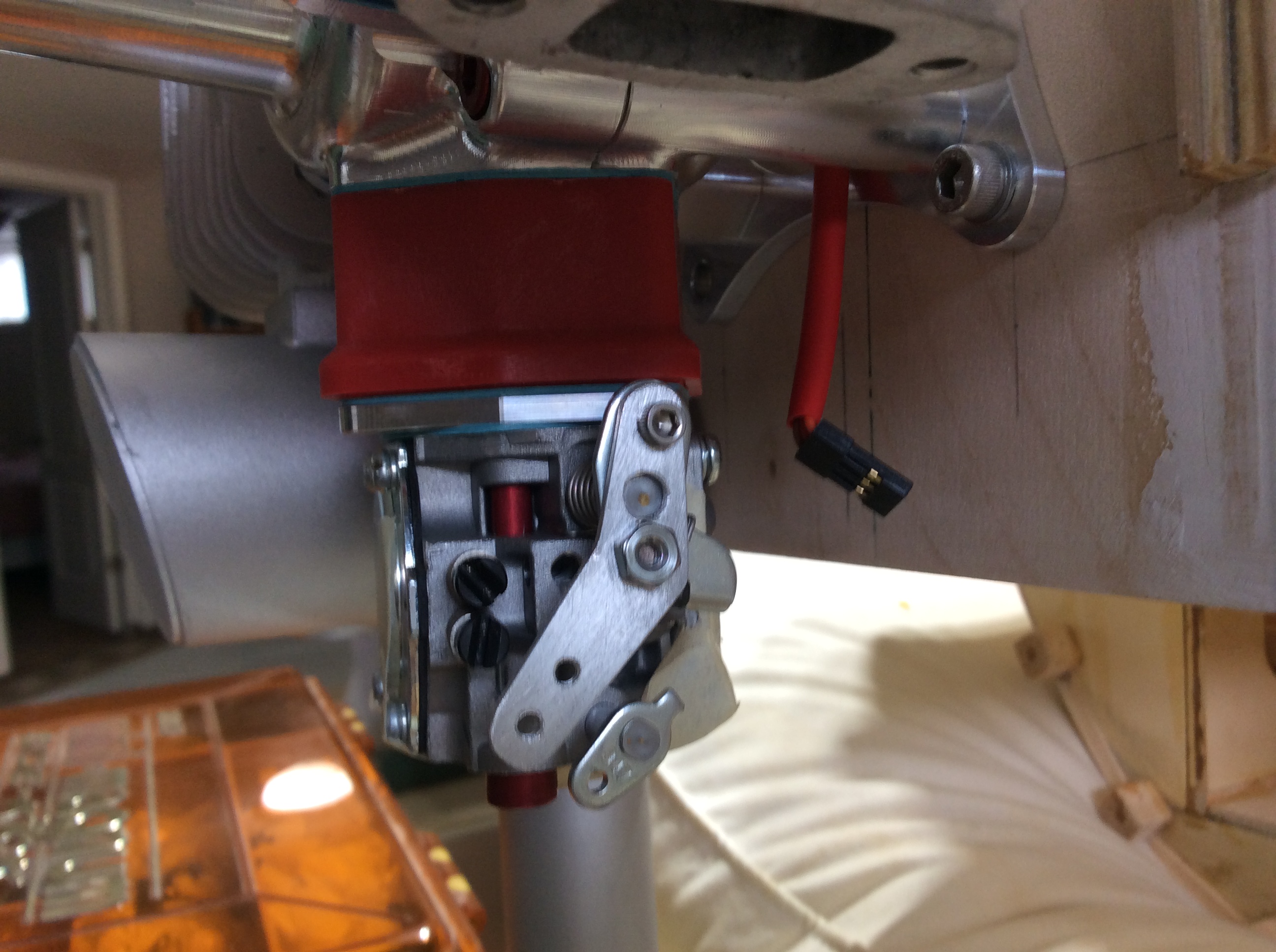

Started on some of the small details the throttle arm that came on the engine did not fit the situation so needed to make a new one. Changed it upside down and reversed the angle. The one in the picture should do the job.
Another piece of the puzzle done now I can have straight push rod from the servo to the carburetor. Just need to put two small locknuts on the arm and then it will be done.

Will need to build a drop box on top of the motor box for the ignition there is insufficient headroom for the ignition to sit on top. Especially with a twin it is always best to mount it on top. This allows for good wire support and runs to the plugs.
