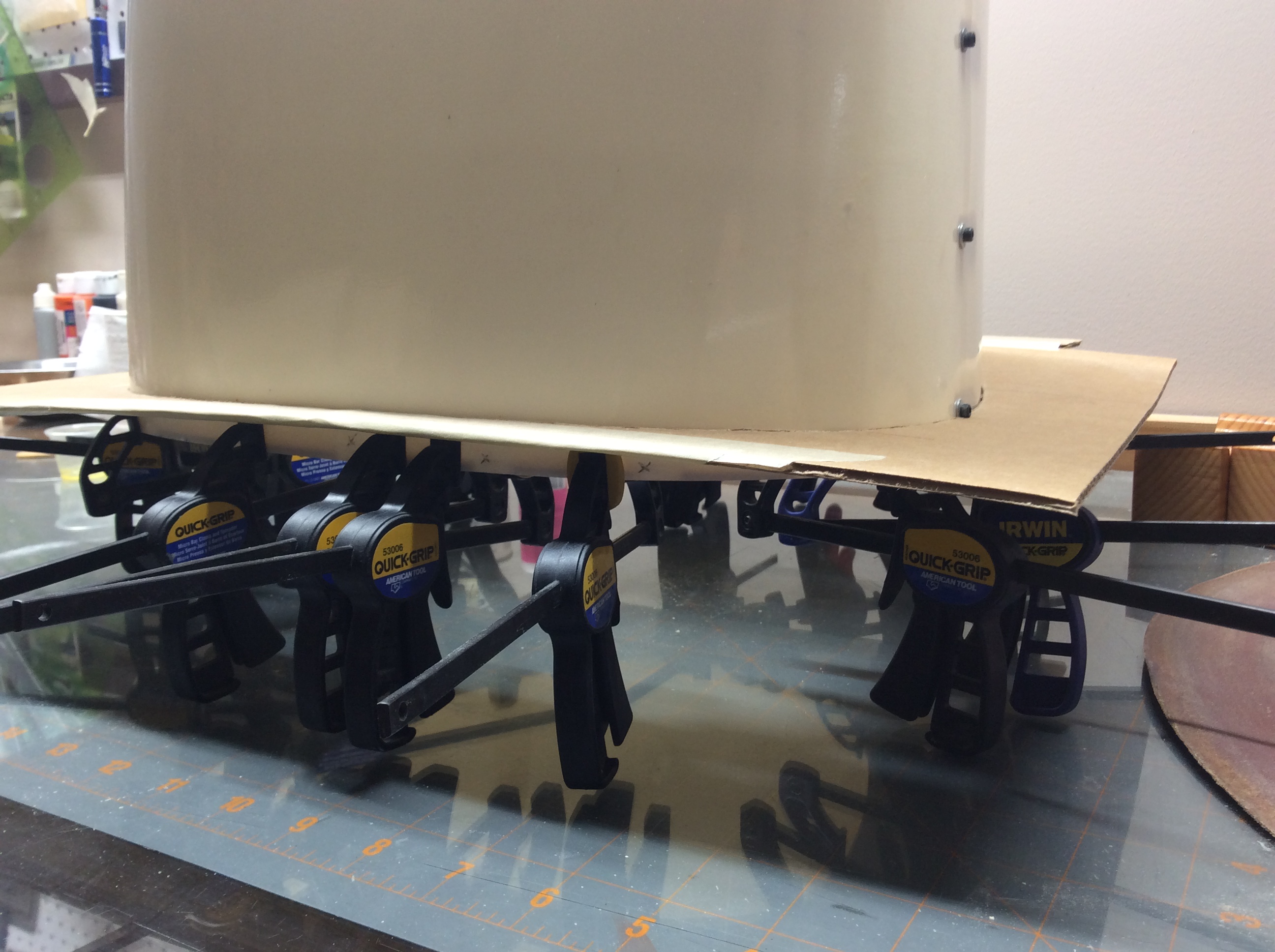

Ok that was fun “NOT” the cowl ring is in and clamped into place. Layered some epoxy around the inside perimeter of cowl and the light ply ring. just have wait 3 to 4 hours to see what I have ended up with. Probably will take a little work to get it to fit nicely to the fuselage time will tell.

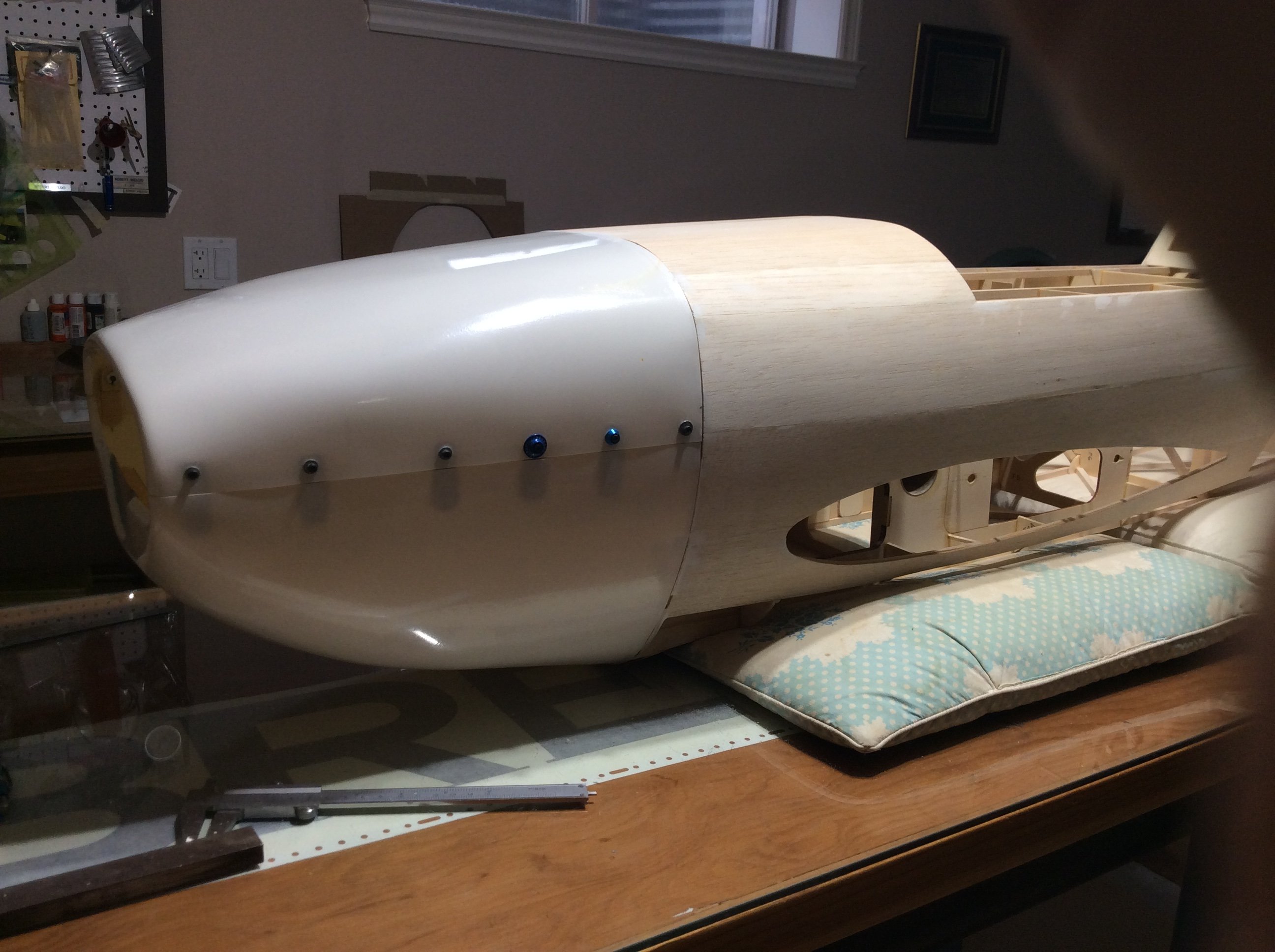

The cowl ring went on great. Spent the day fitting the cowl to the fuselage. Sanding and filling gaps so that the cowl and the fuselage blend into each other, and flush around the perimeter.

Cowl is on and set so that it lines up with the fuselage. So bolted the engine in and it looks like the engine is placed one inch to high in the fuselage. I am stumped. Doing a bunch of research found and very old RCM article on the plane and they ran into the same problem and mentioned that if you drop the engine down an inch then everything will fit. Then found another article by the designer not to do that to leave the engine in its correct position because it will cause some coupling difficulties, and what ever else.
Will be making more changes to the cowl to make everything fit what a pain. One thing that will not fit is the recommended five inch spinner, that will have to probably go down to a four inch. Oh well one spare five inch spinner.
Just to see how it looks Moved the front of the cowl up to and match the five inch spinner it looked ridiculous.
