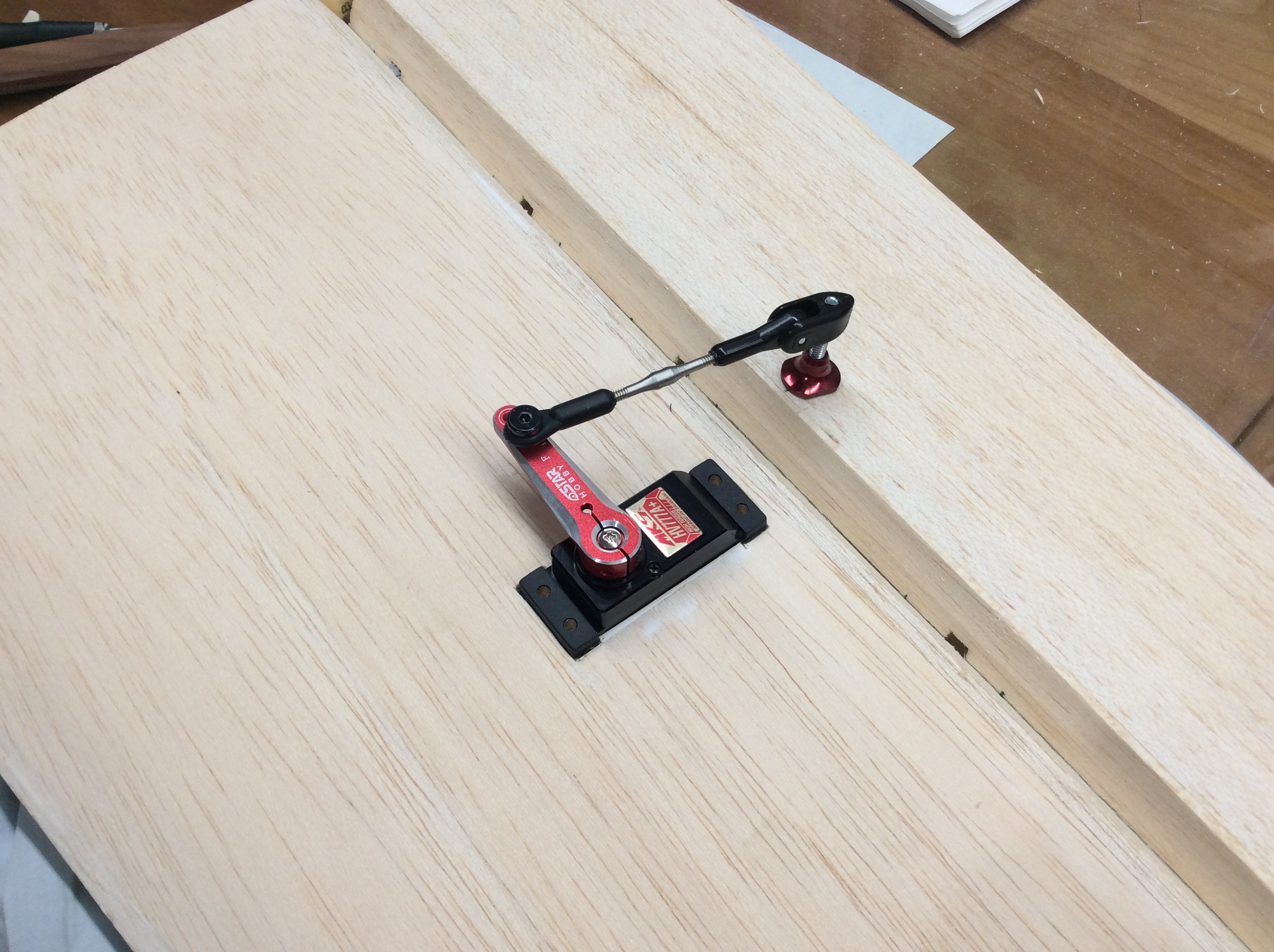

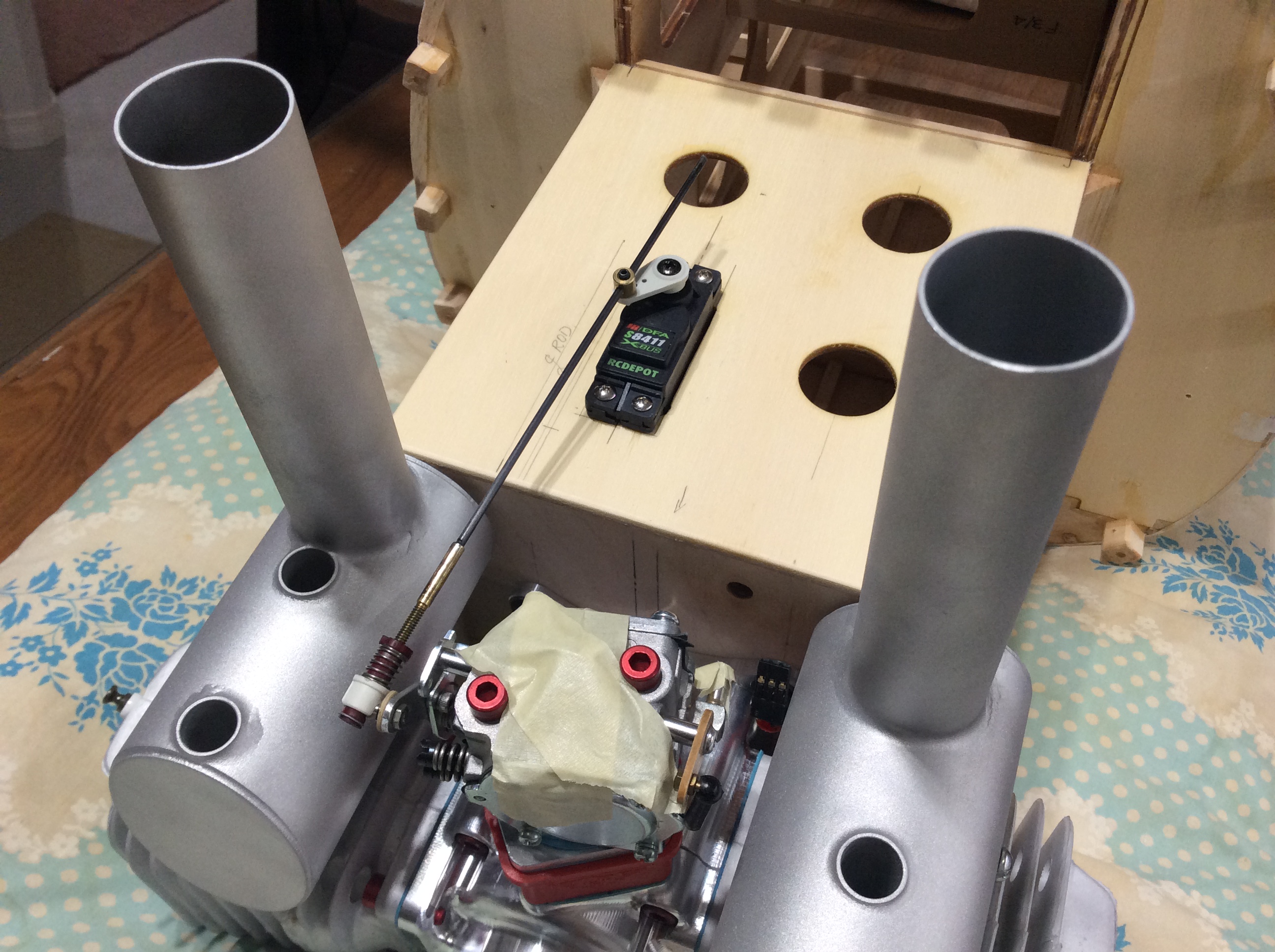

Just working my way through small jobs until it is ready for covering. This is the throttle setup, no slop and direct, also got one of the new JR servos that are programable makes life so much easier, you can program servo angle, off set and many more controls.
With this servo it is so easy to get the 50% / 50% setup.

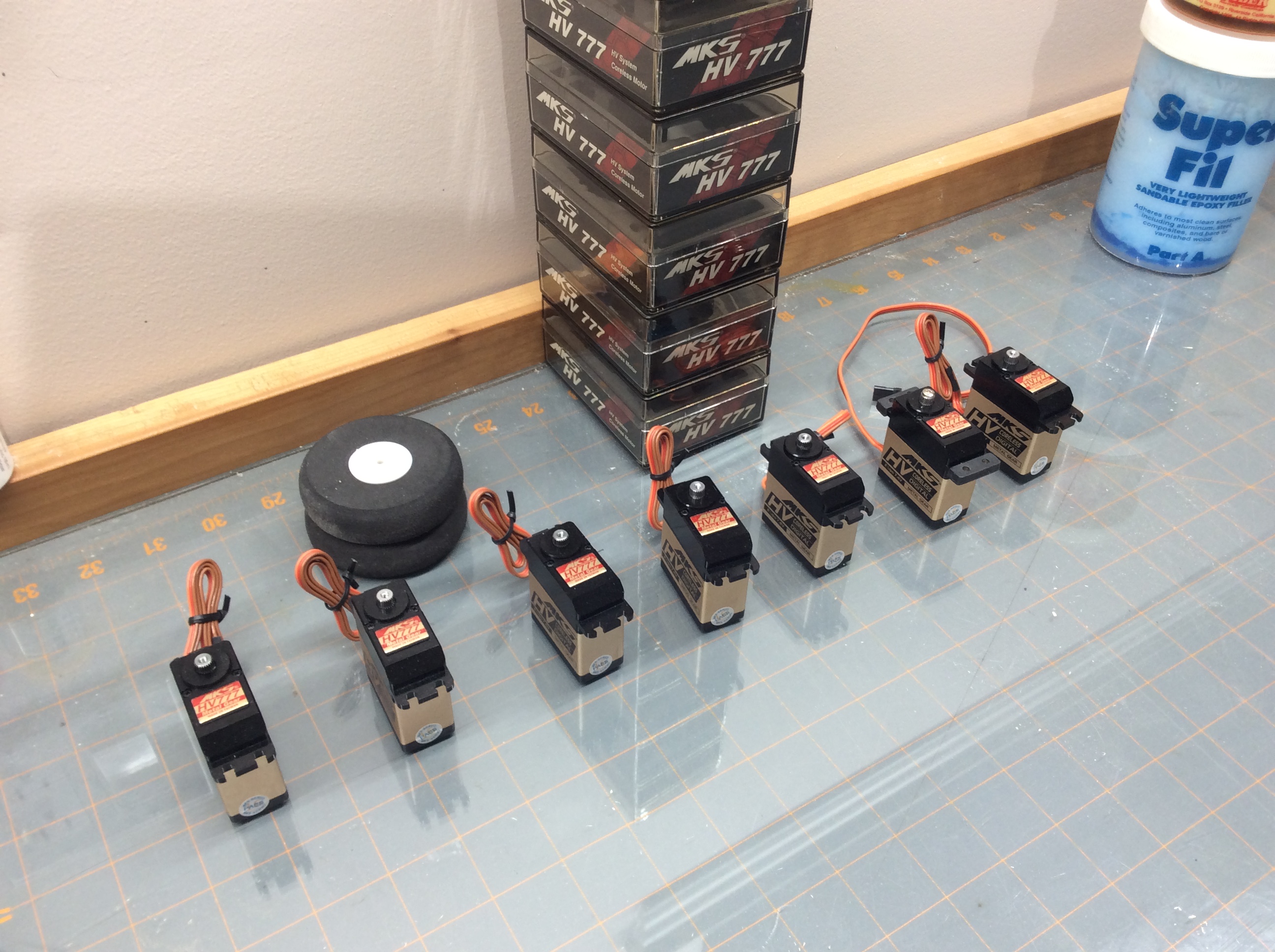

Preparing the servos and trying to find the correct arms and see what works. Have to keep telling my myself that this is a Scale Extra and not a 3D plane. Will be setting it up for around 25 degrees on the ailerons, 30 degrees on the elevator and as much as I can get out of the rudder.
Will be trying to get the CG to work with a pull- pull system. I know the servo in the back with a push/pull setup is easy and a solid setup but when using 500 plus oz-inch servo trying to push the hinges apart not good. Hopefully I can get the pull/pull to work.
