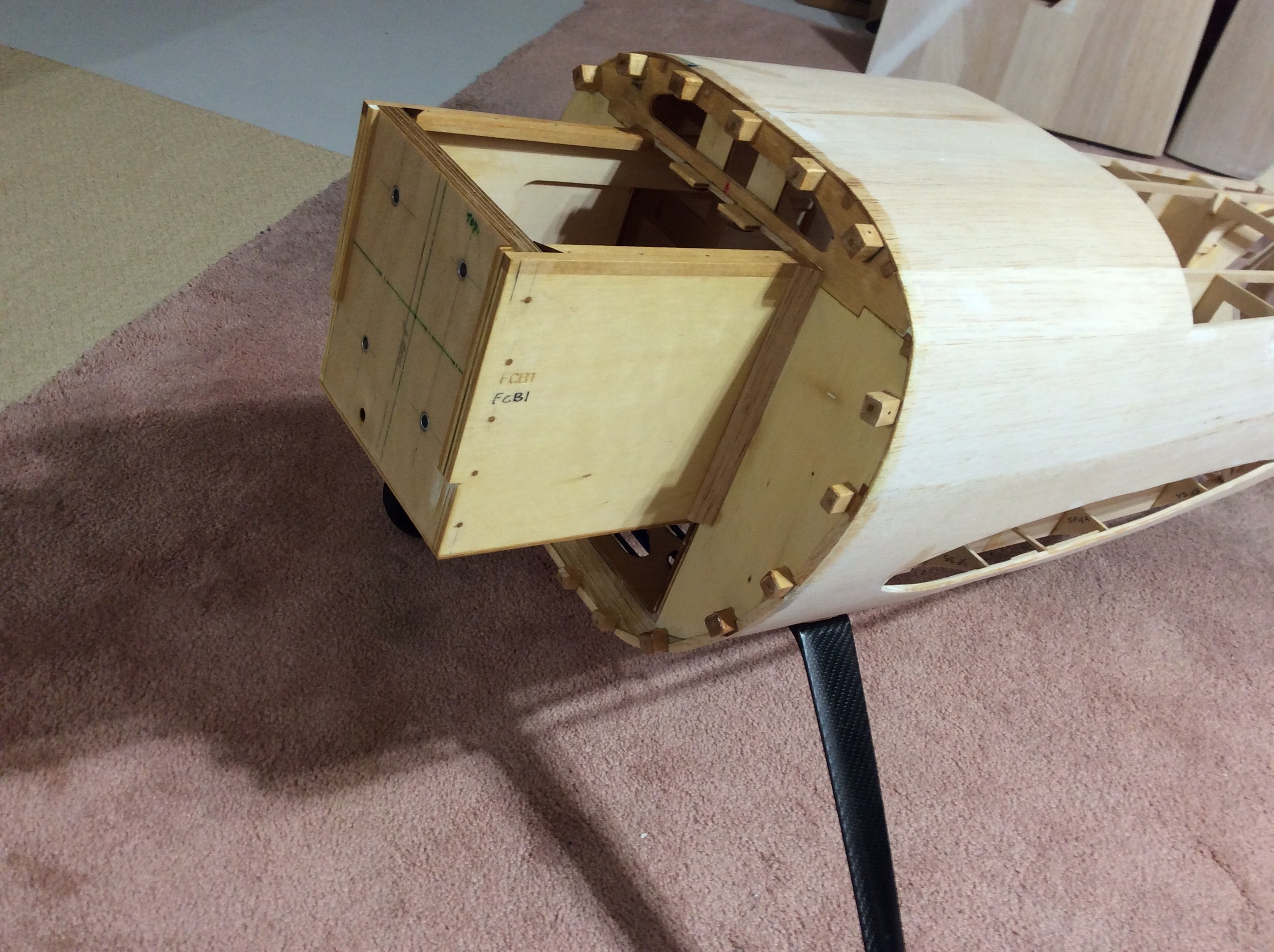

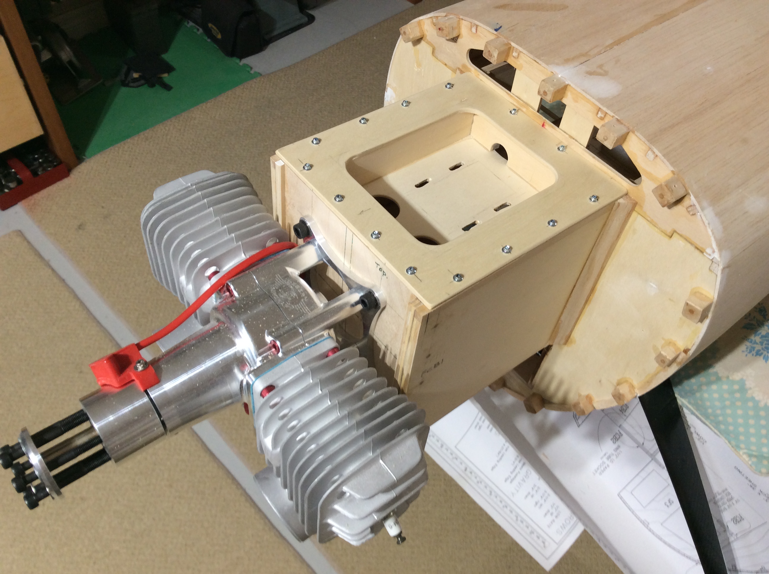

Now to put some bass wood edging around the top of the motor box so that the screws have something to screw into. Once that is done then 50% diluted epoxy mix will be painted all over the front faces and the motor box.

The top motor box is fitted and screwed down. This leaves me with ability to work from the top whenever required.
Now I must remove the engine and the top cover and give everything a coat of thinned epoxy, and it takes for ever to dry. Hopefully by tomorrow morning it is cured sufficiently to work on.

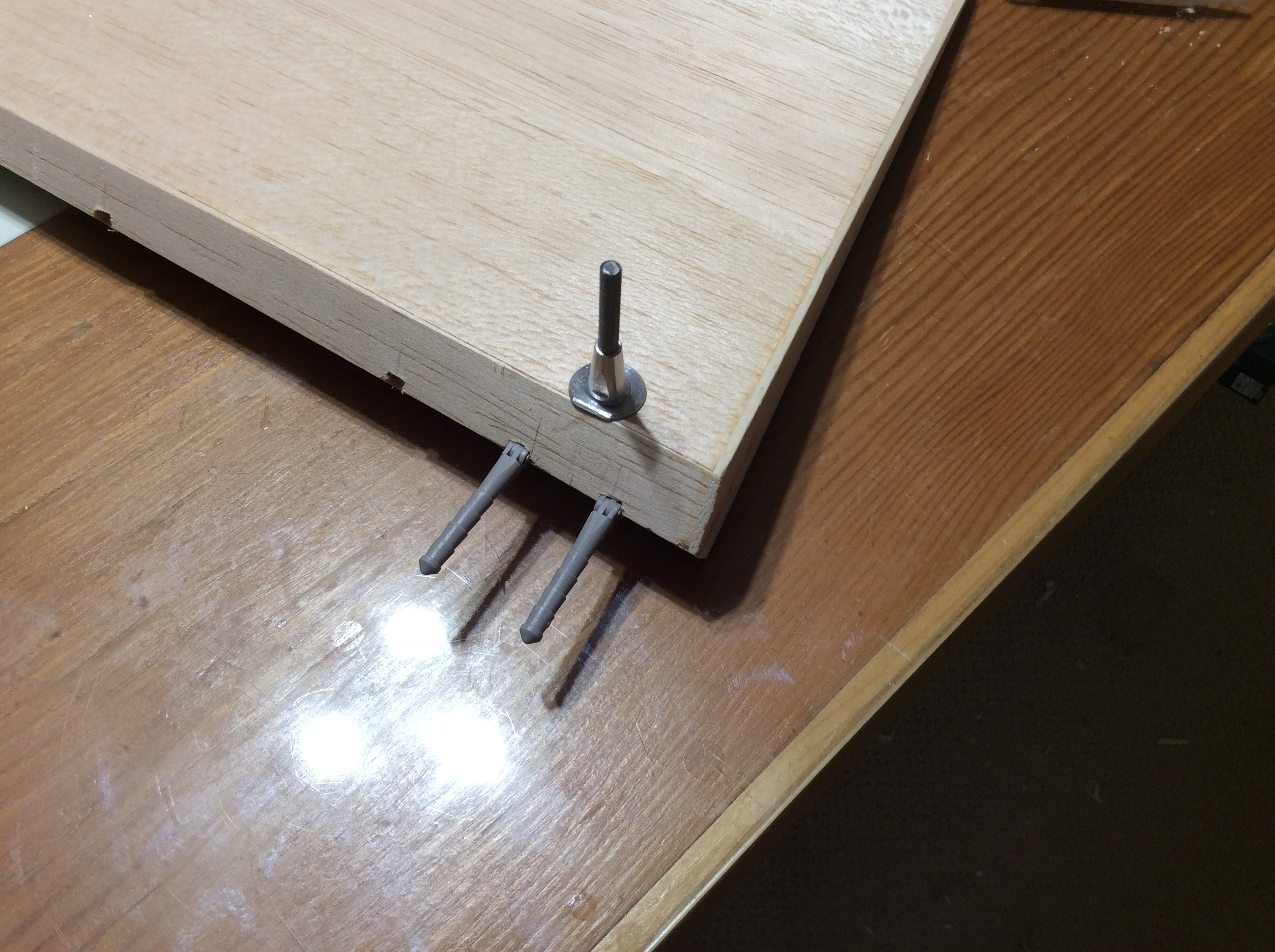

Ok finishing up some fine details added 3/32 balsa to the leading edge of the rudder because it was not lining up with the fin properly. And will also be adding an additional Robart hinge pin at the servos horn location for some extra strength, because I ended up doing a push-pull setup.
This should do the job two 3/16 Robart hinges either side.
