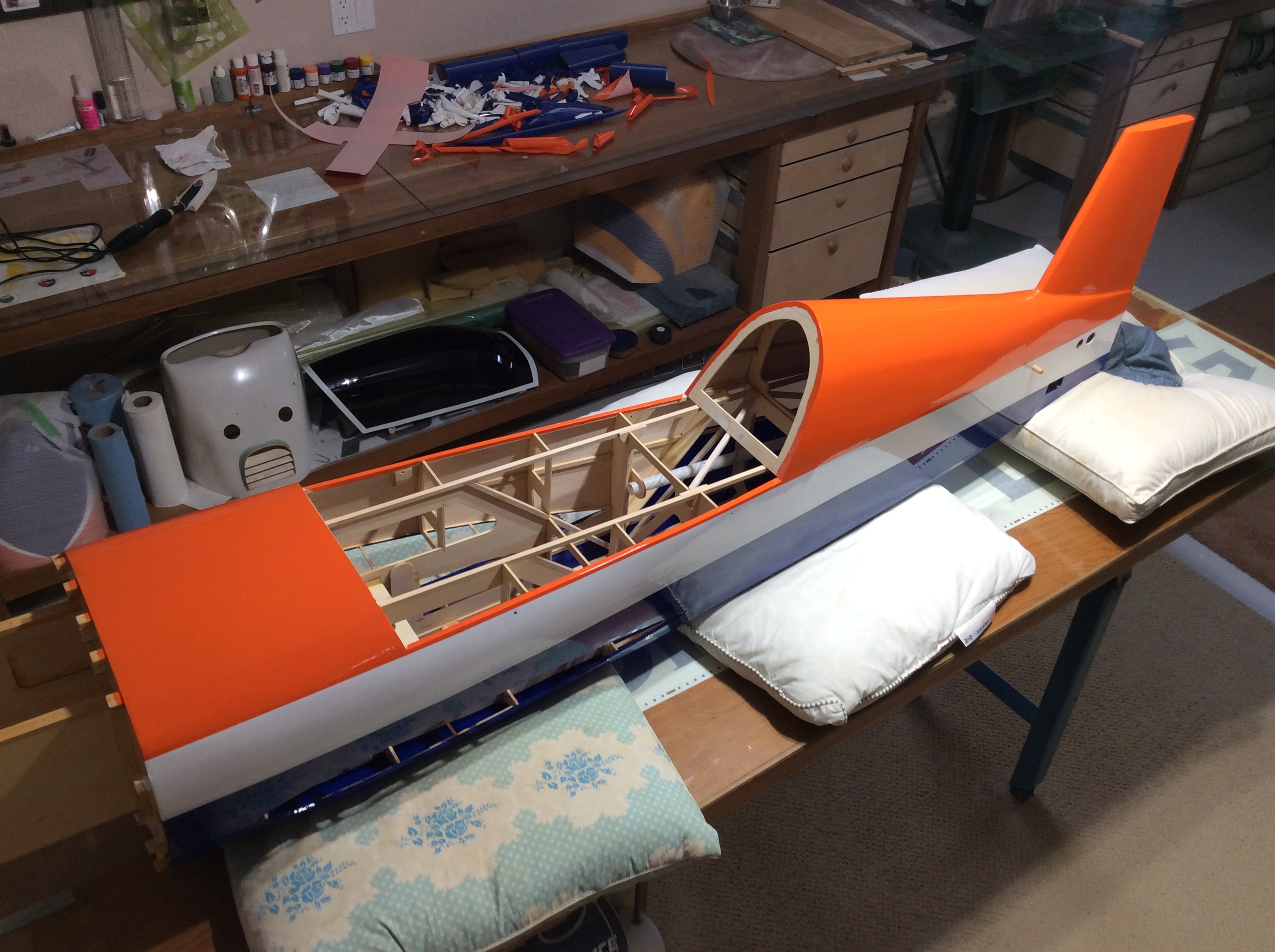

Let’s just say I am making progress. I am having my difficulties, really fighting wrinkles. Covered a lot planes over years but nothing like this most planes were generally flat sided which make a huge difference. This plane does not have single flat side on it and also tapers on the curvatures.

Ok I tried to stick a piece of Ultracote to the cowl 3 by 4. It is beyond me it just would not stick and when it did not well. First piece stuck down the corners and then tried to finish it up not a chance . Second piece started in the centre and worked my way out to the perimeter bit better but all around the perimeter I had tiny wrinkles. If I had a piece of monocote to try it would be interesting how they compare . But it was worth a try.
