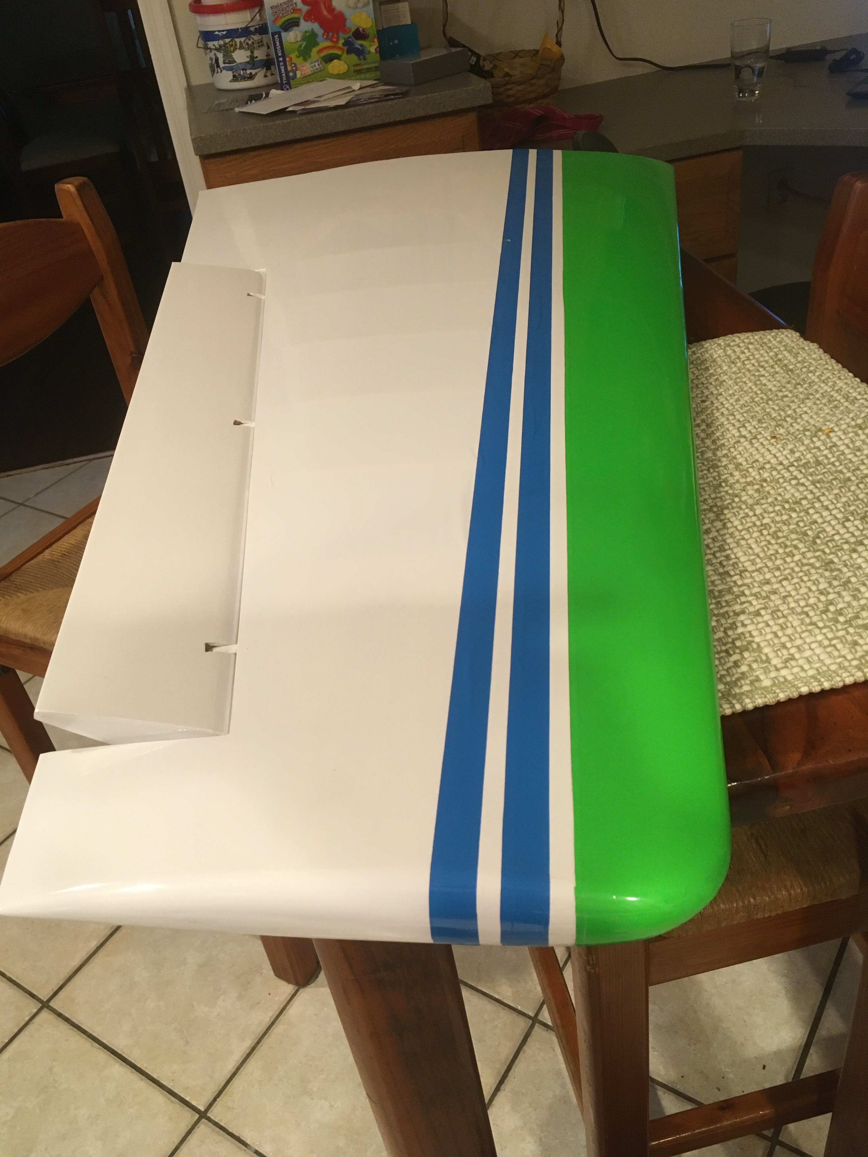

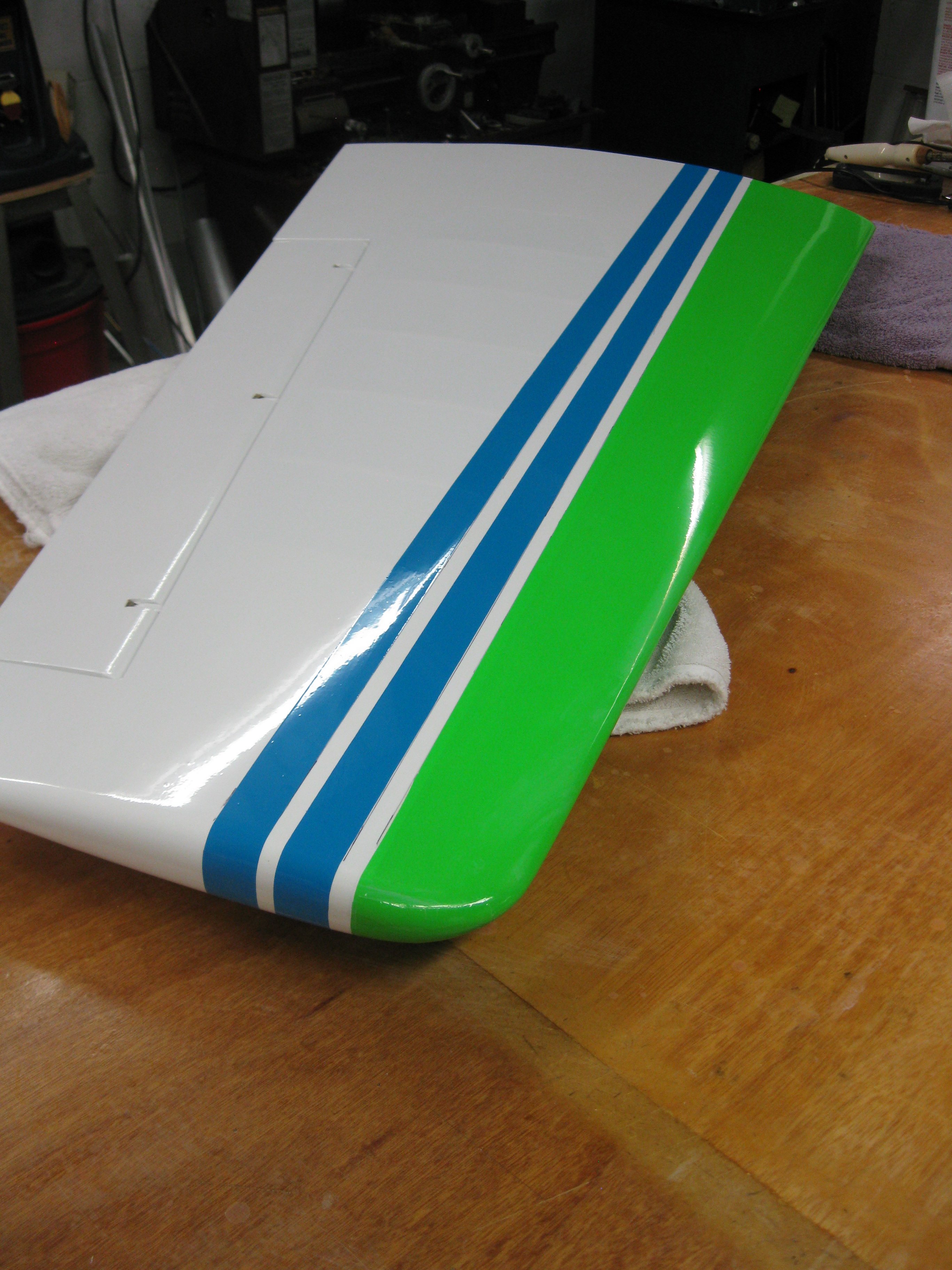

Buy a roll of white and give it a try. It's kind of interesting, when you buy it, that's what you get, film! No carboard tube, no shrink wrap, no instructions, if you order more than roll of the same color, you get a 10 or 15 meter roll. I assume it is processed when ordered off a large roll.
Goes on like Ultrakote, shines more like Monokote. Lower temperature than Monokote. I covered this wing in December 2014. I couldn't color march the green, tried several autobody supply houses and Sherwin-Williams paint store. Just about every hobby fluorsence green paint I could find. Tried yellow base and dusting green on top. Finally gave up.
And here's what it looks like today. there's one bay that is showing small wrinkles, not bad after 6 years stored in my basement that had a water problem until last year.
The autobody supply was able to match both white and blue colors. The plane is on the list to recover some day. Can't tell you how many time I sanded the cowl and canopy down!

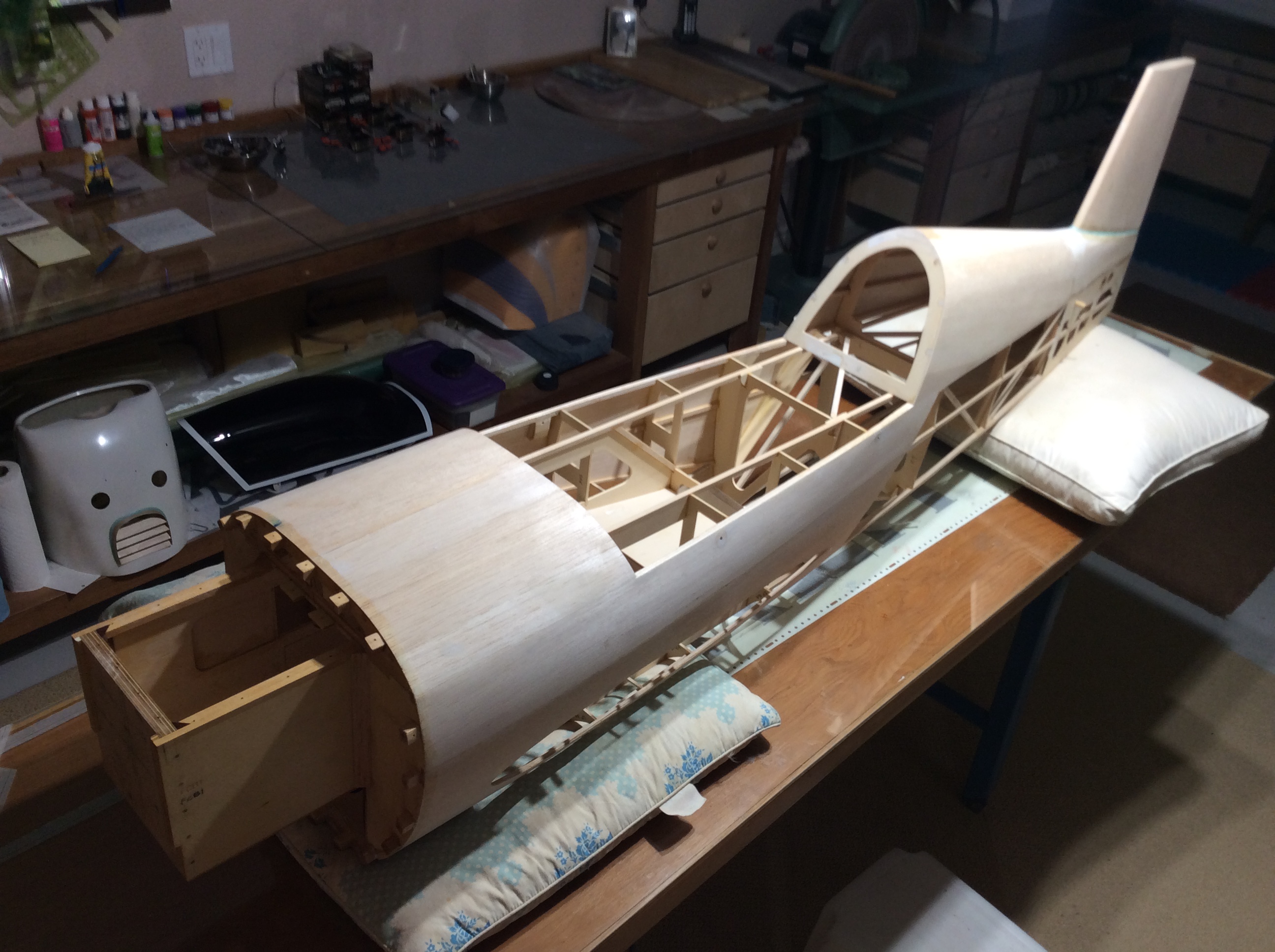

Started laying out the covering the scheme onto the fuselage and seeing where I need to glue in strips of balsa for the covering to stop and start. Just another phase of getting the end results you want.

Ok after a hole day of work on the fuselage, I believe the fuselage is almost ready for covering, about another two hours of fiddling. Then cleanup the workshop and blow off the fuselage and tack rag it to make sure all the dust is removed and then we can start.
