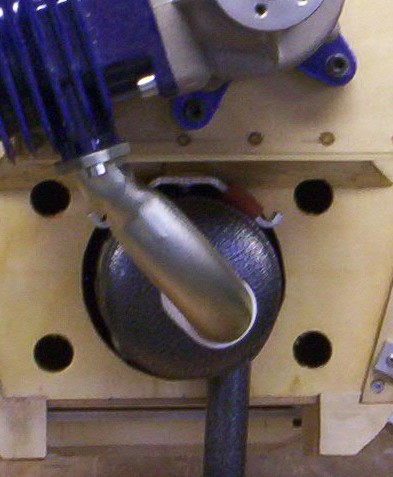

The mount provided by JMB, it is a silicon O-ring with an aluminum W shaped mount, the rear of the can is supported in a silicon rubber bushing on the snout. Photo was taken in 2006, still flying today although it does have a little rash. The can and mount were purchased from RC Showcase. I don't think JMB offers it anymore but it has held up well. Never broke an O-ring however I did have the mount located incorrect location has shown in the photo which dented the can, it is moved back an inch or two now. Here's a zoomed in photo of the mount.
Neat!, I have three JMB cannisters now, I've been trying to figure out how to use the rear tube mount in a current build. I may just use a small screw/bolt through the teflon couplers though.

You have 3 JMB canisters have you owned other manufacturers if you have how do they compare. I tried about 6 months ago to buy a complete system from them never got an answer. Did you get it from a US supplier or from JMB

Nothing else so far. Ordered direct from JBM. Two headers, and two TRA-70-L and one TRC-60-L, I think the 60 was too small for my GP76. I've installed the 70 in my 89" laser (pending flight test), and am currently putting one in a 120" TBM. The TRC-60-L is their best selling cannister for the 120cc planes (uses 2) I believe. It's very quiet.
Be interested to see how they work out and what you think of them. In the beginning stages of drawing up a Taylorcraft about 100cc size. Would like to maybe size and design the plane to be able to fit a pair of JMB canisters.

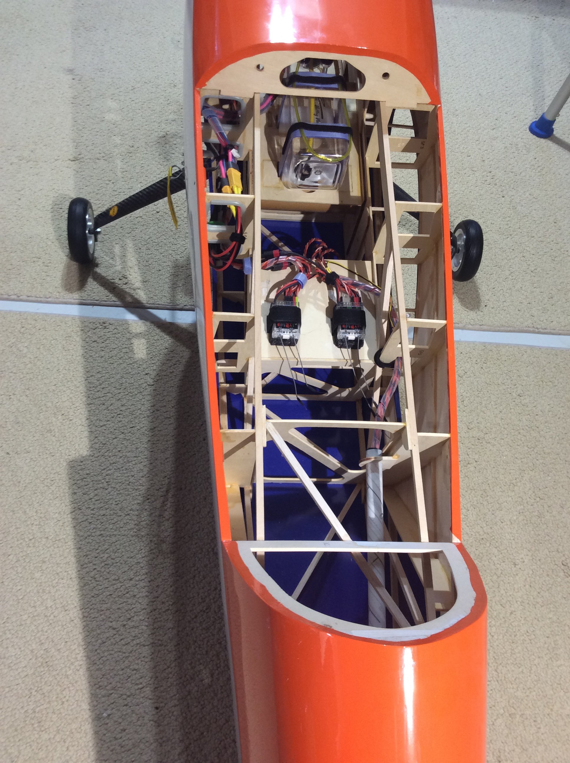

The radio is installed and all the wiring sorted out and the servo distribution decided on. Also the battery terminals located so it is easy to access check and charge. Just need to setup the antenna and get them supported and oriented.
