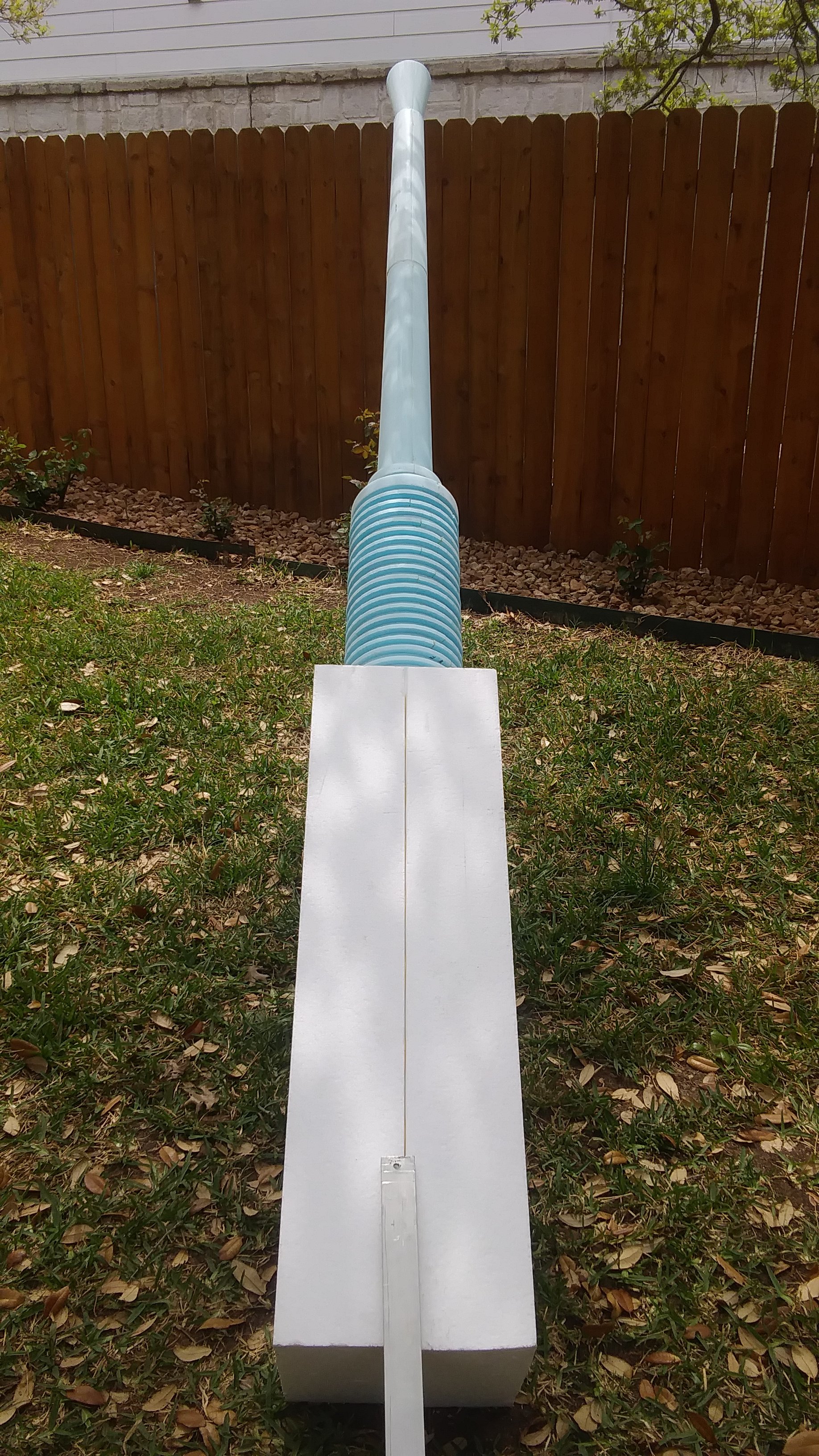

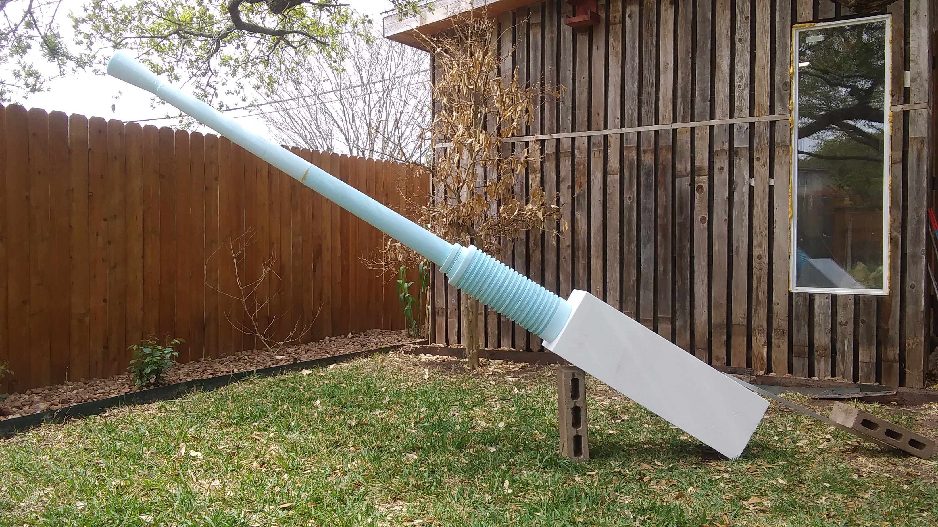

Working on something different, between building airplanes. This is a full scale 40mm Bofor Gun I am doing for a customer for his business to be on display for his WW2 themed mini golf and museum

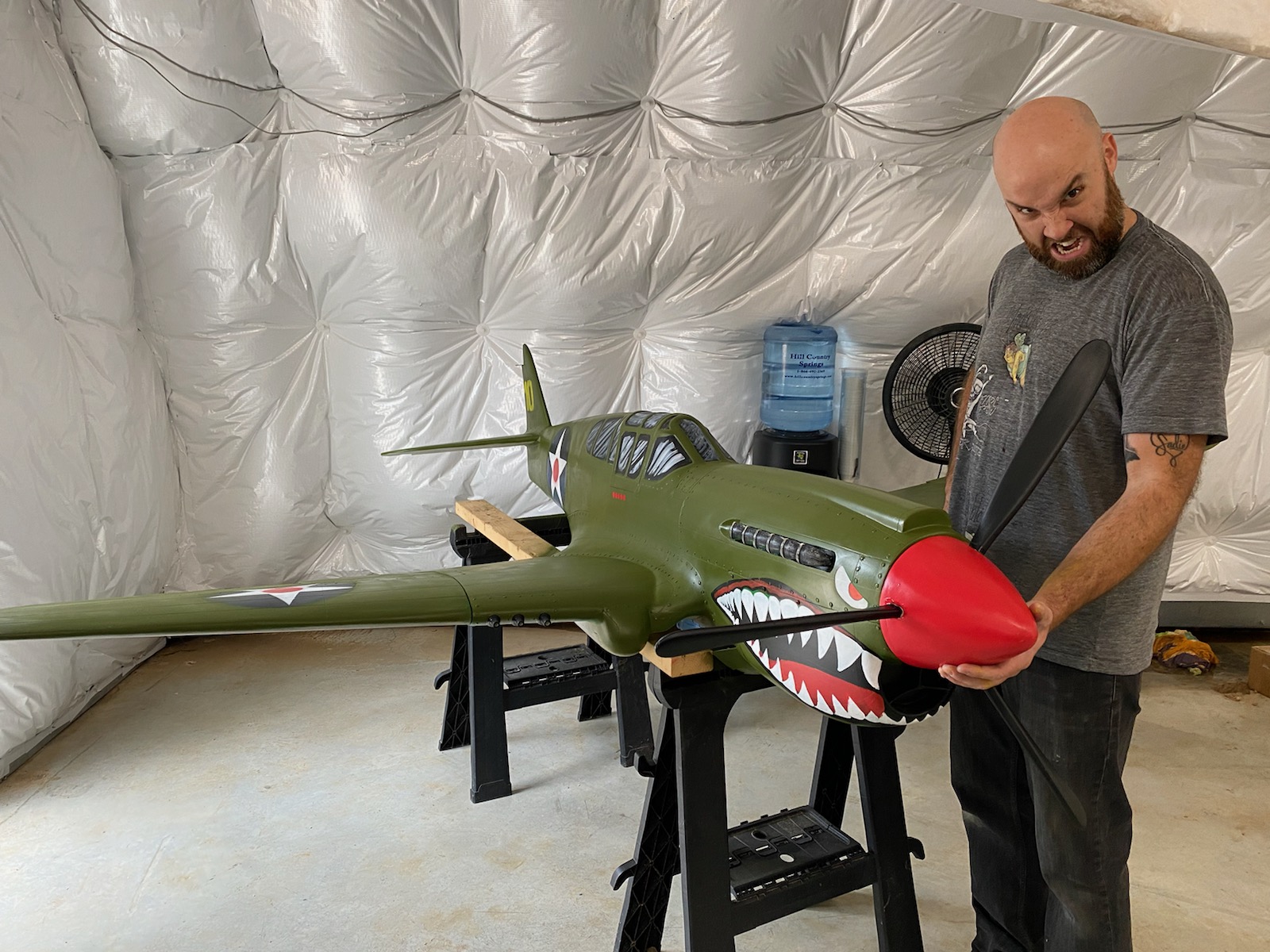

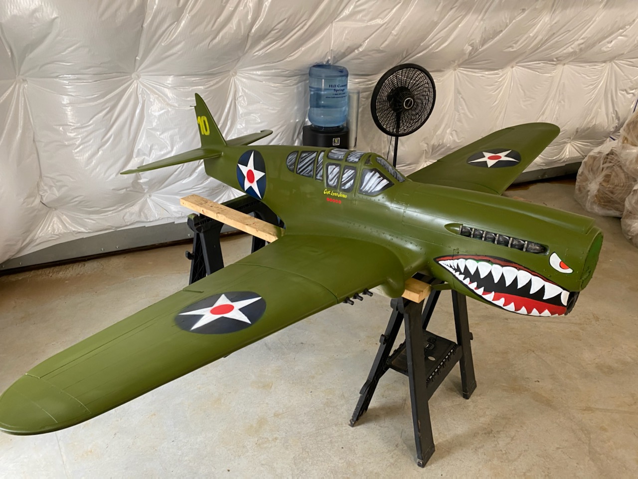

Blazing Wings

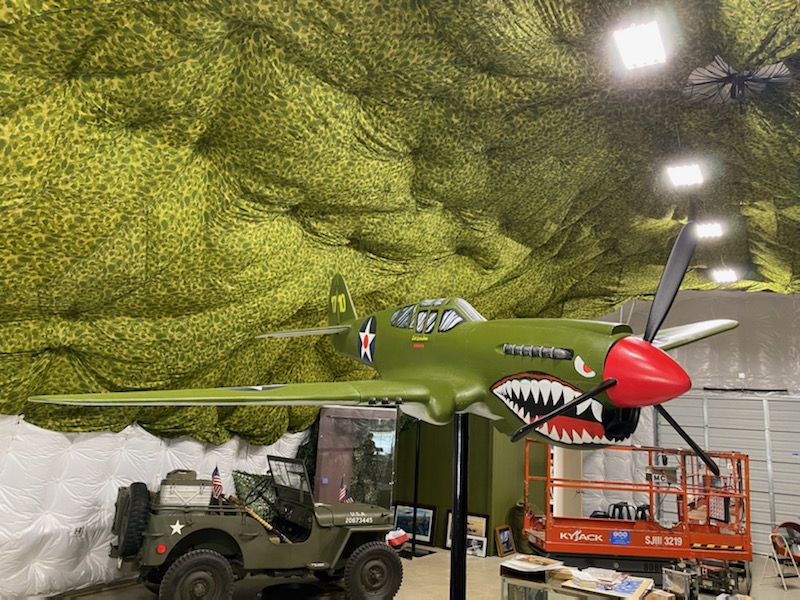

First Pictures received from customer of P40 painted. Always excited to see one of my planes painted.
This color scheme was chosen by customer. His Uncle served in the 14th AF under General Chennault.

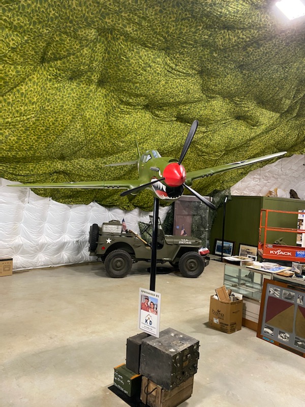

Blazing Wings

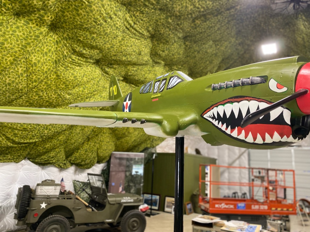

P40 finally at it's final resting place. Received the pics from customer last weekend. Stuka is up too and will post as well. I will take more pictures this weekend when I drive up there.
I am working on a new kit concept on the P40, so it will make shipping and transportation easier. Basically I am going back to fuselage only design and supply wing cores for center section and outer wings. I am working on a version right now for a customer, and I will post pictures when I get the wings built. I have to make a new mold for the fuselage belly section, and hope to have that done soon as well.

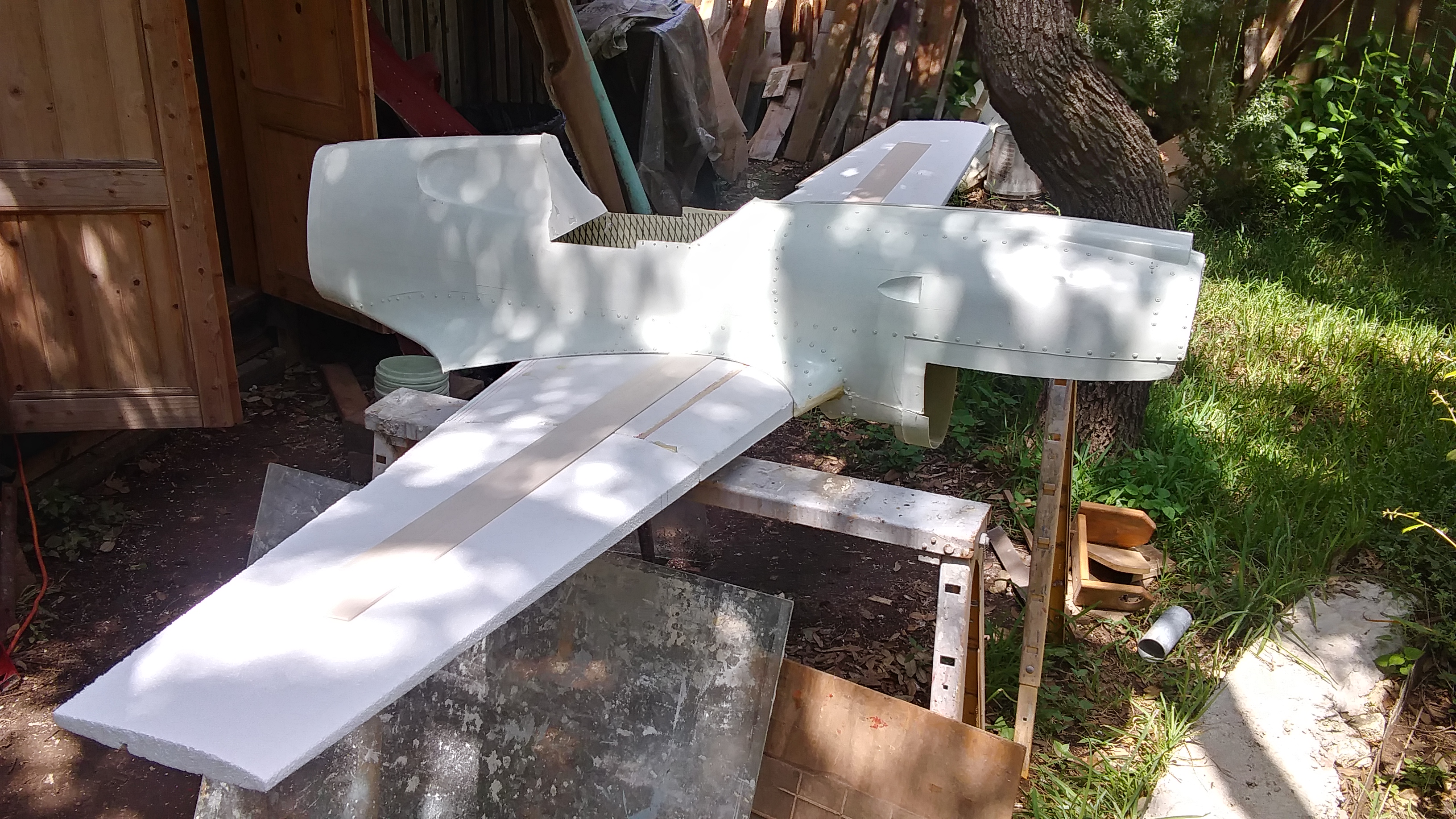

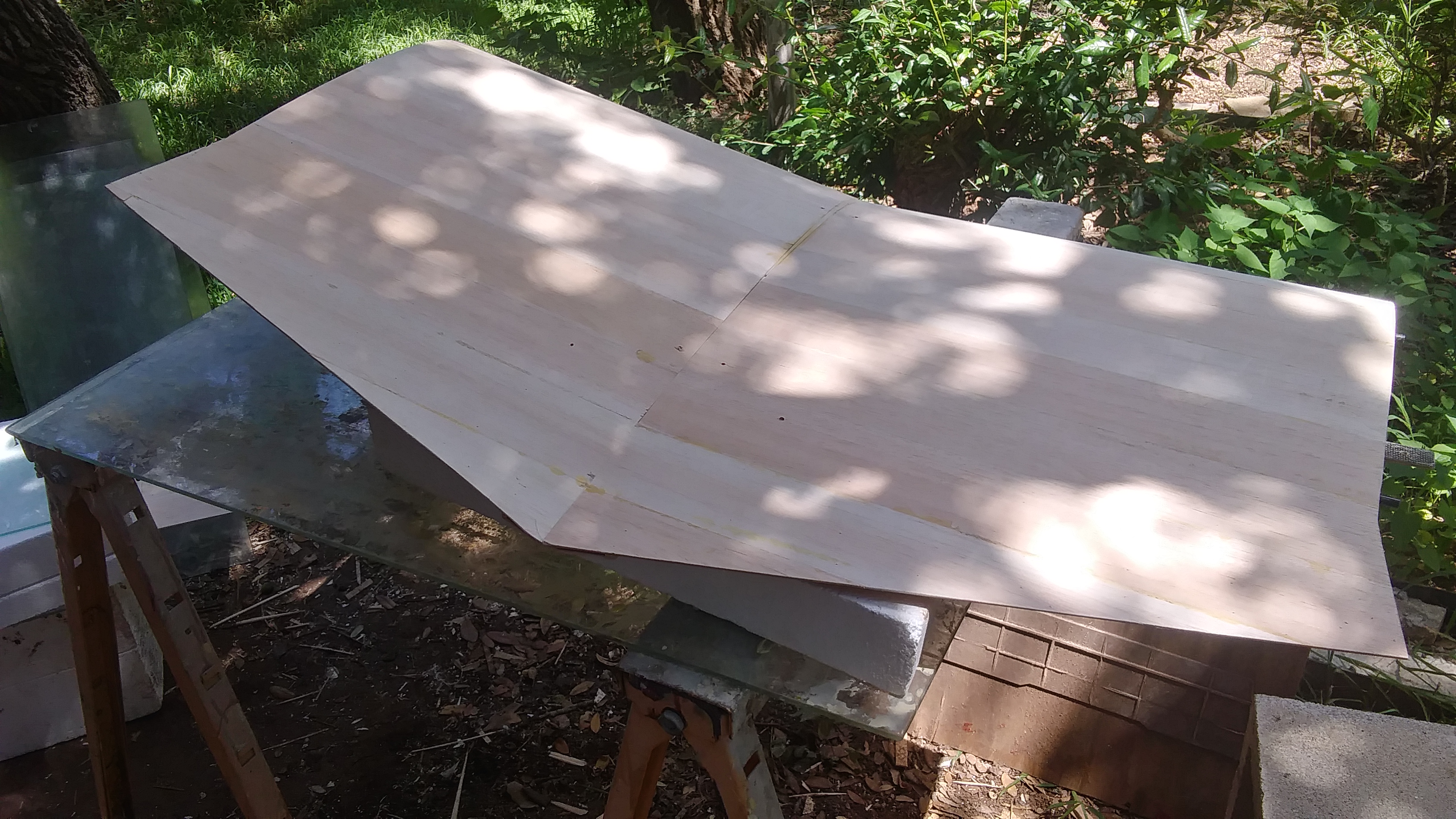

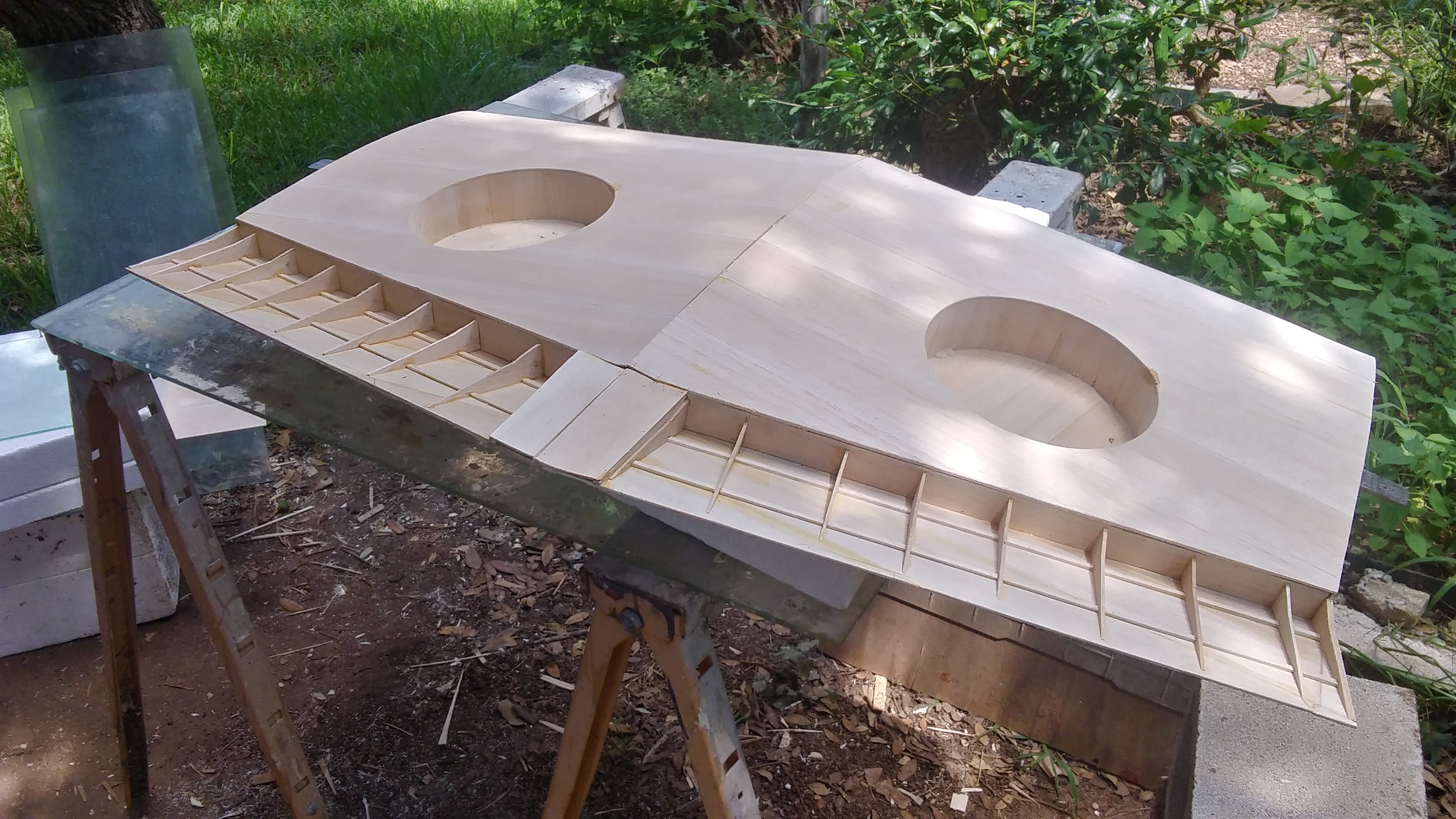

Blazing Wings
Still working hard on the new 2022 P40 Warhawk 1/4 scale kit concept. I am building this currently for a customer. The wing construction is almost done. Sheeting and glassing should be done next month. Once that is completed, I can fit the wing to the main fuselage and make a new mold for the belly section.
The foam core wings come in 4 pieces. Customer can choose to how he want to build the wings. One, two or three piece configuration. Where I can, I always prefer the 3 piece with the center section built as one. That in my opinion just makes assembly and transportation easier from and to the field.
The reason for changing the design was, that shipping cost are just getting more and more expensive, and I had to make the boxes smaller to save customers the cost. Thank god, most customer come to pick up in person. Also, a lot of people just do not have the room to store or transport such a big plane. Changing the design will allow for easy storage and transportation, and handling.
Best part the kit will be cheaper from the previous model.
