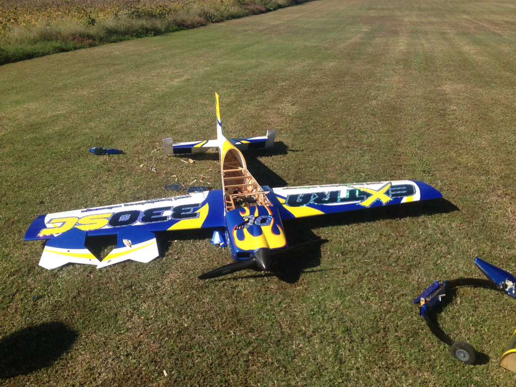

A friend of mine setup his Beast on a DX7 with 2 smart fly equilizer 2s. I had a problem with mine as the servos connectors are not secured with the board in any meaningful way and my buddy also had them slip out. If you have not purchased the power safe RX, you could use a power system from smart fly that does both servo matching and power distribution and use something more basic like a AR8000.

I did have a DX-8, and I did mix 4 ailerons on my old H9 extra within the radio and matched the two elevator halves. My issue was when the servo plugs came out, I had no elevator.
ImageUploadedByTapatalk1382286685.265774.jpgopps
