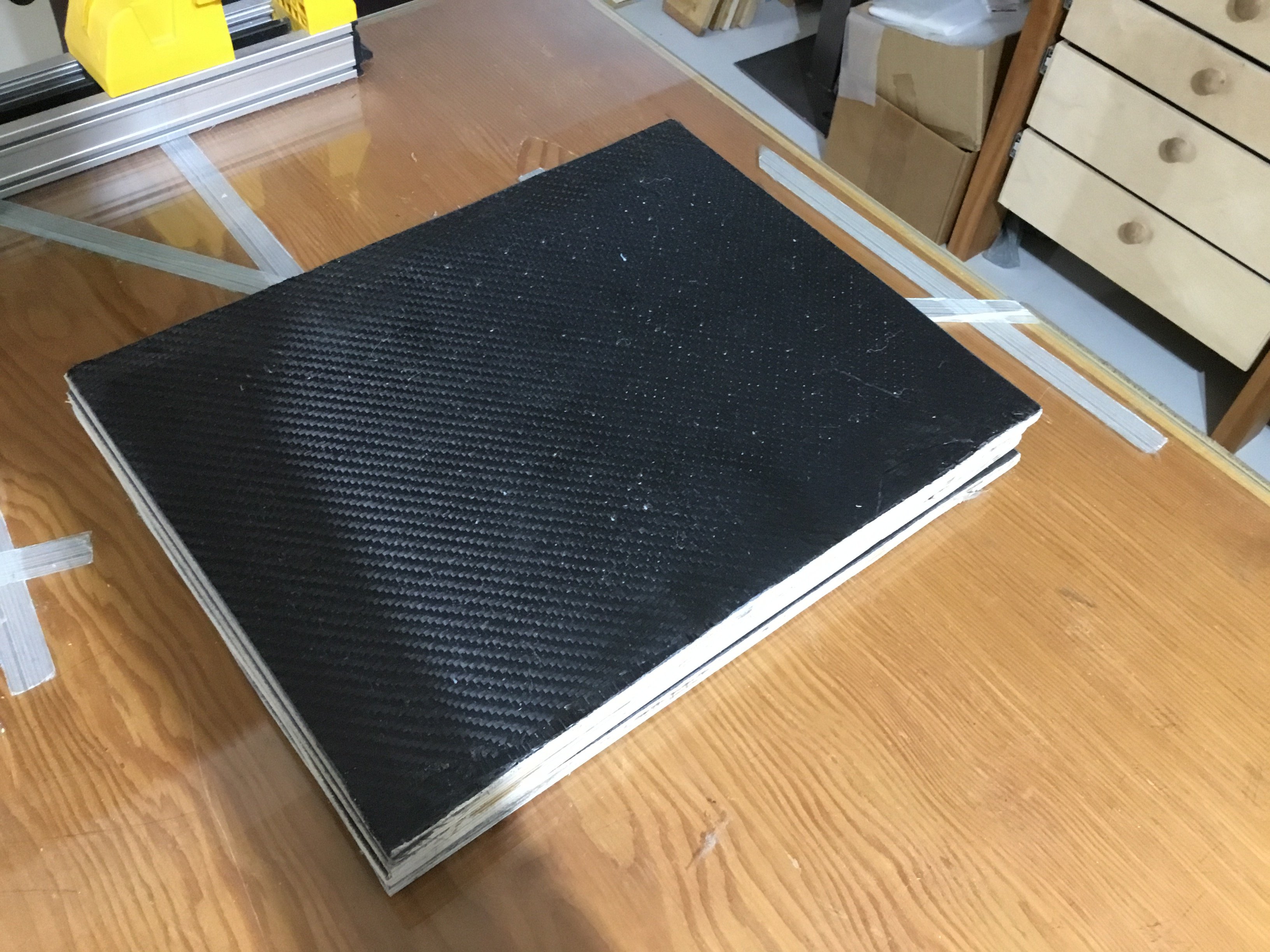

This the firewall after vacuum bagging. There is 2 layers of 6oz carbon cloth per side.
What is the thickness of the plywood? That looks to be a bullet proof firewall.
You are correct it is a little over done, but this plane will need some nose weight so the firewall Is a little over done. 2- 1/4” Burch ply and then 2 layers of 6oz carbon cloth on either side.. one thing I have had problems with over the years is firewalls compressing over time. I mean after 10 years of flying not 2 to 5 years. We will see how this stands up over time.

Kevlar should be better in compression loads than carbon fiber but that's quite the layup! Should be super duper strong!

Do not like Kevlar difficult to work with and almost impossible to wet out properly. The only way I believe or would try to use Kevlar is by infusion to prevent air pockets.

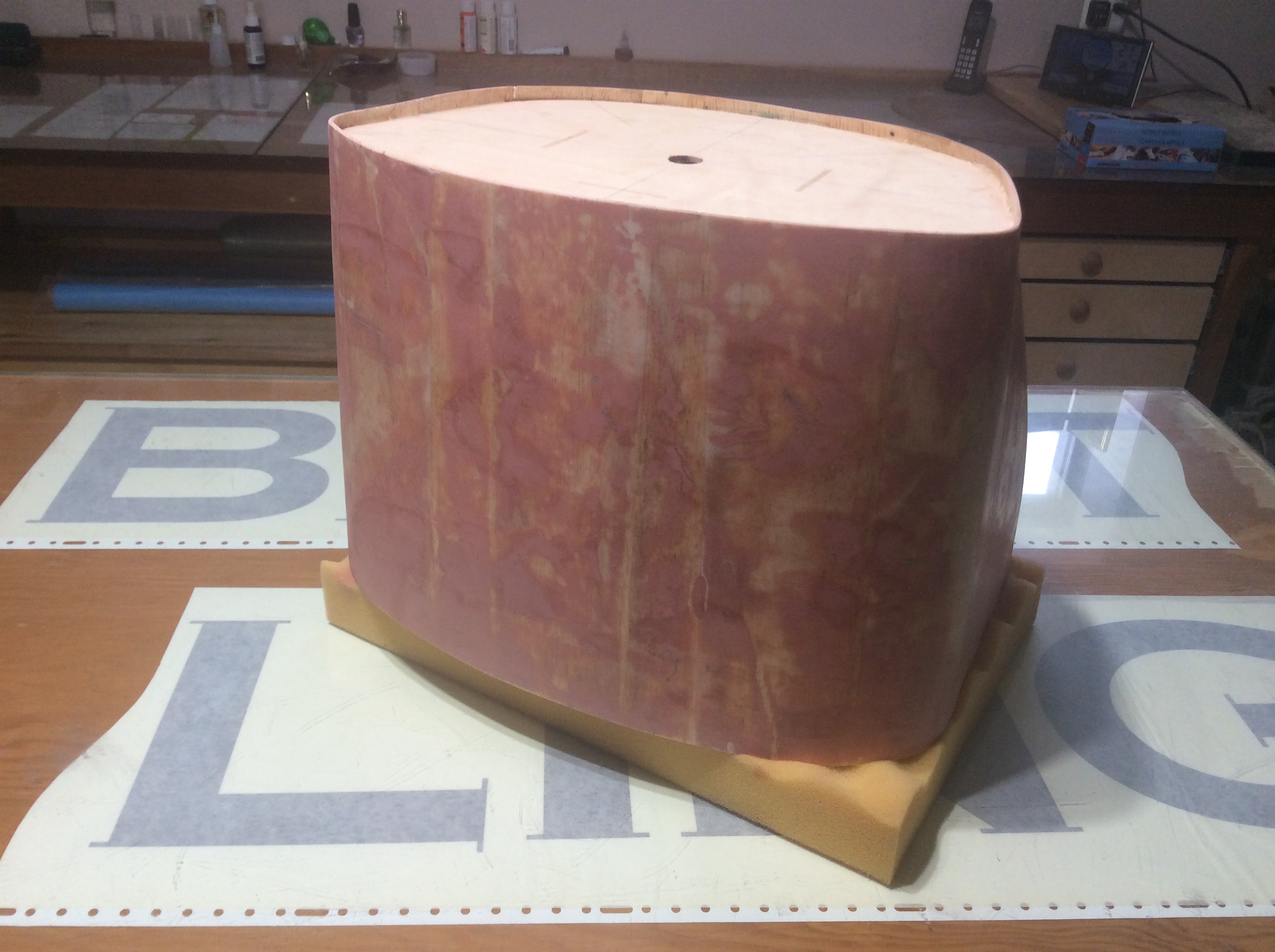

This is the back portion of the cowl plug. First a framework was built then sheeted with 3/32 balsa, filled and sanded smooth. Then glassed with 2 layers of 2 1/4 oz cloth, then filled with spot putty several times and sanded till we have what you see.
The front section will 3D printed and glued on to the front. Then when that is all blended and smooth a plug will made from it.
