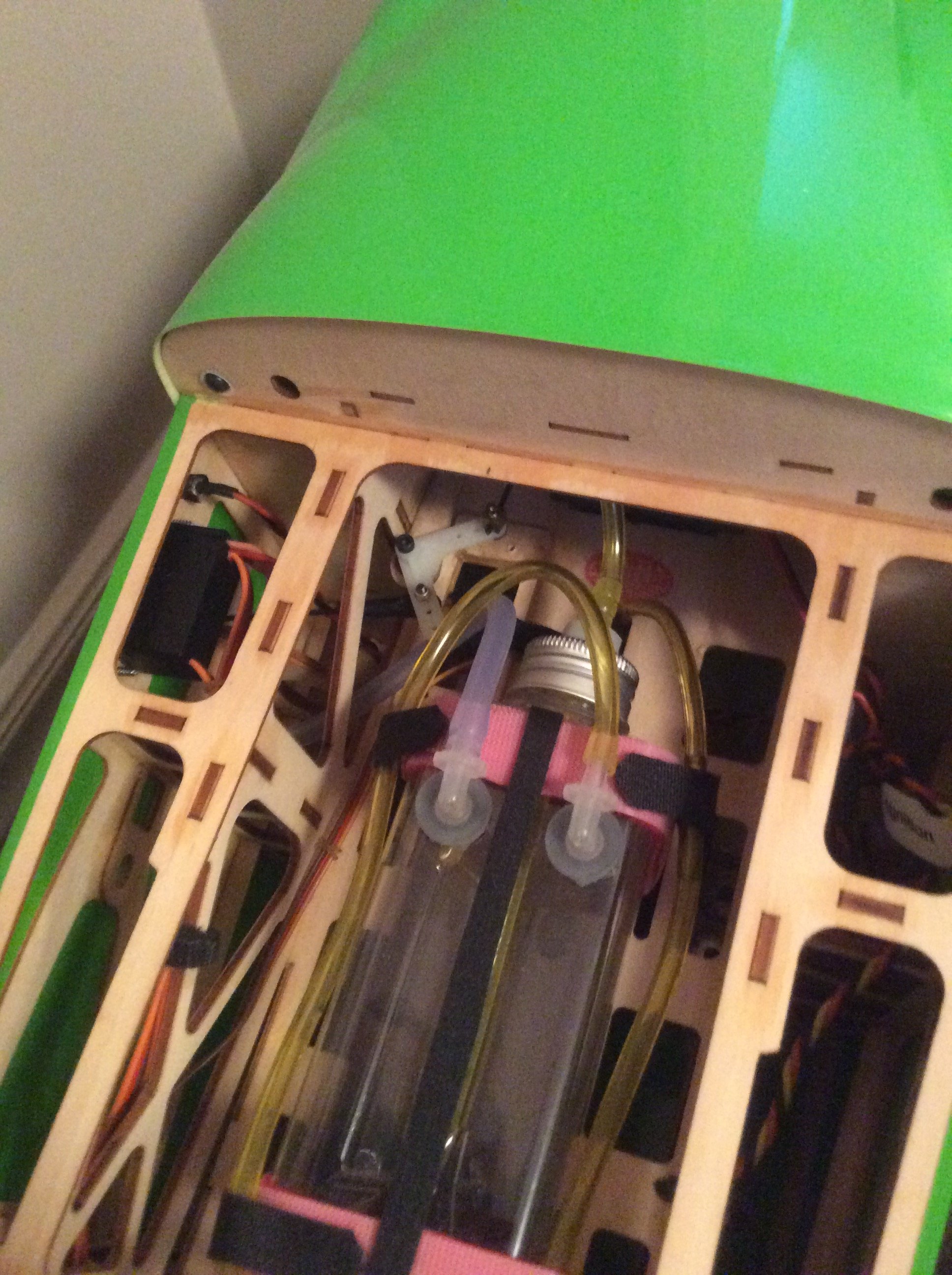

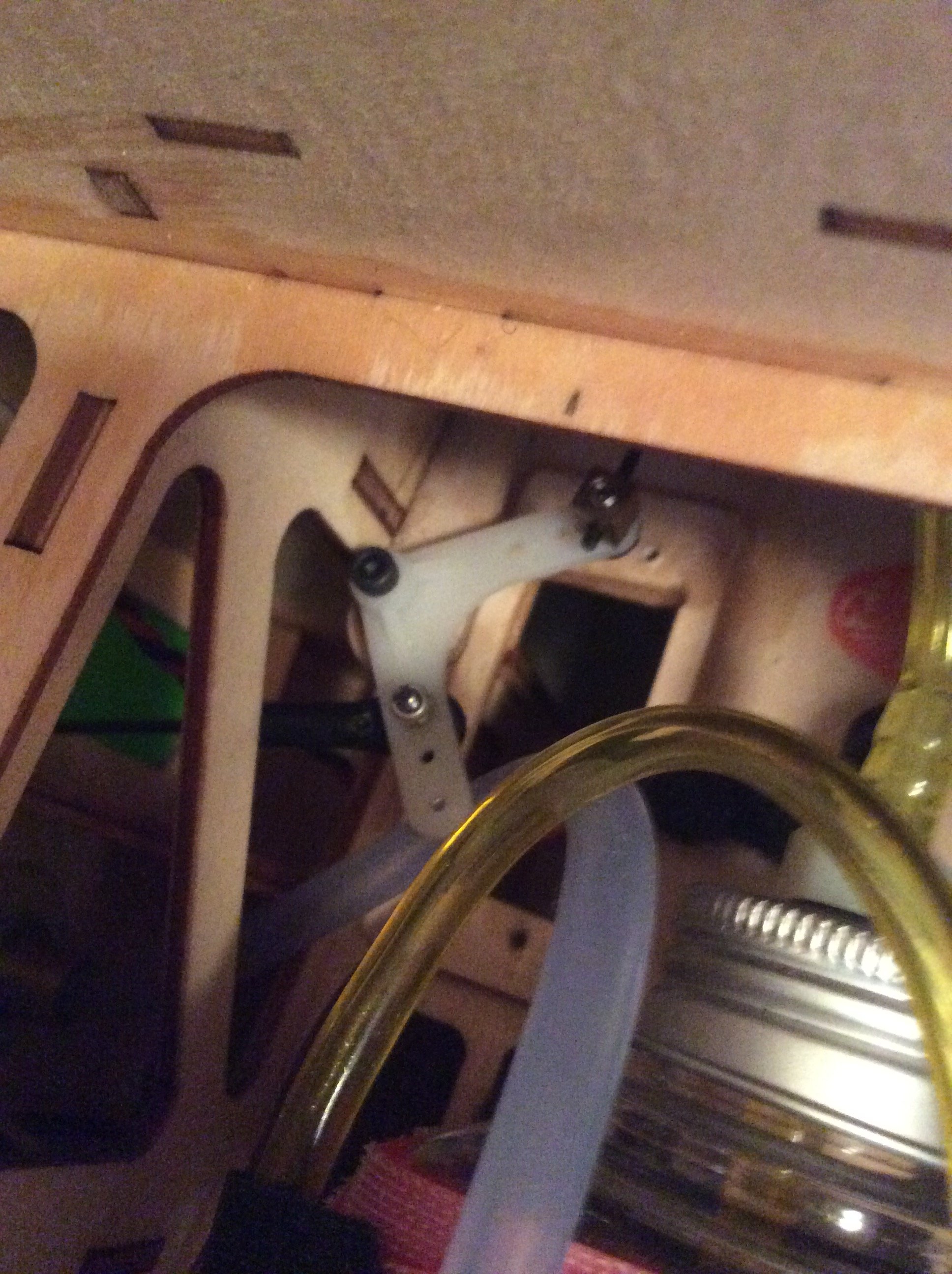

Ok got a picture for of the bell crank that replaced the servo. If you look carefully you can see were the servo was. Hope that helps you. Need more info just ask.
Yes that is correct it comes out the left side. Small button non glued to the end of the rod and it is pulled and pushed to operate the choke.
