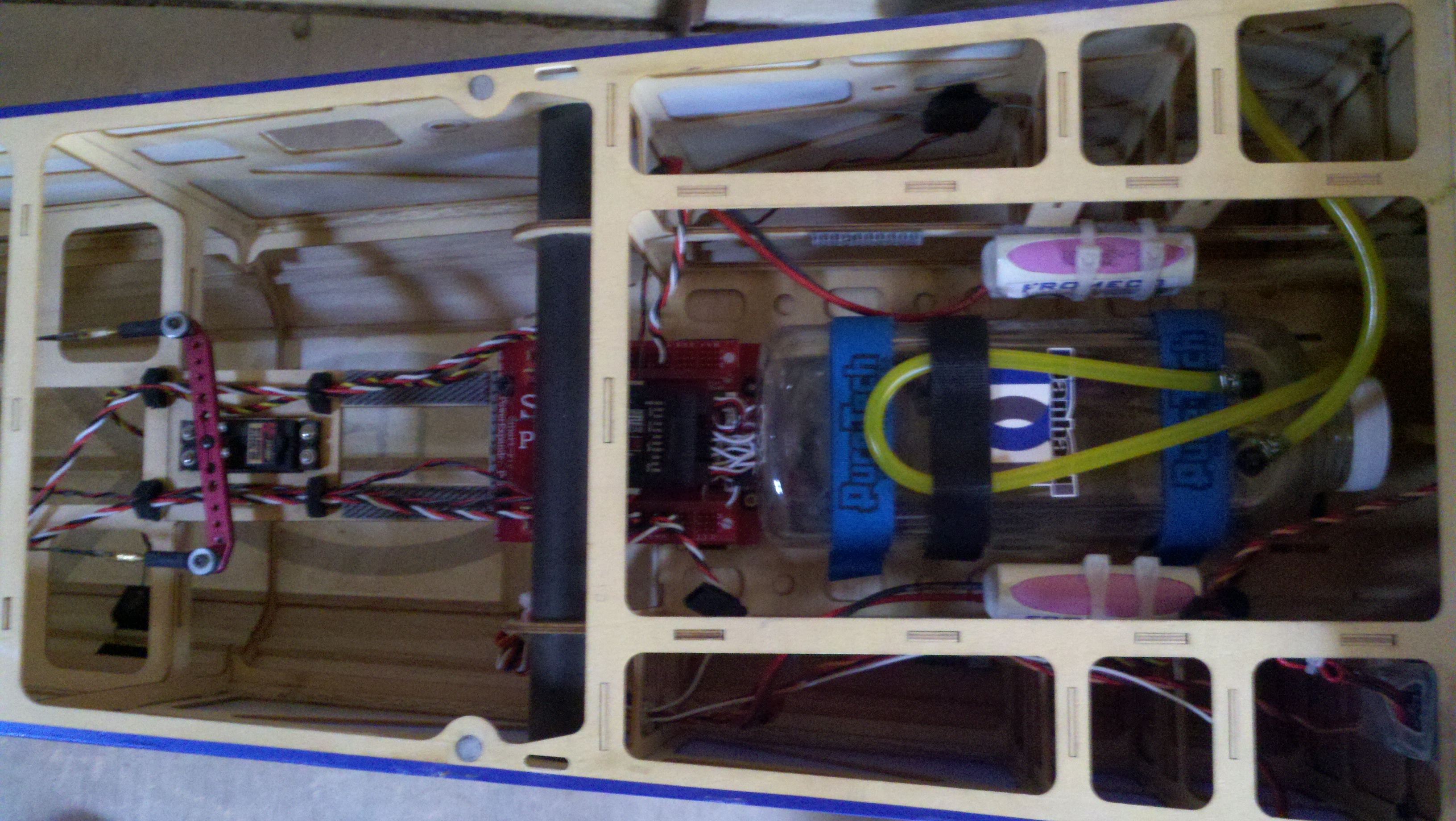

FWIW, this is the setup I had on mine when flying it... it was very slightly nose heavy, which made for some perfect 3D IMHO.
EME 60cc engine with side dump muffler
Hitec 7955TG Servos
32oz fuel tank
Made some battery trays like this:
http://www.3drcforums.com/showthread.php?59-3dhs-89-slick&p=26128&viewfull=1#post26128
Also, when I originally got the plane, it had a DLE55 on the nose, same servos and tank mentioned above. Here was battery placement:
