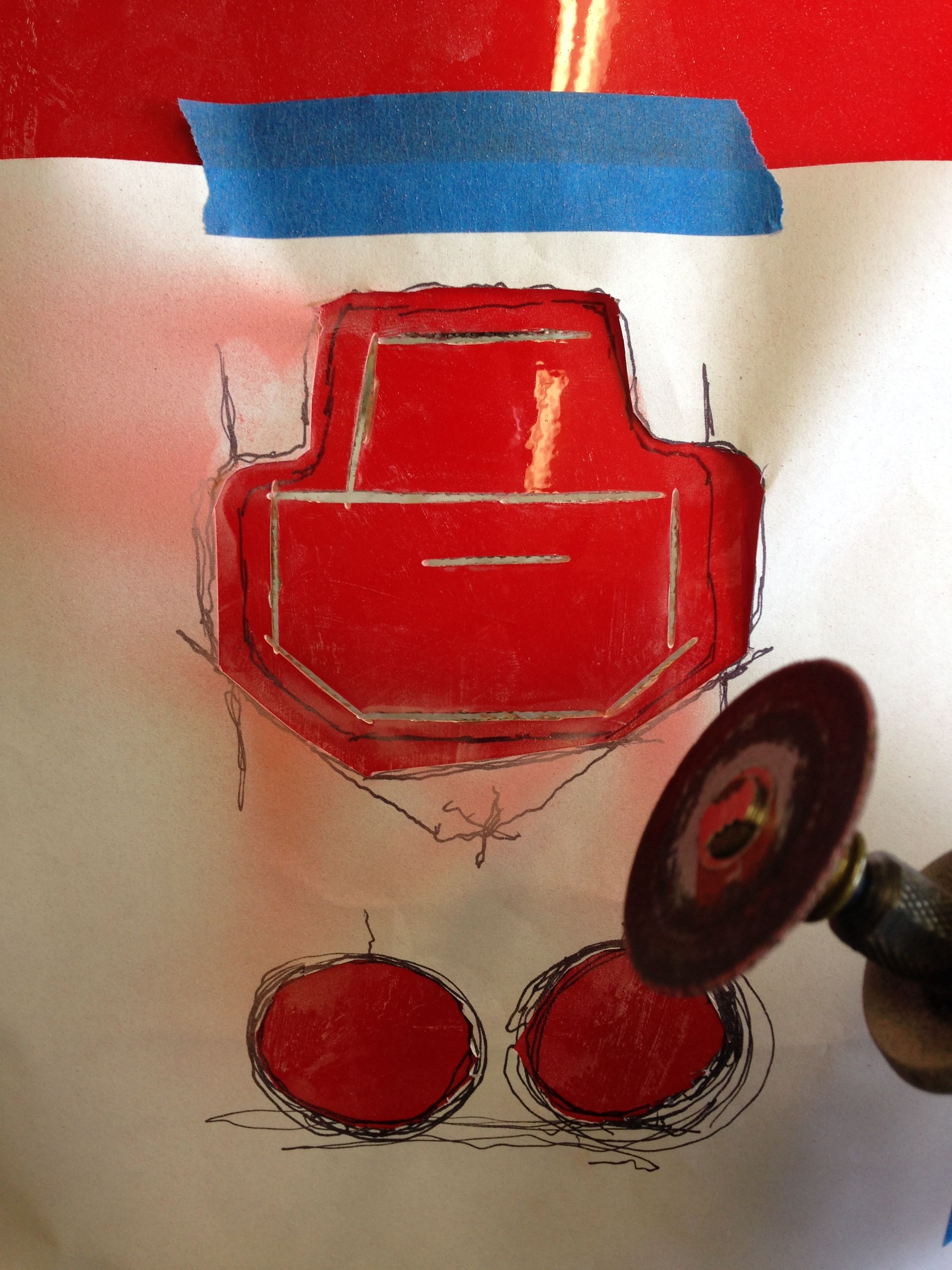

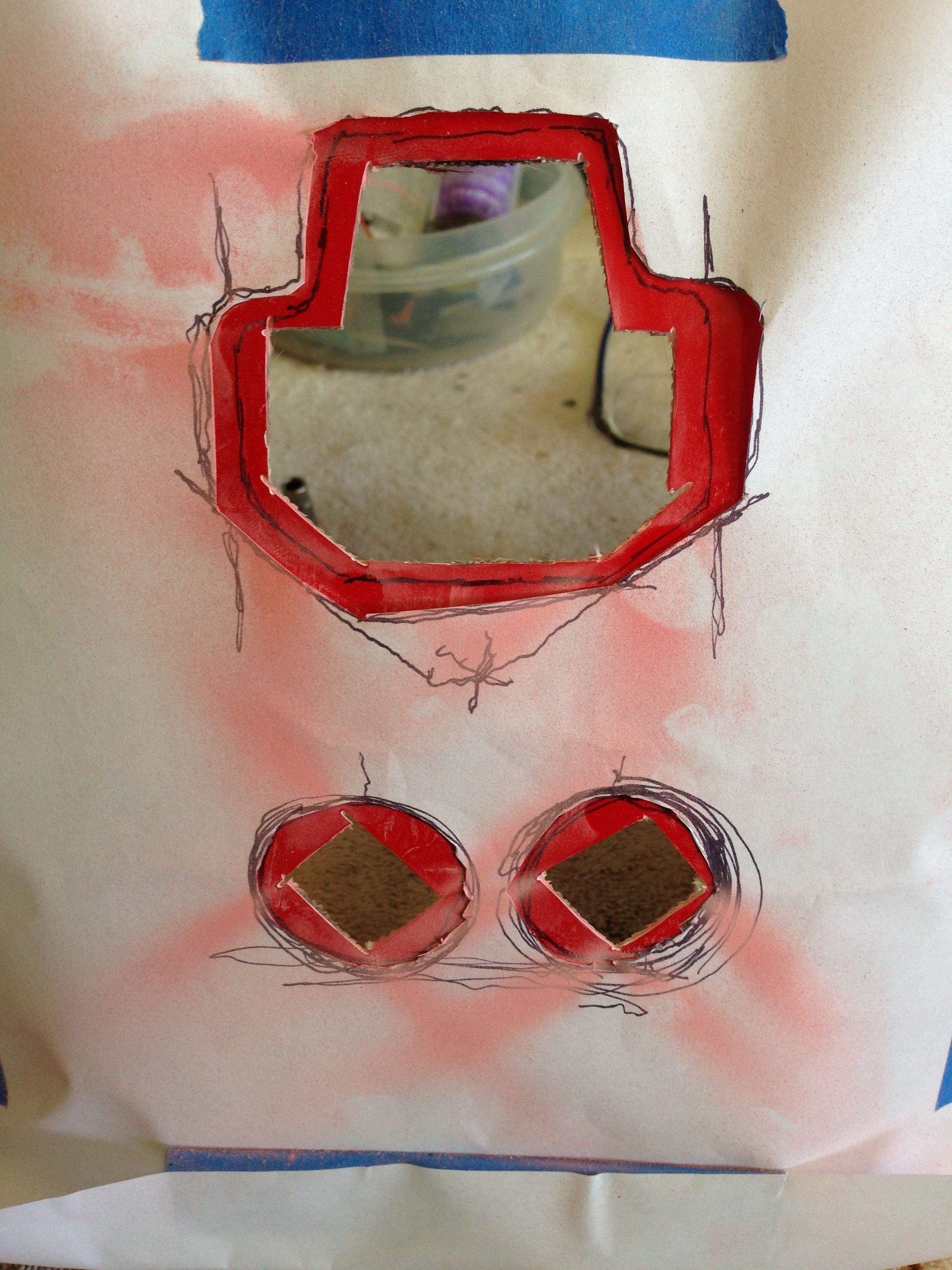

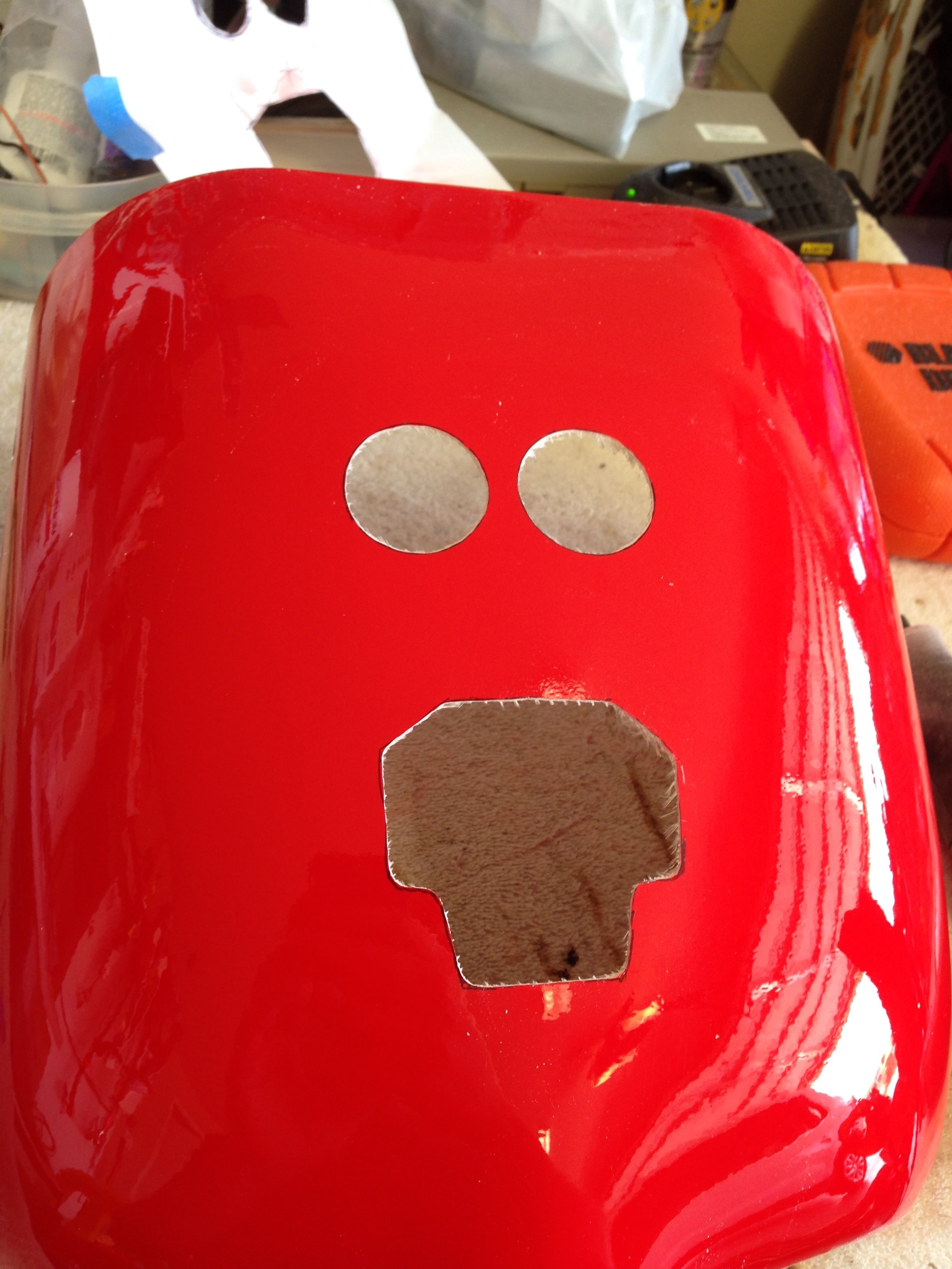

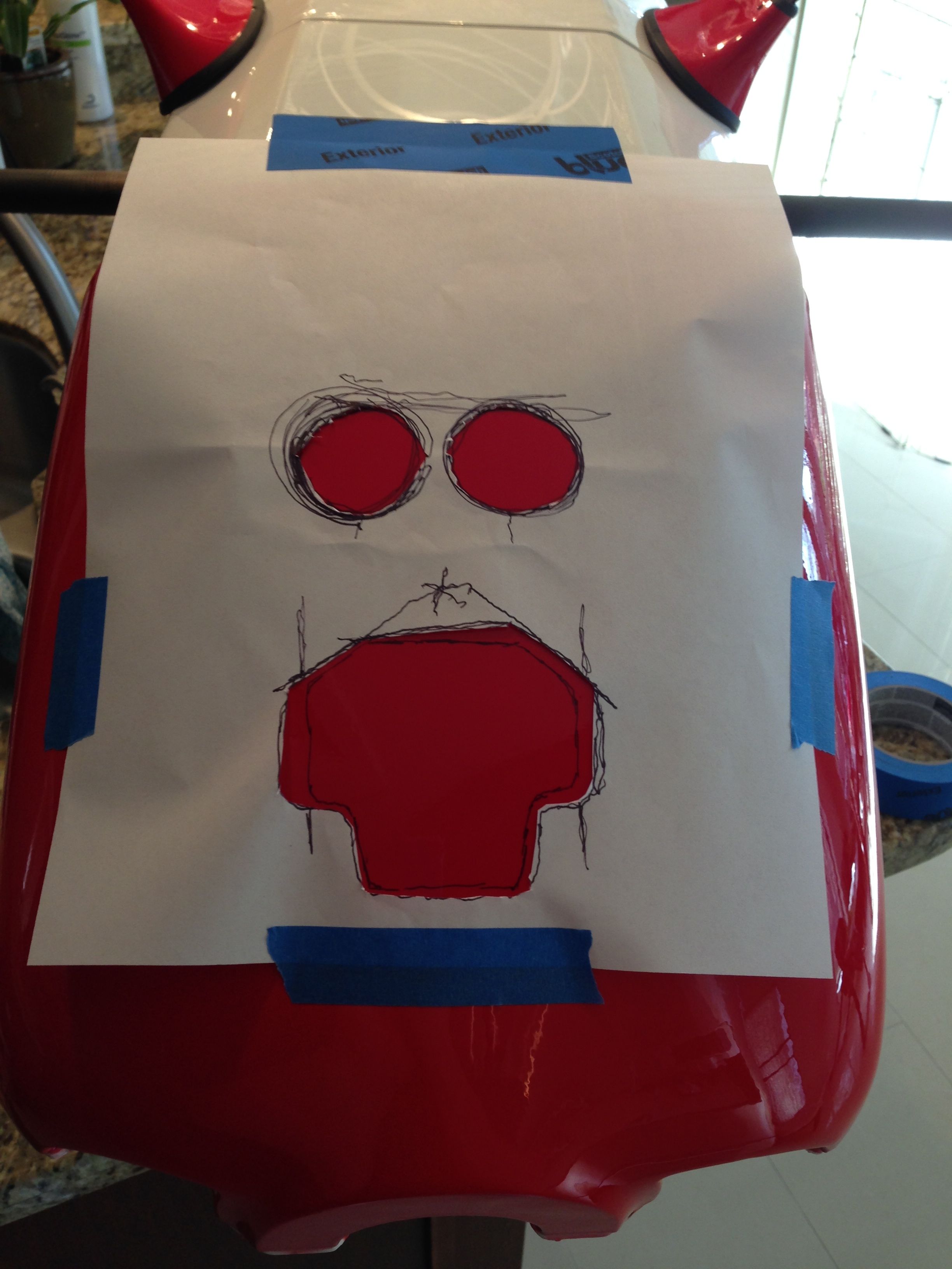

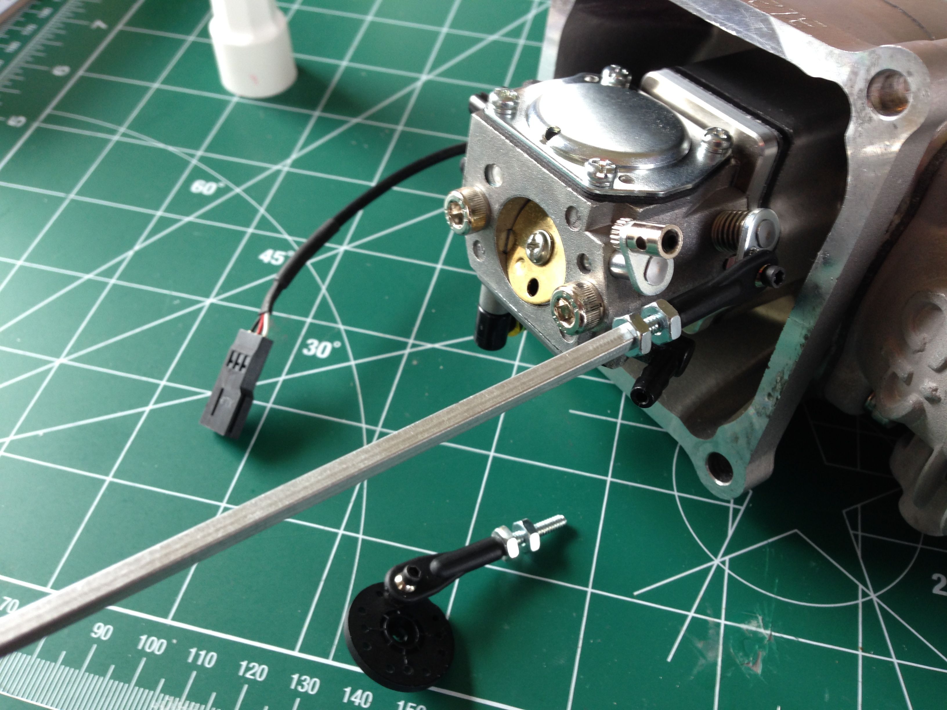

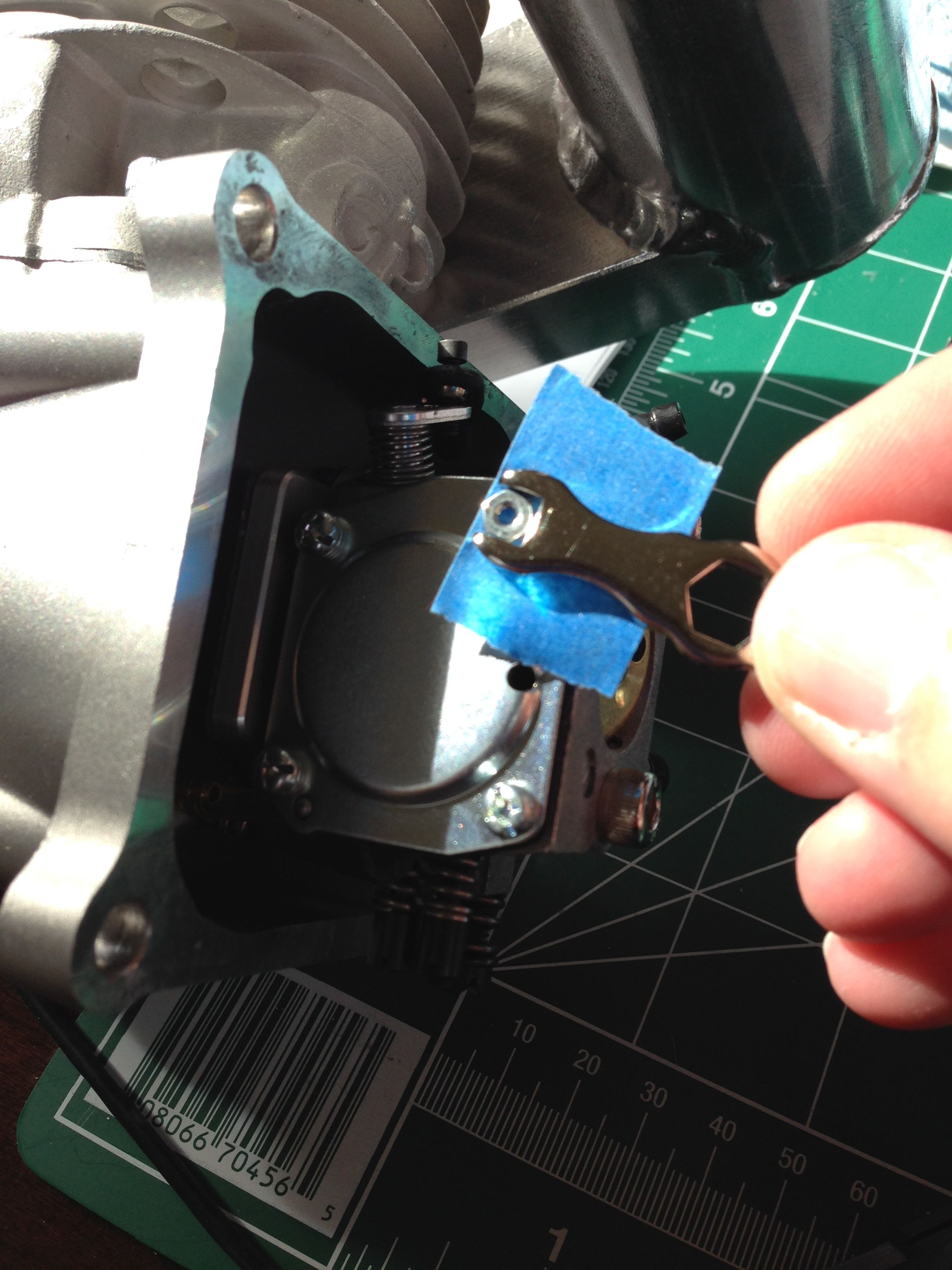

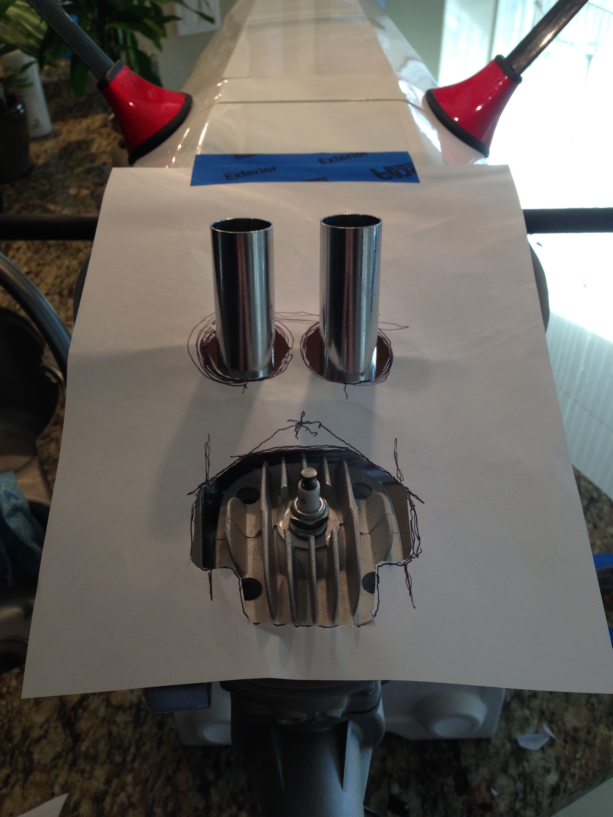

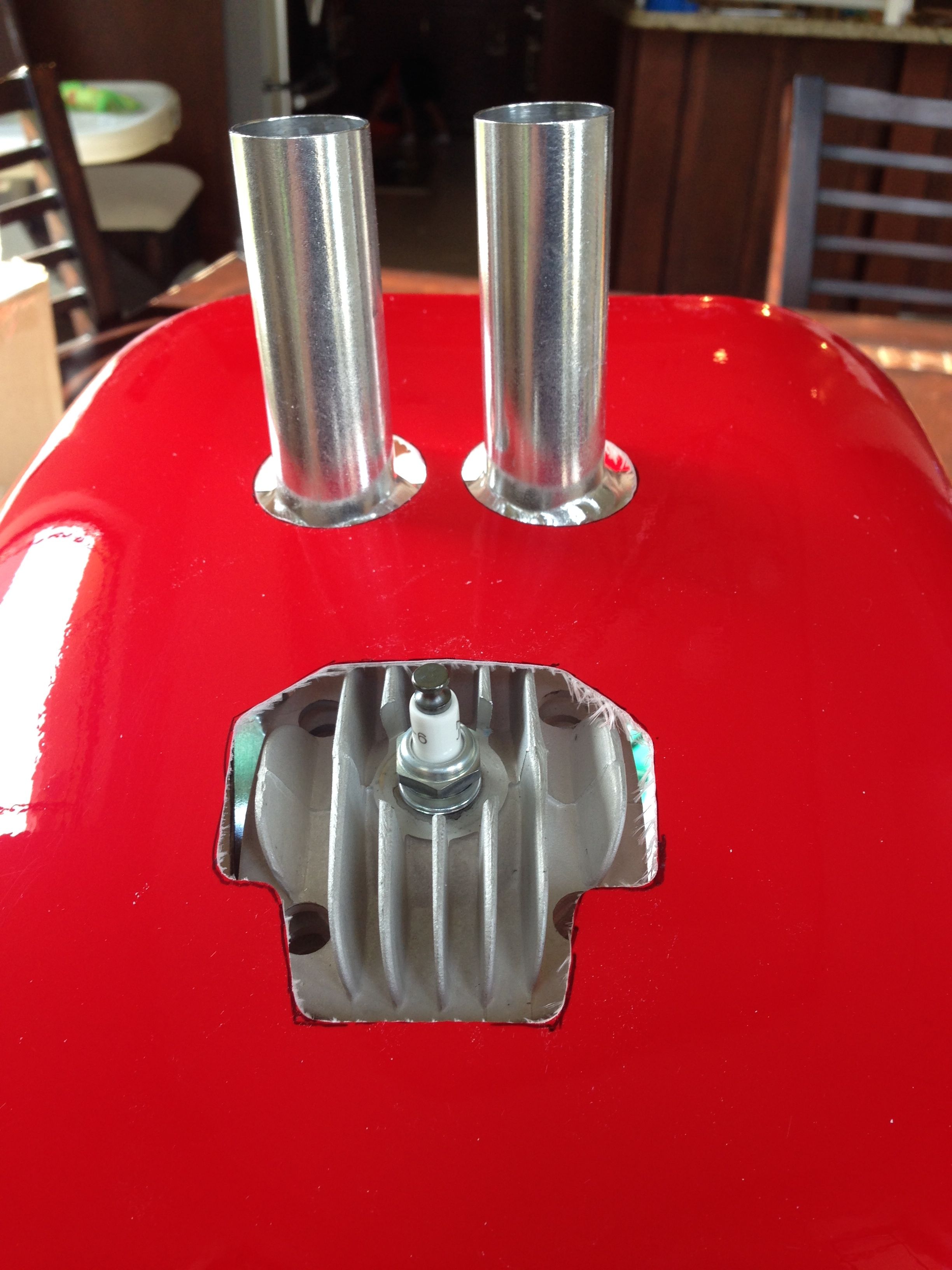

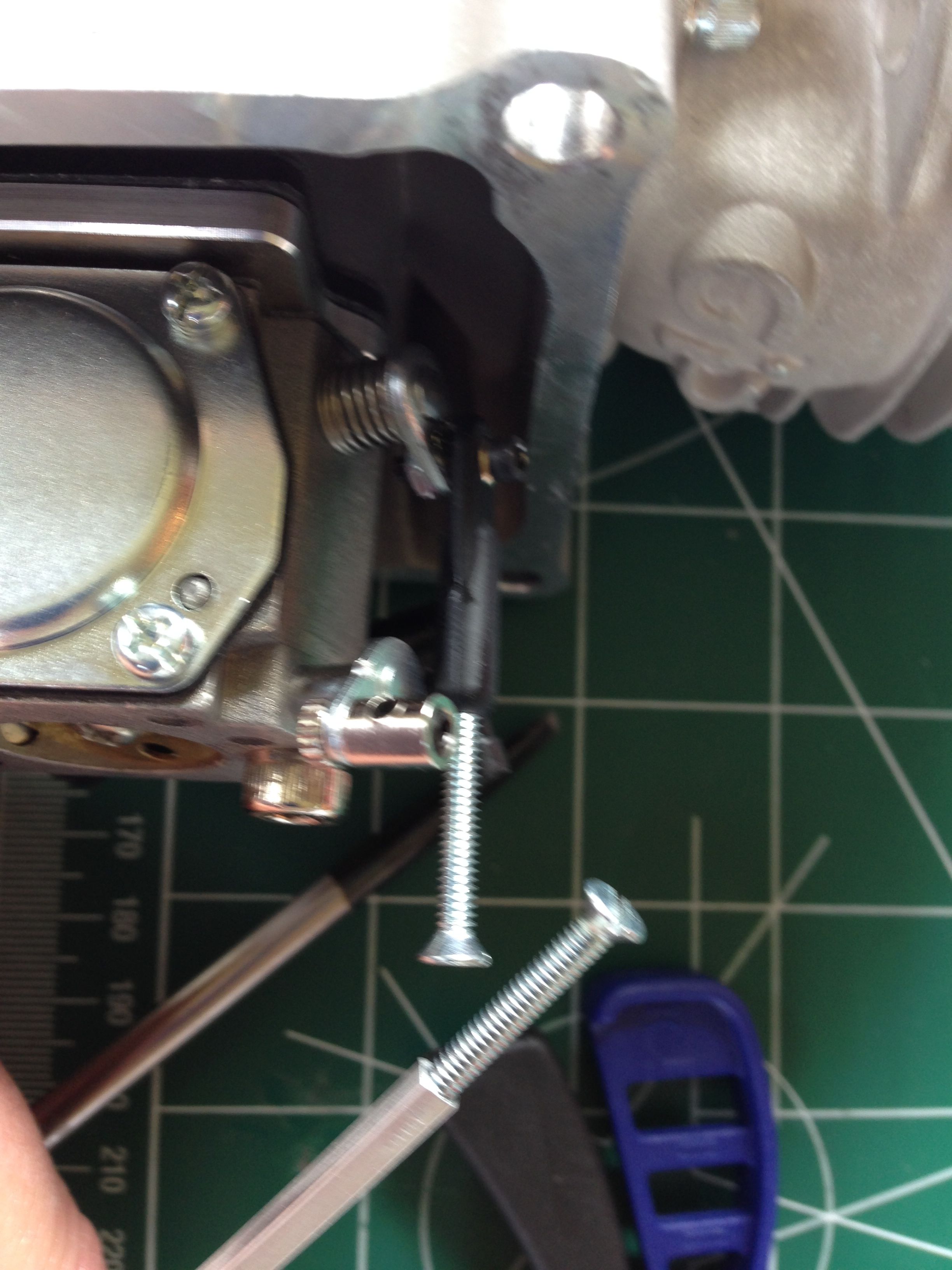

Well I did the cowl and worked hard on the throttle linkage. I need a threaded 4-40 rod and could not find one at hardware store. So I needed to make one from some square aluminum extrusion. I think it looks nice after some head scratching.
