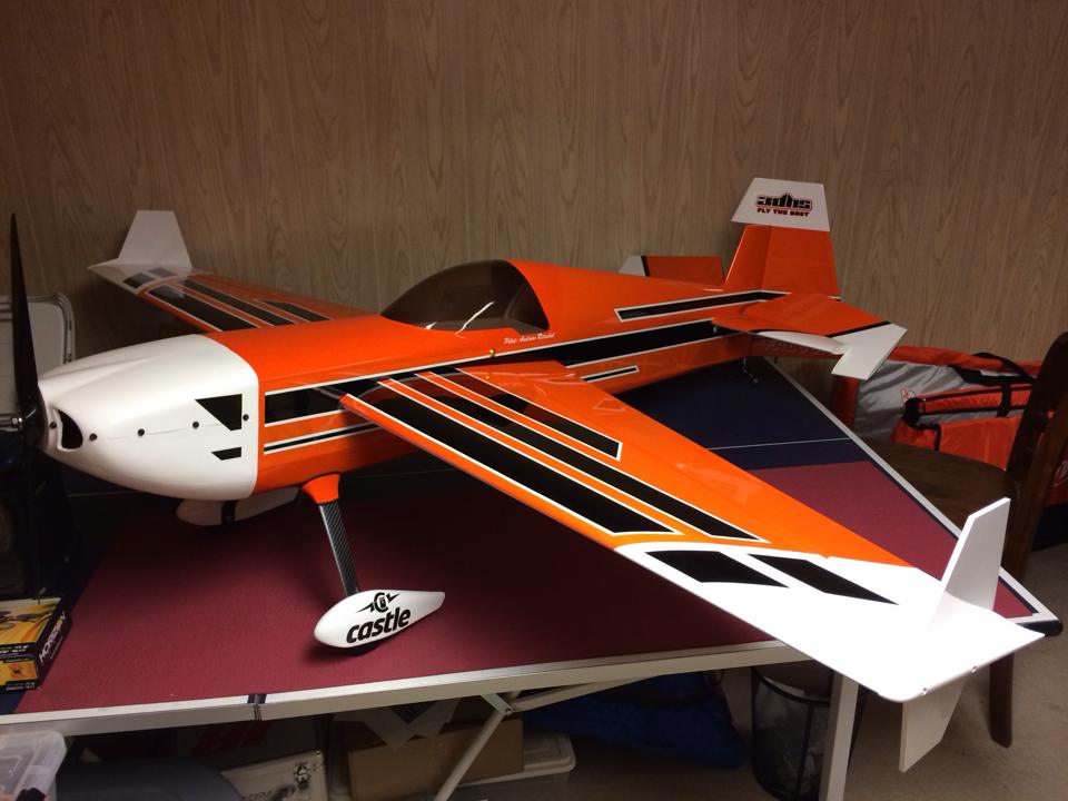

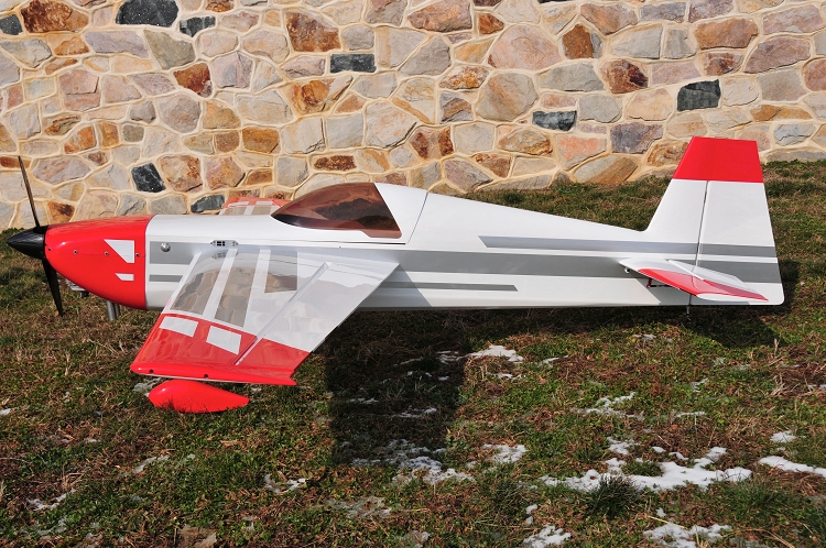

I dont know why they look orange in some pictures. Do you know when they might have the next batch avaiilable?
vegasking
They are red/white/silver. The orange/white/black were prototypes.

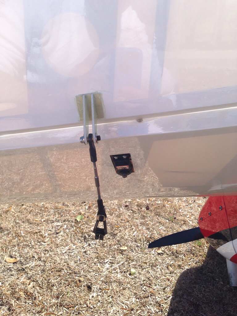

The Edge didn't feel right on the fist flight, so I landed to find this:
Guess there wasn't enough loctite...

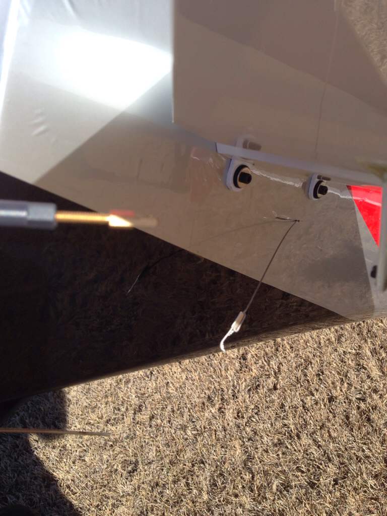

Took off again, and tried to get some violence done... But after the second pop-top, once again, something didn't feel right, so I checked controls, and rudder was only deflecting left.
So... I landed again and found this:
Looks like the supplied pull-pull wire wasn't up to task. I'll order some quality replacement cables from Secraft so I can make sure it doesn't happen again.
