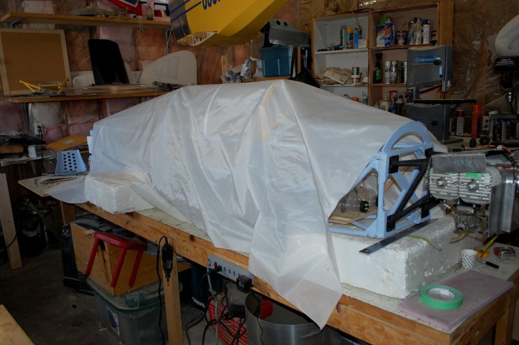

Scale 50% Dalotel 165

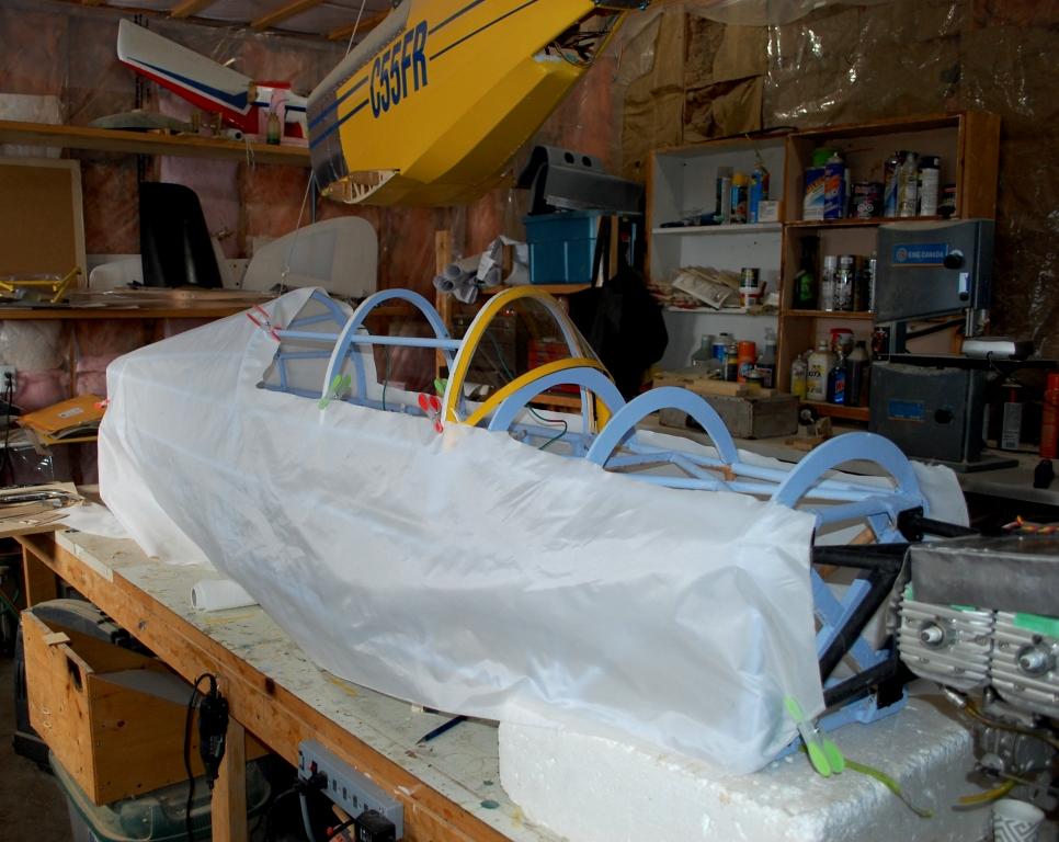

No I didn't put her to bed, just finished cutting the dacron, man that is big,

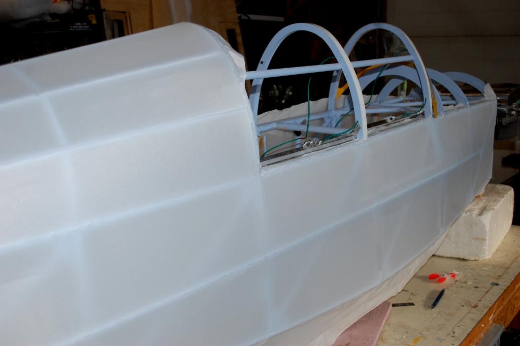

excelent but being a scale airplane , I have to do it the way it was done
Ray if you are looking at this, can you tell me if the full size had the pinking tape
about the pinking tape, I have looked at every original photos of the Dalotel that I have , reworked them for better contrast etc, and there is no way to tell if it had pinking tape or not, so my decision is mine will have it .
